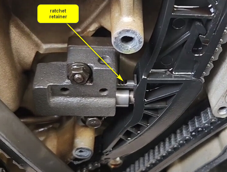

The timing chain rattle is caused by slack in the timing chains on startup when the engine oil pressure still has to build up. The timing chain tensioners, there are 2, are then gradually extended to take up the slack in either chain.
A worn timing gear certainly can add to excessive timing chain slack and should be replaced if found to be worn.
A good video of a failed timing chain tensioner is below.
https://youtu.be/kTCBIvTBjOM
The tensioners have a ratchet type adjuster to take up the initial slack and are then fully extended once oil pressure has build up. If this ratchet mechanism fails to engage the tensioner piston, as shown in the video, then you will have a timing chain rattle as the chain remains slack until there is sufficient oil pressure. See image 1.

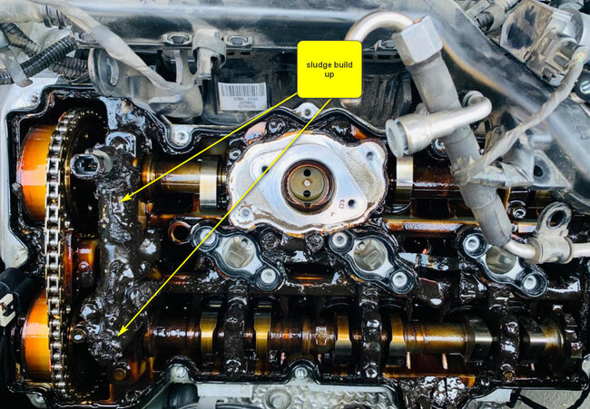

Has the mechanic checked that the engine oil is clean and of correct viscosity/grade? Also check that the engine has no excessive sludge build up. See image 2.
Sludge can cause a delay in oil pressure build.
