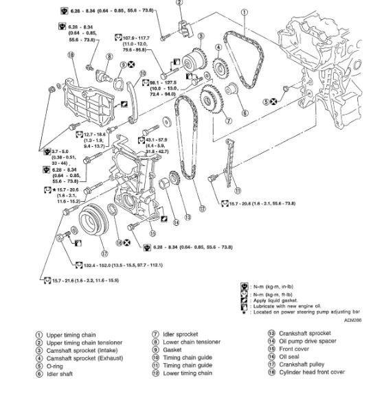

i have replaced the top gasket, now i do not know how to put on a timing chain. Please help me the guide on how to put a timing chain, timing marks.

Good afternoon,
I attached the procedure for you below. This is a huge project if you never did one before.
https://www.2carpros.com/articles/how-a-timing-belt-works
This engine is an interference engine which means if the timing changed or is installed incorrectly, valve damage will result in the cylinders.
This procedure is revised by TSB # 98-107 Date: January 15, 1999
Note: A revised service procedure for the engine front cover/timing chain has been adopted for the GA16DE. It is no longer recommended to remove the cylinder head when removing the timing chain/front cover(s). Utilize the following steps when servicing the front cover, timing chain, guides or tensioner(s)

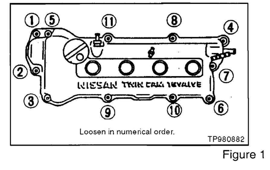

3. Remove the rocker cover (see figure 1). 4.Remove the coolant reservoir tank with bracket and reposition it for clearance.

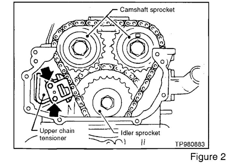

9. Remove the upper chain tensioner (see figure 2).

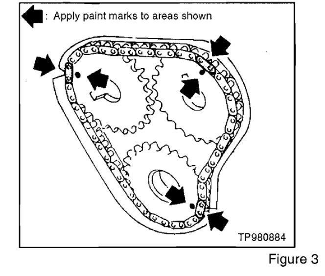

10. Wipe off the links of the upper timing chain next to the timing marks on the sprockets. Put paint marks on the timing chain, matching them with the timing marks on the cam sprockets and idler sprocket (see image 3)

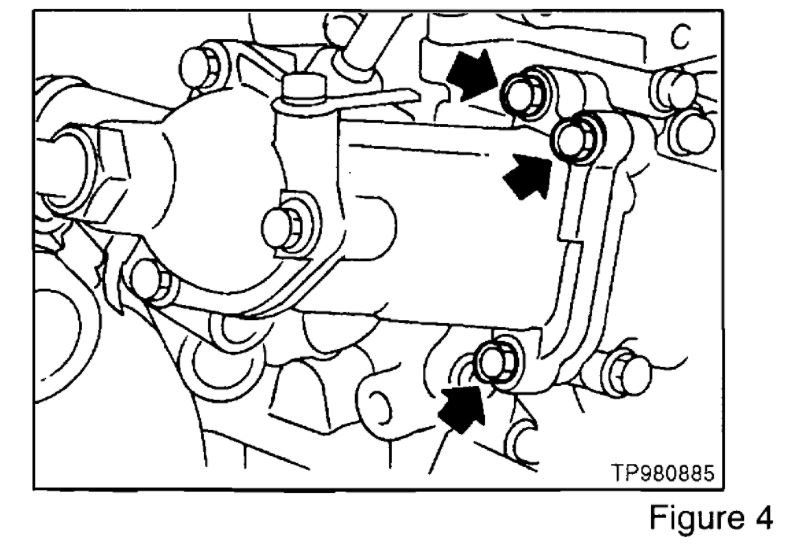

19. Remove the thermostat housing (See figure 4).

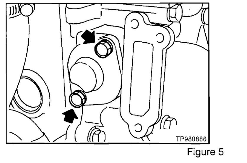

20. Remove the lower chain tensioner (see figure 5).

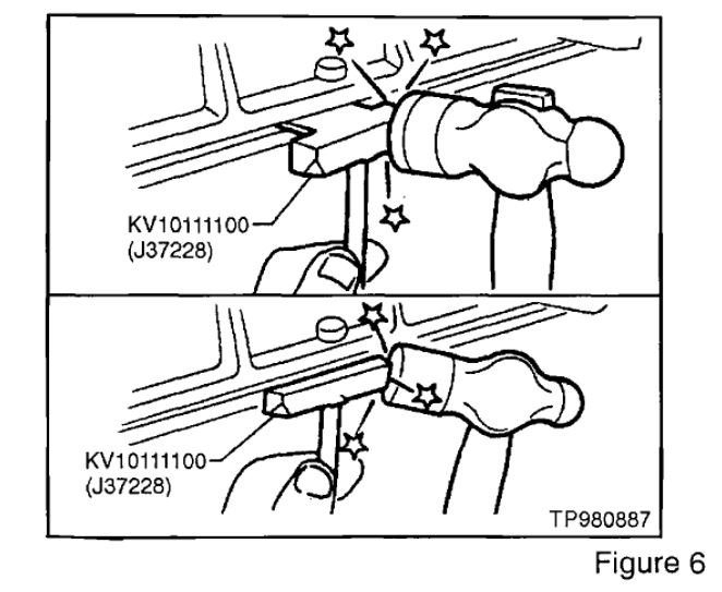

23. Remove the oil pan (see figure 6).
a. Insert the tool between the cylinder block and oil pan.
CAUTION:
Be careful not to damage the aluminum mating face. Do not insert a screwdriver, or the oil pan flange will become damaged.
b. Slide the tool by tapping it on the side of the tool with a hammer.

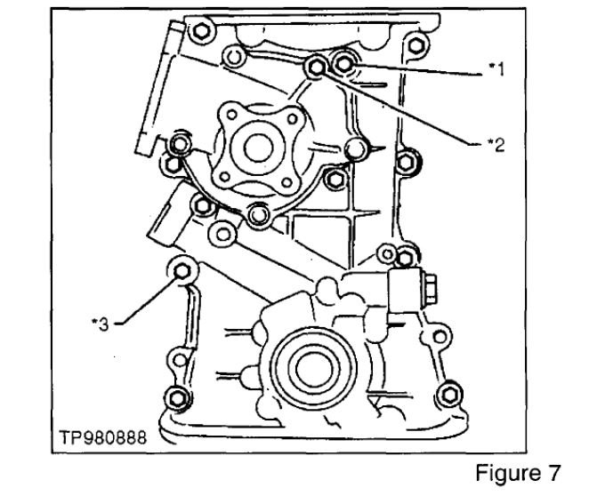

27. Remove the front cover bolts and front cover.
CAUTION:
One bolt is located on the water pump (see figure 7).
1: Located on engine front mounting bracket.
2: Located on the water pump.
3: Located on the power steering oil pump adjusting bar.
CAUTION: Be careful not to tear or damage the cylinder head gasket.
28. Remove the cylinder block to front cover alignment dowels.
CAUTION: Do not hit the dowels or the cylinder block will crack.

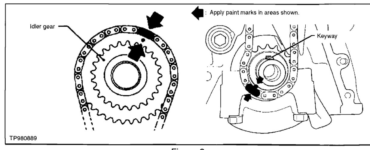

29. Wipe off the links of the lower timing chain next to the timing marks on the sprockets. Put paint marks on the timing chain, matching them with the timing marks on the idler sprocket and crankshaft sprocket (see image 8).
