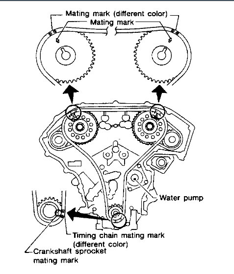

Can I check if my timing chain is correctly matched by rolling the camshaft pulley?
2000 NISSAN MAXIMA
400,000 MILES • V6 • 2WD • AUTOMATIC
SAINTHOMMES
By rolling the pulley I mean, does rolling the pulley and having no obstacles or the crankshaft stopping mean my timing is correct and won't have the valves hitting the pistons. Thanks
Feb 7, 2023 at 3:47 PM
  • 110,240 POSTS

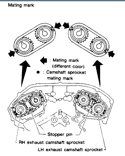

That is usually a good indication there is no interference, but you should really rely on timing marks on the engine. If you had them aligned and there is no interference, it should be correct.
I attached two pics below for the primary and secondary timing chains. Take a look at them and let me know if the colored chain links were in the position shown.

Thank you so much for the wonderful response, I really appreciate it. I have the markings on the timing chains aligned with the dots and points both on the cogs and gears, what we notice is, the engine appears tough to roll, it does roll, but it's tough hard to roll and we have had to change the kick twice cos they keep getting burnt. What could be the cause of the toughness? Do you think the positioning of the pistons, connecting rod and caps could be wrong? Cos if that's the issue, we can still being the engine down and reset from scratch. What is your valuable suggestion?
