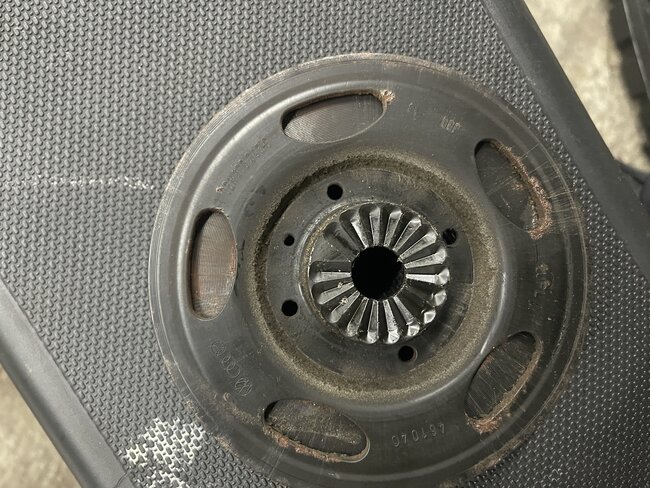

I watched several videos on how to go about it. I just want to change the gasket but I have to remove the chain to do that anyways, if I see a chain stretch I may change it. I saw the tool which is not expensive to lock the cams and crank. My question is, I have not seen one video that mentions what to do if say the timing was off by one tooth, also does a stretched chain always mean the timing is off? I have no timing codes and it runs well. If it is off and the cams are locked how do I go about turning the camshaft so the slots on the back of engine are flat.

ya I saw videos on how to do it and the tool set isn't expensive. My only question is, after I install the 3 tools, and if I need to adjust the camshaft say a tooth if its off, how would I do that while everything is locked in position

hmm, you talking about the front tool am guessing, so what do I do after I lock the crank? if it is a bit off and after I remove the chain, can I turn it a tiny bit using a long wrench around the camshaft? I believe there is a place for it, this way the tool fits right

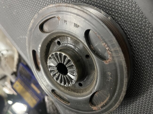

Attached
Jan 7, 2026 at 10:11 AM
  • 55,711 POSTS
Yep, you found it, that will make the noise you are having when the engine is running! Was the engine worked on before and they left it that way or was it like this from the factory? Thanks for the video it helps.

IS IT OK IF I INSTLL THE CRANKSHAFT LOCKING PIN AND THEN USE THE IMPACT TO REMOVE THE BOLT? CAUSE WHENEVER I USE THE IMPACT THE PULLEY MOVES

Do you have two posts for the same car/problem? I just saw this image a few posts ago?
