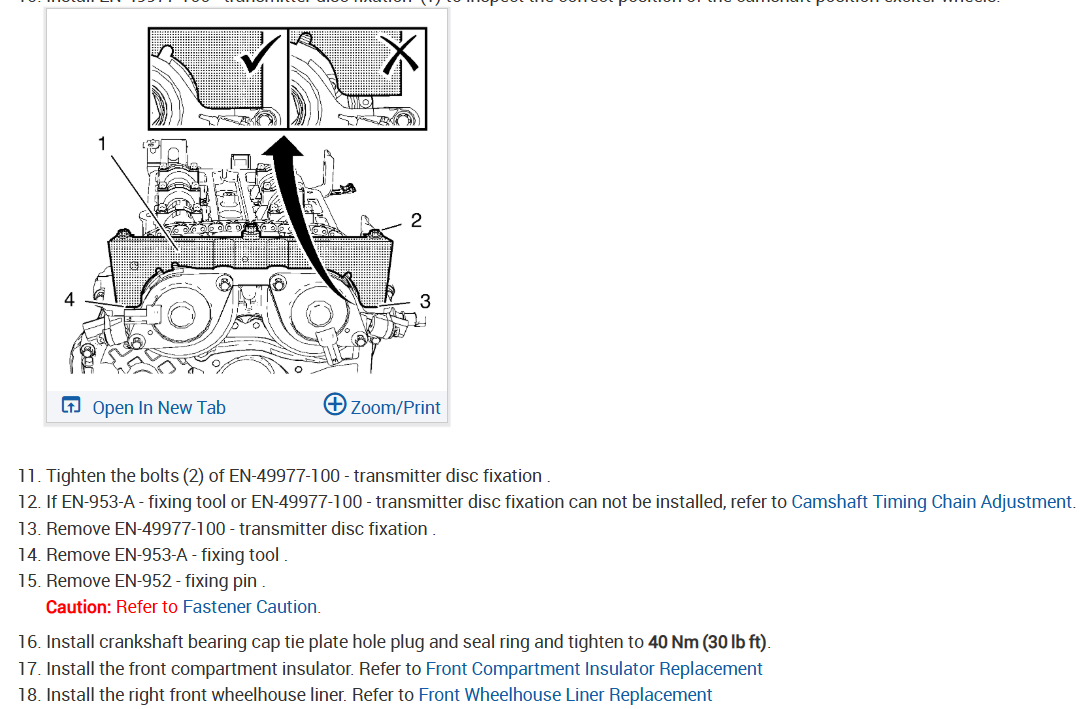

I watched several videos on how to go about it. I just want to change the gasket but I have to remove the chain to do that anyways, if I see a chain stretch I may change it. I saw the tool which is not expensive to lock the cams and crank. My question is, I have not seen one video that mentions what to do if say the timing was off by one tooth, also does a stretched chain always mean the timing is off? I have no timing codes and it runs well. If it is off and the cams are locked how do I go about turning the camshaft so the slots on the back of engine are flat.

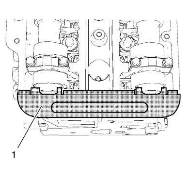

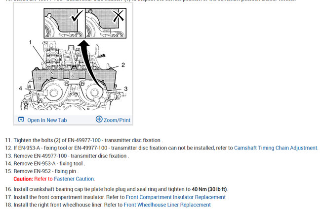

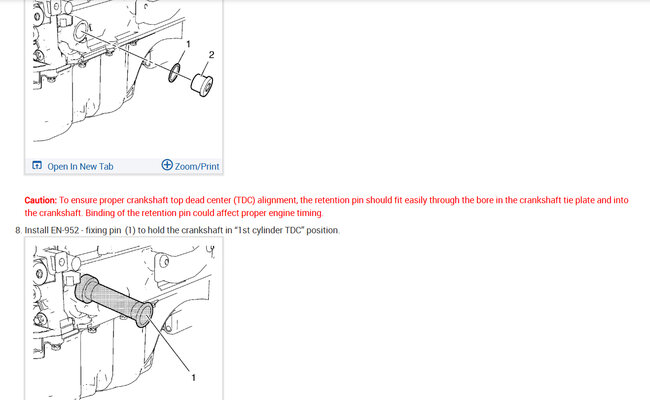

Yes, you need to be careful while messing with the timing chain, so at 123k I would change the chain, tensioner and guides out. So this is a 1.4 liter turbo engine. So there is no camshaft marks and there are three special tools to help line up the crankshaft to the camshafts. Two of them hold the camshafts and one holds the crankshaft in position for the new chain installation. There should be flat spots on the camshaft to help adjust them slighting to help with the tool installation, do not turn the camshaft over fully with the crankshaft tool installed, you will damage the valves. Here are the tools and how to install them. Check out the images (below). Let us know if you need anything else.

ya I saw videos on how to do it and the tool set isn't expensive. My only question is, after I install the 3 tools, and if I need to adjust the camshaft say a tooth if its off, how would I do that while everything is locked in position
Jan 3, 2026 at 1:55 AM
  • 55,051 POSTS
So the camshaft tools can not be installed unless the cams are lined up, the tool will not fit into place if the timing is off a tooth.
Jan 3, 2026 at 1:59 AM
DIVIDES
  • 903 POSTS
hmm, you talking about the front tool am guessing, so what do I do after I lock the crank? if it is a bit off and after I remove the chain, can I turn it a tiny bit using a long wrench around the camshaft? I believe there is a place for it, this way the tool fits right
Jan 3, 2026 at 2:01 AM
  • 55,051 POSTS
Correct, but it is the rear tool that dictates the camshaft alignment. Lock the crankshaft and then use the wrench on the camshafts to help rotate them slightly so the rear tool fits.

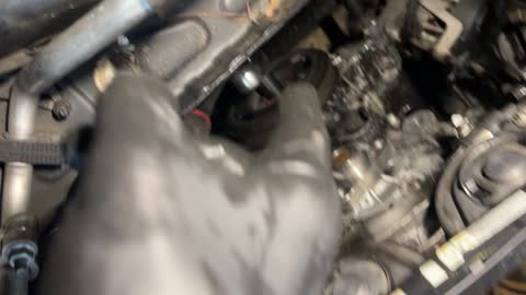

Attached
Jan 7, 2026 at 10:11 AM
  • 55,051 POSTS
Yep, you found it, that will make the noise you are having when the engine is running! Was the engine worked on before and they left it that way or was it like this from the factory? Thanks for the video it helps.
Jan 8, 2026 at 12:51 AM

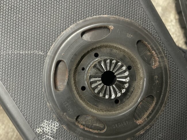

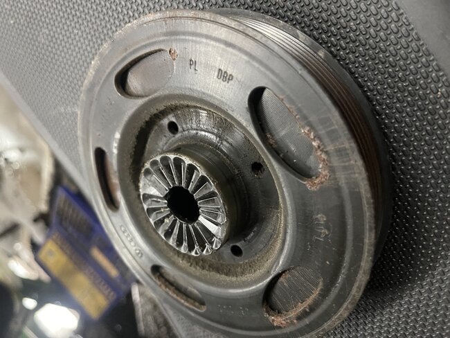

DIVIDES
  • 903 POSTS
IS IT OK IF I INSTLL THE CRANKSHAFT LOCKING PIN AND THEN USE THE IMPACT TO REMOVE THE BOLT? CAUSE WHENEVER I USE THE IMPACT THE PULLEY MOVES
Jan 8, 2026 at 9:01 AM
  • 55,051 POSTS
Do you have two posts for the same car/problem? I just saw this image a few posts ago?
