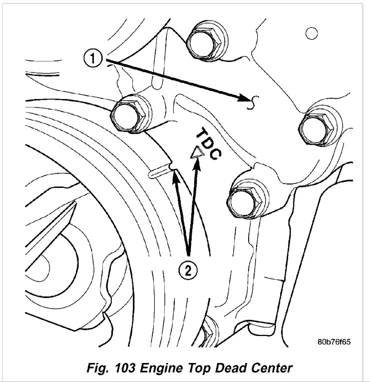

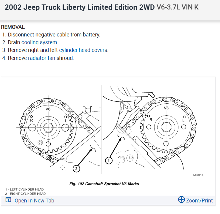

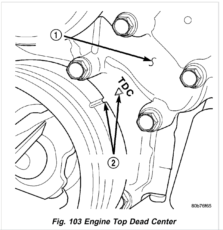

I need the timing chain marks diagram for the vehicle listed above 3.7 L, please.
Jun 25, 2025 at 12:45 AM
  • 55,402 POSTS
Sure, here are the correct timing chain marks, also it shows the crankshaft position as well TDC. Check out the images (below). Let us know if you need anything else.
