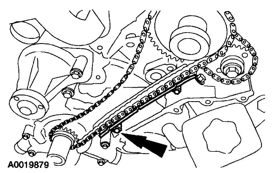

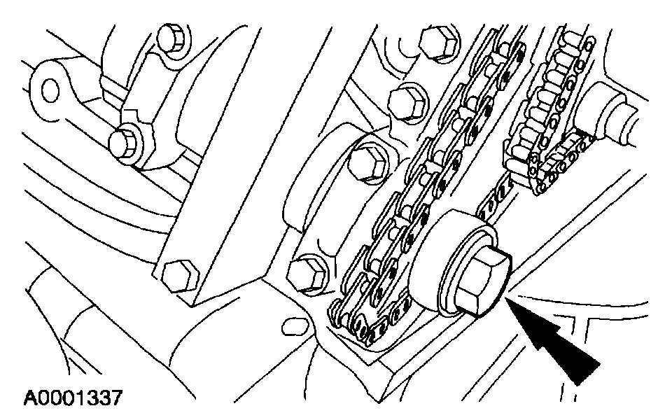

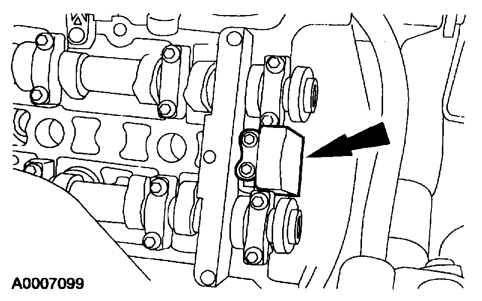

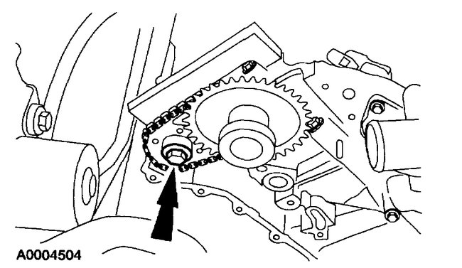

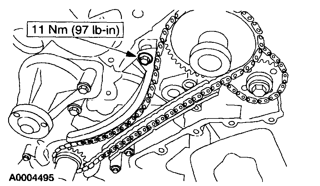

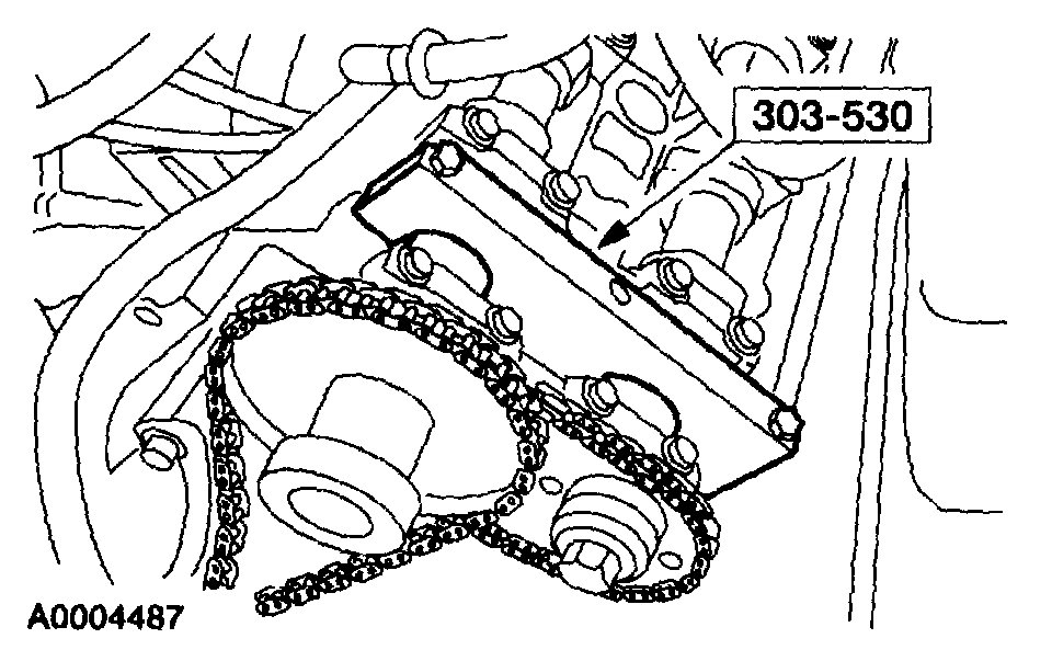

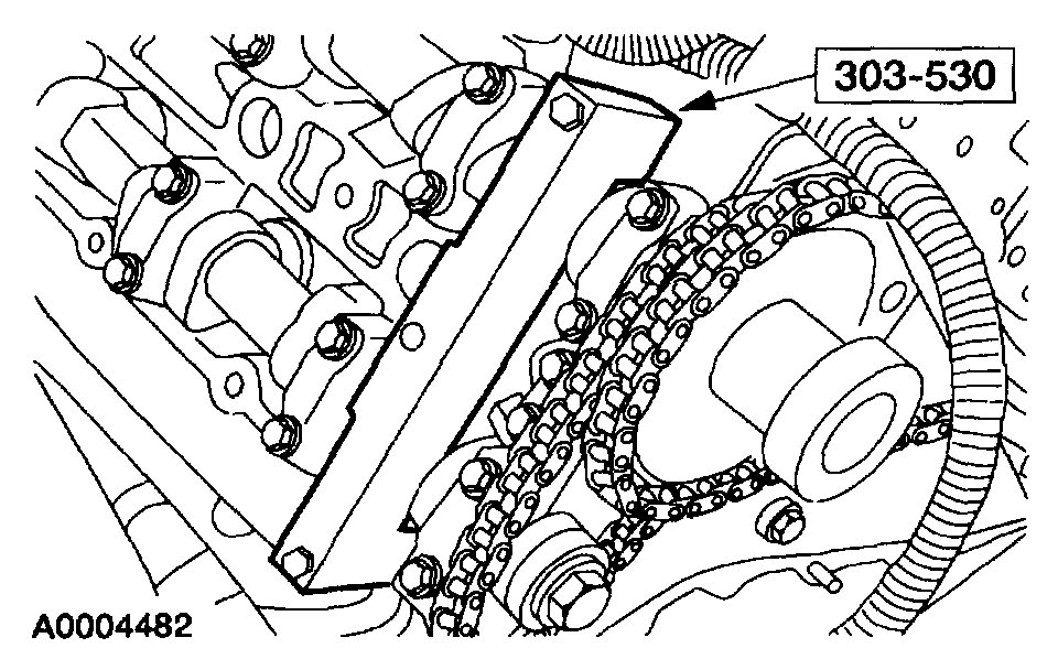

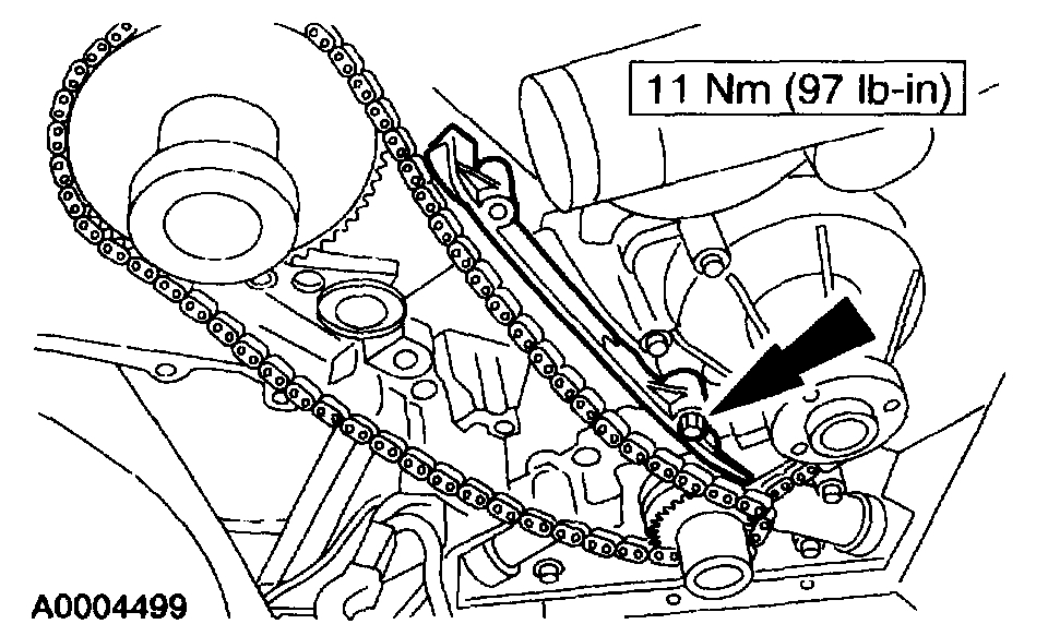

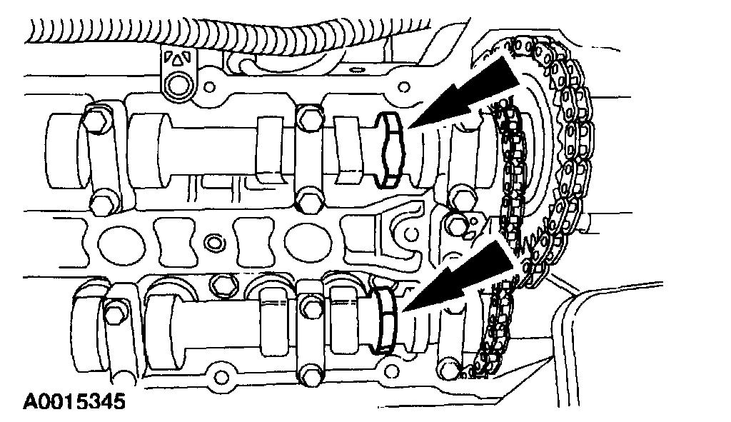

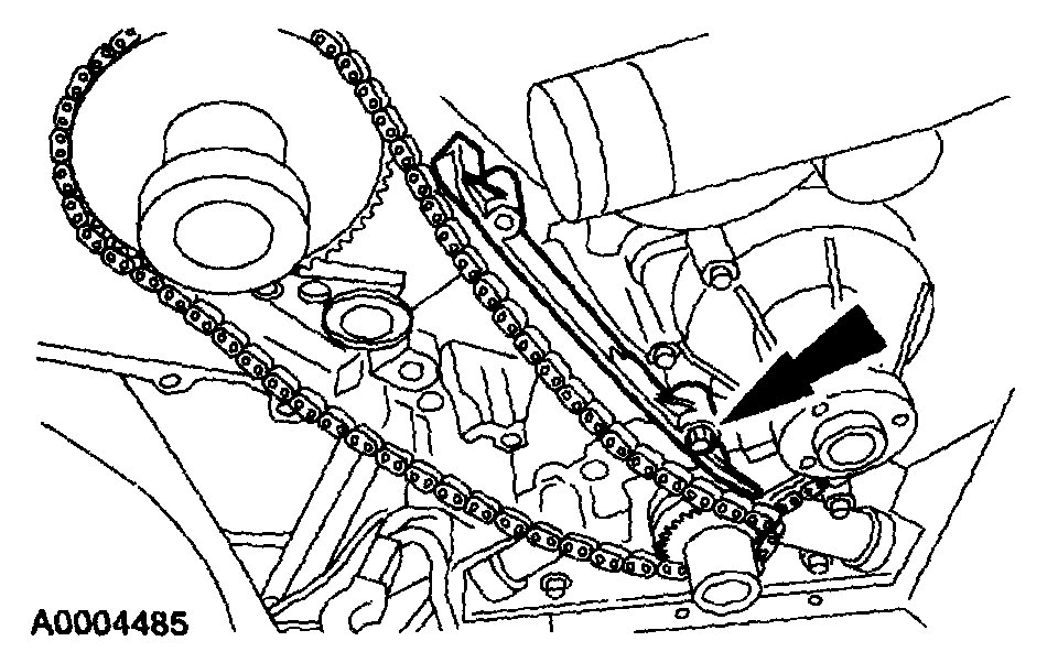

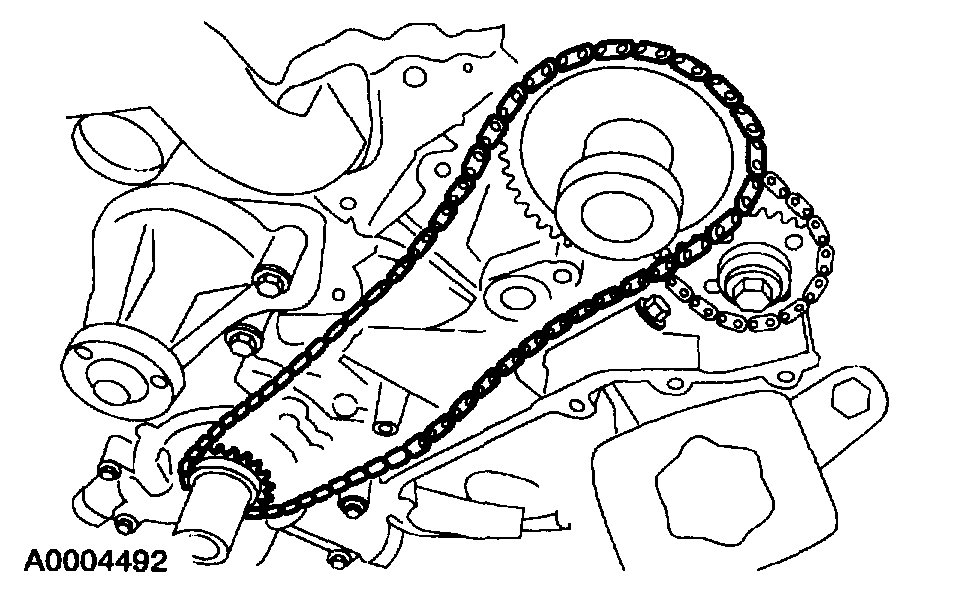

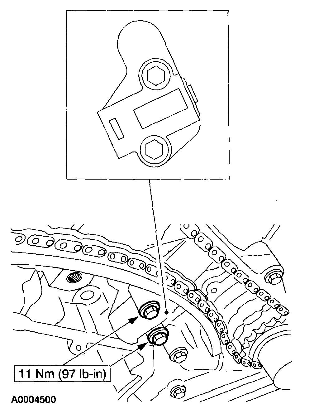

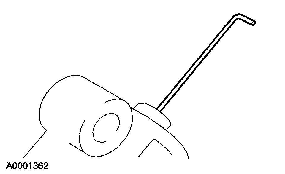

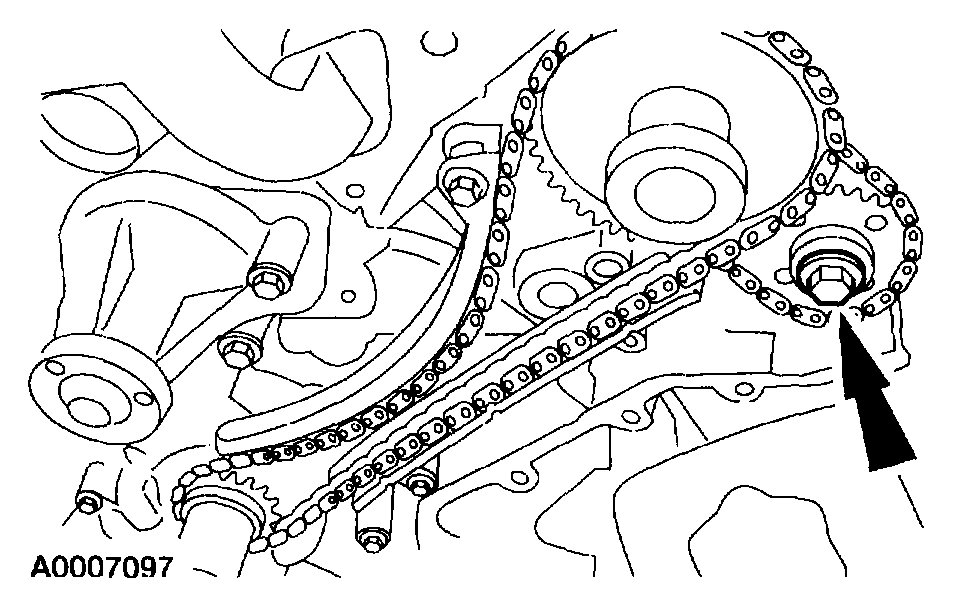

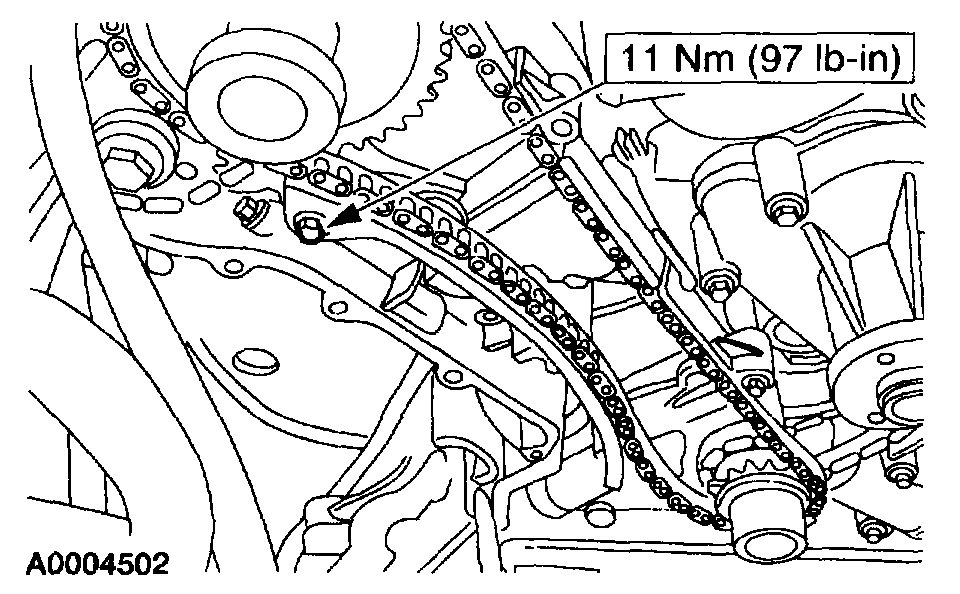

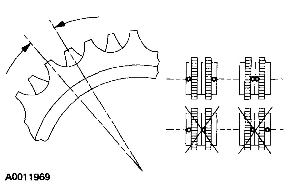

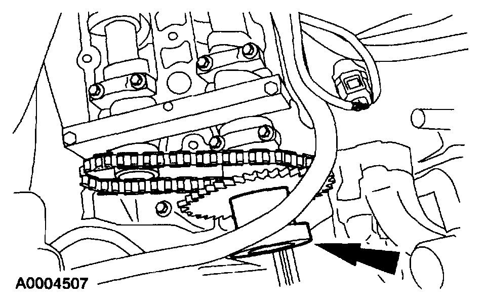

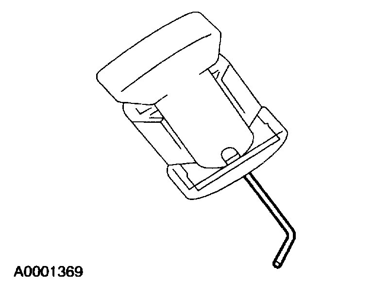

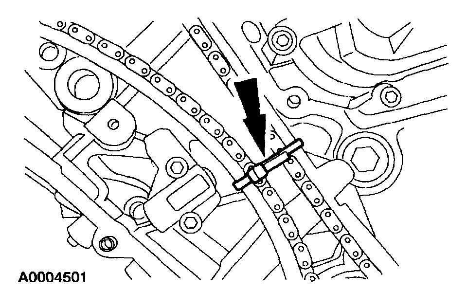

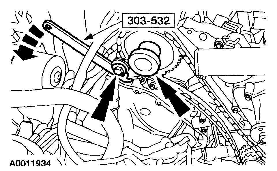

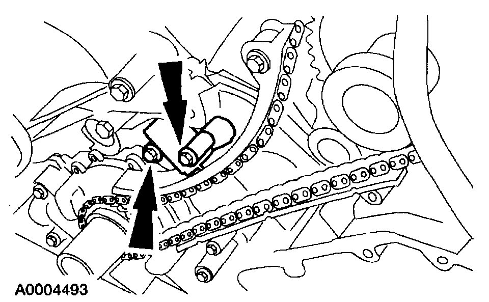

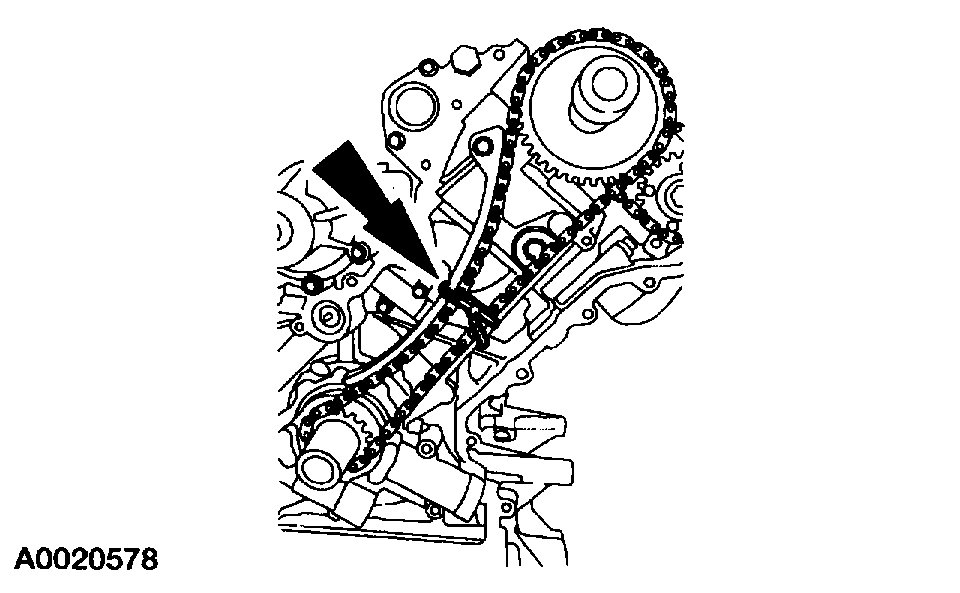

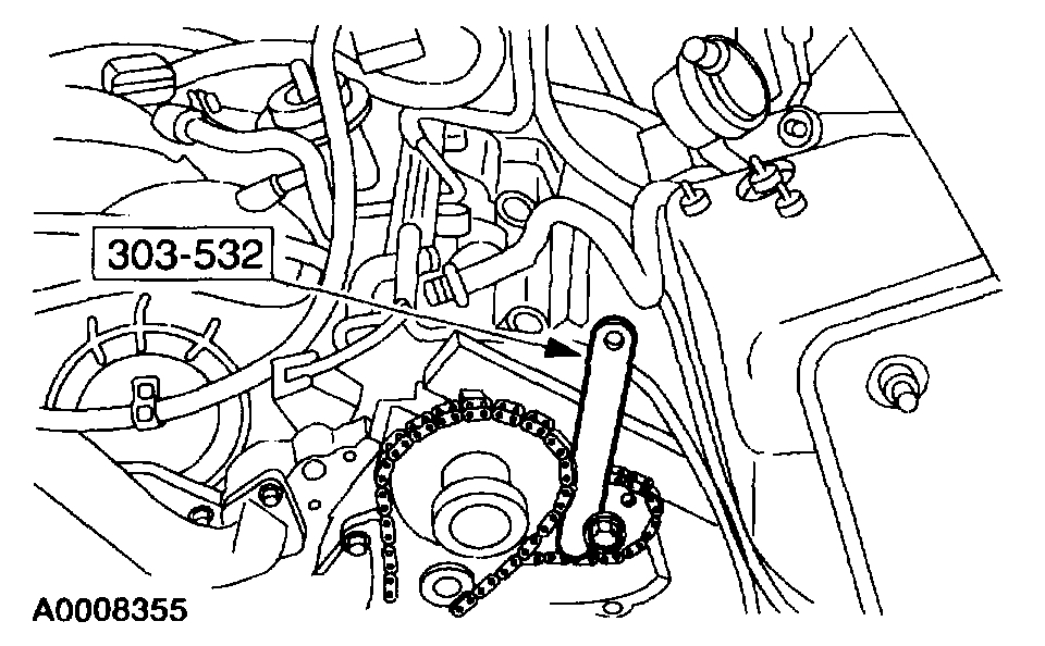

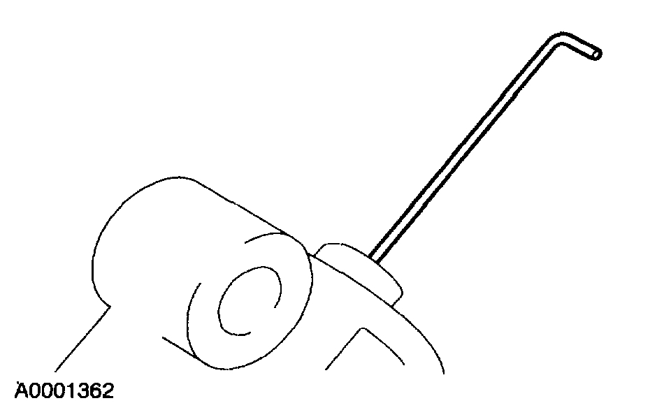

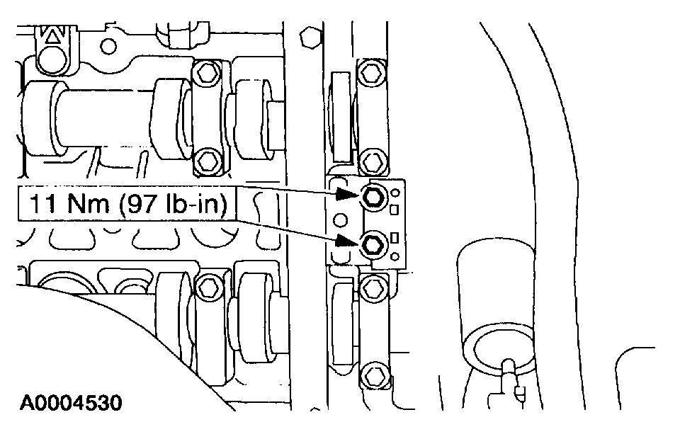

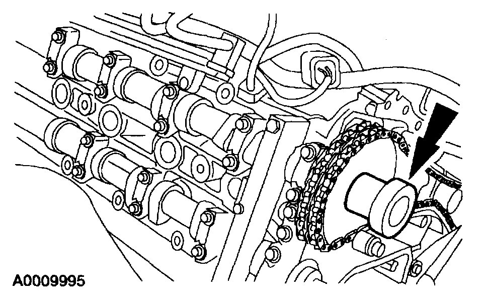

The timing chain broke and I need images of the timing chain markings to put on new timing chains.
Apr 14, 2020 at 1:12 AM
  • 110,240 POSTS

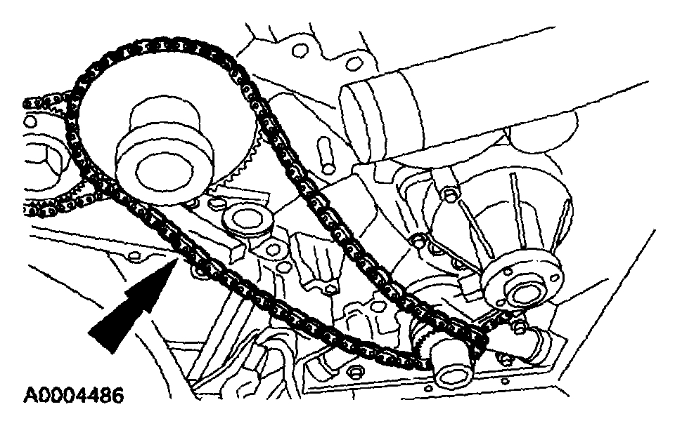

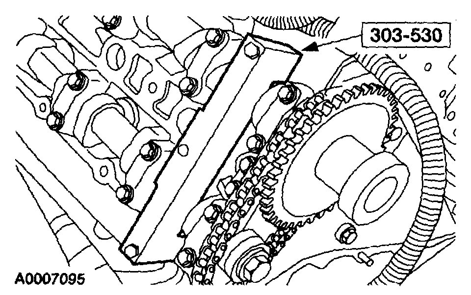

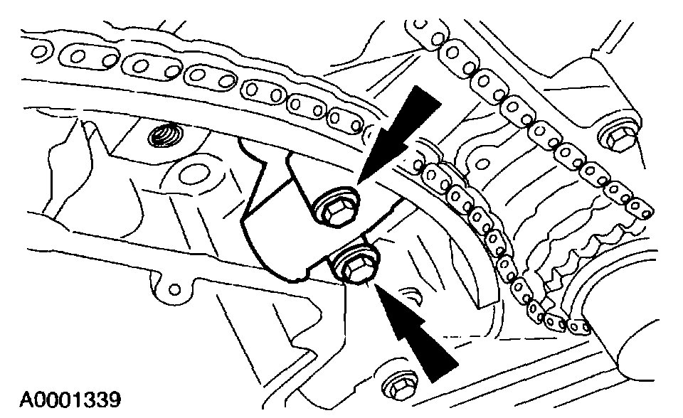

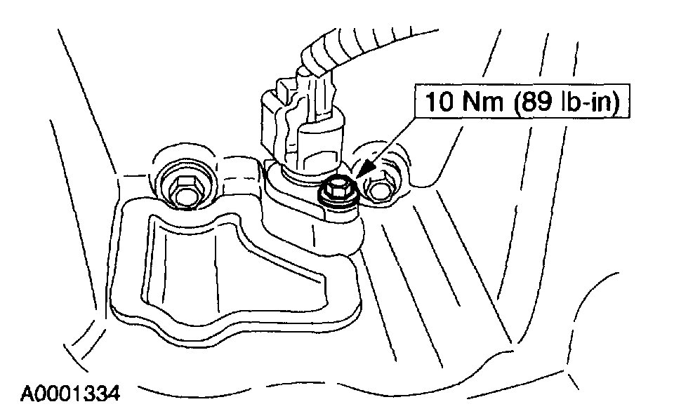

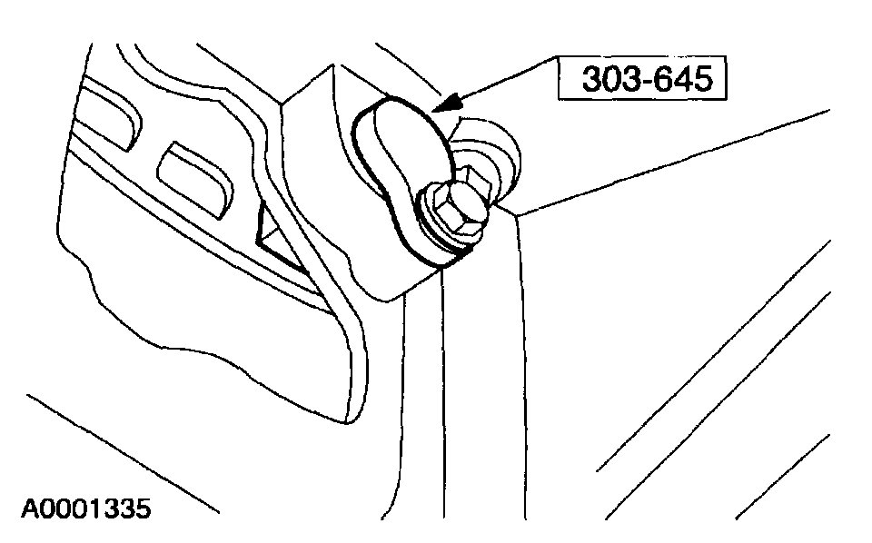

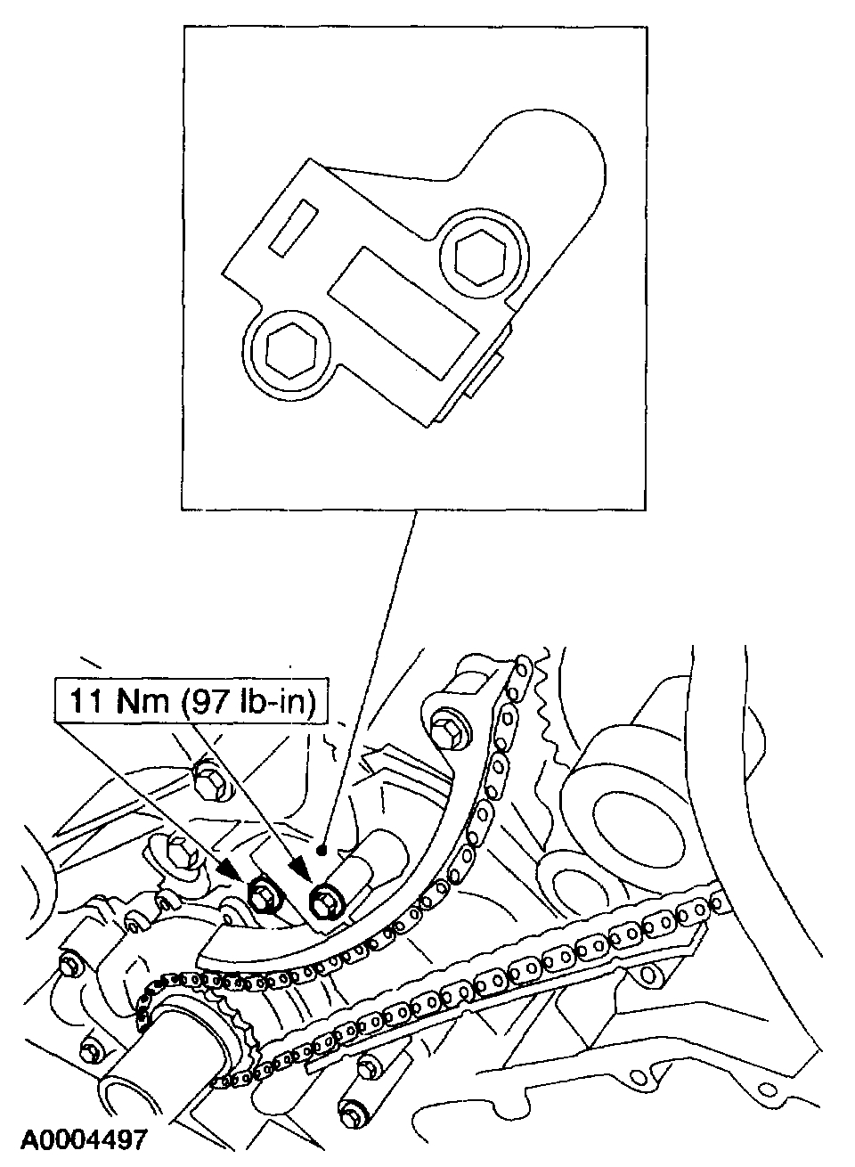

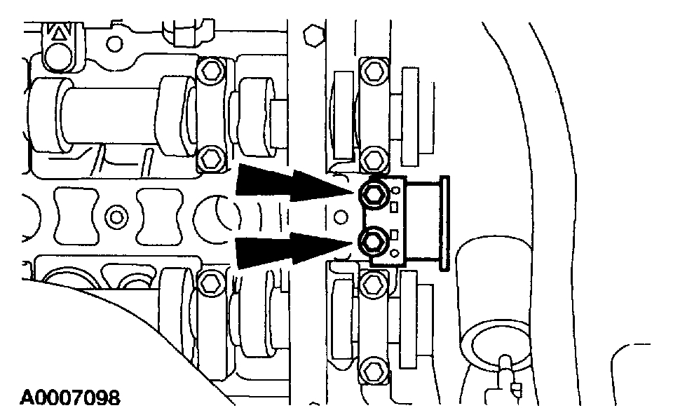

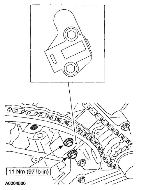

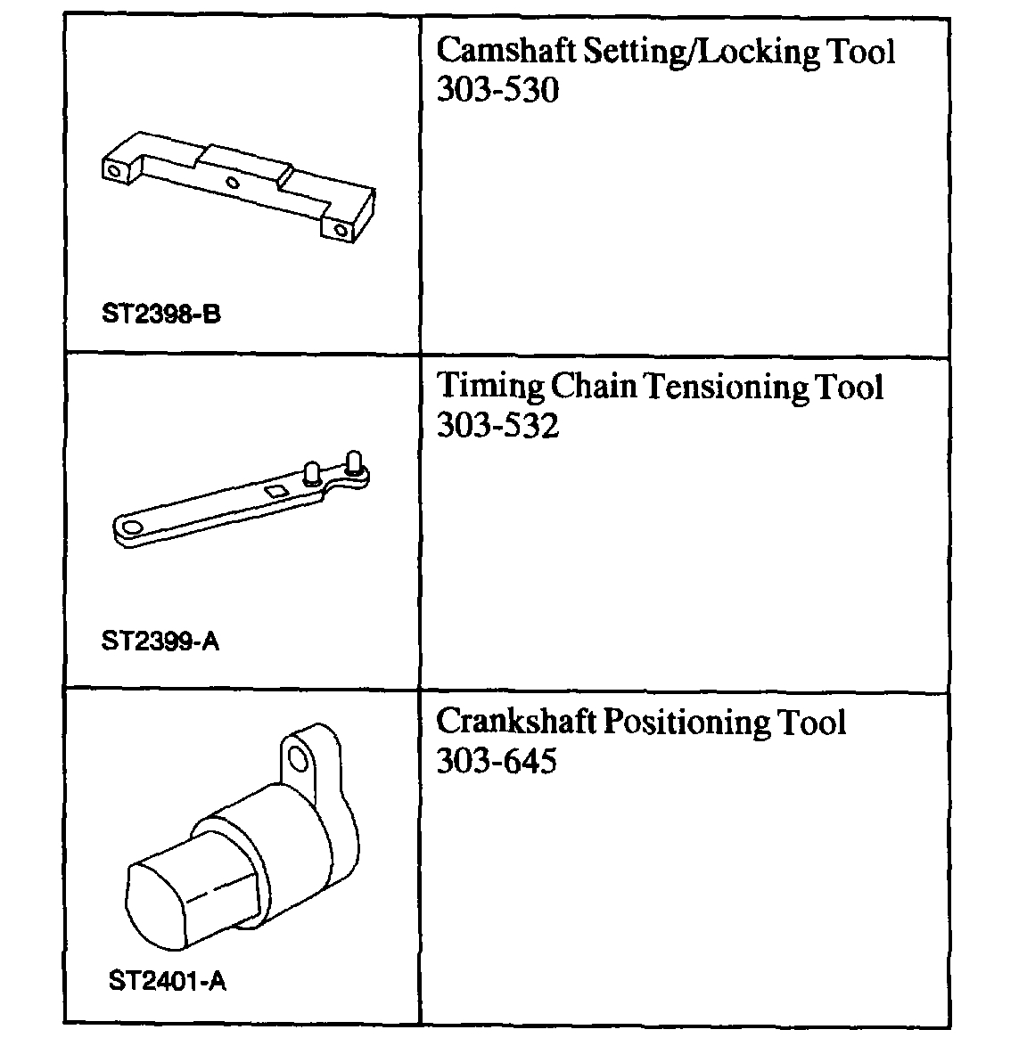

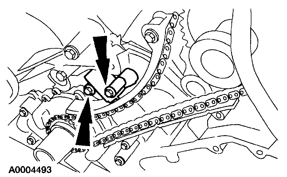

Here are the directions for replacing both the primary and secondary timing chains. All of the attached pics correlate with the directions.
________________________________________________________________________________________
2001 Lincoln LS V8-3.9L VIN A
Primary
Vehicle Engine, Cooling and Exhaust Engine Timing Components Service and Repair Procedures Primary
PRIMARY
Timing Drive Components-Primary
Special Tools
pic 1
Special Tool(s)
Removal
1. Remove the engine front cover.
2. Raise the vehicle.

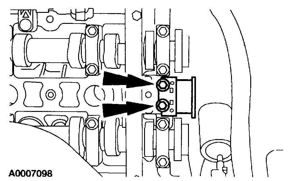

pic 2
3. Remove the crankshaft position (CKP) sensor and the torque converter cover.

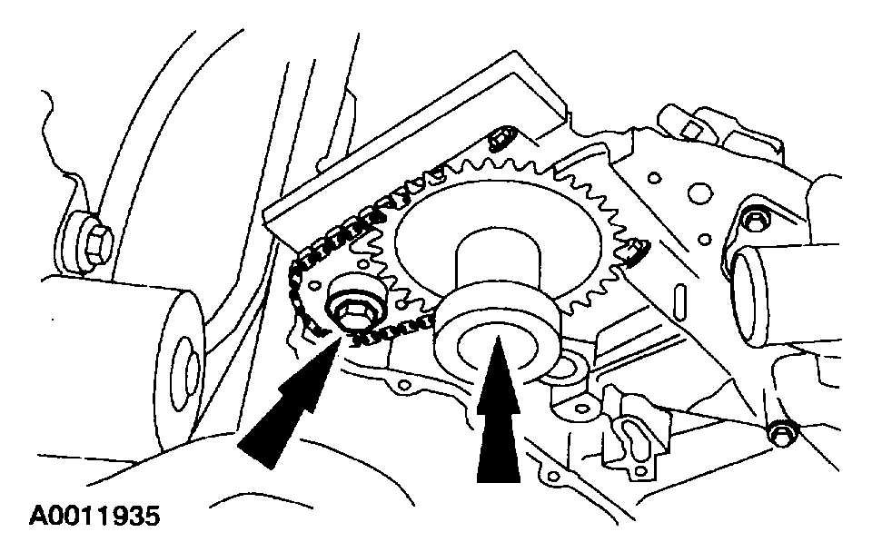

pic 3
4. NOTE: There is one window on the ignition pulse wheel that is unique to accept the special tool.
Install the special tool.
- Turn the crankshaft to 45 degrees ATDC. The crankshaft keyway will be in the 6 o'clock position.
- Install the special tool.

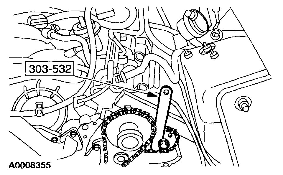

pic 4
6. Make sure the lobes of the camshaft are facing upwards. If not, repeat Step 4.

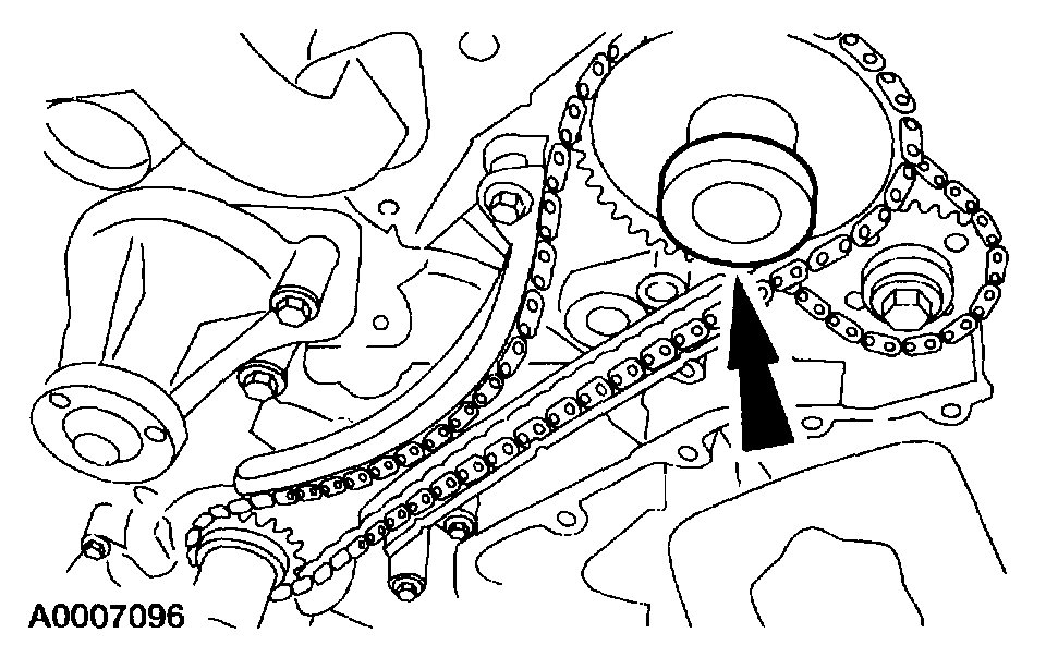

pic 5
7. Install the special tool on the RH cylinder head.

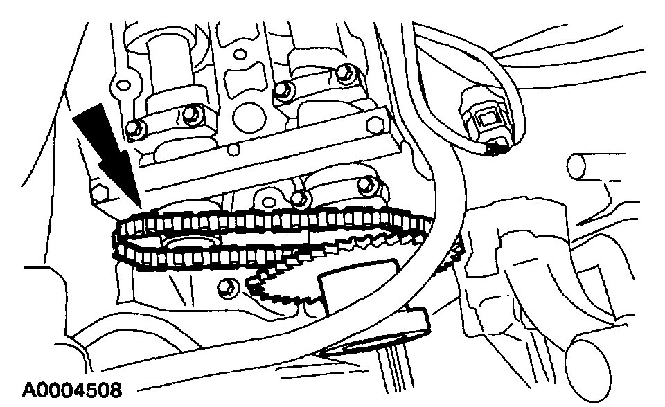

pic 6
8. Loosen the exhaust camshaft sprocket bolt.
pic 7
9. Loosen the intake camshaft sprocket bolt and slide the camshaft sprockets forward on the bolts.
pic 8
10. Remove the RH timing chain tensioner and blanking plate.
pic 9
11. Remove the tensioner arm.
pic 10
12. Remove the timing chain guide.
pic 11

18. Remove the LH timing chain tensioner and blanking plate.
pic 17

1. Reset the timing chain tensioners.
- Insert a fine wire and dislodge the check ball.
- Using finger pressure, compress the tensioner.
- Remove the wire.
pic 21
2. NOTE: If the timing mark on the LH timing chain crankshaft gear is facing toward the rear of the engine, install the RH timing chain crankshaft gear with the mark facing forward. If the timing mark on the LH timing chain crankshaft gear is facing toward the front of the engine, install the RH timing chain crankshaft gear with the mark facing toward the rear of the engine.
NOTE: The camshaft holding tool should still be installed on the LH cylinder head.
Position the LH timing chain and crankshaft gear.
- Position the timing chain over the LH intake camshaft sprocket.
- Position the crankshaft gear in the timing chain.
- Position the timing chain and crankshaft gear over the crankshaft as an assembly.

3. Install the LH timing chain guide.
pic 23
4. Install the LH timing chain tensioner arm.
pic 24
5. CAUTION: The orientation of the blanking plate must be as shown or the oil galley will not seal, resulting in low oil pressure and possible engine damage.
Install the LH timing chain tensioner.
- Position the blanking plate.
- Install the LH timing chain tensioner and blanking plate.

6. Install a tie strap to take up the slack in the timing chain.

Here are the directions for replacing the secondary timing chains.
Secondary
Vehicle Engine, Cooling and Exhaust Engine Timing Components Service and Repair Procedures Secondary
SECONDARY
Timing Drive Components-Secondary
Removal
NOTE: The RH secondary timing chains are shown; the LH secondary timing chains are similar.
1. Remove the primary timing chains.
pic 39
2. Remove the exhaust sprocket bolt.
pic 40
3. Remove the intake sprocket bolt and remove the camshaft damper.
pic 41
4. Remove the sprockets, damper, and chain as an assembly.
pic 42
5. Remove the secondary timing chain tensioner bolts.
pic 43
6. Remove the tensioner.
Installation
pic 44
1. Collapse the tensioners.
- Insert a thin wire into the check valve.
- Apply hand pressure until the tensioner is fully collapsed.
- Remove the wire.
pic 45
2. Position the tensioner.
pic 46
3. Install the timing chain tensioner bolts.
pic 47
4. Position the intake sprocket, damper, chain and exhaust sprocket on the intake camshaft as an assembly.
pic 48
5. Loosely install the intake and exhaust sprocket bolts.
