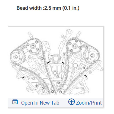

How many labor hours does it call for to replace a timing kit?
2014 HYUNDAI SANTA FE
100,000 MILES • 3.3L

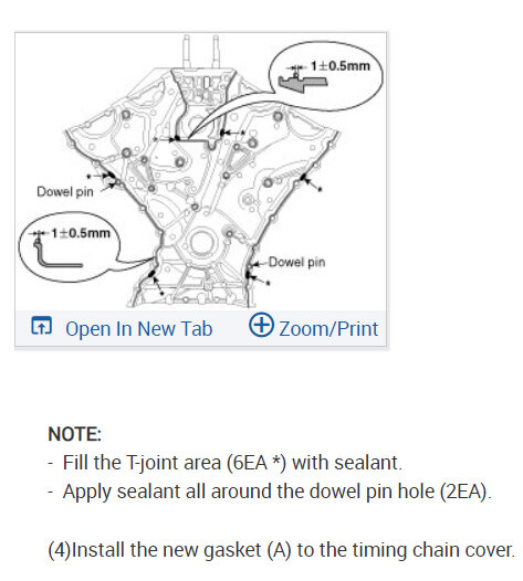

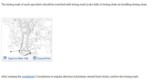

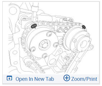

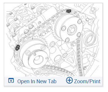

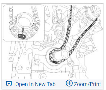

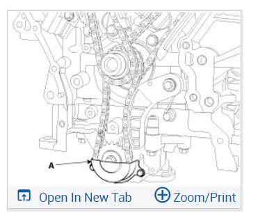

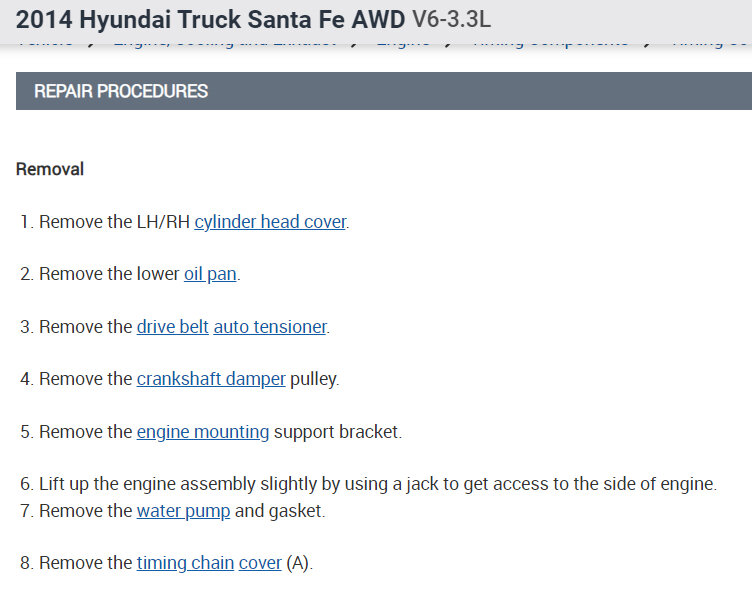

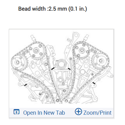

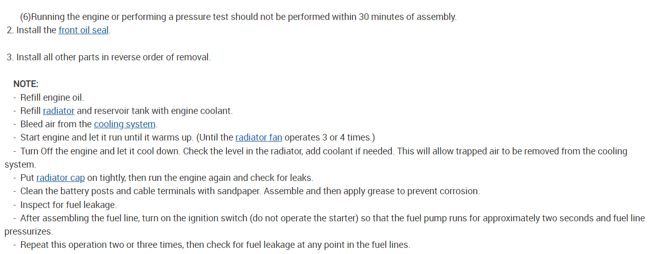

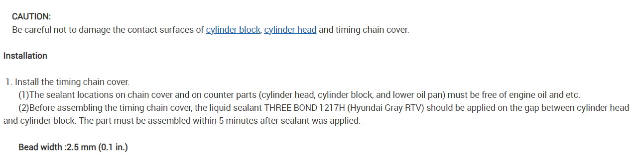

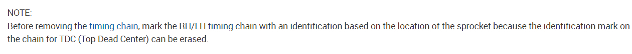

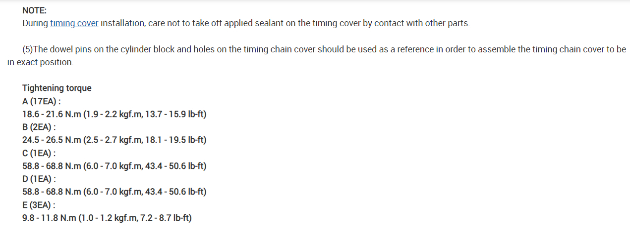

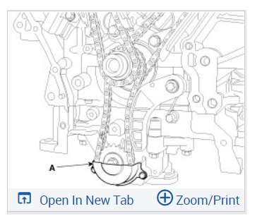

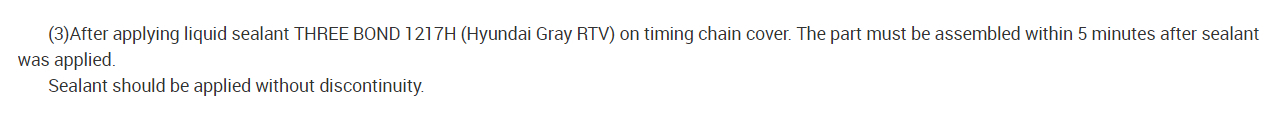

can I get instructions on how to do the job?
Dec 30, 2023 at 5:46 AM
Experienced Mechanic
55,588 POSTS

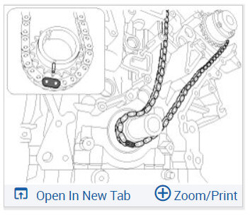

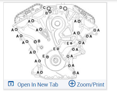

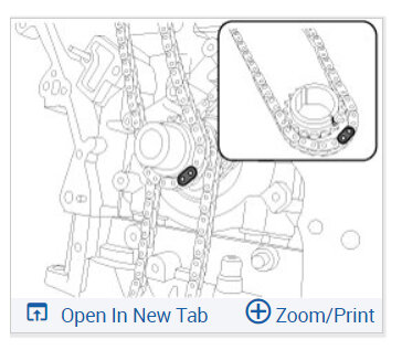

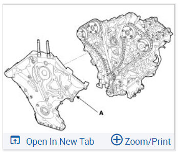

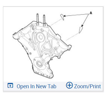

Here is how to change out the timing chain and guides with the timing chain alignment marks. Check out the images (below). Let us know if you need anything else.
Images (Click to enlarge)
