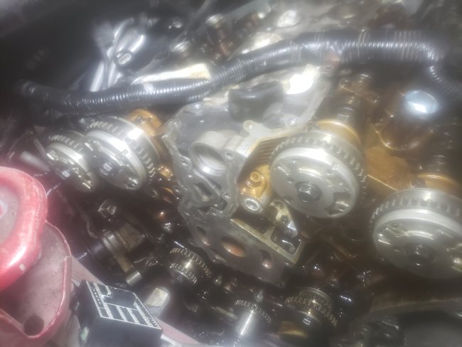

I'm getting ready to redo the timing alignment. i'm in stage one timing is there where everything should be? Brand new guides as well.
Sep 5, 2020 at 9:03 AM
JESSESLVN1994
  • 18 POSTS
Cam flats where the cam holders go are all flat facing up right now.

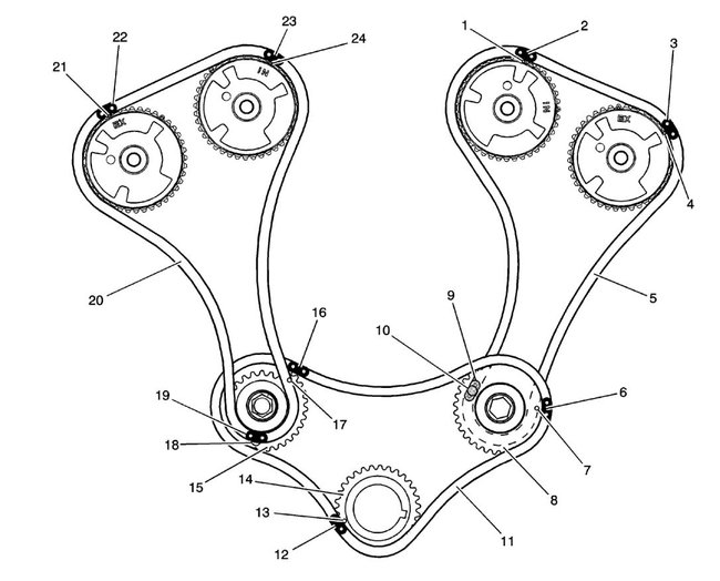

These are the alignment locations for the stages. Once you have everything in place and the tensioners installed you should be able to rotate the engine clockwise as the tensioners are on the slack side.

I'm on stage one now and everything is exact as the pictures.

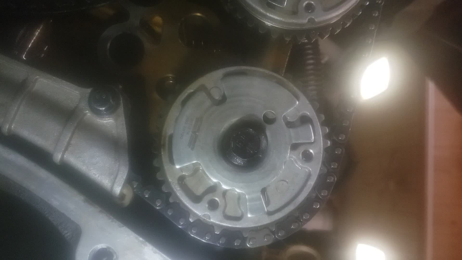

Here is what it is doing getting slack on the exhaust side guide when tensioner compresses:
Sep 5, 2020 at 10:31 AM
JESSESLVN1994
  • 18 POSTS
You can see how far the black guide sucks in in the very left corner when it compress.
Sep 5, 2020 at 10:33 AM
STEVE W.
  • 15,410 POSTS
That definitely isn't correct. It almost looks like the chain and sprocket are not the same pitch. Where did you get the parts from?

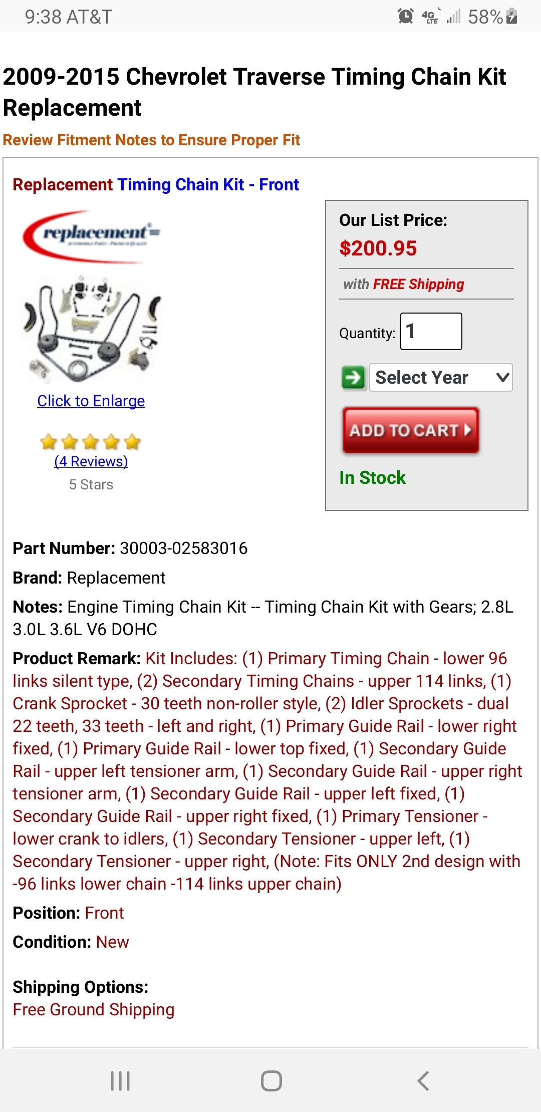

Parts geek says it's right part number, but seems to be the only thing it can be is the chains doesn't sit on the gears far enough so it jumps off.
Sep 5, 2020 at 12:37 PM
JESSESLVN1994
  • 18 POSTS
Here's the info:
Sep 5, 2020 at 12:43 PM
STEVE W.
  • 15,410 POSTS
It may be the correct part number but not the best quality parts. With the way the parts have been going it's hard to trust any of them anymore. I've seen some of the aftermarket kits replaced in under 10,000 because the parts were very poor quality. I try to only use the newer parts directly from GM on the 3.6 because they have updated them a few times. The current GM kit number is 12700436.

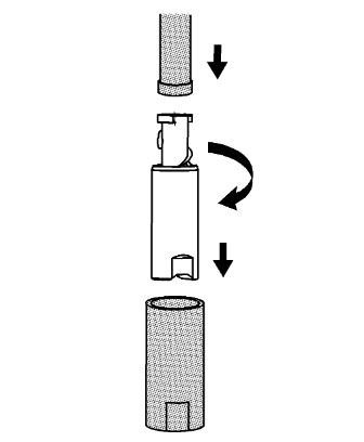

What was the reason for the repair? Timing codes, chain damage? I cannot think of anything that would really cause this issue if the parts are correct unless the tensioner is not holding as it should. When the pin was released it should have ratcheted out and locked. Then once the engine starts oil pressure acts on it and will tighten it as needed. Is it only the tensioner that is moving or are the guides flexing? Did the kit include new tensioners or are you using the old ones? If they are the old ones how did you retract them? If new you may want to take it apart and see if it is assembled correctly. It shouldn't retract easily once it extends.

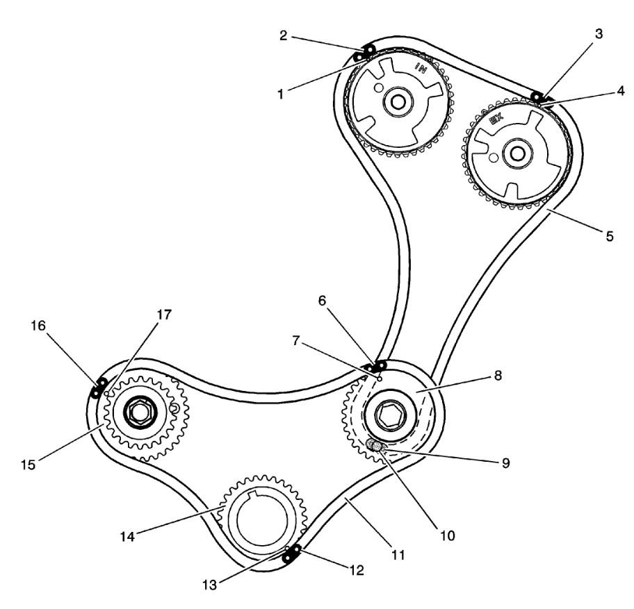

Using the second image I posted above of the chains in position do they match up with this stage 2 list?
1 - Left Intake Camshaft Position (CMP) Actuator Timing Mark- Circle
2 - Left Intake Secondary Camshaft Timing Drive Chain Timing Link
3 - Left Exhaust Secondary Camshaft Timing Drive Chain Timing Link
4 - Left Exhaust Camshaft Position (CMP) Actuator Timing Mark- Circle
5 - Left Secondary Camshaft Timing Drive Chain
6 - Primary Camshaft Drive Chain Timing Link for the Left Primary Camshaft Intermediate Drive Chain Sprocket
7 - Left Primary Camshaft Intermediate Drive Chain Sprocket Timing Mark for the Primary Camshaft Drive Chain
8 - Left Primary Camshaft Intermediate Drive Chain Sprocket
9 - Left Secondary Camshaft Timing Drive Chain Timing Link for the Left Primary Camshaft Intermediate Drive Chain Sprocket, behind hole in sprocket
10 - Left Primary Camshaft Intermediate Drive Chain Sprocket Timing Window
11 - Primary Camshaft Drive Chain
12 - Primary Camshaft Drive Chain Timing Link for the Crankshaft Sprocket
13 - Crankshaft Sprocket Timing Mark
14 - Crankshaft Sprocket
15 - Right Primary Camshaft Intermediate Drive Chain Sprocket
16 - Primary Camshaft Drive Chain Timing Link for the Right Primary Camshaft Intermediate Drive Chain Sprocket
17 - Right Primary Camshaft Intermediate Drive Chain Sprocket Timing Mark for the Primary Camshaft Drive Chain
18 - Right Primary Camshaft Intermediate Drive Chain Sprocket Timing Mark/Window for the Right Secondary Camshaft Timing Drive Chain
19 - Right Secondary Camshaft Timing Drive Chain Timing Link for the Right Primary Camshaft Intermediate Drive Chain Sprocket
20 - Right Secondary Camshaft Timing Drive Chain
21 - Right Exhaust Camshaft Position (CMP) Actuator Timing Mark- Triangle
22 - Right Exhaust Secondary Camshaft Timing Drive Chain Timing Link
23 - Right Intake Secondary Camshaft Timing Drive Chain Timing Link
24 - Right Intake Camshaft Position (CMP) Actuator Timing Mark- Triangle
Also try rotating the engine the other direction and see if the chain stays tight, just to see if there is a different problem. Keep in mind that on this engine you set the chains in position, release the tensioner and then button it up. Rotating the engine to verify timing positions isn't normally done on that engine as the chains are all different and won't line up again. However the tensioner still shouldn't pop in like that.
