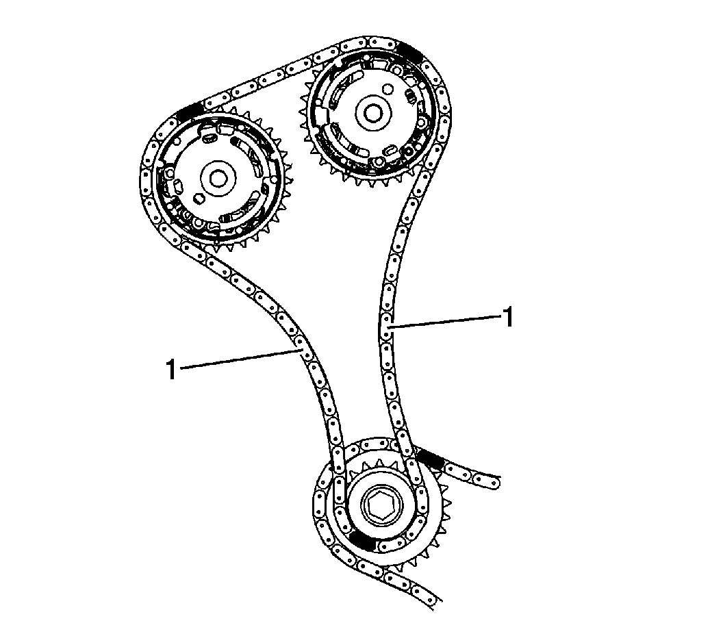

Timing chain ID
SKULLJER
  • 2005 CADILLAC CTS
  • 3.6L
  • 6 CYL
  • 2WD
  • 130,000 MILES
Well, beings the car is a 2005 I would think it has a first design timing chain setup, but from what I am gathering from trying to purchase a timing kit on Ebay, the first design has roller cam chains and a silent link primary chain. But my setup on my 2005, VIN 7 3.6 has all three of the silent link style chains which I think I found but then they describe the primary chain having 96 links and the cam chains having 114 links. My primary chain has 48 links and cam chains have 57 links. I cannot find anything setup like I have. What is the deal?
Sunday, March 17th, 2019 AT 9:02 PM
3 Replies
  • 109,885 POSTS
Welcome to 2CaroPros.
I looked up the OEM part numbers for you. Use them to cross reference chains from other manufacturer's.
As far as getting the part online, buyer beware. You don't want to get the wrong or a cheap duplicate of this one. I have a feeling you are seeing the timing chains for other engines that came in the vehicle.
Here are the OEM numbers:
12590920 is the primary
12589011 Is the secondary.

I don't know if you need it, but here are the directions for replacement. It is broken down to left and right secondary and primary. The attached pictures correlate with these directions.
I will separate each one to help avoid confusion.
_________________________________________________

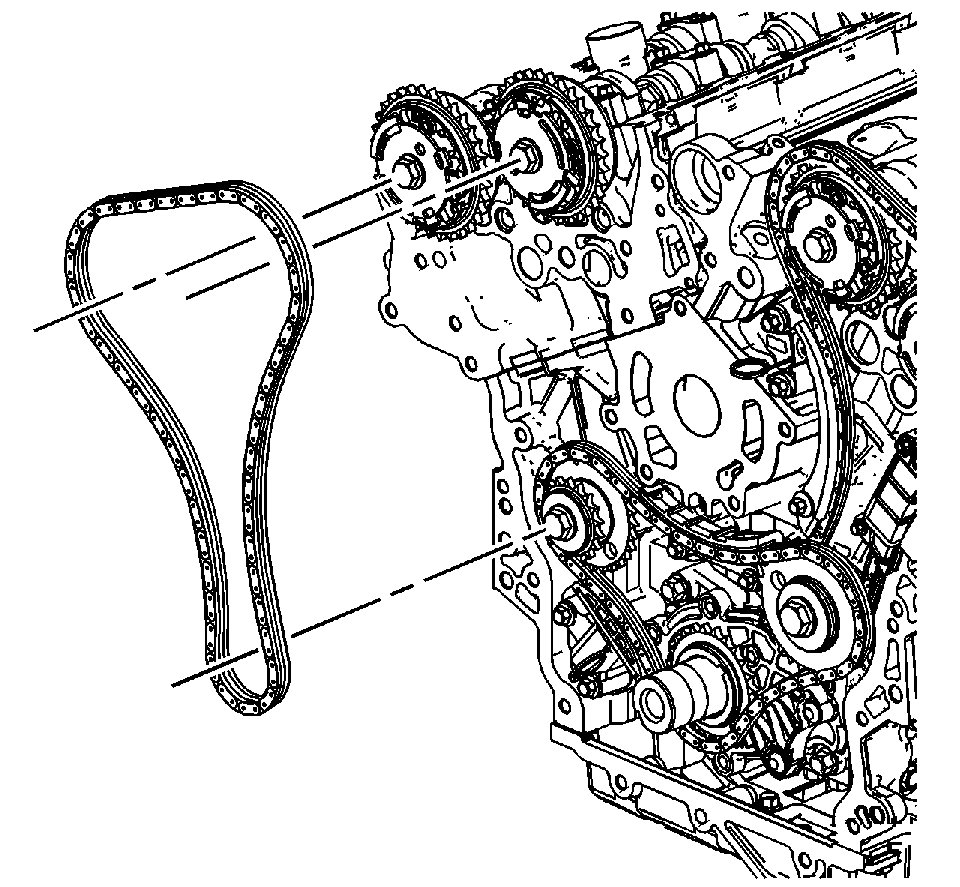

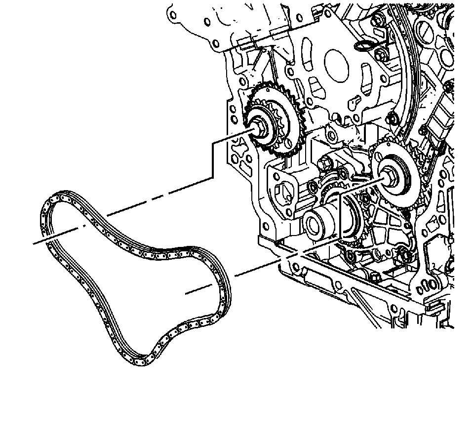

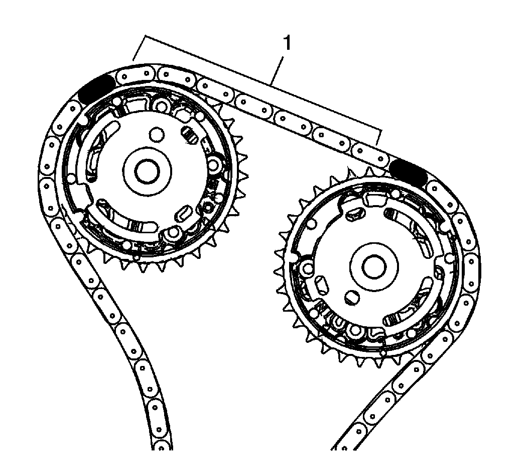

SECONDARY CAMSHAFT INTERMEDIATE DRIVE CHAIN REPLACEMENT - LEFT
Removal Procedure
1. Remove the engine front cover. See: Timing Cover > Procedures > Engine Front Cover Replacement
2. Remove the right bank secondary camshaft drive chain tensioner. See: Engine > Overhaul > 23. Secondary Timing Chain Tensioner Removal - Right
3. Remove the right bank secondary camshaft drive chain shoe. See: Engine > Overhaul > 24. Secondary Camshaft Drive Chain Shoe Removal - Right
4. Remove the right bank secondary camshaft drive chain guide. See: Engine > Overhaul > 25. Secondary Timing Chain Guide Removal - Right
5. Remove the right bank secondary camshaft drive chain. See: Engine > Overhaul > 26. Secondary Camshaft Intermediate Drive Chain Removal - Right
6. Remove the primary camshaft drive chain tensioner. See: Engine > Overhaul > 27. Primary Camshaft Intermediate Drive Chain Tensioner Removal
7. Remove the primary upper camshaft drive chain guide. See: Engine > Overhaul > 28. Primary Timing Chain Guide Removal - Upper
8. Remove the primary camshaft drive chain. See: Engine > Overhaul > 30. Primary Camshaft Intermediate Drive Chain Removal
9. Remove the right bank camshaft intermediate drive chain idler. See: Engine > Overhaul > 31. Timing Chain Idler Sprocket Removal - Right
10. Remove the left bank secondary camshaft drive chain tensioner. See: Engine > Overhaul > 32. Secondary Timing Chain Tensioner Removal - Left
11. Remove the left bank secondary camshaft drive chain shoe. See: Engine > Overhaul > 33. Secondary Camshaft Drive Chain Shoe Removal - Left
12. Remove the left bank secondary camshaft drive chain guide. See: Engine > Overhaul > 34. Secondary Timing Chain Guide Removal - Left

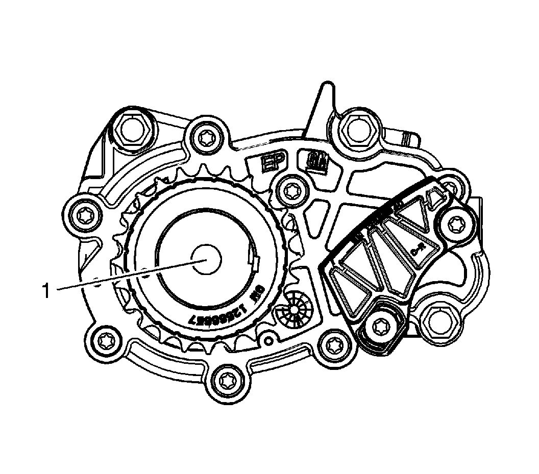

13. Remove the left bank camshaft intermediate drive chain idler. See: Engine > Overhaul > 36. Timing Chain Idler Sprocket Removal - Left
See Picture 1
14. Remove the left bank secondary camshaft drive chain. See: Engine > Overhaul > 35. Secondary Camshaft Intermediate Drive Chain Removal - Left
15. Clean and inspect all of the camshaft timing drive components. Replace components as necessary. See: Engine > Overhaul > 71. Camshaft Timing Drive Components Clean and Inspect
Installation Procedure
See Picture 1
1. Install the left bank secondary camshaft drive chain. See: Engine > Overhaul > 116. Secondary Camshaft Intermediate Drive Chain Installation - Left
2. Install the left bank camshaft intermediate drive chain idler. See: Engine > Overhaul > 115. Timing Chain Idler Sprocket Installation - Left
3. Install the left bank secondary camshaft drive chain guide. See: Engine > Overhaul > 117. Secondary Timing Chain Guide Installation - Left
4. Install the left bank secondary camshaft drive chain shoe. See: Engine > Overhaul > 118. Secondary Camshaft Drive Chain Shoe Installation - Left
5. Install the left bank secondary camshaft drive chain tensioner. See: Engine > Overhaul > 119. Secondary Timing Chain Tensioner Installation - Left
6. Install the right bank camshaft intermediate drive chain idler. See: Engine > Overhaul > 120. Timing Chain Idler Sprocket Installation - Right
7. Install the primary camshaft drive chain. See: Engine > Overhaul > 121. Primary Camshaft Intermediate Drive Chain Installation
8. Install the primary upper camshaft drive chain guide. See: Engine > Overhaul > 123. Primary Timing Chain Guide Installation - Upper
9. Install the primary camshaft drive chain tensioner. See: Engine > Overhaul > 124. Primary Camshaft Intermediate Drive Chain Tensioner Installation
10. Install the right bank secondary camshaft drive chain. See: Engine > Overhaul > 125. Secondary Camshaft Intermediate Drive Chain Installation - Right
11. Install the right bank secondary camshaft drive chain guide. See: Engine > Overhaul > 126. Secondary Timing Chain Guide Installation - Right
12. Install the right bank secondary camshaft drive chain shoe. See: Engine > Overhaul > 127. Secondary Camshaft Drive Chain Shoe Installation - Right
13. Install the right bank secondary camshaft drive chain tensioner. See: Engine > Overhaul > 128. Secondary Timing Chain Tensioner Installation - Right
14. Install the engine front cover. See: Timing Cover > Procedures > Engine Front Cover Replacement

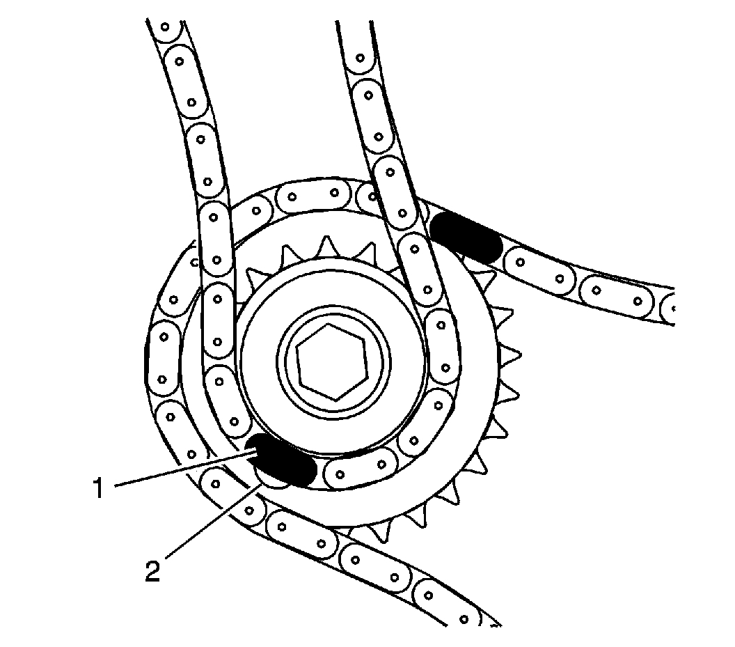

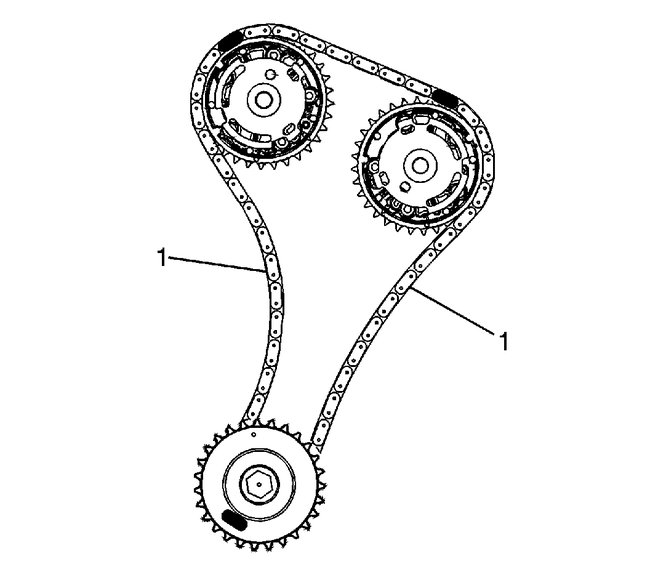

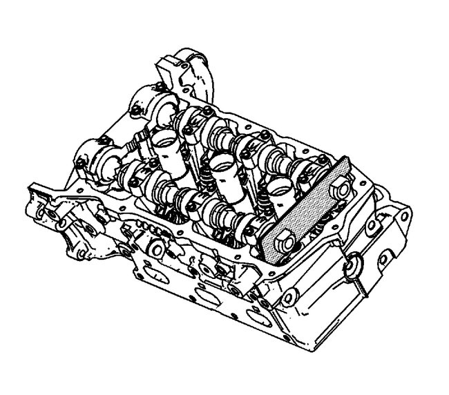

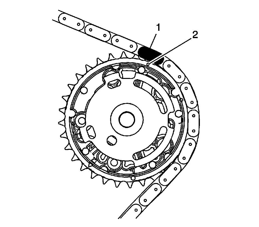

SECONDARY CAMSHAFT INTERMEDIATE DRIVE CHAIN REPLACEMENT - RIGHT
Removal Procedure
Picture 2
Picture 2
1. Install the right bank secondary camshaft drive chain. See: Engine > Overhaul > 125. Secondary Camshaft Intermediate Drive Chain Installation - Right
2. Install the right bank secondary camshaft drive chain guide. See: Engine > Overhaul > 126. Secondary Timing Chain Guide Installation - Right
3. Install the right bank secondary camshaft drive chain shoe. See: Engine > Overhaul > 127. Secondary Camshaft Drive Chain Shoe Installation - Right
4. Install the right bank secondary camshaft drive chain tensioner. See: Engine > Overhaul > 128. Secondary Timing Chain Tensioner Installation - Right
5. Install the engine front cover. See: Timing Cover > Procedures > Engine Front Cover Replacement

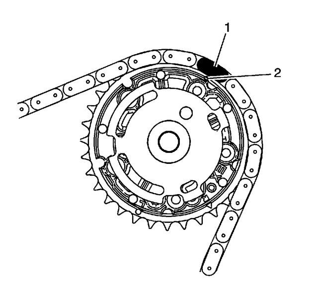

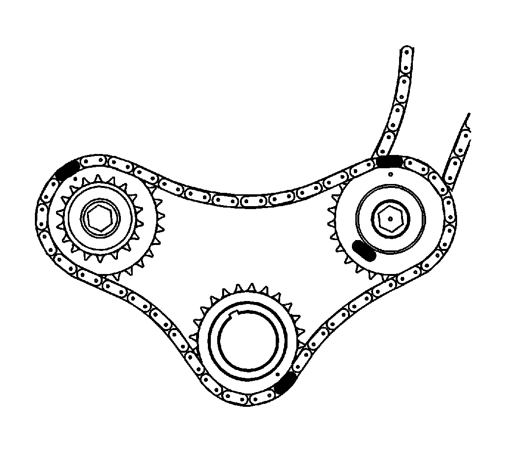

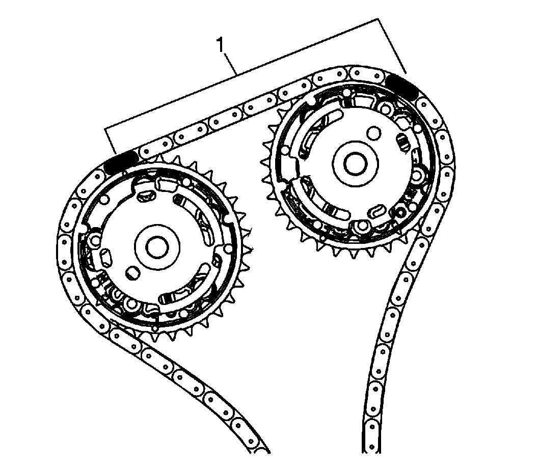

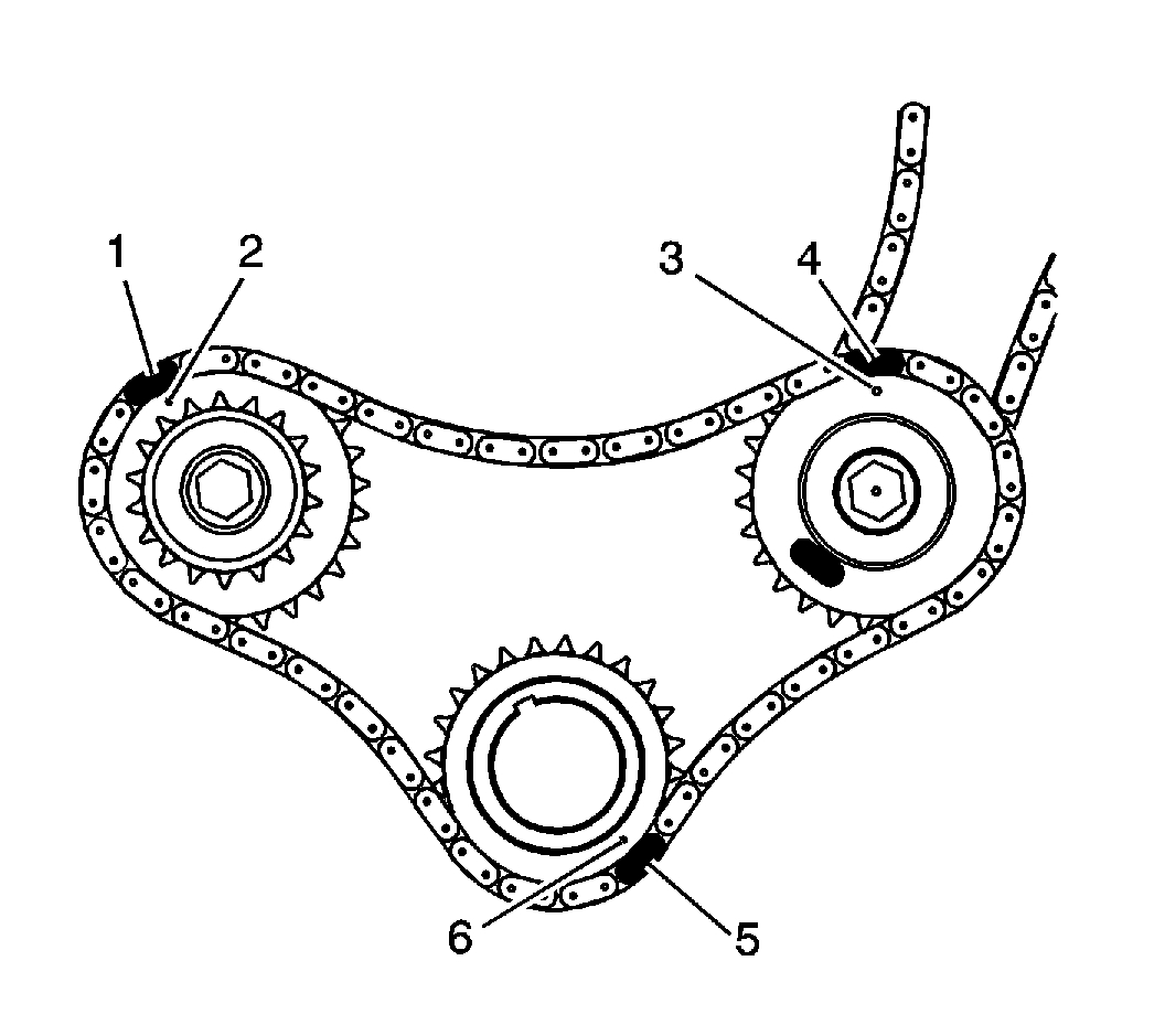

PRIMARY CAMSHAFT DRIVE CHAIN AND SPROCKETS REPLACEMENT
Removal Procedure
7. Remove the primary camshaft drive chain upper guide. See: Engine > Overhaul > 28. Primary Timing Chain Guide Removal - Upper
Picture 3
8. Remove the primary camshaft timing chain. See: Engine > Overhaul > 30. Primary Camshaft Intermediate Drive Chain Removal
Picture 3
1. Install the primary camshaft timing chain. See: Engine > Overhaul > 121. Primary Camshaft Intermediate Drive Chain Installation
2. Install the primary upper camshaft drive chain guide. See: Engine > Overhaul > 123. Primary Timing Chain Guide Installation - Upper
3. Install the primary camshaft drive chain tensioner. See: Engine > Overhaul > 124. Primary Camshaft Intermediate Drive Chain Tensioner Installation
4. Install the right bank secondary camshaft drive chain. See: Engine > Overhaul > 125. Secondary Camshaft Intermediate Drive Chain Installation - Right
5. Install the right bank secondary camshaft drive chain guide. See: Engine > Overhaul > 126. Secondary Timing Chain Guide Installation - Right
6. Install the right bank secondary camshaft drive chain shoe. See: Engine > Overhaul > 127. Secondary Camshaft Drive Chain Shoe Installation - Right
7. Install the right bank secondary camshaft drive chain tensioner. See: Engine > Overhaul > 128. Secondary Timing Chain Tensioner Installation - Right
8. Install the engine front cover. See: Timing Cover > Procedures > Engine Front Cover Replacement

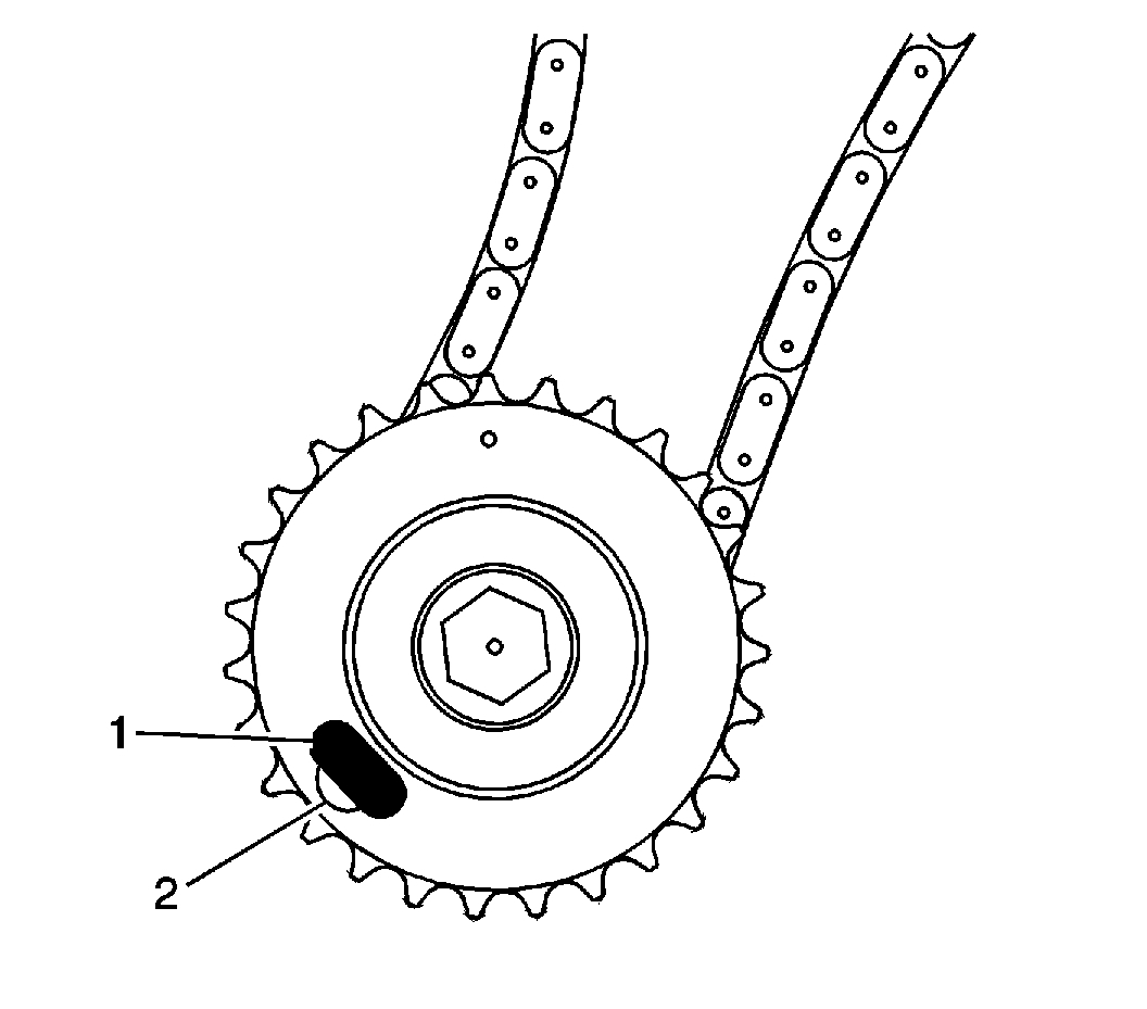

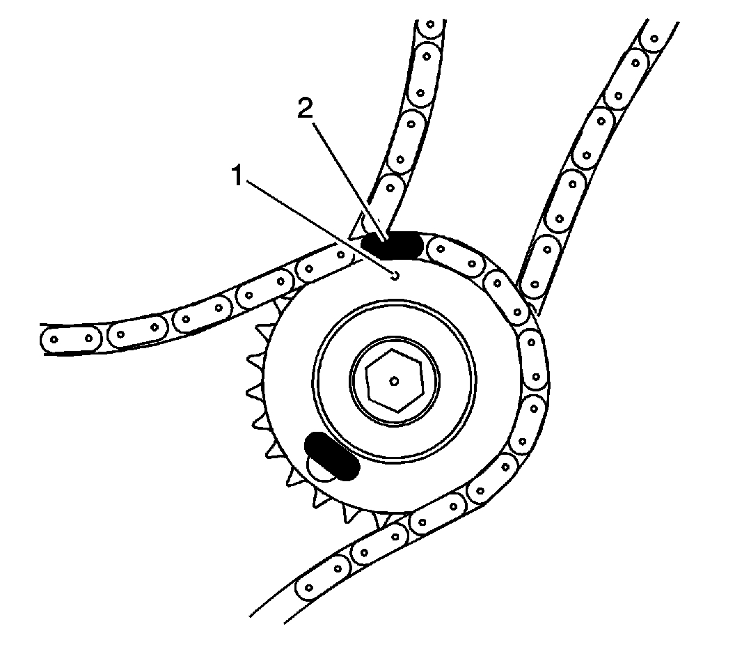

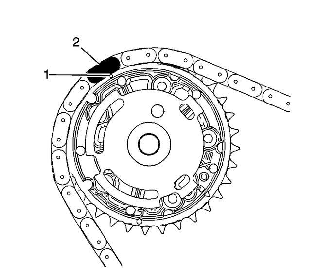

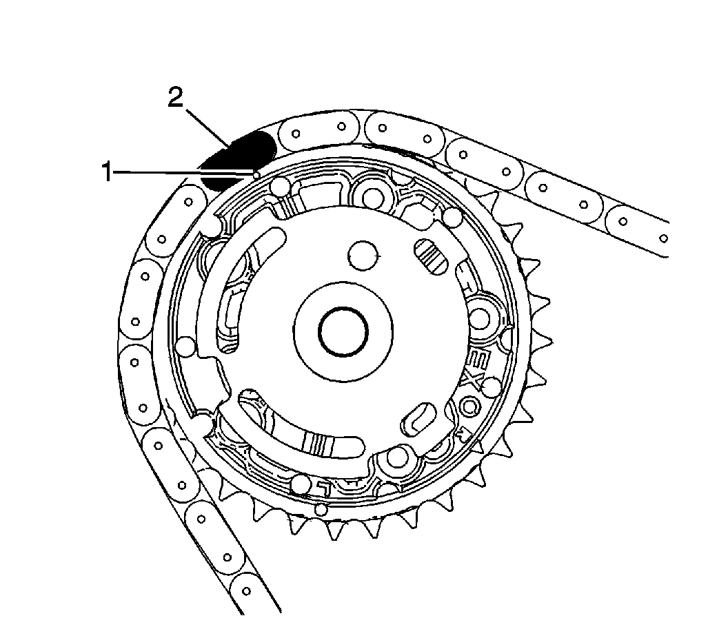

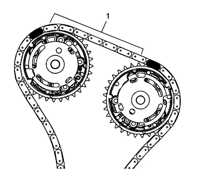

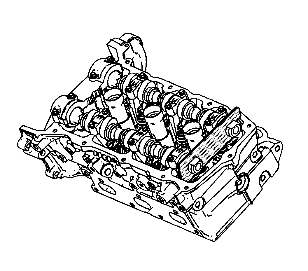

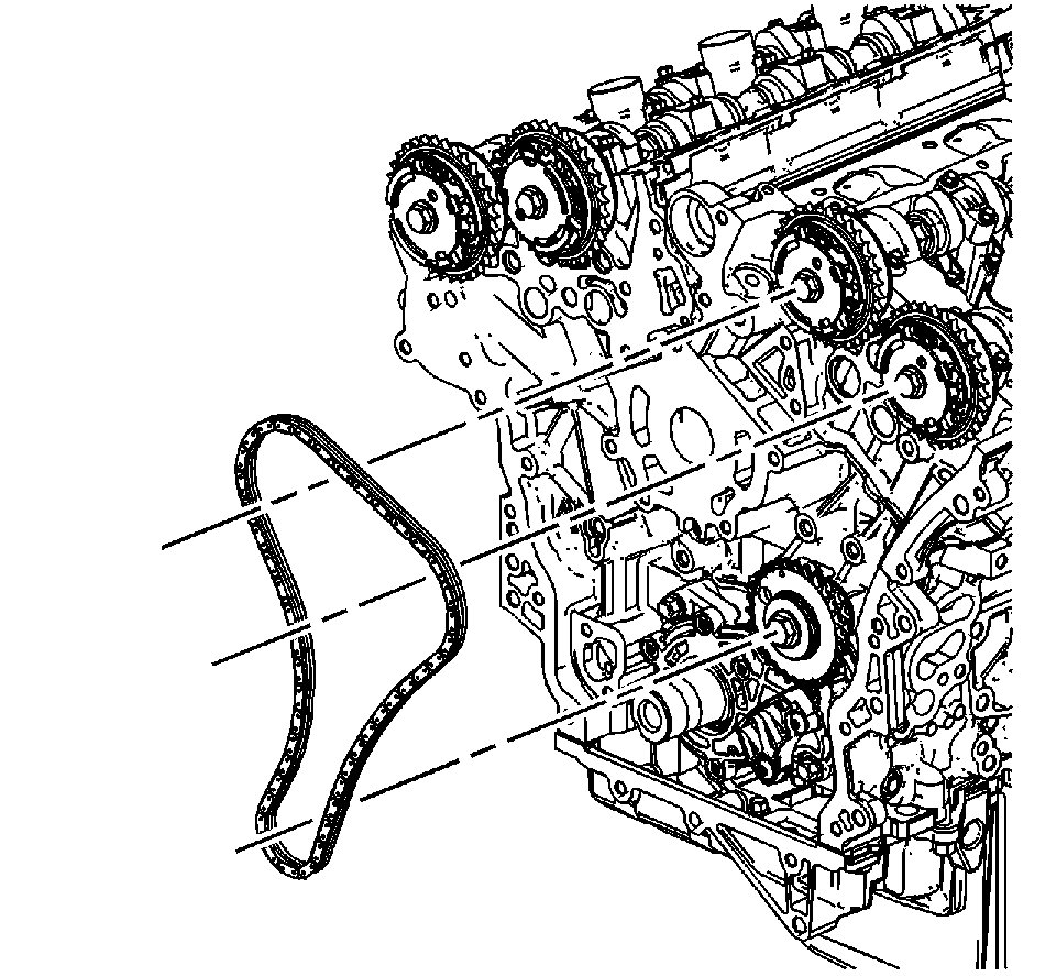

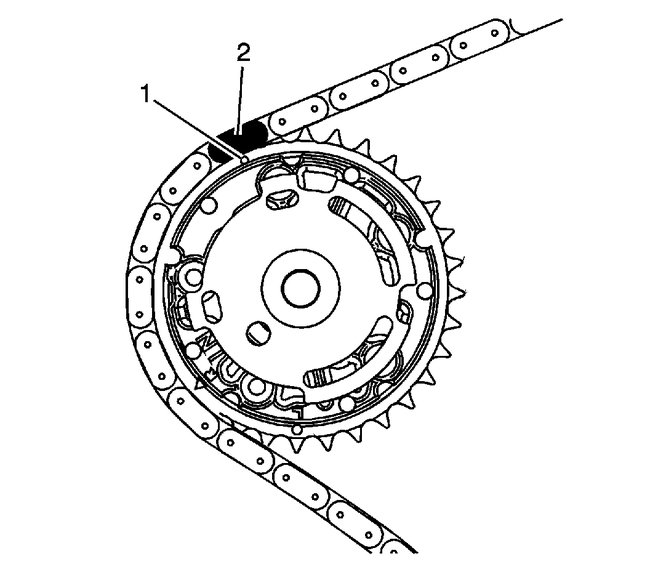

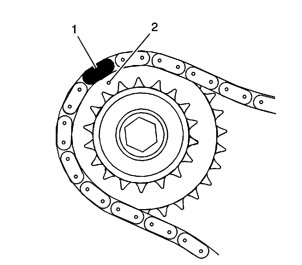

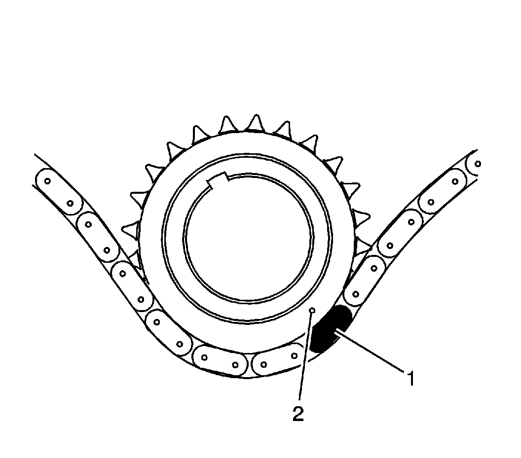

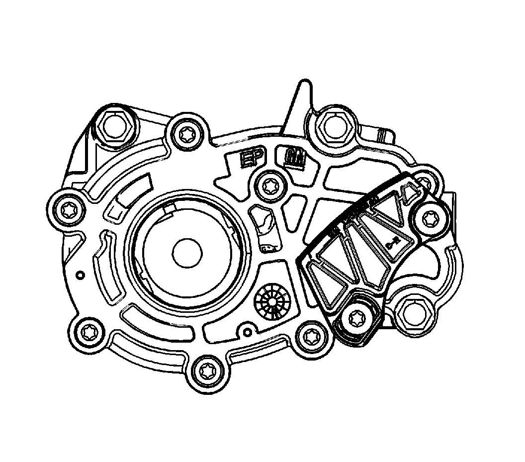

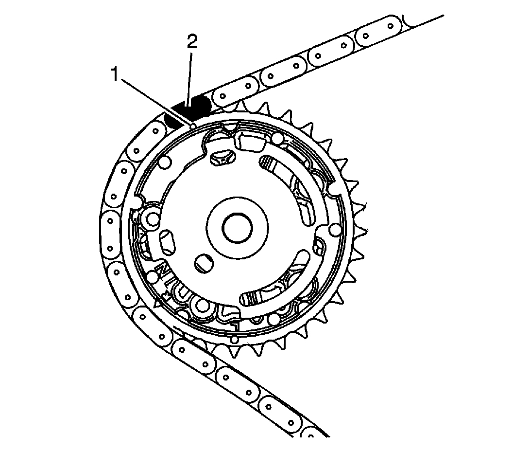

Pictures 4-7 show timing marks as a guide

Left cam timing procedure
116. SECONDARY CAMSHAFT INTERMEDIATE DRIVE CHAIN INSTALLATION - LEFT
Tools Required
EN 46105 Camshaft Holding Tool
EN 46111 Crankshaft Rotation Socket
Picture 8
1. Important: There should be no need to rotate the camshaft more than 10 degrees. Using the hex cast into the camshaft rotate the camshaft in order to install the EN 46105.
Install the EN 46105-1 onto the rear of the left camshafts.
2. Important: All camshafts must be locked in place before installation of any camshaft drive chains.
Ensure that the EN 46105-1 is fully seated onto the camshafts.

7. Ensure there are 7 links (1) between the timing camshaft drive chain links for the camshaft position actuator sprockets.
Picture 13
8. Align the left exhaust camshaft position actuator sprocket alignment circle mark (2) with the timing camshaft drive chain link (1).
Picture 14
9. Align the left intake camshaft position actuator sprocket alignment circle mark (1) with the timing camshaft drive chain link (2).
Picture 15
10. There will be 18 links (1) between the left camshaft intermediate drive chain idler timing secondary camshaft drive chain link and each left camshaft position actuator sprocket timing secondary camshaft drive chain link.

Monday, March 18th, 2019 AT 5:56 PM
SKULLJER
Thank you very much to take the time to get that information for me. So you only saw two different styles of chains for that 3.6 vin"7"? Not same style of chain with different lengths right? That is how they make it look. I know I should get all the components from the dealer but that $100.00 for the whole kit is too easy. I'm going to dump the car anyway. Thanks for the instructions on replacing that stuff but I am a master Technician, been doing this stuff for 35 years, Thanks again take care.
Monday, March 18th, 2019 AT 11:41 PM
  • 109,885 POSTS
Not a problem. I have to be honest, that's what it looks like to me. The part numbers I gave you are for the primary and secondary. That's all it lists.
Let me know if you need anything. However, it sounds like you got it under control.
