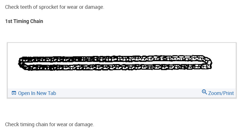

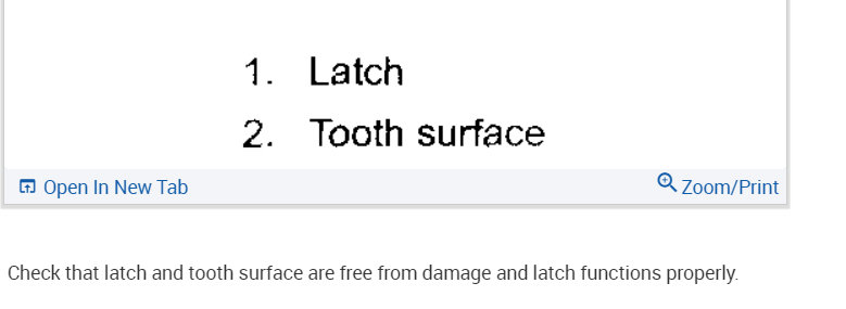

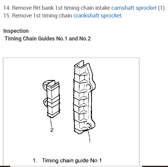

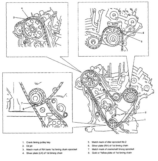

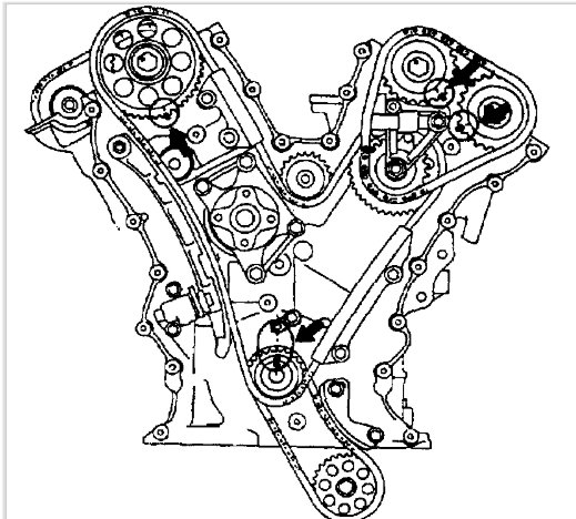

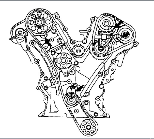

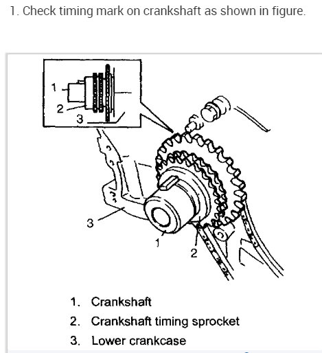

Please, I would love for someone to help me with vehicle listed timing chain marks diagram.
Jun 6, 2020 at 4:05 AM
DANNY L
  • 5,648 POSTS

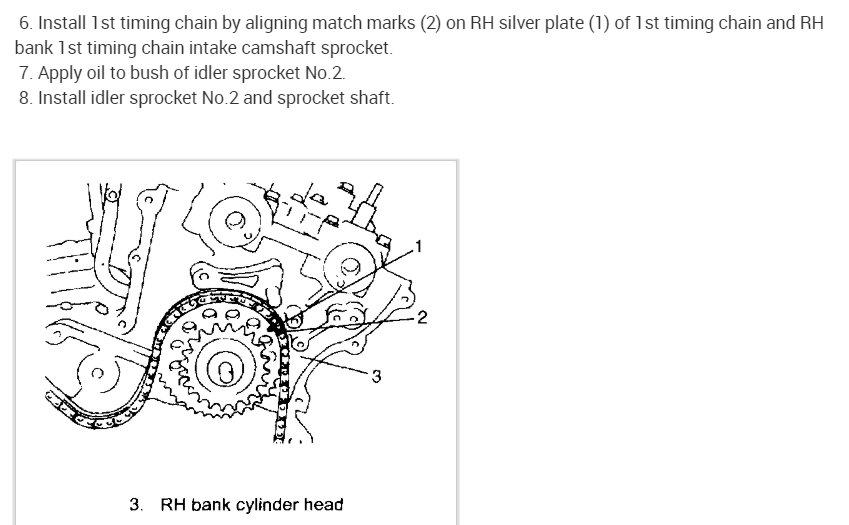

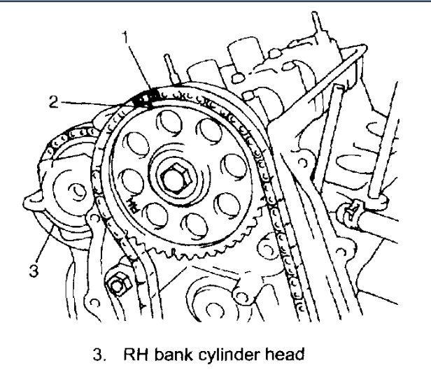

Hello, I'm Danny.

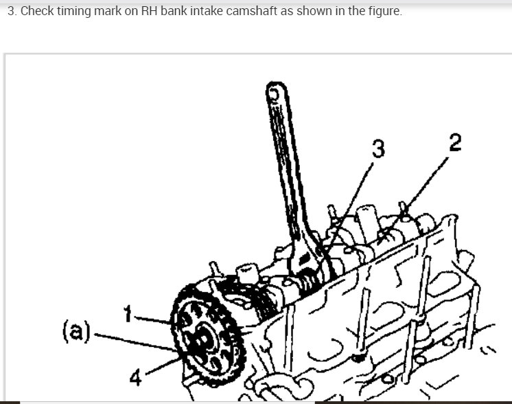

Here is the picture diagram of the timing marks you requested. The black marks are what you are looking for. I've attached the picture below.If you like I can also send you step by step picture instructions if you like.Hope this helps and thanks for using 2CarPros.
Jun 7, 2020 at 2:55 PM
BENJONES

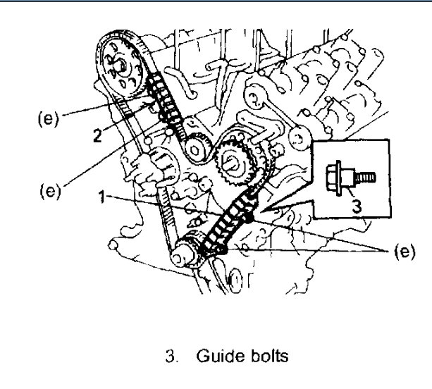

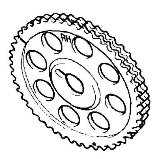

Thanks so much, Danny. I appreciate the time taken to get back to me. If you could also give me the step by step instructions with pictures attached, that would definitely go a long way. Thanks much.
Jun 8, 2020 at 5:49 AM

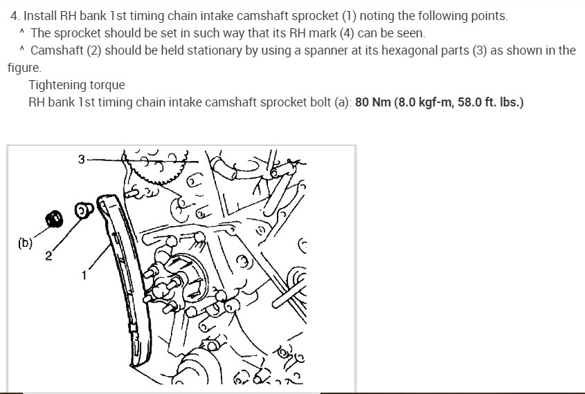

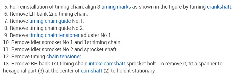

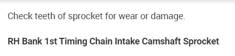

DANNY L
  • 5,648 POSTS

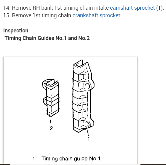

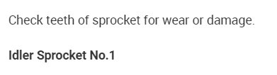

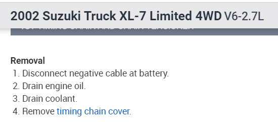

Hello again.

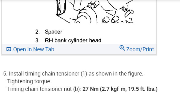

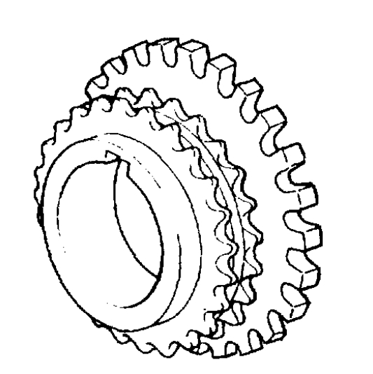

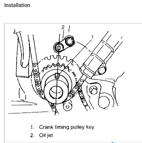

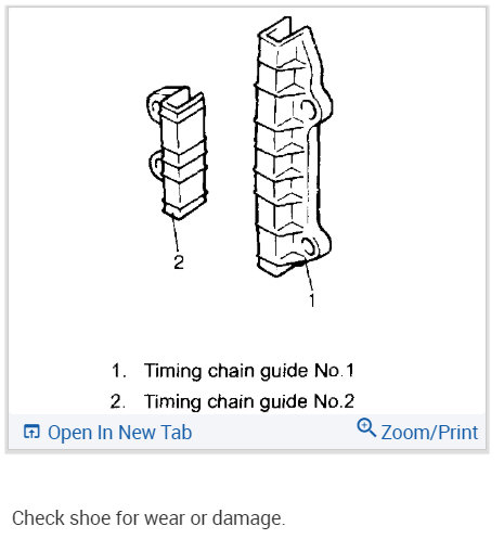

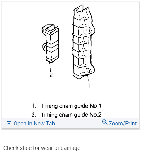

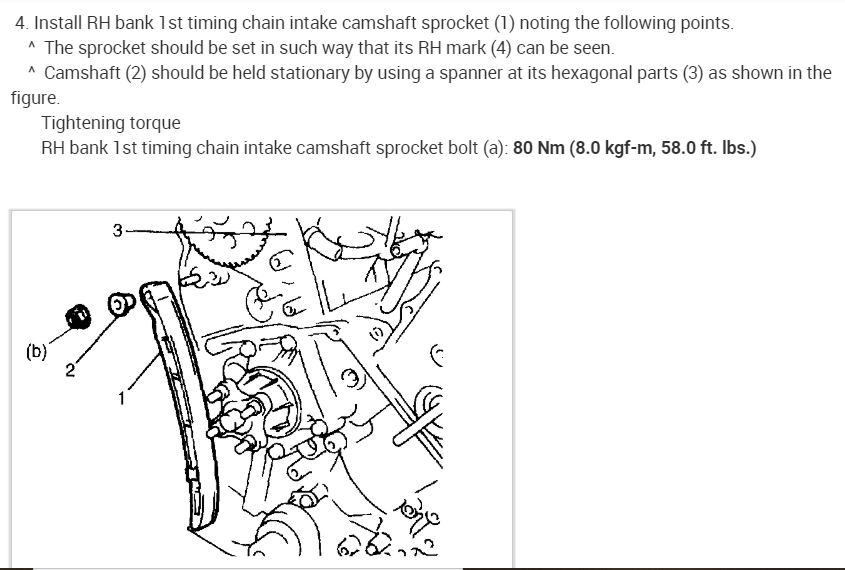

Here is Part 1 for removal. I'm attaching picture step by step instructions below for timing chain replacement.Hope this helps and thanks again for using 2CarPros.
Danny-
Jun 10, 2020 at 7:54 PM

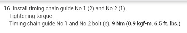

DANNY L
  • 5,648 POSTS

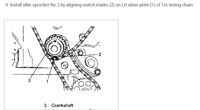

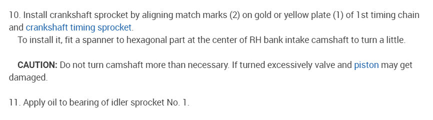

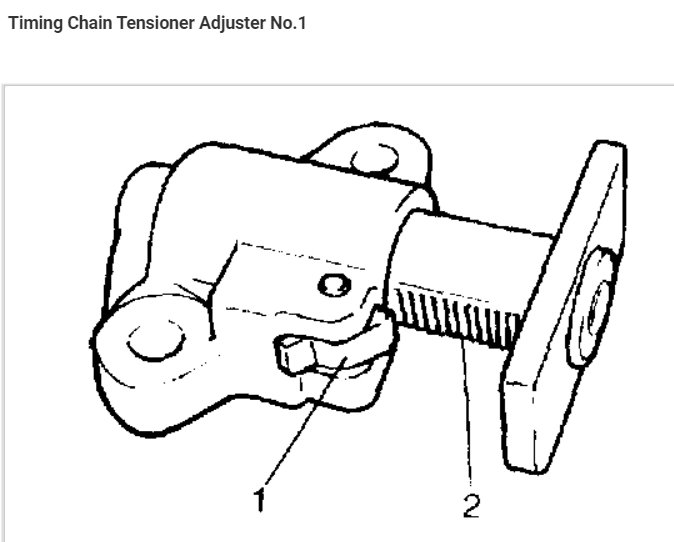

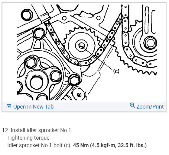

Hello again.

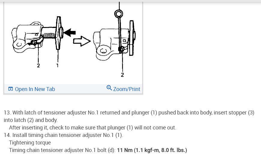

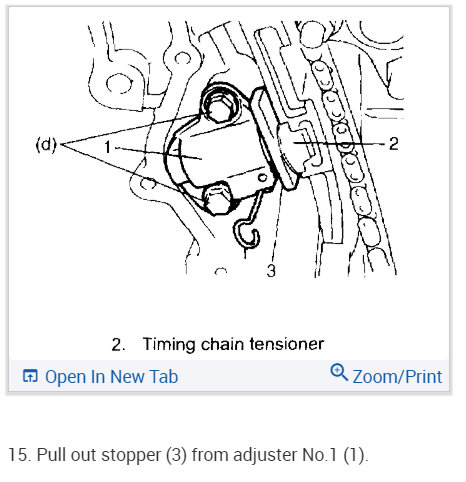

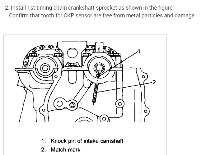

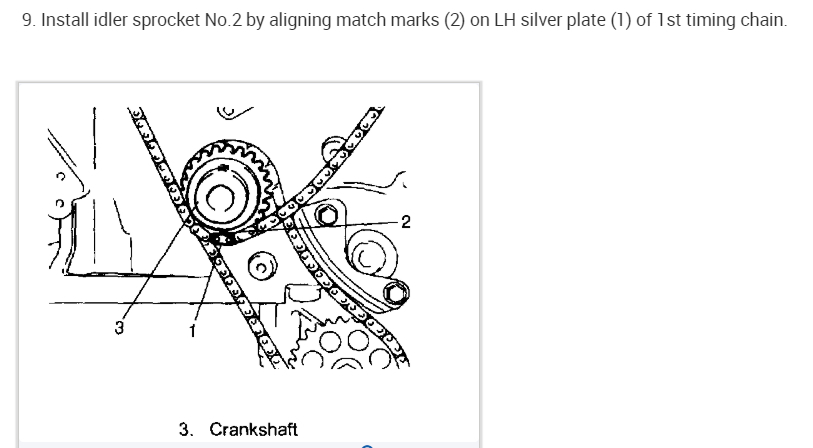

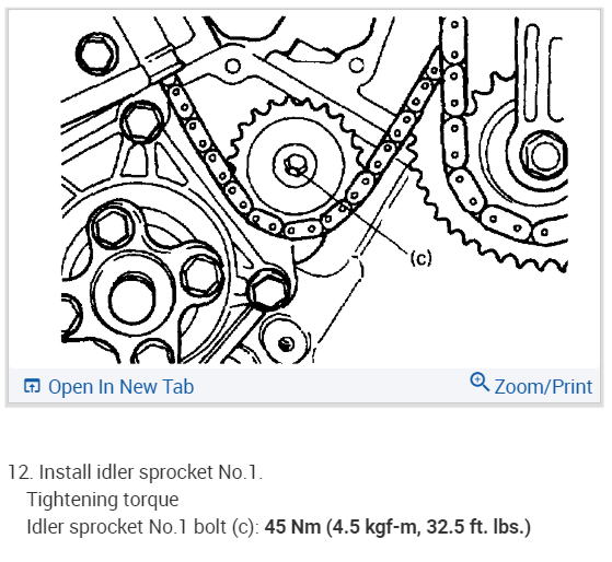

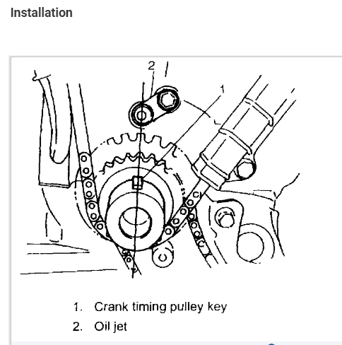

Here is the final Part 2 for installation. I've attached the remaining picture step by step instructions below. Let me know if you have any further questions about your timing chain issue.Hope this helps and thanks again for using 2CarPros.
