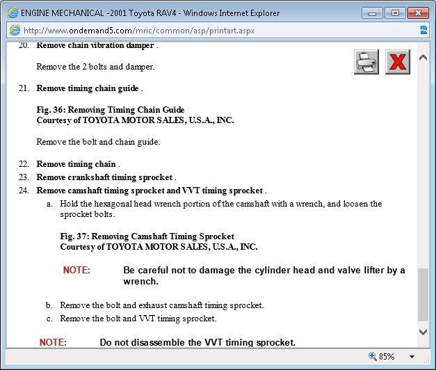

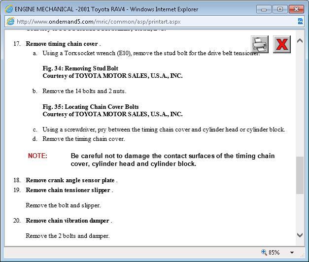

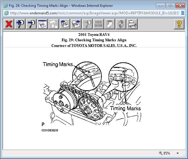

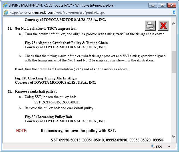

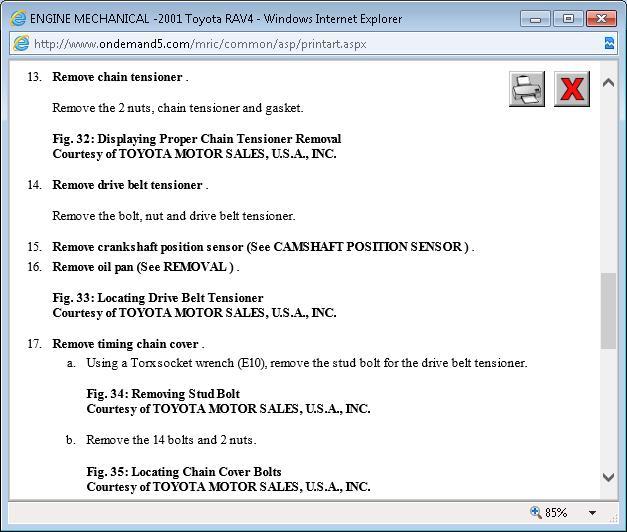

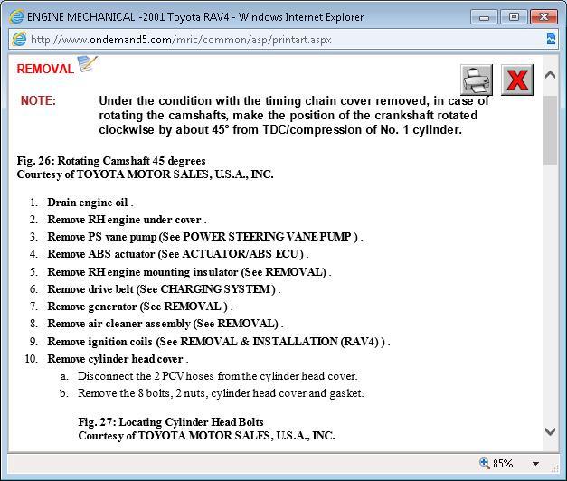

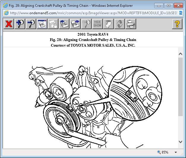

heres the timing marks for your car.I take that back I found in mention to off set the valves so you don't damage them while servicing the timing chain.Have you ever done anything like a timing chain job?

I posted the removal the timing chain its pretty straight forward.Its a lot more intailed then a older single cam American v8 engine.To answer your question it all depends on how many teeth the chain may have jumped if any damage was done to the valves.Lets start by checking the timing marks to see how far there off?Iam still working on the price to replace the chain.
