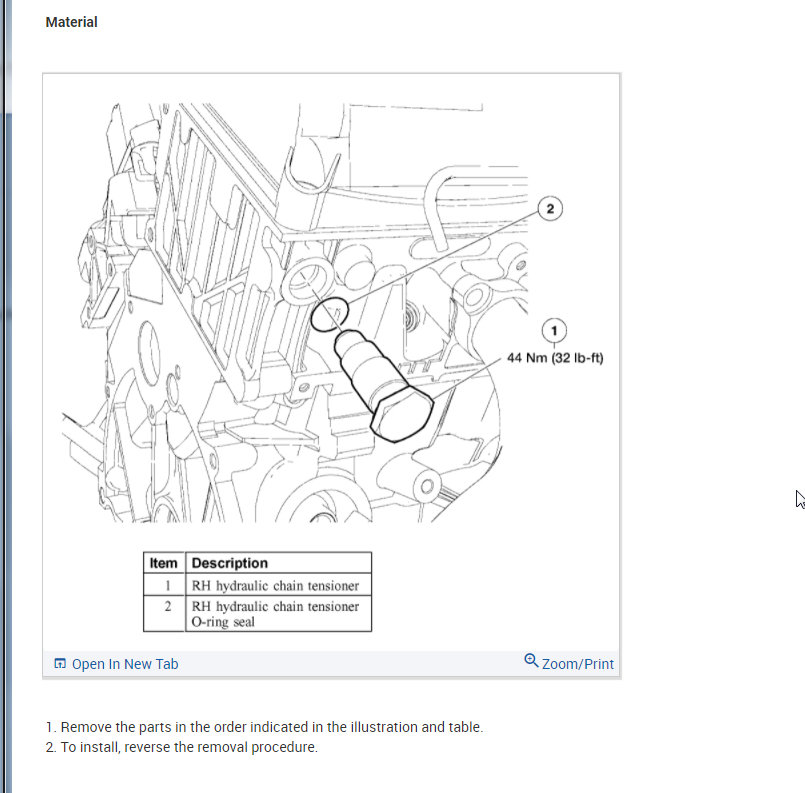

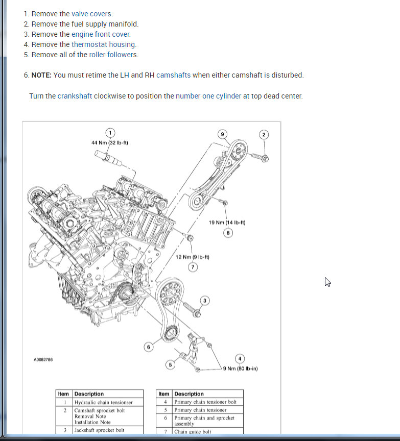

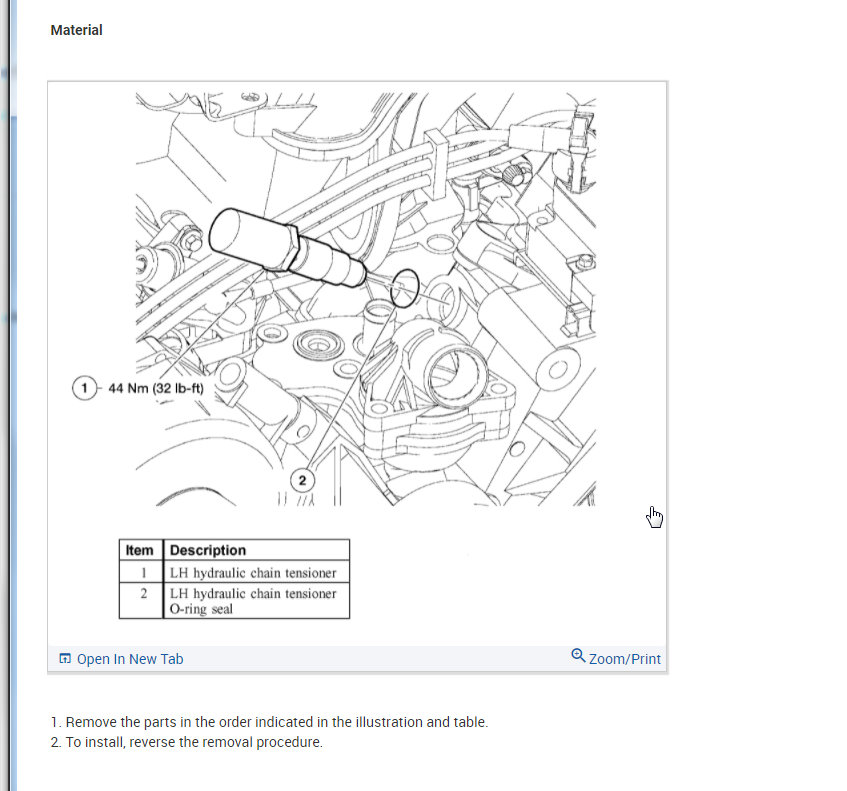

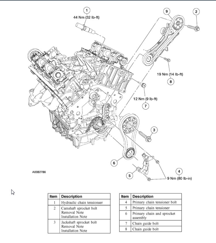

If my two front guides are broken should i replace all guides and both tensioners or should i only replace the two broken guides and tensioner? Or maybe the whole timing set since my engine has a lot of miles. If i should do all 3 would i have to remove my heads? I bought the rocker arm tool just in case but the wear pattern looks uneven. Should i replace those too?
Apr 28, 2021 at 8:01 AM
You do not have to replace the chains if just the guides broke however, I would replace all the guides and tensioners while you are there. The only time you need to do the chains is when there is an issue with them. I attached the process below on this so that you can review this material.
Please review this and let us know if you need other info. Thanks

I have all new cassettes and tensioners and guides. I removed the rear already but im waiting for the bolts to come. I did not remove the roller followers. Is that critical? Also, while im waiting for the bolts can I remove the other chains or do i need to do one at a time?

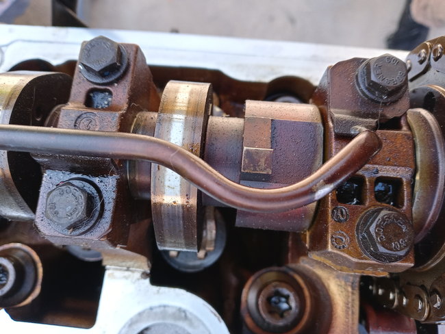

Also the wear pattern on the cam lobes is wobbly. Do i need new lifters? And does that mean new cam as well?
May 6, 2021 at 10:26 AM

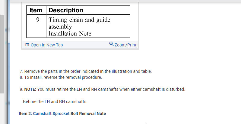

If you are setting the timing up again then you can remove any chain you want as it will have to be reset when you do.
It is hard to see the close up of the cam lobes but they don't look wiped out. Basically if they still have a lobe and are not grooved then they are okay. The lifters will be flattened and that means they need to be replaced.
However, if you are there and want to replace them, then I would do both, cam and lifters.
May 7, 2021 at 12:00 PM

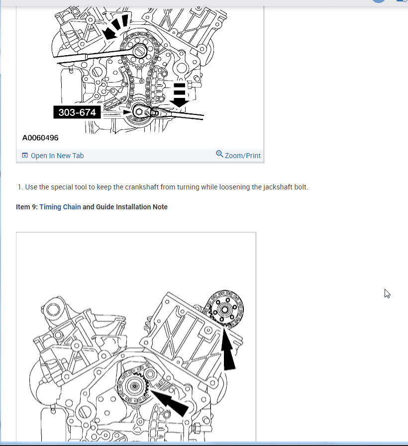

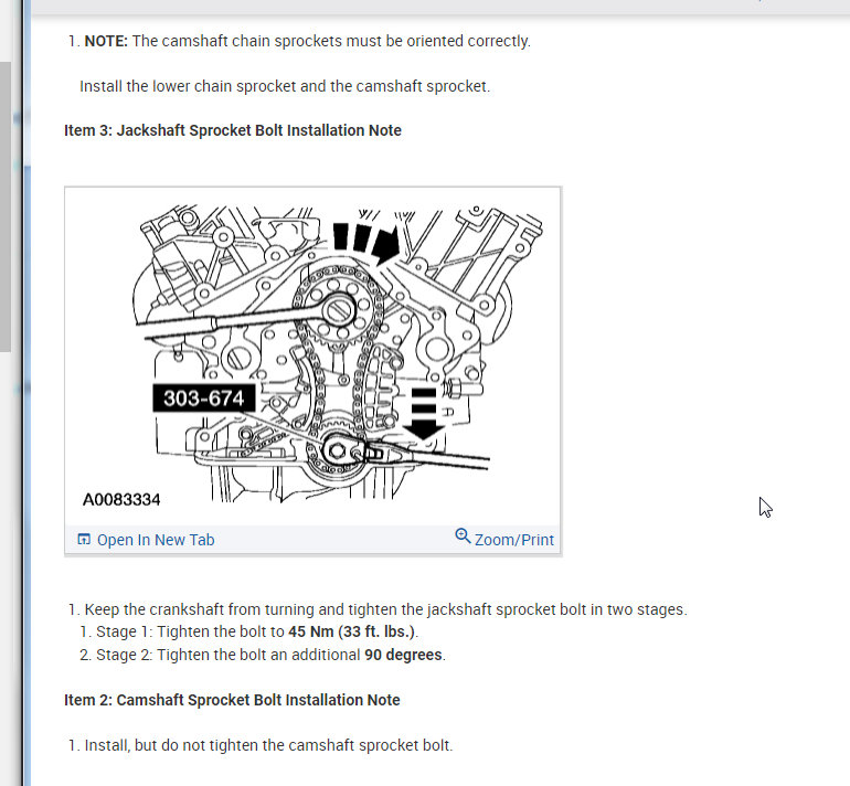

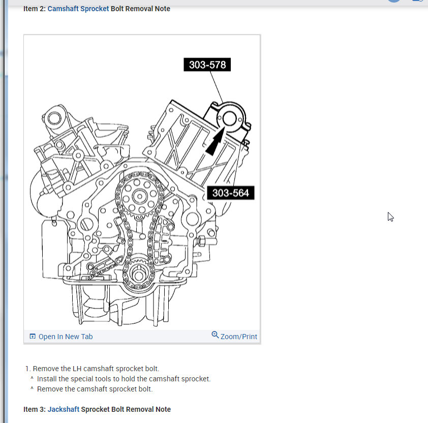

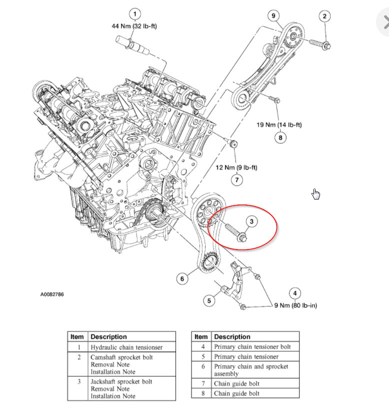

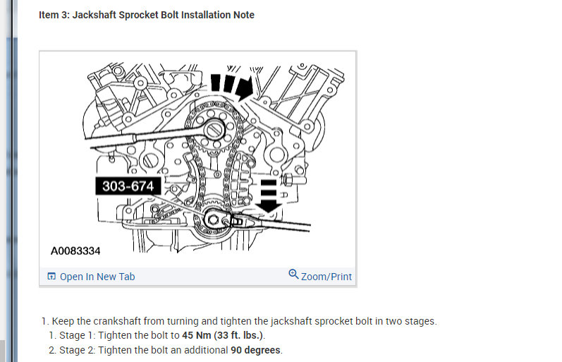

Nevermind i figured it out. All but 1 lash adjuster came out. The top half of it came out but the bottom half is stuck. I was just going to leave it and take the cams out since I will be replacing those too. I'm trying to remove the font chin but i just can't seem to loosen the front jackshaft sprocket bolt.
May 12, 2021 at 8:37 AM
Normally these are a little tight but they are only 33 ft lbs plus 90 degrees. So that would make it around 50-60 ft lbs. However, I suspect if this was apart before then someone put lock tight on the bolt which is making it hard to come out now.
you may have to heat the bolt to try and get it off.
May 13, 2021 at 11:39 AM

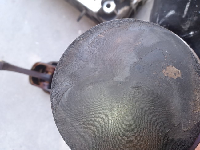

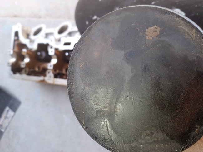

Crank and pistons are out. It's just the aluminum block now but the first shop i went to dropped my block onto the asphalt when they were unloading it from my friends car. so i took it somewhere else and this shop says the pistons look fine so they can reuse them and just hone and deck it and I would only have to get new rings or they can bore it too and i would have to get new pistons. Is it bad to reuse them since my engine has so many miles? Or would you recommend just getting new ones?
May 22, 2021 at 1:19 AM
I would not think twice about reusing pistons if you have them out of the engine and they look fine. The thing that must be replaced are the bearings and rings so if they say they are fine, then I would not waste the money.
I would reuse them and not give it a second thought.
May 22, 2021 at 11:55 AM
ARIANADANIELLE5345
  • 402 POSTS

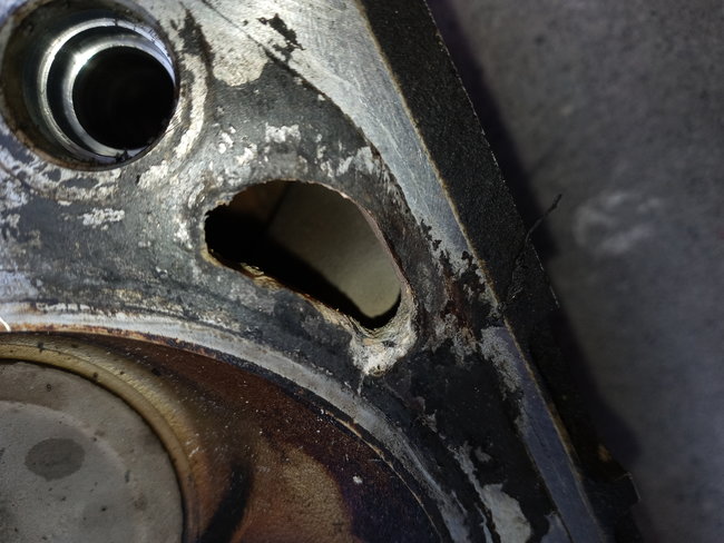

Well, now they're saying they're bad and that i need new heads because water corroded them.
May 23, 2021 at 7:48 AM
Clearly there are just a couple pictures but those pistons look like they can be cleaned as that carbon will come off and corrosion can be cleaned as well.
Pistons, heads, valves need to be replaced if they make contact with each other, most all other issues can be cleaned up.
However, at this point, I would only do what you are comfortable with. The reason is, it is far better to replace it with new parts and feel like you may have over repaired it then not do it and live in fear you made the wrong decision. The fact is, it is all taken apart right now so if you would feel better replacing them, then I would do it.
May 23, 2021 at 12:36 PM
