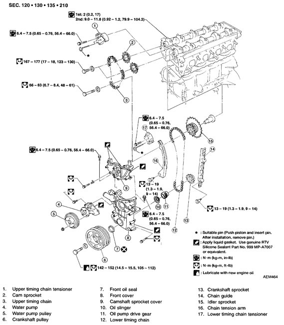

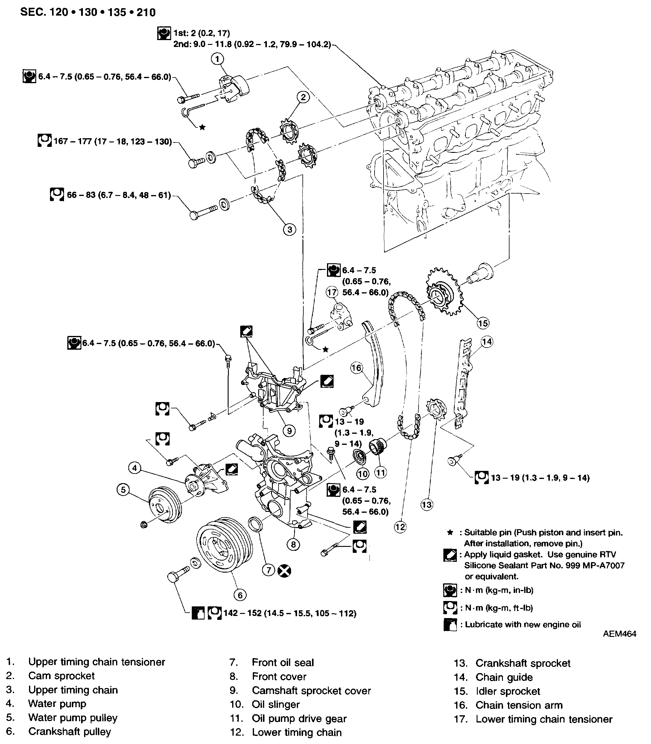

have you ever heard of the vehicle listed aboves timing chain just break when it is only 3 months old? it has a new head and all timing items replaced, then one day it quit running took cover off chain from crankshaft to dual cams was broke.
Mar 7, 2021 at 11:31 AM
  • 110,244 POSTS
I have to be honest, I haven't especially considering it was only three months old. Did you check to see if one of the cams locked? Something caused it to break unless it was a factory defect in the chain itself.
Let me know. Also, let me know if you have other questions.
Take care and God Bless,
Mar 7, 2021 at 11:45 AM
BONESMIKE
  • 21 POSTS
Thanks Joe. a quick question, would you take a chance that no valves got bent and just put a new chain on it and try to crank or just pull it down? please anyone that would help please let me know.
Mar 7, 2021 at 5:53 PM
  • 110,244 POSTS
Here is the way I see it. If you install a new chain, you can do a compression test to see if everything is good. If it isn't, at that time you can remove the chain and remove the head. All Nissan engines are interference engines, so there is a good chance something happened.
You don't need to put everything together to check compression because you're not starting the engine. Get the new chain on and then check compression.

Here are the directions for timing chain replacement. Use this to make sure you have it installed correctly. The pics below correlate with the directions.
__________________________
2001 Nissan-Datsun Truck Frontier XE 2WD L4-2.4L (KA24DE)
Removal and Installation
Vehicle Engine, Cooling and Exhaust Engine Timing Components Timing Chain Service and Repair Removal and Replacement Removal and Installation
REMOVAL AND INSTALLATION
TIMING CHAIN COMPONENTS
pic 1
1 of 2
pic 2
2 of 2
pic 3

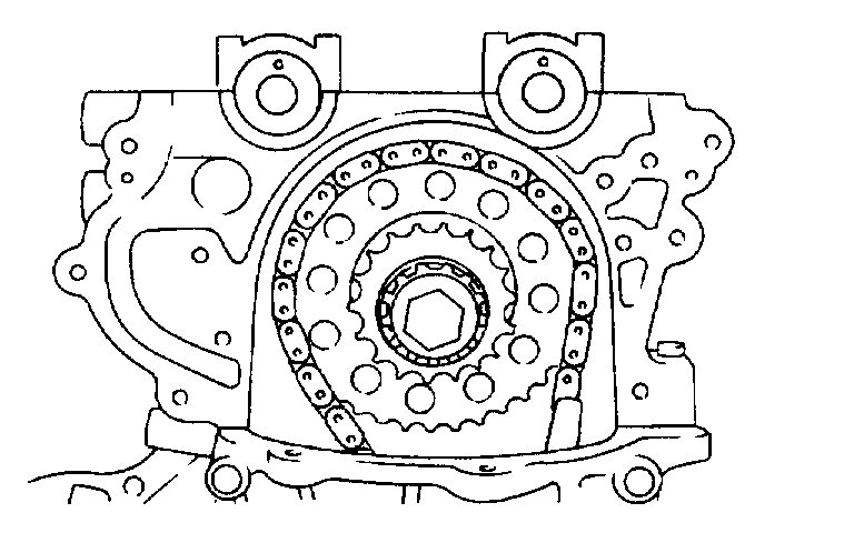

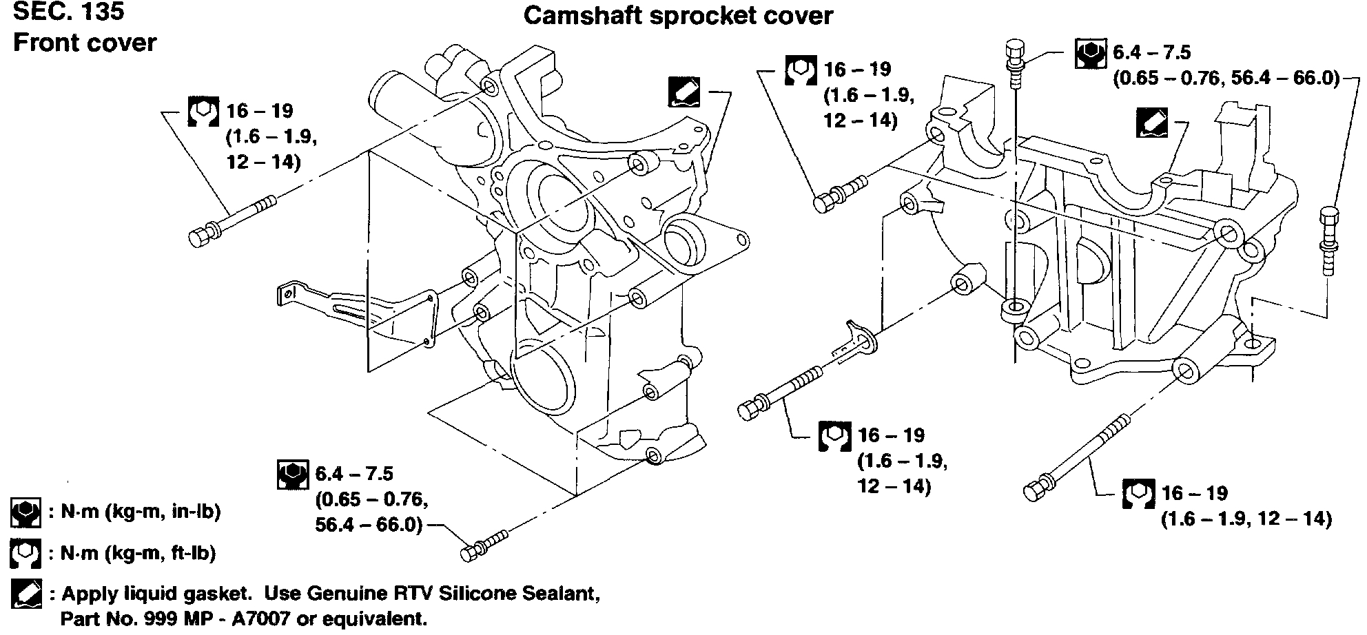

LIQUID GASKET APPLICATION PLACES

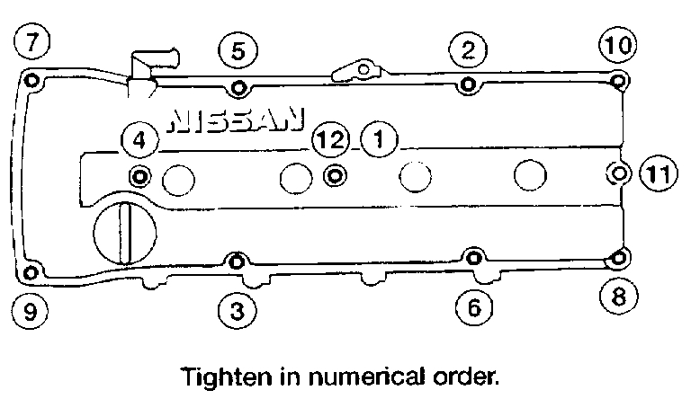

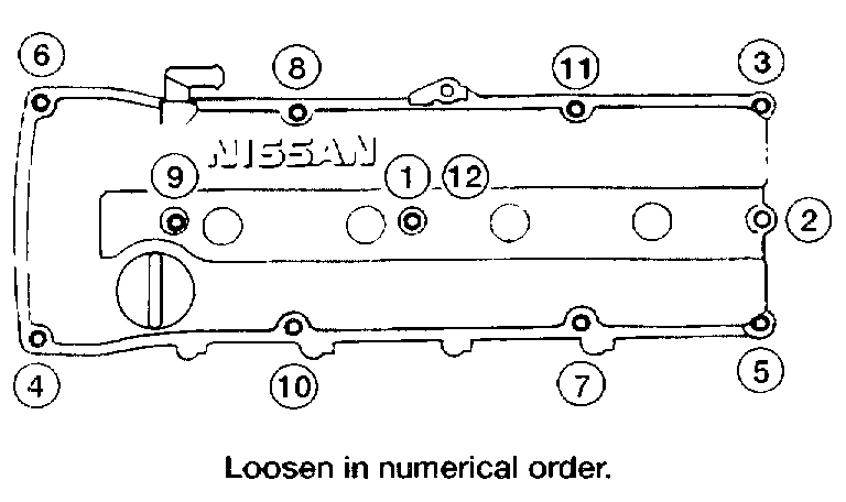

7. Remove the rocker cover.
- Loosen the bolts and remove in numerical order as shown.

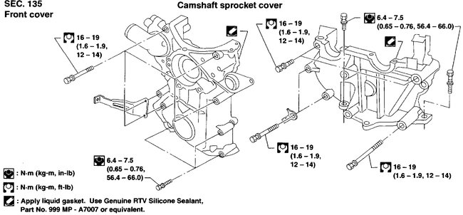

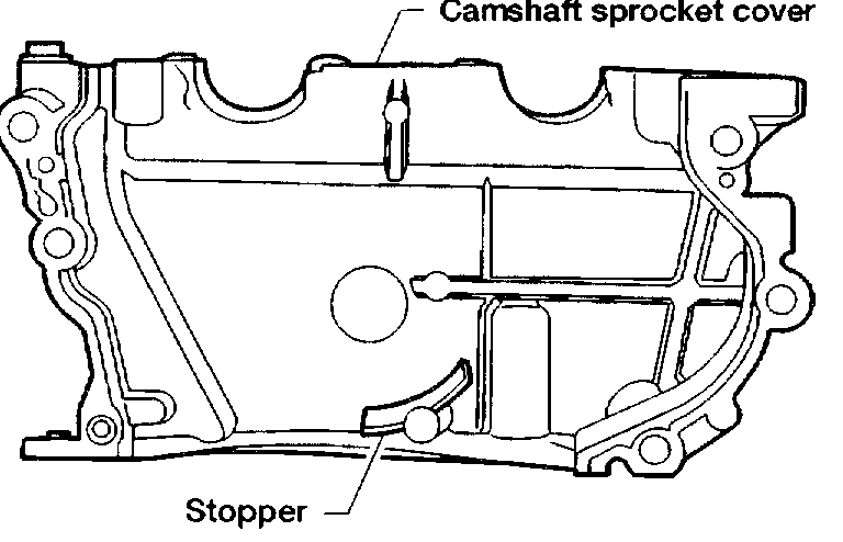

8. Remove the camshaft sprocket cover.
pic 7

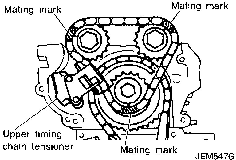

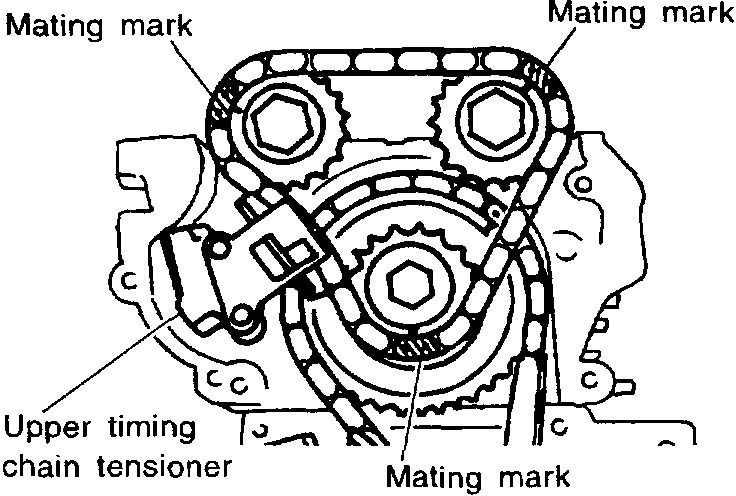

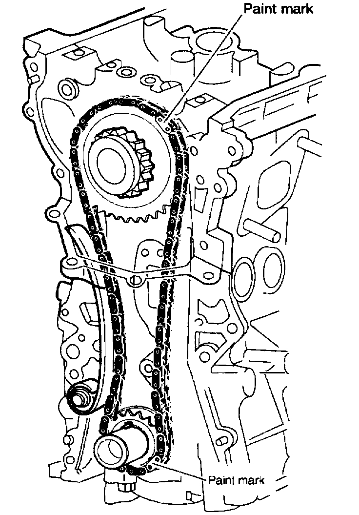

9. Wipe off the links of the timing chain next to the timing marks on the sprockets. Put paint marks on the timing chain, matching them with the timing marks on the cam sprockets and idler sprocket.
10. Remove cam sprocket bolts, cam sprockets and upper timing chain.

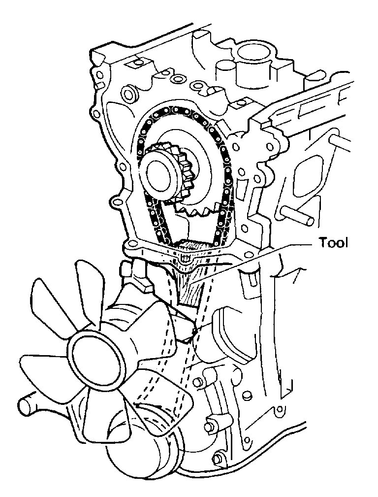

2. Support lower timing chain by using a suitable tool to prevent chain tensioner spring from coming out.
NOTE: This step is only to be applied when the lower cover is not being removed.
3. Remove the idler sprocket.

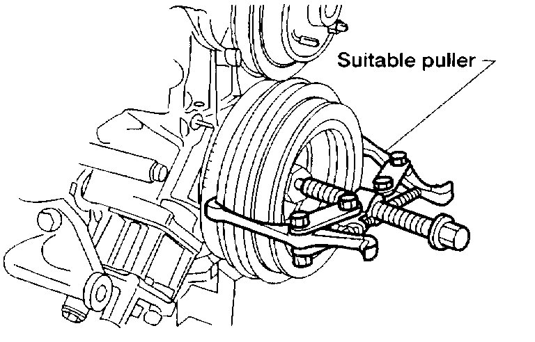

7. Remove the crankshaft pulley with suitable puller.

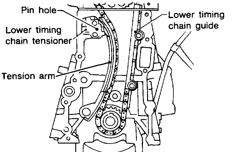

11. Remove the following parts.

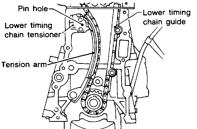

- Release the timing chain tensioner. Push piston in and insert a suitable pin into the pin hole.
- Chain tension arm Lower timing chain guide
12. Remove the upper timing chain and idler sprocket. Refer to "UPPER TIMING CHAIN", and "IDLER SPROCKET".

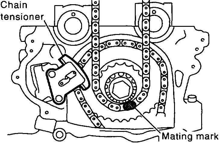

13. Wipe off the links of the timing chain next to the timing marks on the sprockets. Put paint marks on the timing chain, matching them with the timing marks on the crankshaft sprocket and idler sprocket.
14. Remove the lower timing chain and sprocket.

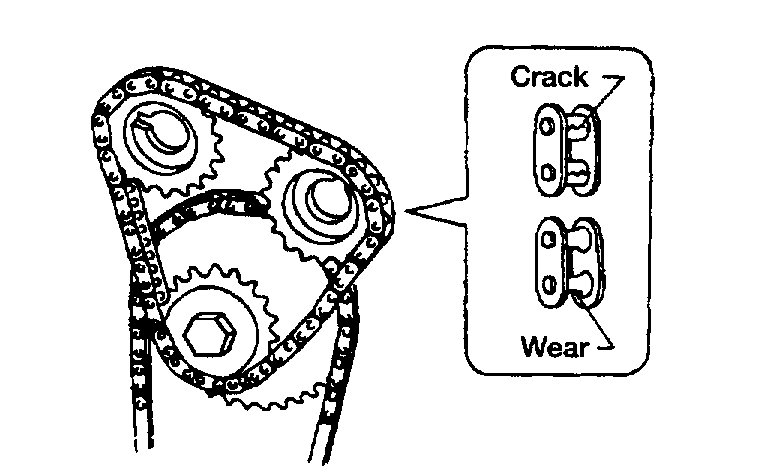

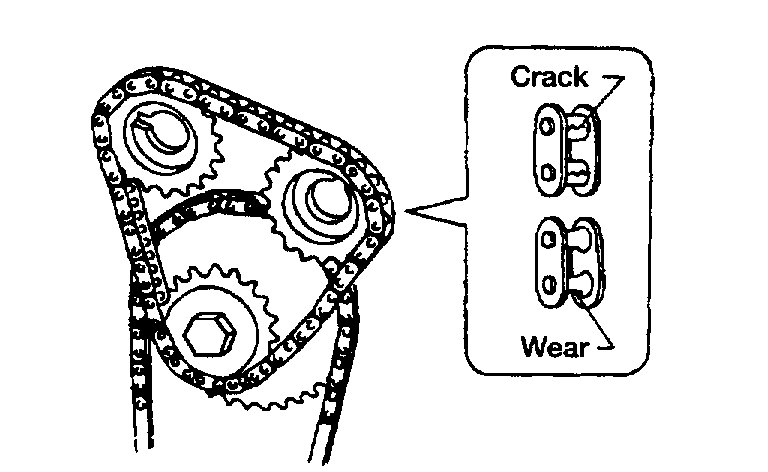

Inspection
Check for cracks and excessive wear at roller links. Replace chain if necessary.

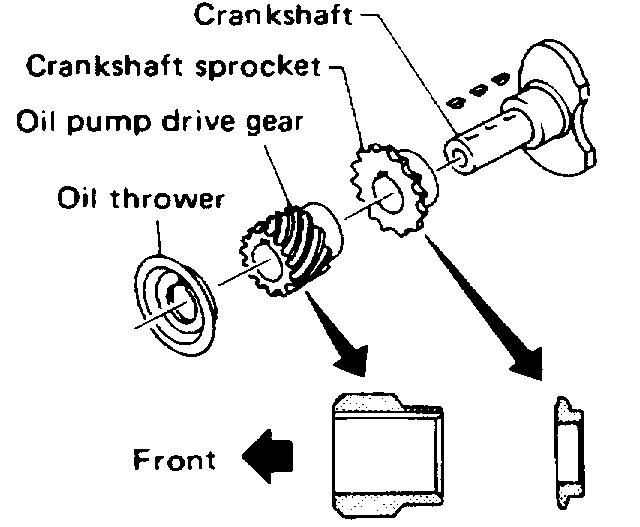

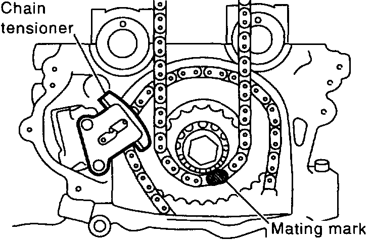

1. Install crankshaft sprocket.
- Make sure that mating marks of crankshaft sprocket face front of engine.
2. Install the idler sprocket and lower timing chain using the mating marks and the paint marks made during the removal process.
CAUTION: Be careful not to tear or damage the cylinder head gasket.
3. Install chain guide and chain tension arm.
4. Install lower chain tensioner and remove the pin securing the piston into the tensioner body.

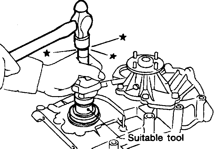

5. Front cover installation:
- Using a scraper or other suitable tool remove all traces of liquid gasket from the cylinder block and front cover mating surfaces.
pic 15

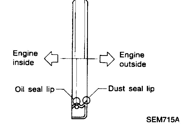

- Install new crankshaft seal in front cover.
- Apply a continuous bead of liquid gasket to front cover. Refer to "LIQUID GASKET APPLICATION PLACES".
NOTE: Use Genuine Nissan RTV Silicone Sealant P/N 999MP-A7007 or equivalent.
pic 16
- Be sure to install new front oil seal. Refer to "FRONT OIL SEAL", under Cylinder Head Assembly; Valve Guide Seal; Service and Repair.
- Also place RTV sealant on the head gasket surface.
- Install the front cover to the engine.

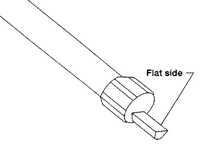

7. Install the oil pump and distributor drive shaft.
NOTE: Make sure the flat side of the distributor drive shaft is facing the engine. Failure to do so will result in the distributor being out of time.

2. Install upper timing chain and sprockets, referring to the painted marks made during removal.
3. Install chain tensioner. Remove the pin holding the tensioner piston in the bore of the tensioner.

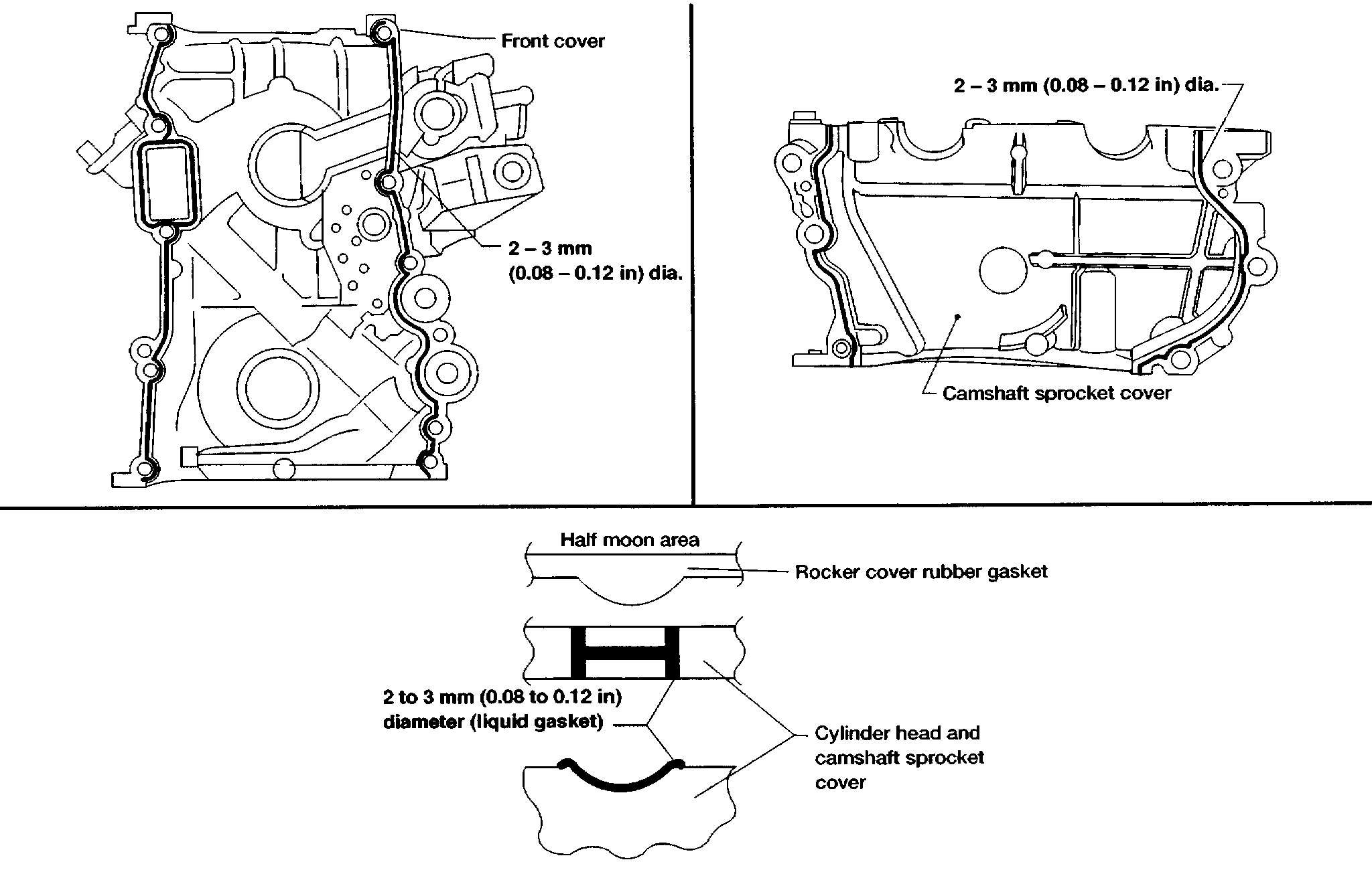

4. Install camshaft sprocket cover:
- Use a scraper to remove all traces of liquid gasket from mating surfaces of the engine block and camshaft sprocket cover.
- Apply a continuous bead of RTV sealant to the cover. Refer to "LIQUID GASKET APPLICATION PLACES".
NOTE: Use Nissan Genuine RTV Silicone Sealant, Part No. 999MP-A7007 or equivalent.
CAUTION:
- Be careful not to tear or damage the cylinder head gasket.
- Be careful upper timing chain does not slip or jump when installing camshaft sprocket cover.

6. Install rocker cover. Tighten bolts in numerical order.
- 8 - 11 Nm (0.8 - 1.1 kg-m, 69 - 95 inch lbs.).

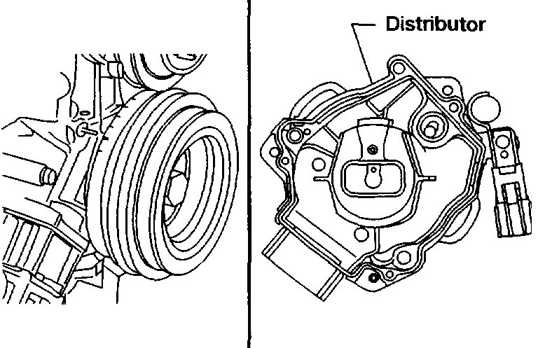

7. Install distributor, aligning as shown.
