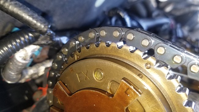

I use the cloyes video but when i go to turn it over left bank exhaust cam spins like to much slack on the guide part of chain.
Dec 2, 2019 at 4:24 PM
Okay, then most likely the timing is way off on that side from either a failed guide or tensioner.
Most likely with this issue, you may have valve damage.
Does the engine run?

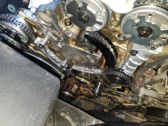

Took it a loose today and it's a lot of slack on the secondary chain (brand new) exhaust phaser going down the guide. but the tensioner side stays tight. could it be because i got it off Amazon for $140.00? but my Cloyes chain well be here Thursday.
Dec 3, 2019 at 3:03 PM
You either have a guide or tensioner that is causing the slack. That is not normal.
Can you post some pictures?

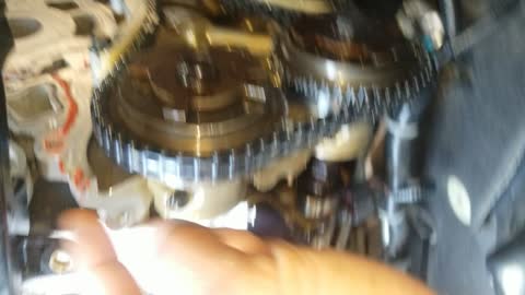

Slips on both sides.

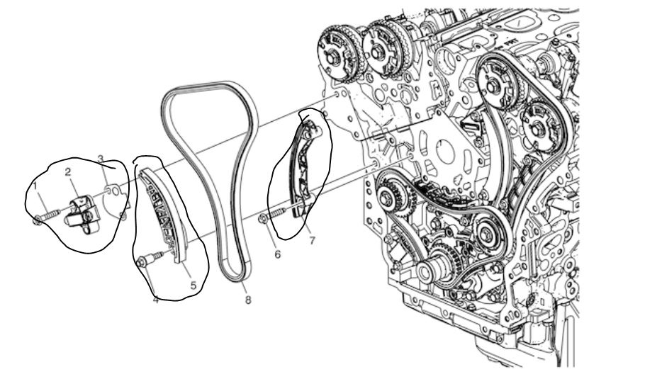

Think it's this chain:
Dec 4, 2019 at 12:49 PM
Okay, is the tensioner fully extended?

Nope only only when there's slack to that side.
Dec 4, 2019 at 3:09 PM
BRANDON CORNELL
  • 20 POSTS
The tensioner side is tight and the guide side is loose.
Dec 4, 2019 at 3:10 PM
BRANDON CORNELL
  • 20 POSTS
Then vice versa.

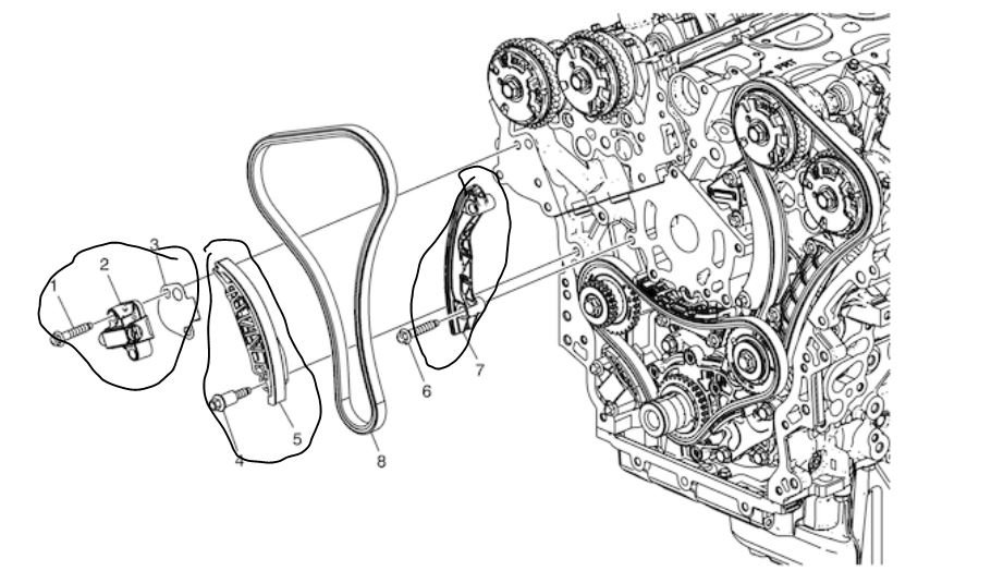

Is the tensioner fully extended? If it is, it will take up all the slack in the chain, not just on one side. Sounds like you have a bad tensioner.
Dec 4, 2019 at 3:17 PM
BRANDON CORNELL
  • 20 POSTS
Not strong enough to pull against the idler since its on crank and not enough to pull against cam but this me turning it over by hand so I think your right
Dec 4, 2019 at 4:35 PM
Yep
Dec 4, 2019 at 4:38 PM
BRANDON CORNELL
  • 20 POSTS

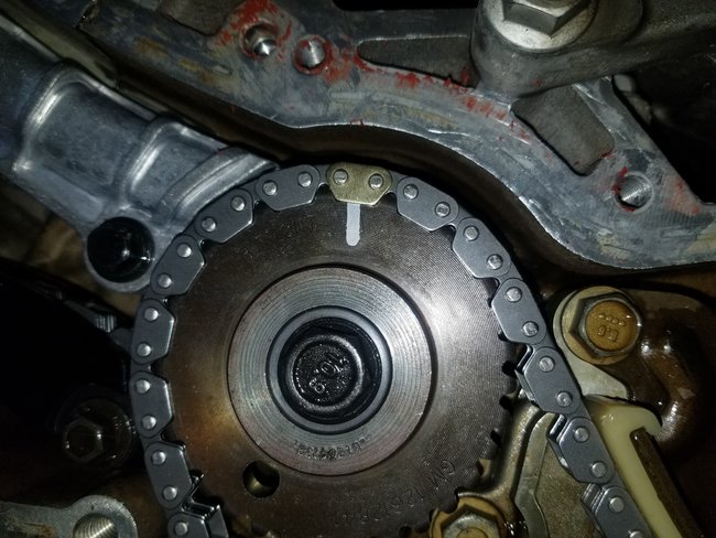

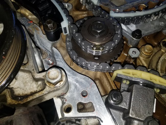

Think it was just a cheap chain didn't think $150.00 was cheap but compared to $330.00 Cloye's chain seem way tighter haven't turn it over but there's a difference in chain length Cloye's was 1/4 smaller.
Dec 5, 2019 at 4:37 PM
Hand turn the motor and check to see if it turns freely.

Brand new but bad chain was the problem.. the Cloyes is the best.. I turn it over 4-5 times its good! Thanks? Going to compression check tomorrow .

Its alive! Shes running good. i am going to stick with Cloyes.
