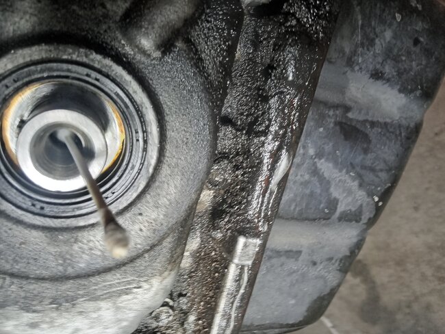

what I noticed is that oil came out and stopped from the crankshaft threads where the bolt screw in. it's where the Q tip is. see picture please.is it normal ? same as what happened here in this video start watching at 1:50 mark

Yes, the oil coming out from the threads is normal. This is why they use sealant at the bolt head face to stop leaks.

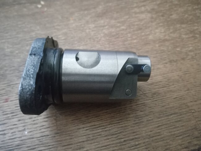

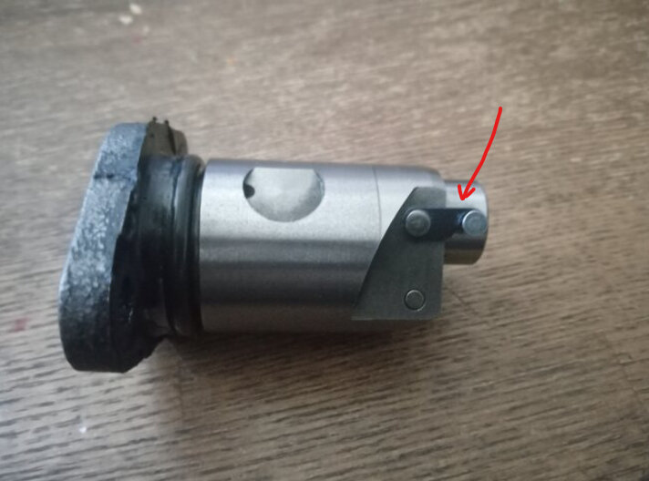

there is no pin. It's an external tensioner. this is the old one.it extend by itself when I rotate engine by hand.

Okay, this looks like it has a catch/stay for the plunger, please looks at the image below to see what I am talking about. Can you release this?

when the plunger gets pushed slightly back. gravity releases the hook and the plunger extends. I believe the plunger is extended. I started the car a drove it. sounds good but i see a drip of engine oil on the power steering pump. I don't know if I put enough sealant between the head and the block.
