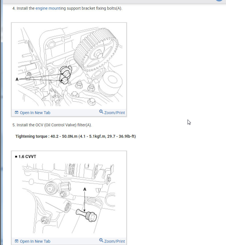

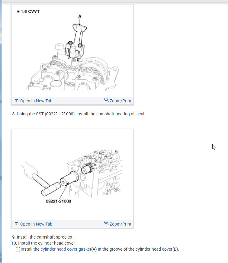

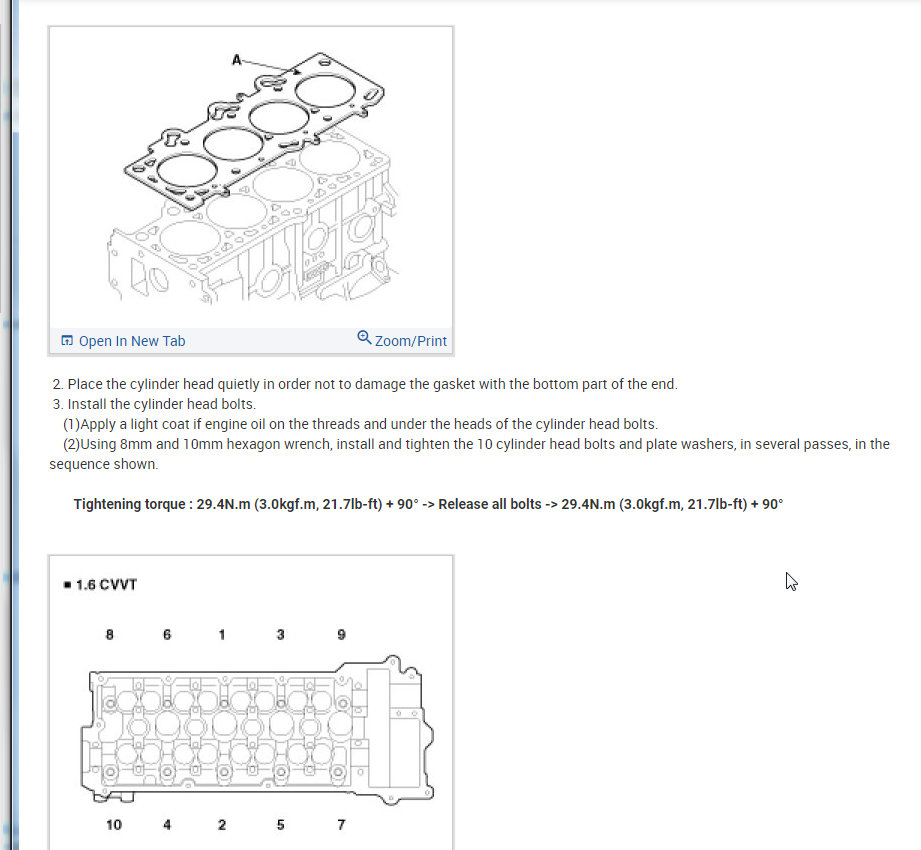

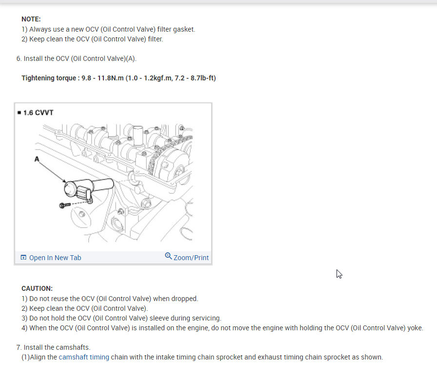

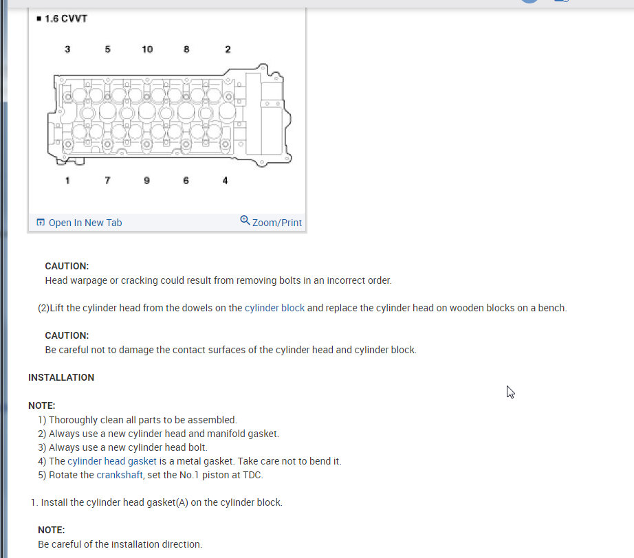

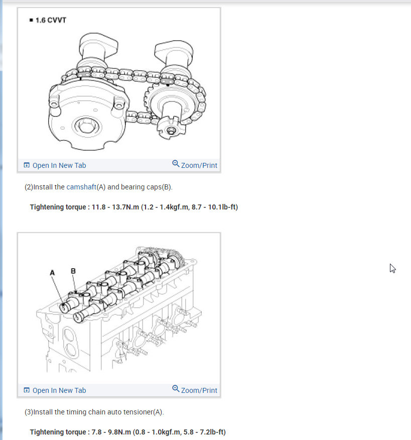

Want to know how and where the camshaft timing marks are that the timing chain drives both camshafts at the rear is driven by timing belt at front of motor and i know them marks but not the cam gears for the chain?
Nov 30, 2019 at 11:12 AM
I attached the entire process below on how to replace the cam and it shows the timing marks needed when installing the cams.
Let us know what questions you have and we can go from there. Thanks
