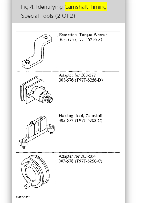

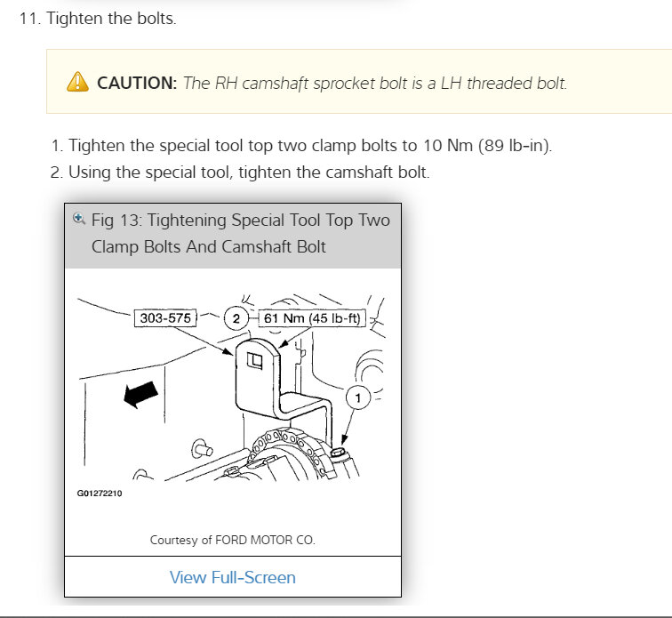

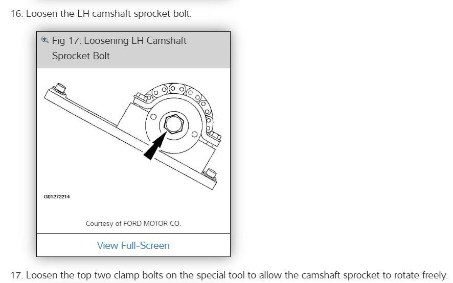

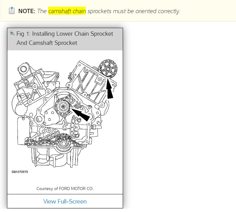

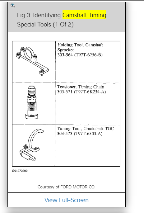

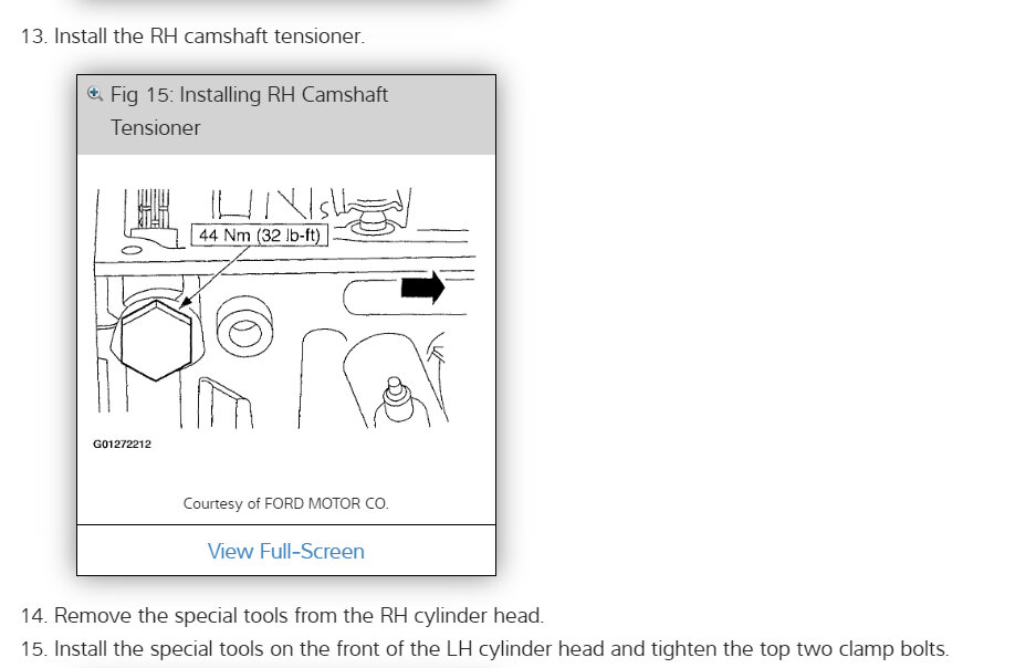

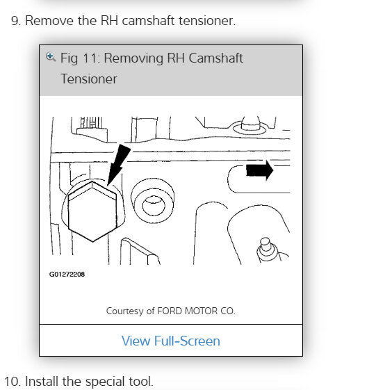

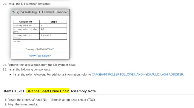

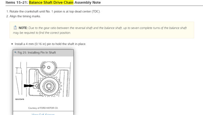

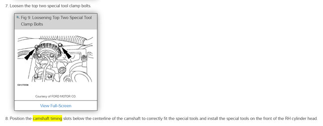

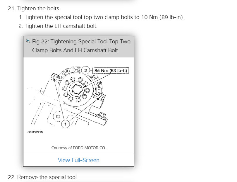

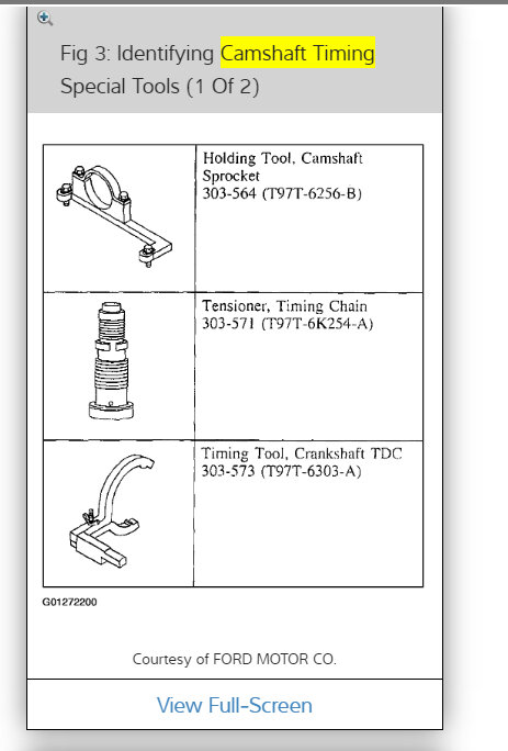

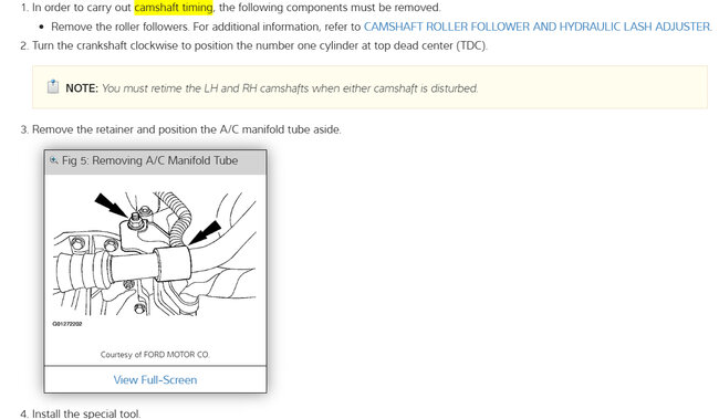

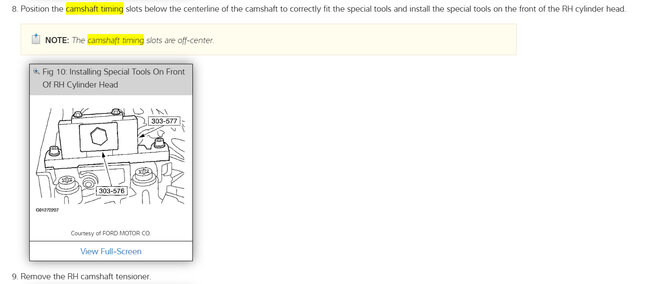

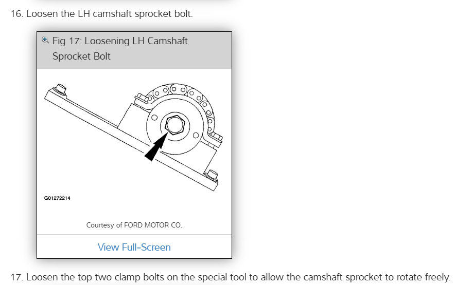

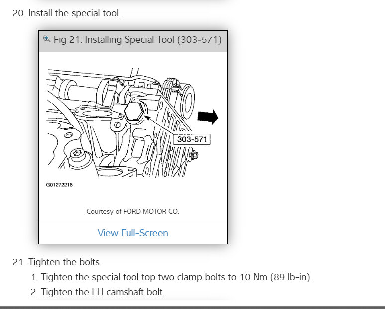

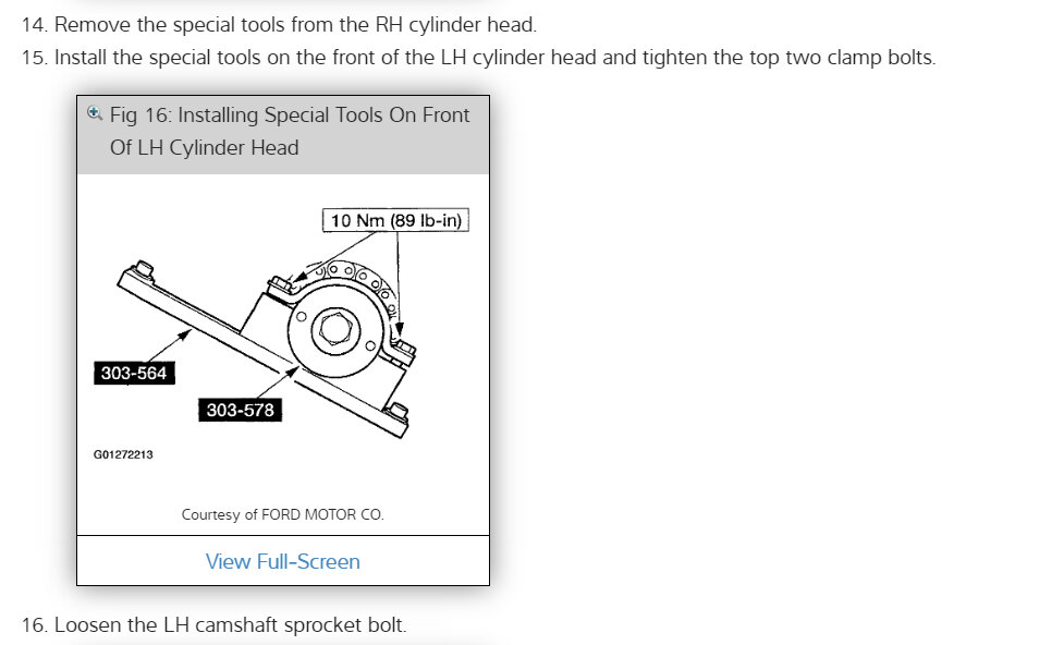

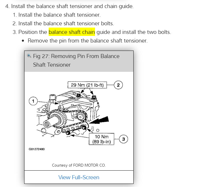

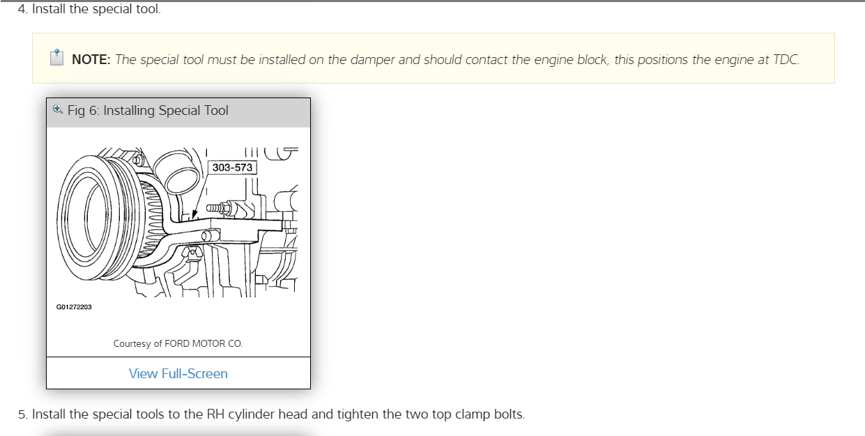

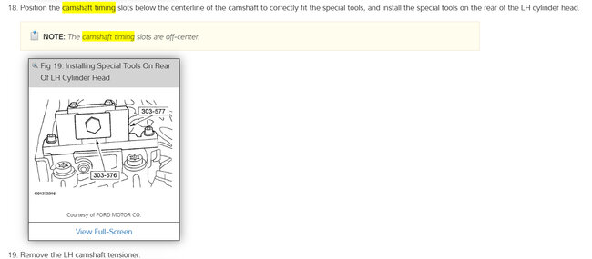

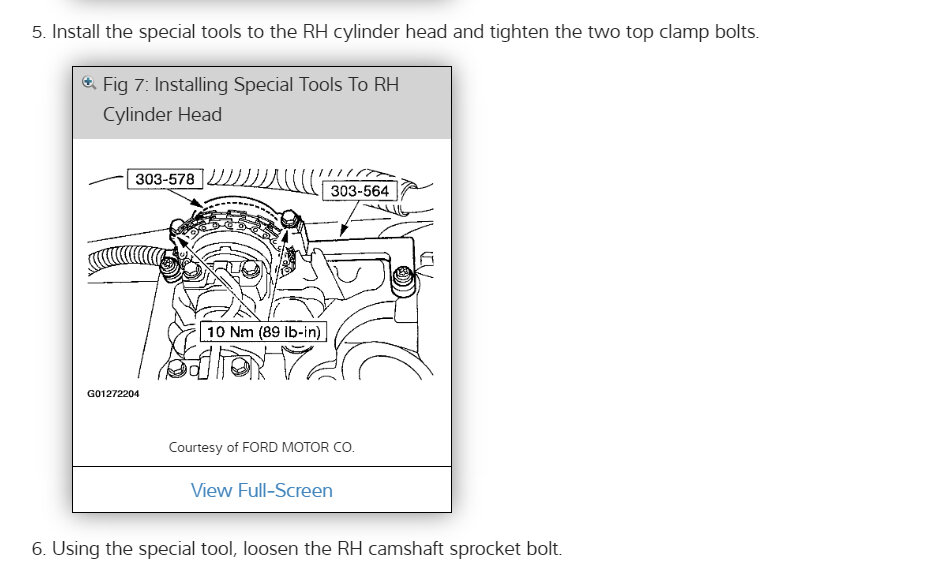

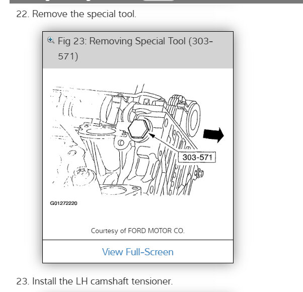

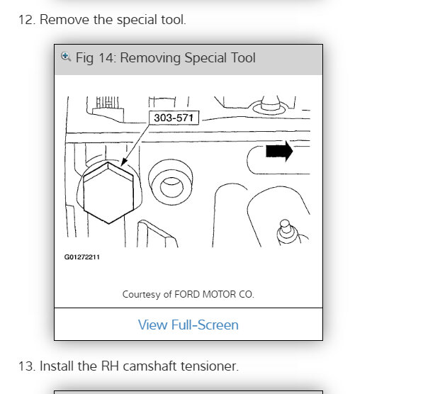

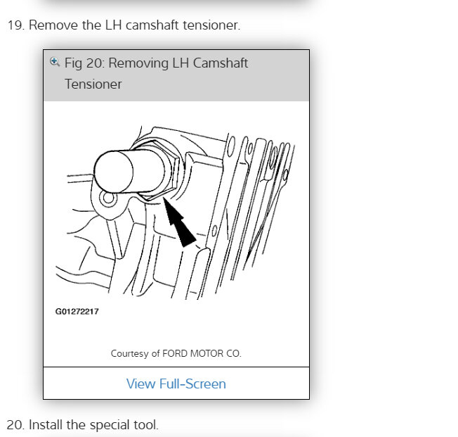

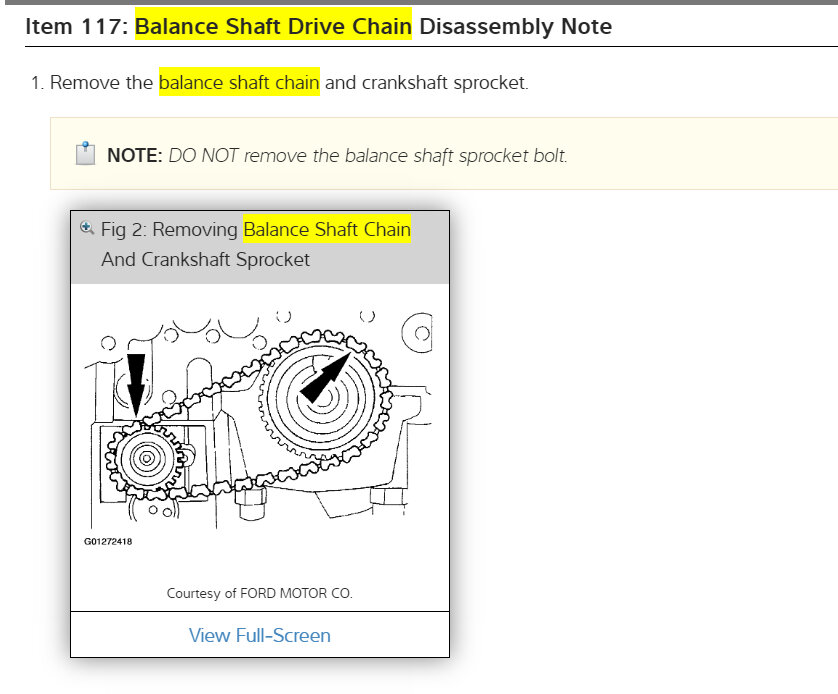

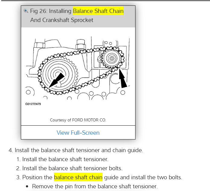

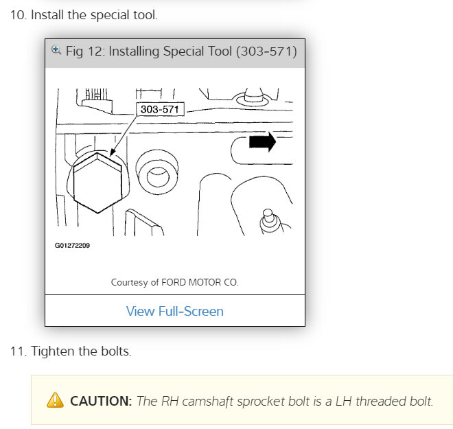

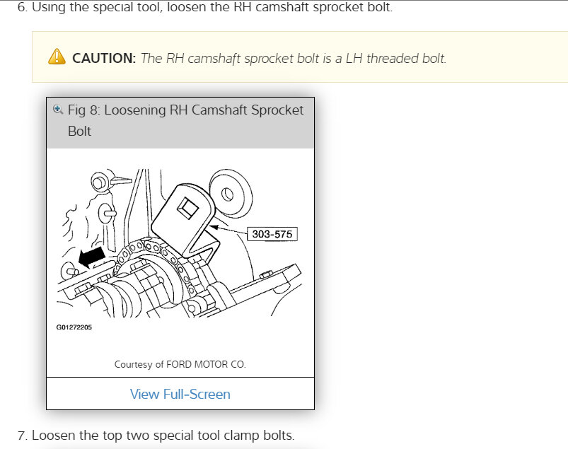

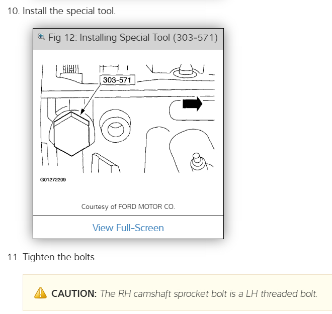

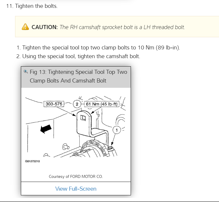

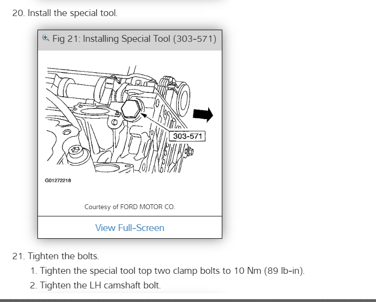

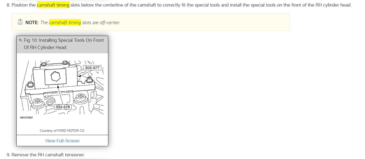

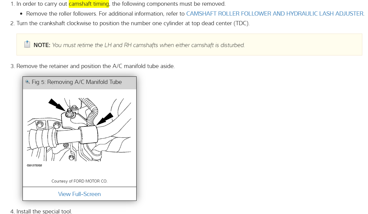

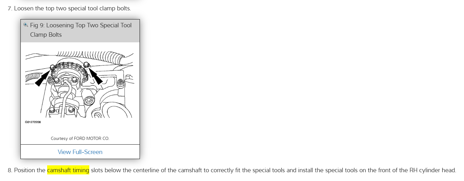

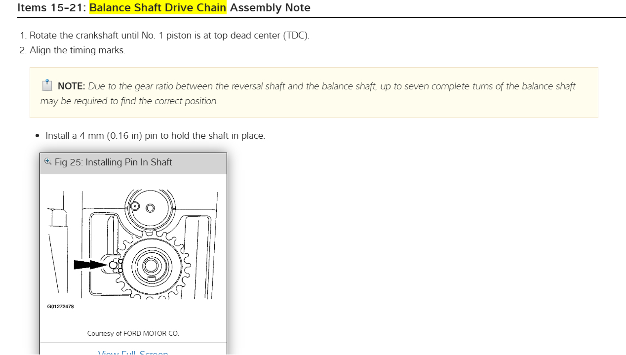

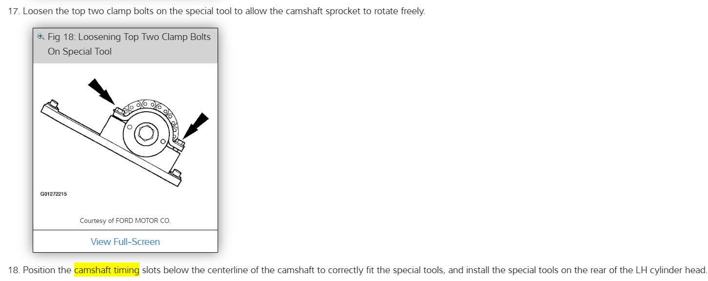

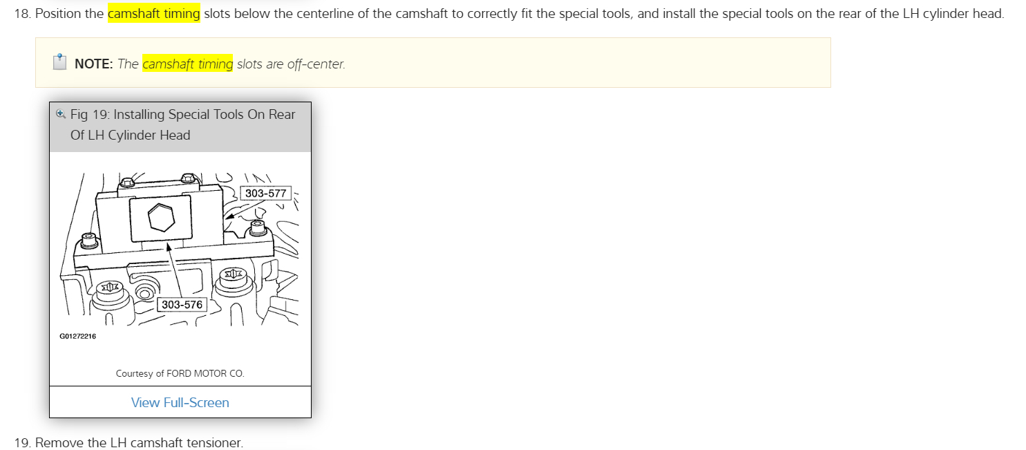

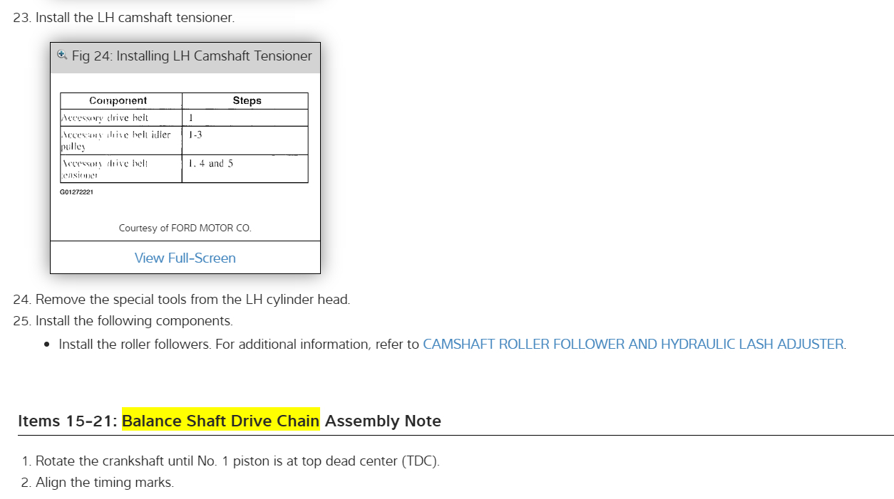

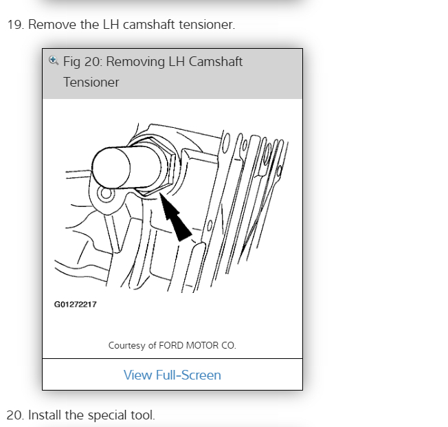

Here are the instructions on how to replace the timing and balance shaft chains in the images below, please drain the coolant and disconnect the battery first. Check out the images (below). Please let us know if you need anything else to get the problem fixed.

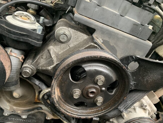

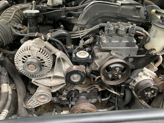

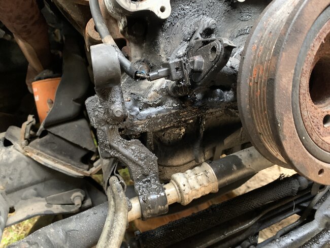

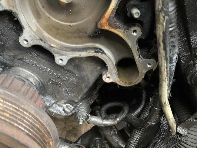

Thank you for the info! Let me start by providing a little more info! Had someone that was more familiar with vehicles than I am, come help me that is until they didn’t show back up! He was doing things that didn’t include pulling engine etc. I am left to finish this job and I’m kind of lost on where to go from here! So far have pulled the radiator, alternator and tensioner pulley, thermostat housing (I think that’s what it is called, and whatever that is above the crankshaft. I’m working on 4.0l sohc engine
Any advice would be greatly appreciated.

Okay, we can help walk you thought the repair but can you upload images so we can see what's going on?
Jul 24, 2023 at 3:52 AM
AMRUTLAND75
Not very good and can send better ones in a bit.
Jul 24, 2023 at 7:59 AM
  • 55,433 POSTS
Yep, you have some disassembly to do. The babamcer will be the tough part please go over this guide:
https://www.2carpros.com/articles/how-a-harmonic-balancer-works
Let us know what happens and please upload pictures or videos of the problem so we can see what's going on.
