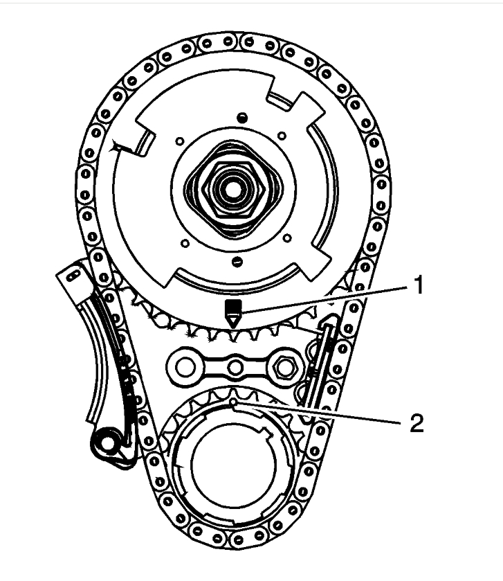

I need de timing chain marks 6.0

Sure I got you covered, here are the timing chain marks for a GM 6.0
Image (Click to enlarge)
