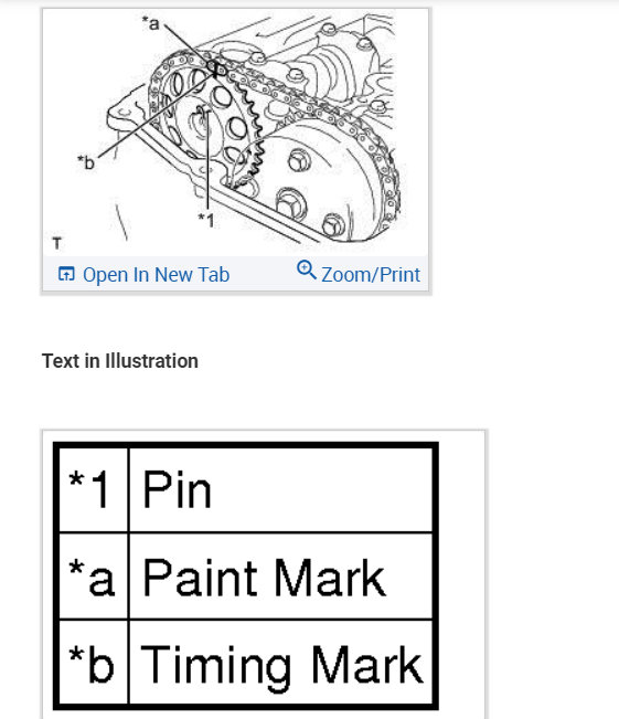

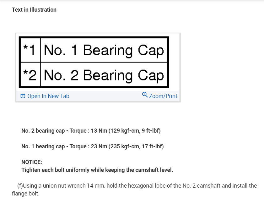

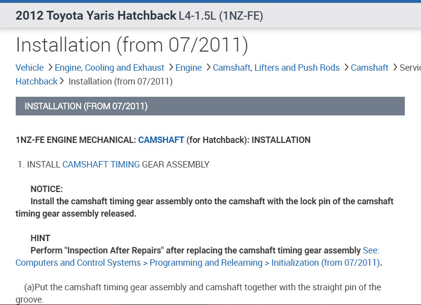

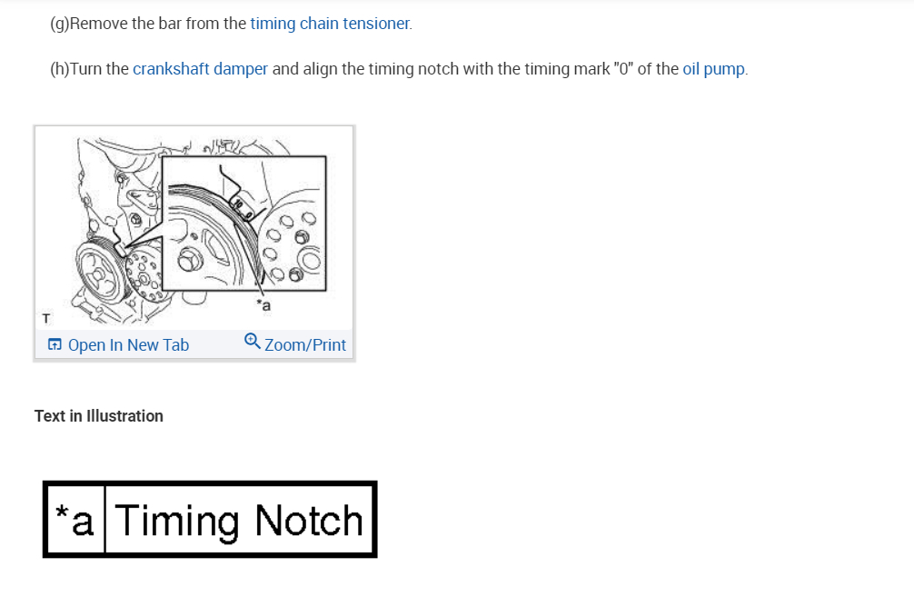

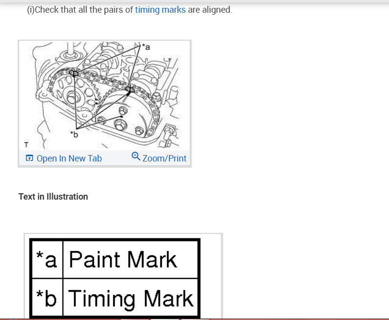

Just trying to get step by steps on how to replace all timing components in car. and tools it requires changing all sprockets chain guides everything.
Nov 16, 2019 at 3:35 AM
SCGRANTURISMO
  • 4,897 POSTS

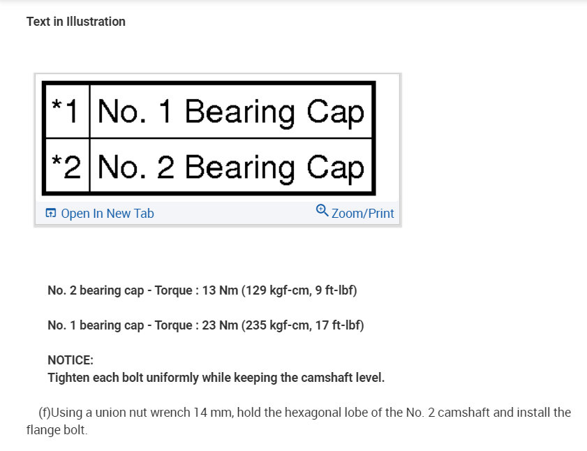

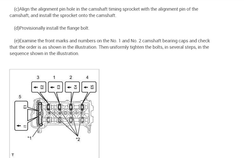

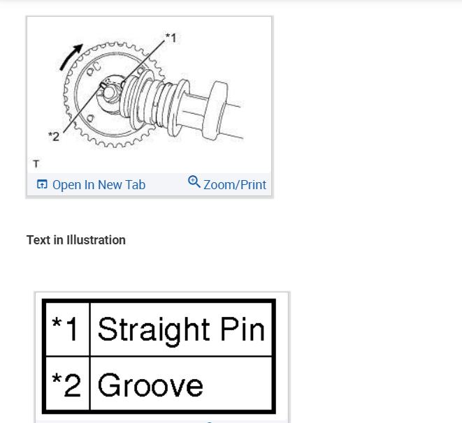

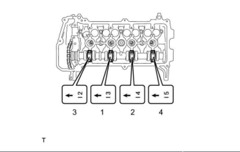

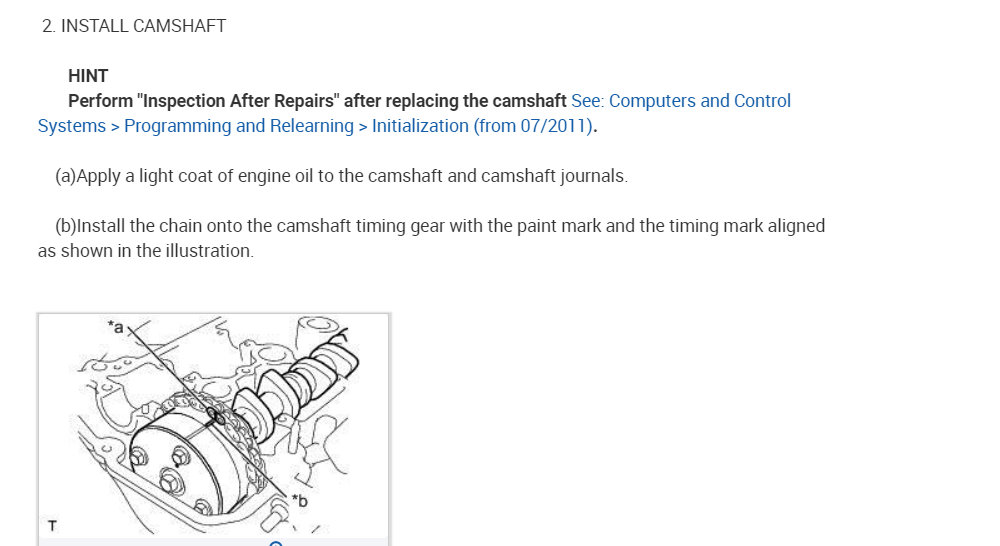

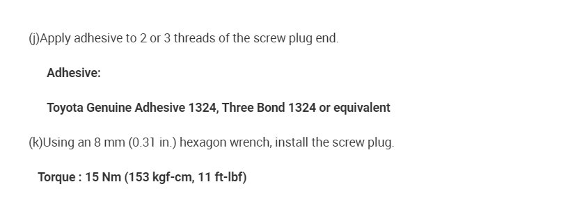

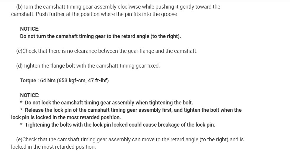

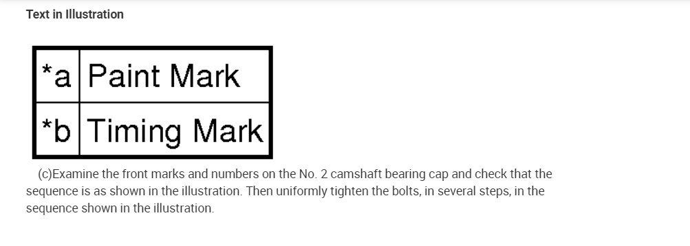

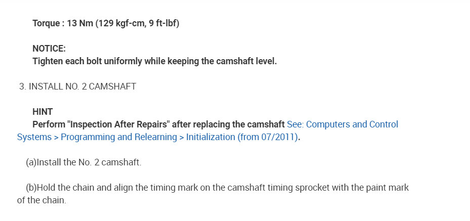

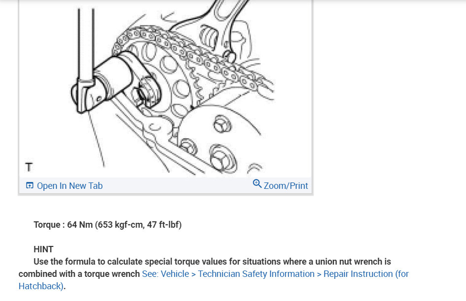

In the diagrams down below I have included the installation instructions for your vehicle's camshaft, which will include the instructions for the installation of the timing chains. I hope that this helps. Please get back to us with how everything turns out.
Thanks,
Alex
