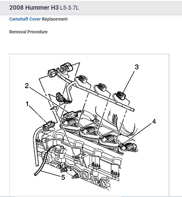

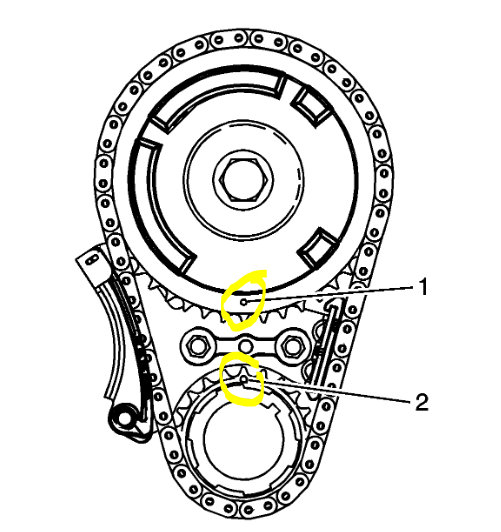

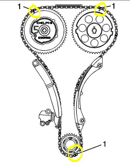

Do you have the 3.7L V6 or the 5.3L V8? I need to know that to get the information needed.
I attached a couple of pics below. If you have the 3.7, see pic 1. Note, the colored links must align with the marks.
Pic 2 shows the 5.3L and is much easier to time the engine.

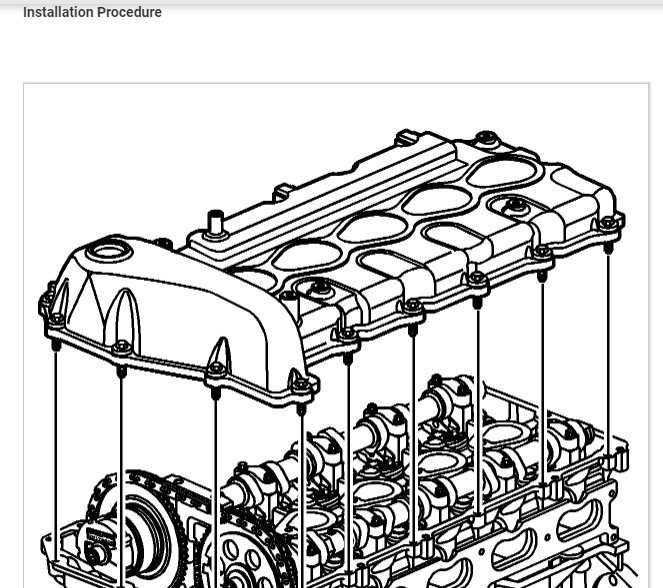

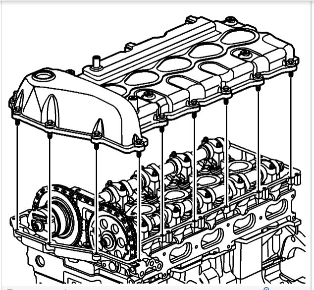

The engine has no compression and will not run this way. If the timing was off the first time you put it together and you were cranking it, there is a chance there is internal damage to the valves. Please keep in mind that I am basing that on the timing to be correct at this point.

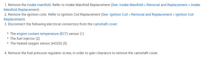

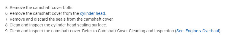

What I need you to do is remove the valve cover and see if there are any stuck valves.
I'm sorry for the bad news, but it took a half second for me to recognize the issue.

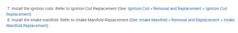

I don't know if you need them, but I attached the directions for removing and replacing the valve cover.

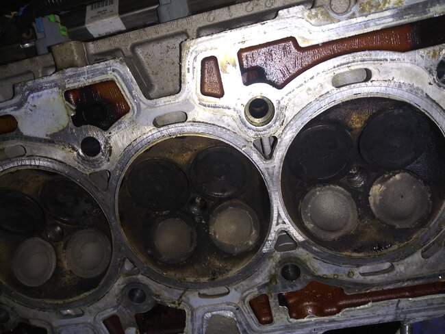

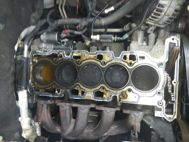

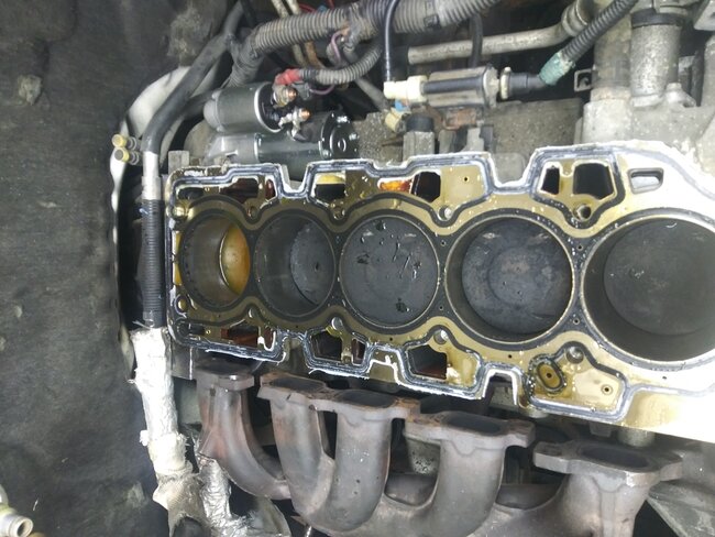

Sorry it took so long. I don't know how, but the coolant leaked into the cylinders.
Oct 12, 2022 at 4:35 AM
  • 110,251 POSTS
Chances are the head gasket was bad. Is there any evidence that the valves were hitting the tops of the pistons? Is there any damage you can see?
Also, get the coolant out of the cylinders, dry them, and place a film of motor oil over the cylinder walls. Make sure there is no coolant mixed with the engine oil as well. If it did, drain and replace it with new oil and a filter.
Let me know what I can do to help.
Oct 12, 2022 at 11:22 AM
JAKNIYAH
  • 31 POSTS

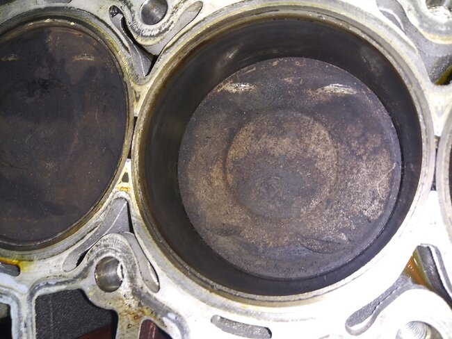

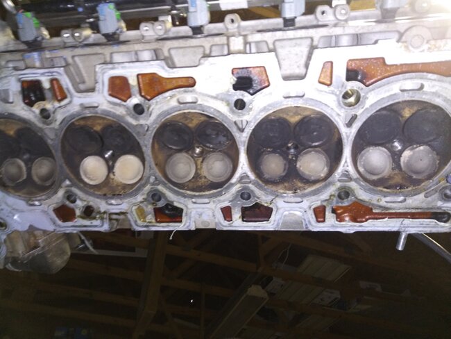

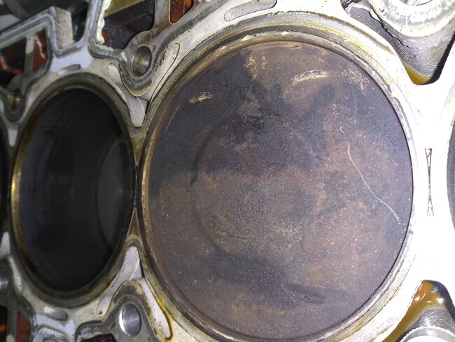

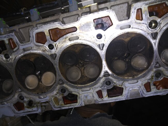

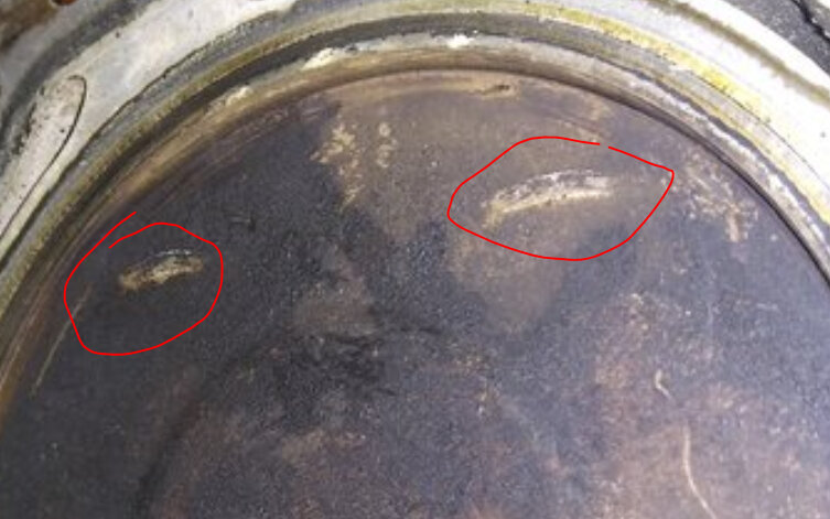

The piston tops have a few small scratches, is that enough to cause significant damage? The gasket i bought was three layers, and new from rockauto; what is a better choice for a gasket?
Oct 13, 2022 at 11:38 PM
  • 110,251 POSTS
Based on the pics, I would say you are okay. I attached a pic below from your pics. Are these marks from the valves?
Let me know. As far as the pistons, they look fine. You may want to confirm there is no damage to the valves. They should be okay, but you should check.
See pic below.
Oct 14, 2022 at 2:27 PM
JAKNIYAH
  • 31 POSTS
Yes, those are the valve marks, but the valves are not damaged.
Oct 15, 2022 at 11:08 AM

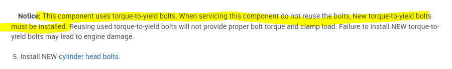

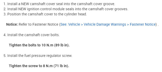

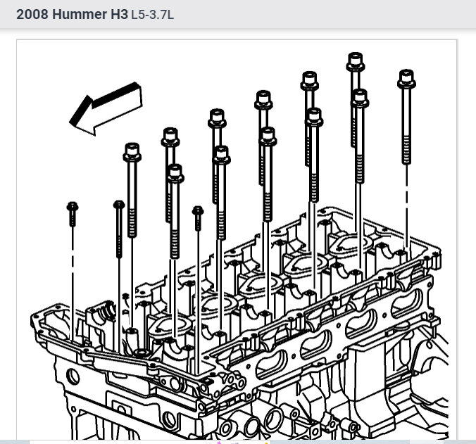

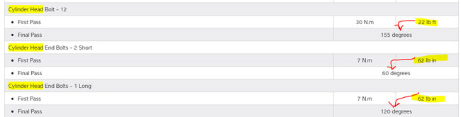

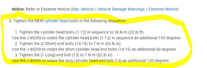

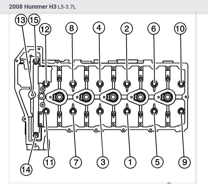

I just bought a torque wrench from Harbor freight: i tried to torque the cylinder block to the engine block using 22 ft/lbs, and the bolt snapped! Is that the right pounds per torque?
Oct 30, 2022 at 4:18 AM
  • 110,251 POSTS
Do you mean the cylinder head to the engine block or are you referring to the valve cover to the cylinder head?
The valve cover is 89-inch pounds, not foot-pounds. It works out to 7 foot-pounds.
The 12 head bolts are first tightened to 22 ft/lbs and then an additional 155-degree turn.
The end bolts on the head are different. You start at 62-inch pounds which is equal to 5 foot-pounds. And then slightly tighten after. See the directions below.
Note: The last pic is from a different manual. I just wanted to make sure I wasn't wrong. Both manuals are the same.
Remember, foot pounds and inch pounds are very different. Let me know if you have questions regarding them.
I attached the directions below. The last pic is just a torque confirmation.
Let me know if this helps.
Oct 30, 2022 at 1:14 PM

Cylinder head to engine block. The bolt was brand new, but still snapped at 22 ft/lbs. Do i need a better equipped torque wrench?
Oct 30, 2022 at 1:37 PM
  • 110,251 POSTS
As long as they weren't the end bolts they shouldn't have broken. Once the initial torque to 22 ft/lbs is done, you have to go back and turn the bolts an additional 155 degrees. So, 22 ft/lbs is only the start.
I guess it could be the torque wrench or a faulty bolt, but the bolt, in most cases, isn't the issue. Do you have a different torque wrench? If you can get your hands on one, torque a bolt on something that isn't important to see if it is the same on the one you purchased. Also, what type of wrench is it? For example, tighten a bolt to 20 ft/lbs with a different wrench and see if your new one clicks before turning the bolt further.
