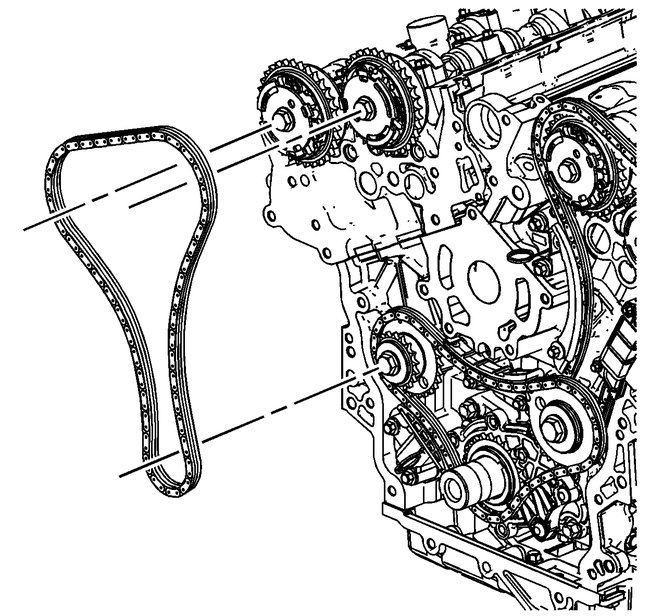

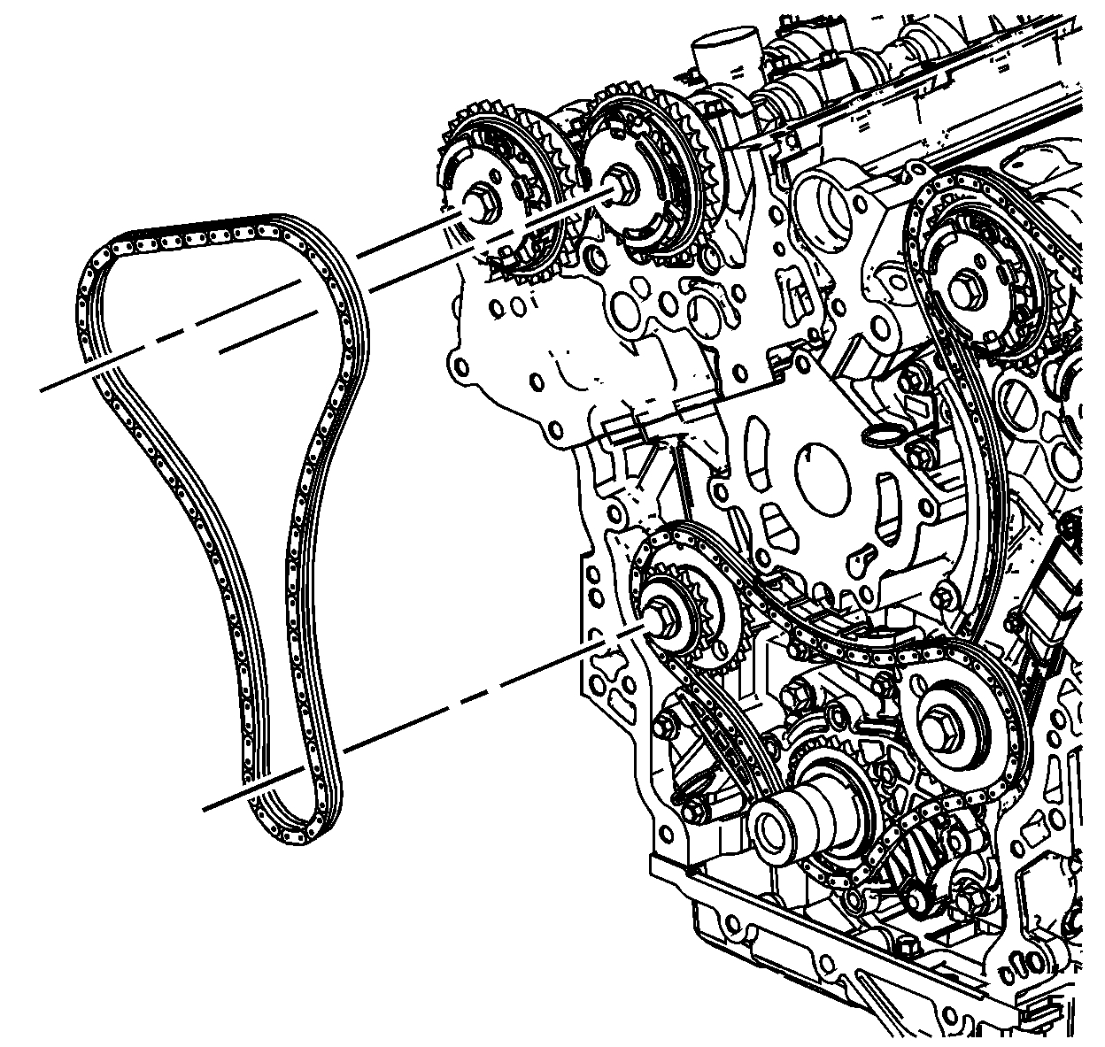

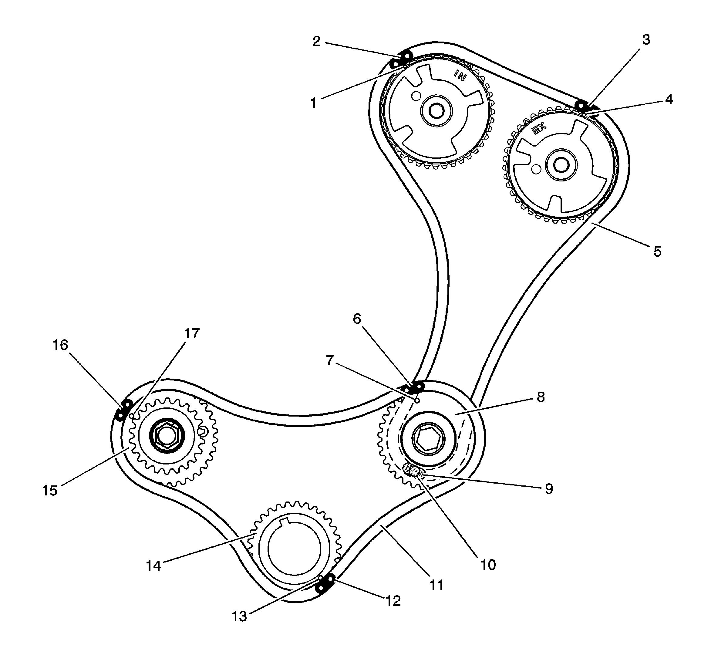

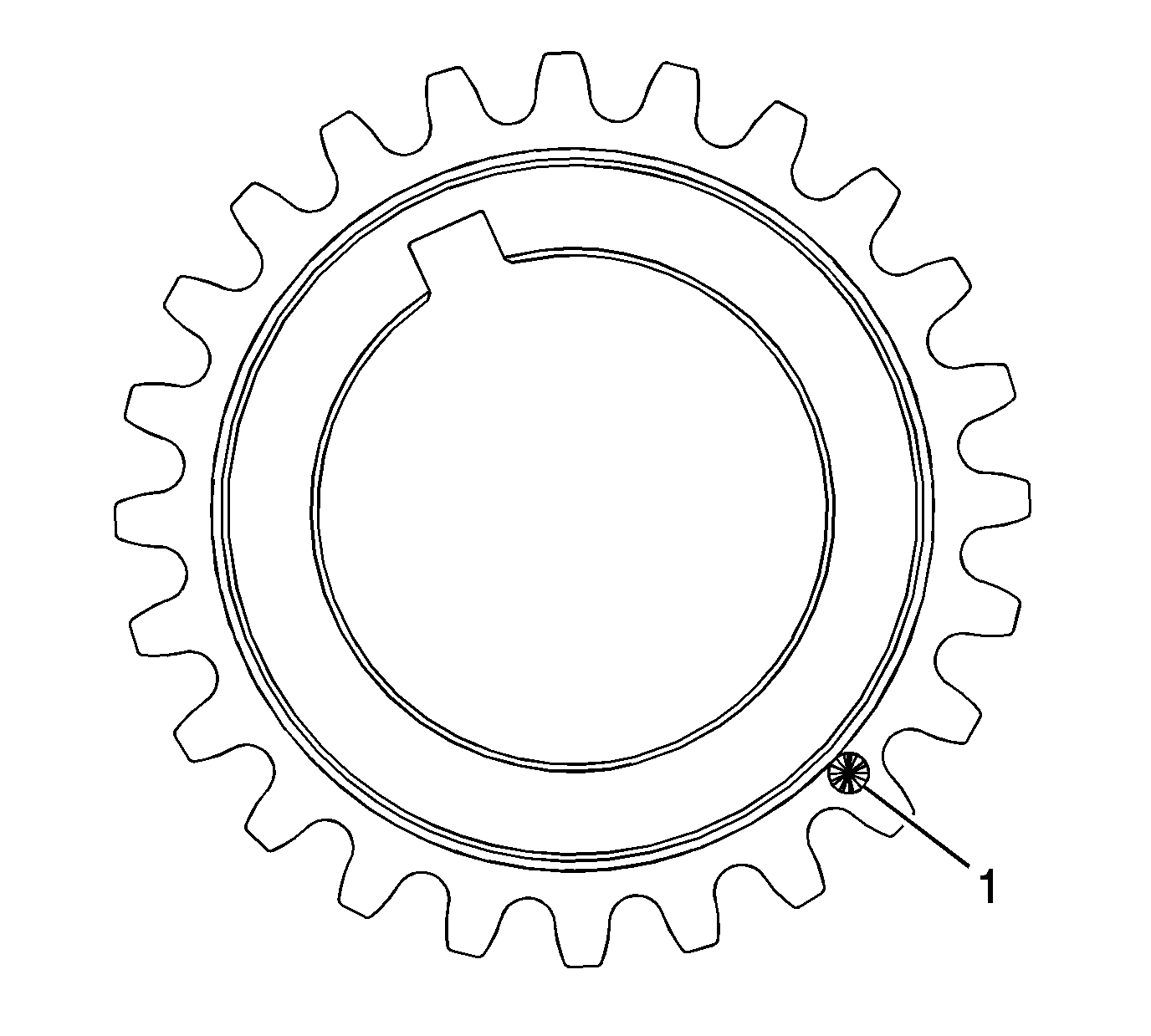

I was trying to replace right bank timing chain and the camshafts jumped
2013 CHEVROLET TRAVERSE
92,000 MILES
MDINSKEEP59
Replaced head gaskets and first two timing chains. While attempting to replace right bank timing chain, the camshafts jumped. Not sure what to do next. Never had this problem before.
Jun 9, 2020 at 10:10 AM
  • 110,240 POSTS
The only thing that can be done is to do it over. Here are the directions specific to the secondary timing chains. The pictures attached correlate with the directions. I am going to provide the directions for all three. You can pick and choose what you need.
__________________________________________
Primary
2013 Chevy Truck Traverse AWD V6-3.6L
Primary Camshaft Drive Chain and Sprockets Replacement
Vehicle Engine, Cooling and Exhaust Engine Timing Components Timing Chain Service and Repair Removal and Replacement Primary Camshaft Drive Chain and Sprockets Replacement
PRIMARY CAMSHAFT DRIVE CHAIN AND SPROCKETS REPLACEMENT
Special Tools
EN 46111 - Crankshaft Rotation Socket
Removal Procedure
1. Remove the engine front cover. Refer to Engine Front Cover Replacement See: Timing Cover > Removal and Replacement > Engine Front Cover Replacement.
2. Remove the spark plugs in order to ease crankshaft/engine rotation. Refer to Spark Plug Replacement See: Spark Plug > Removal and Replacement > Spark Plug Replacement.
3. Remove the right bank secondary camshaft drive chain tensioner. Refer to Secondary Timing Chain Tensioner Removal - Right Side See: Engine > Overhaul > Secondary Timing Chain Tensioner Removal - Right Side.
4. Remove the right bank secondary camshaft drive chain shoe. Refer to Secondary Camshaft Drive Chain Shoe Removal - Right Side See: Engine > Overhaul > Secondary Camshaft Drive Chain Shoe Removal - Right Side.
5. Remove the right bank secondary camshaft drive chain guide. Refer to Secondary Timing Chain Guide Removal - Right Side See: Engine > Overhaul > Secondary Timing Chain Guide Removal - Right Side.
6. Remove the right bank secondary camshaft drive chain. Refer to Secondary Camshaft Intermediate Drive Chain Removal - Right Side See: Engine > Overhaul > Secondary Camshaft Intermediate Drive Chain Removal - Right Side.
7. Remove the primary camshaft drive chain tensioner. Refer to Primary Camshaft Intermediate Drive Chain Tensioner Removal See: Engine > Overhaul > Primary Camshaft Intermediate Drive Chain Tensioner Removal.
8. Remove the primary camshaft drive chain upper guide. Refer to Primary Timing Chain Guide Removal - Upper See: Engine > Overhaul > Primary Timing Chain Guide Removal - Upper.
pic 1

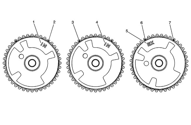

9. Remove the primary camshaft timing chain. Refer to Secondary Camshaft Intermediate Drive Chain Removal - Right Side See: Engine > Overhaul > Secondary Camshaft Intermediate Drive Chain Removal - Right Side.
pic 2
10. Remove the crankshaft sprocket from the nose of the crankshaft.
Installation Procedure
pic 3

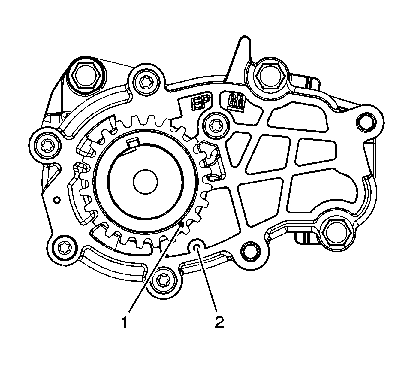

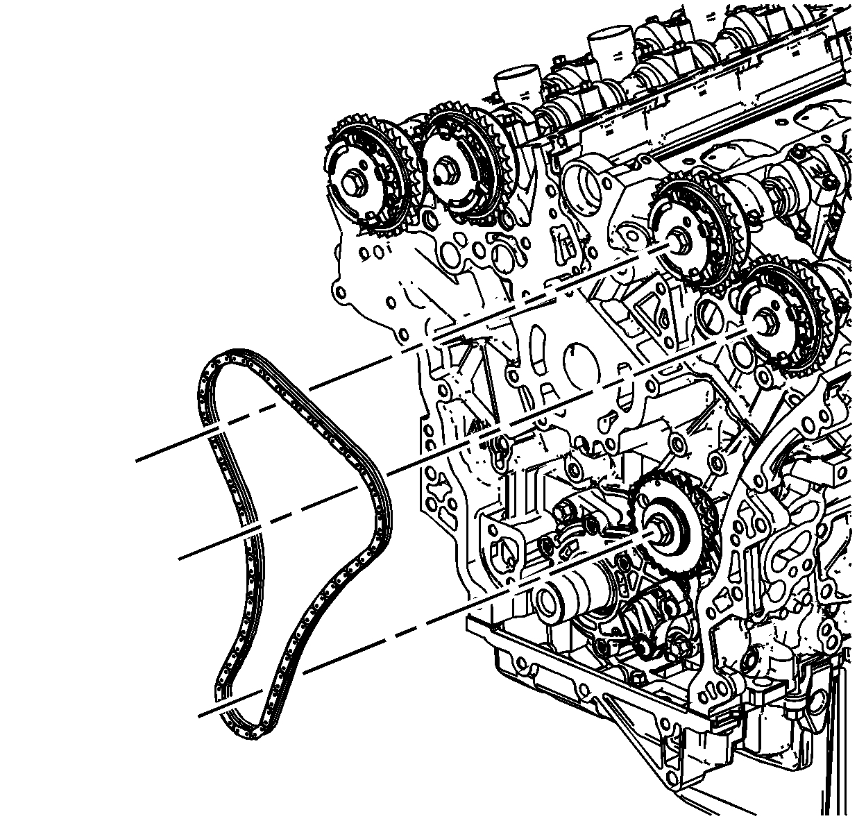

1. Ensure the crankshaft sprocket is installed with the timing mark (1) visible.

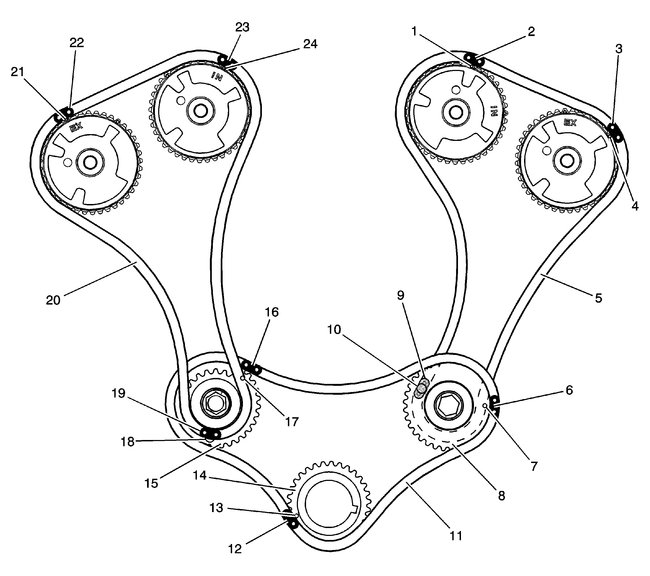

pic 4
2. Install the crankshaft sprocket on to the nose of the crankshaft.
3. Align the notch in the crankshaft sprocket with the pin in the crankshaft.
4. Slide the crankshaft sprocket on the crankshaft nose until the crankshaft sprocket contacts the step in the crankshaft.

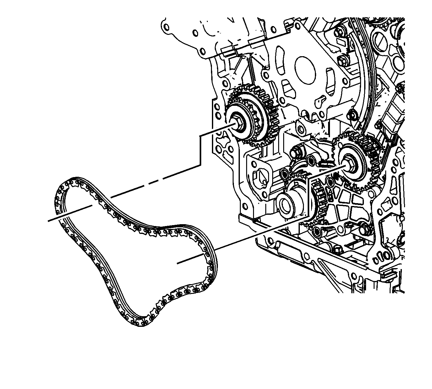

5. Ensure the crankshaft is in the stage one timing position with the crankshaft sprocket timing mark (1) aligned to the stage one timing mark on the oil pump cover (2) using the EN 46111 - crankshaft rotation socket. Refer to Timing Chain Alignment Diagram See: Timing Component Alignment Marks > Components > Timing Chain Alignment Diagram - Stage One.

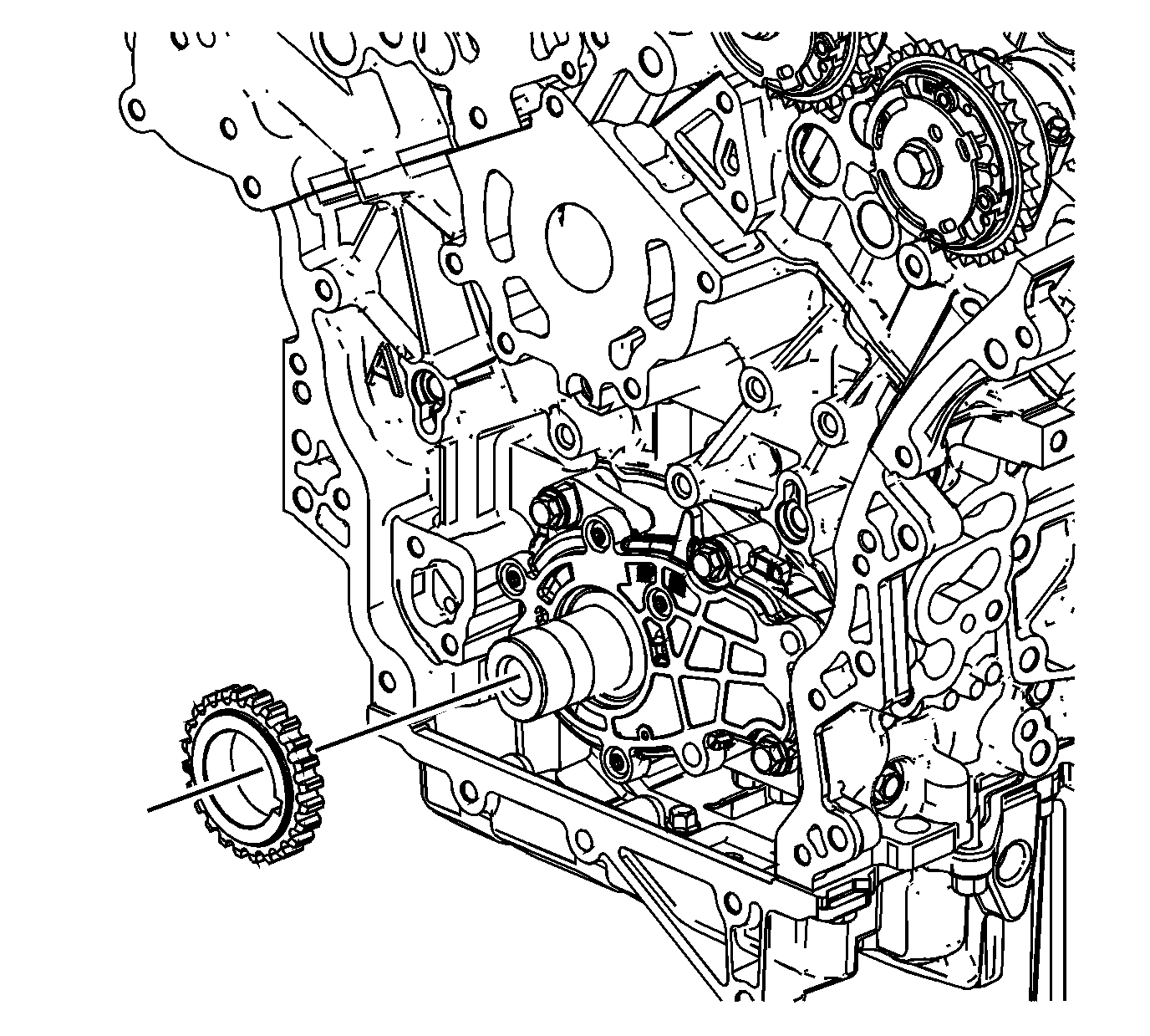

6. Install the primary camshaft timing chain. Refer to Primary Camshaft Intermediate Drive Chain Installation See: Engine > Overhaul > Primary Camshaft Intermediate Drive Chain Installation.

Timing Chain Alignments
Vehicle Engine, Cooling and Exhaust Engine Timing Components Timing Component Alignment Marks Locations Components Timing Chain Alignment Diagram
TIMING CHAIN ALIGNMENT DIAGRAM
Camshaft Position Actuator Timing Marks
pic 11
1 - Right Intake Camshaft Position Actuator Identifier
2 - Right Intake Camshaft Position Actuator Right Side Timing Mark- Triangle
3 - Left Intake Camshaft Position Actuator Left Side Timing Mark- Circle
4 - Left Intake Camshaft Position Actuator Identifier
5 - Exhaust Camshaft Position Actuator Identifier
6 - Exhaust Camshaft Position Actuator Right Side Timing Mark- Triangle
7 - Exhaust Camshaft Position Actuator Left Side Timing Mark- Circle
Stage One
pic 12
1 - Left Intake Camshaft Position (CMP) Actuator Timing Mark- Circle
2 - Left Intake Secondary Camshaft Timing Drive Chain Timing Link
3 - Left Exhaust Secondary Camshaft Timing Drive Chain Timing Link
4 - Left Exhaust Camshaft Position (CMP) Actuator Timing Mark- Circle
5 - Left Secondary Camshaft Timing Drive Chain
6 - Primary Camshaft Drive Chain Timing Link for the Left Primary Camshaft Intermediate Drive Chain Sprocket
7 - Left Primary Camshaft Intermediate Drive Chain Sprocket Timing Mark for the Primary Camshaft Drive Chain
8 - Left Primary Camshaft Intermediate Drive Chain Sprocket
9 - Left Secondary Camshaft Timing Drive Chain Timing Link for the Left Primary Camshaft Intermediate Drive Chain Sprocket, behind hole in sprocket
10 - Left Primary Camshaft Intermediate Drive Chain Sprocket Timing Window for the Left Secondary Camshaft Timing Drive Chain Timing Link
11 - Primary Camshaft Drive Chain
12 - Primary Camshaft Drive Chain Timing Link for the Crankshaft Sprocket
13 - Crankshaft Sprocket Timing Mark
14 - Crankshaft Sprocket
15 - Right Primary Camshaft Intermediate Drive Chain Sprocket
16 - Primary Camshaft Drive Chain Timing Link for the Right Primary Camshaft Intermediate Drive Chain Sprocket
17 - Right Primary Camshaft Intermediate Drive Chain Sprocket Timing Mark for the Primary Camshaft Drive Chain
18 - Right Primary Camshaft Intermediate Drive Chain Sprocket Timing Mark/Window for the Right Secondary Camshaft Timing Drive Chain
19 - Right Secondary Camshaft Timing Drive Chain Timing Link for the Right Primary Camshaft Intermediate Drive Chain Sprocket
20 - Right Secondary Camshaft Timing Drive Chain
21 - Right Exhaust Camshaft Position (CMP) Actuator Timing Mark- Triangle
22 - Right Exhaust Secondary Camshaft Timing Drive Chain Timing Link
23 - Right Intake Secondary Camshaft Timing Drive Chain Timing Link
24 - Right Intake Camshaft Position (CMP) Actuator Timing Mark- Triangle
Let me know if that helps or if you have other questions.
