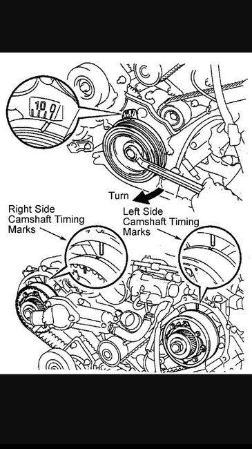

Customer removed Camshaft now i need alignment marks for camshafts for left side and right side

Check image out let me know if this helps
