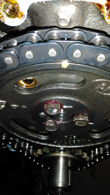

I got the paper work on the engine with the purchase, it was puchased through a dealership 2014. As a crate 350/290 truck engine I had this extreme banging noise from the front. ( Starts and runs) except for bad noise. So I remove front of the engine and timing chain cover and two of the three cam gear bolts are hanging out.
So go to remove to check threads and re-tap, I have engine at TDC, I thought!
So upon inspection I noted dot on crank is twelve o'clock but so is the cam sprocket. I thought all Chevrolet's were twelve and six o'clock. so I rotate several times and watch rockers (1) sure enough after intake closes and both are closed it approaches TDC the dots are six and twelve. Did Chevrolet make some like this? Or is something off?
It is like the cam sprocket is 180 off, but it would not run if that was the case.

I must have, mis spoke, when the 1 is TDC. The dots on crank are 12 o'clock, and cam sprocket dot is at 12 o'clock also. At no time are dots together is #1 ready to fire, when dots are together, the distributor is 180 from #1, but this thing was starting and running, I maybe over thinking this.

Correct, but on the firing stroke (1), piston is TDC, the dots are 12 on the crank, 12 on the cam dot, I am beginning to think , distributor is off and that is throwing me off in my head.

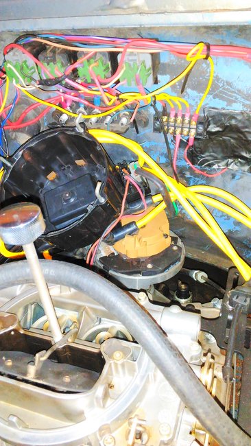

In this picture, we are TDC , intake valve has just closed. And distributor just passed #1. See where the marks are?

MARK FRIZZELL
  • 142 POSTS
I am thinking the distributor is off by a 1/4 or so, but this engine fires right up, but skeptical on how it ran. I had trouble timing it with a light plus the extremely loud banging.

The Goodwrench engines are the same there is no difference. Is the rotor pointing to #1 or #6 when the timing gear mark is at the top, should be #6.
Oct 18, 2017 at 4:40 AM
MARK FRIZZELL
  • 142 POSTS
I know it is pointing to #1.

I am just going to start over on this. from the beginning, pull plugs distributor, and put it were it should be, I think he has put distributor in wrong, and just satisfy myself, until I do I am going be guessing in my mind. I asked if engine only had 5,000 on it why did you open it, he said he adjusted the valves and replace gasket. I am not believing that.

I just verified, at no time the two timing dots are together (12 and 6) the distributor in the #1 position it is always 6 o'clock on the distributor when two dots are together.
Oct 18, 2017 at 5:52 AM
MARK FRIZZELL
  • 142 POSTS
I did finds some sbc' s with the cam dot at 12 oclock, I'm gonna go with the way it was , it started and run but did see the dist was off a tooth, so I'll let know how it goes

Will do, , I triple checked it I even checked to see if there were 2 marks on cam sprocket. There is only one, but I did notice white paint at 12oclk , these were factory marks on 12 on block also.will up load in a day or so
