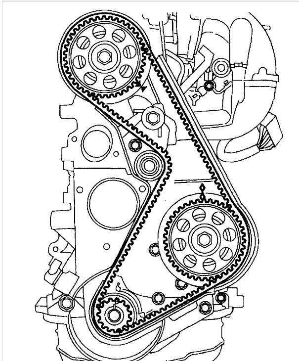

It was definitely the tensioner. It was new but i mustve messed it up on install cuz I warrantied it and put the other new one on and the noise is gone completely. Only thing now is it’s like a tooth off for timing. I don’t have the plastic inner cover so I’m not 100% sure of the timing marks. Is there anyway to know without the back cover? Like marks on the actual block or anything?
Apr 21, 2026 at 11:25 AM
  • 55,732 POSTS
Nice work!, here is the marks for the timing belt without the cover. Check out the images (below). Let us know if you need anything else.

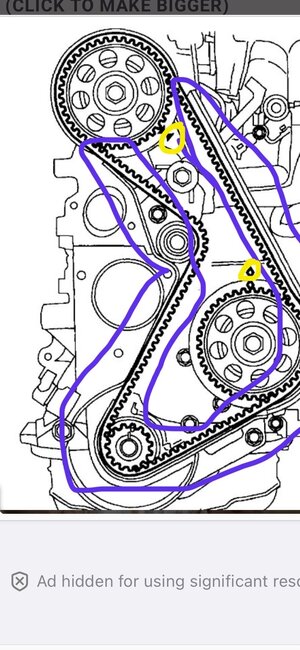

But in that image the plastic inner cover is there. I don’t have that part. That’s the part that has the corresponding diamonds on it. I’ll circle the cover in purple and the diamonds in yellow. This is the part I don’t have
Apr 22, 2026 at 2:25 AM
  • 55,732 POSTS
Hmmm, bummer, you kind of need that to line up the timing marks, you are going to need to estimate the timing marks position according to the diagram, the only other way is to remove the valve cover and #1 spark plug. Bring the #1 piston to TDC and then split the camshaft lobes on #4 cylinder which is the related cylinder, (intake valve open and exhaust valve open the same amount) at this point the engine is in time. Let me know how it goes.
