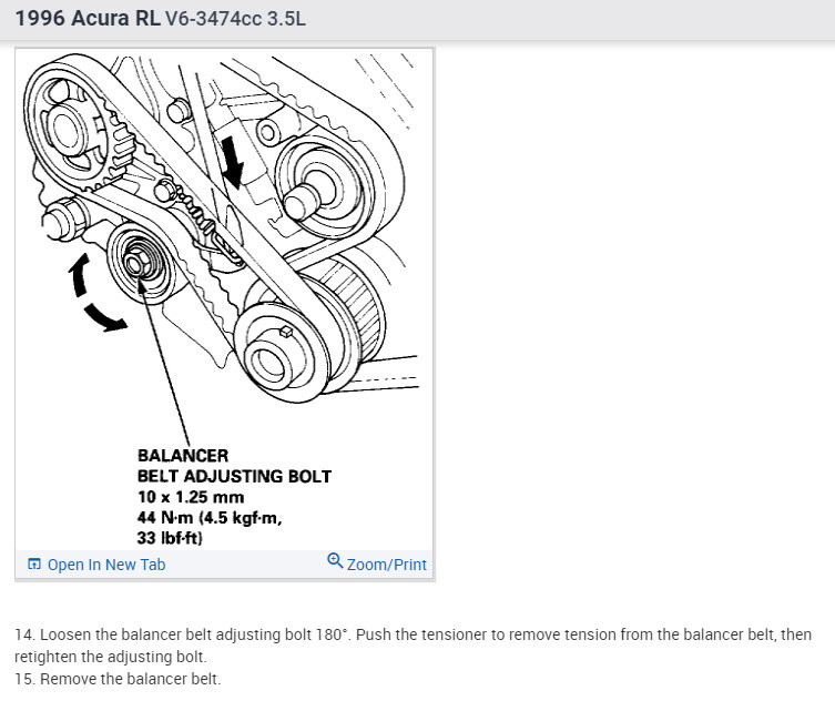

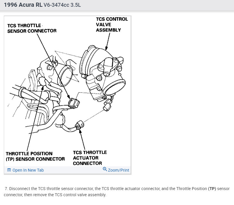

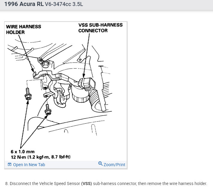

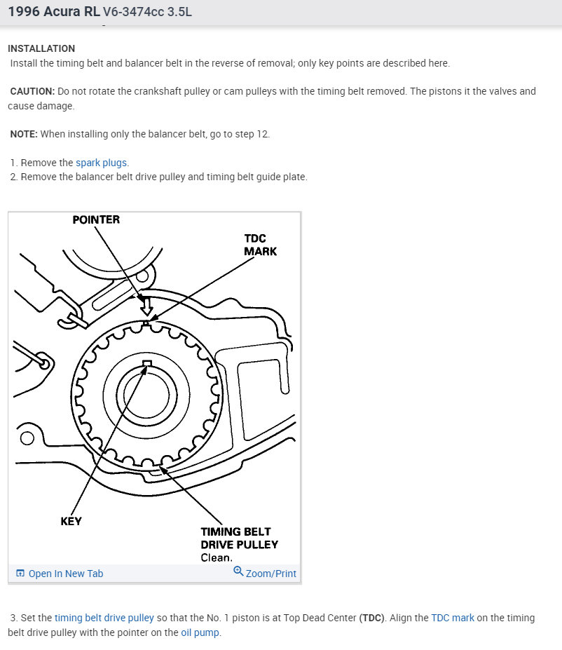

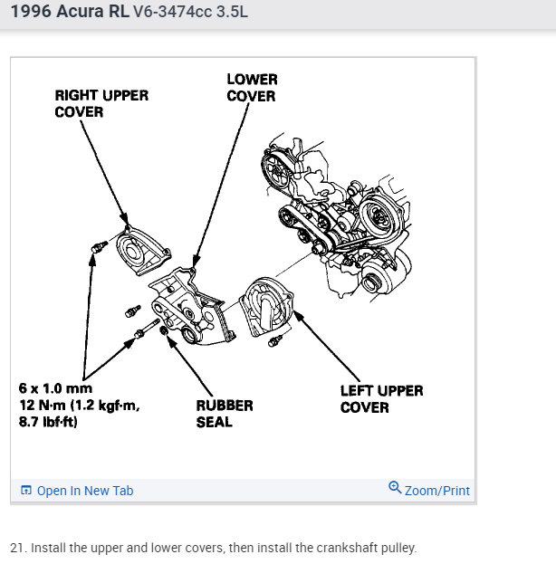

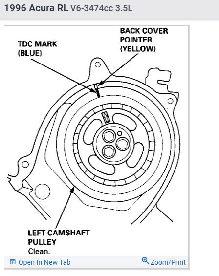

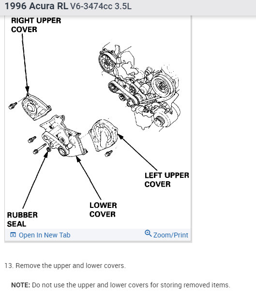

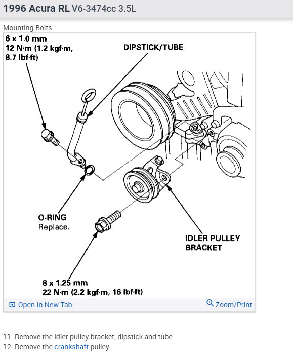

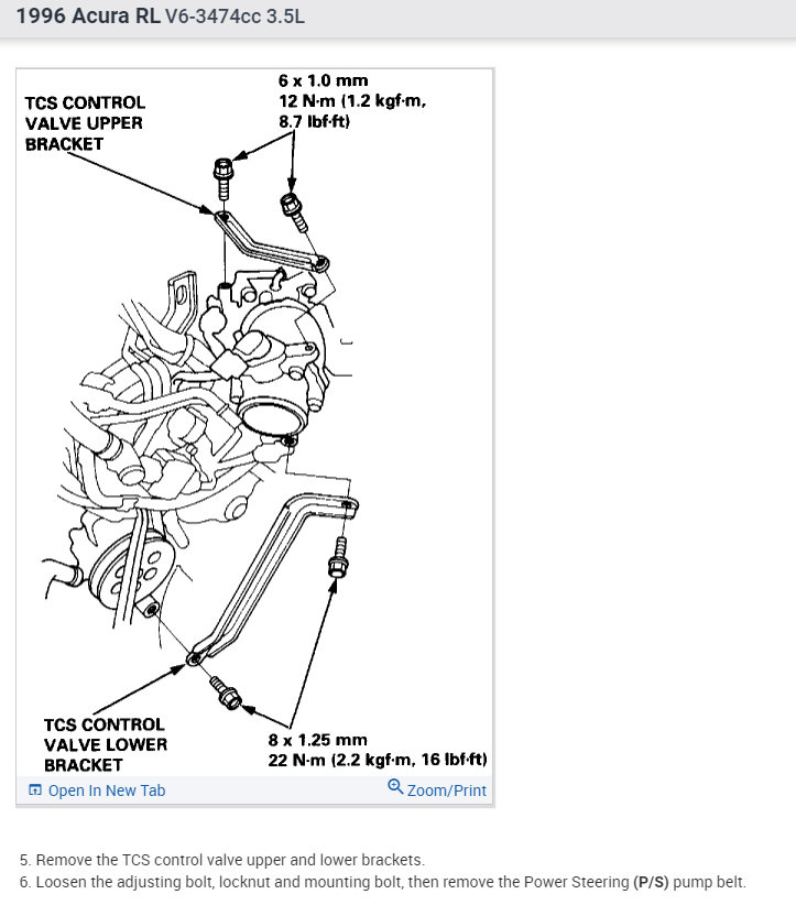

I pulled the cover off and the tensioner and pully was behind it and popped off. how do I get it back on?
May 25, 2022 at 7:21 AM
SQM
  • 6,383 POSTS

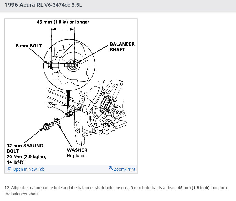

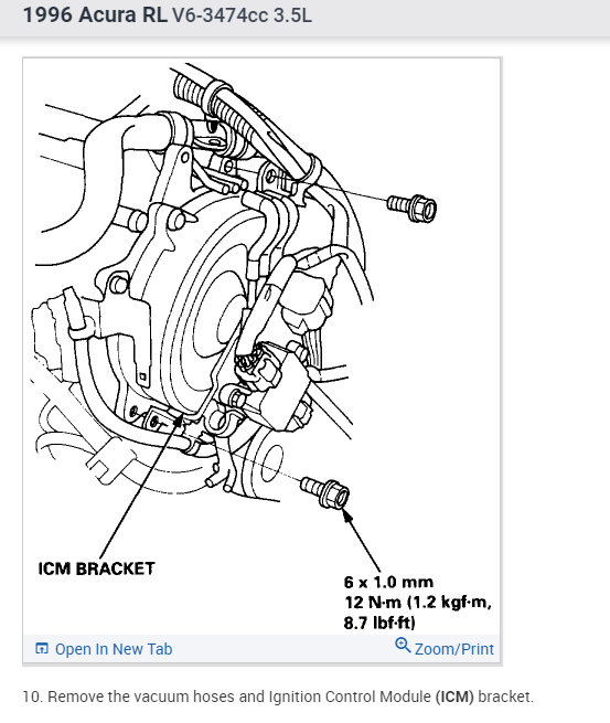

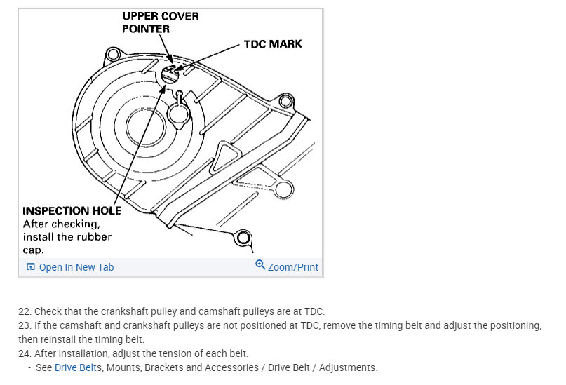

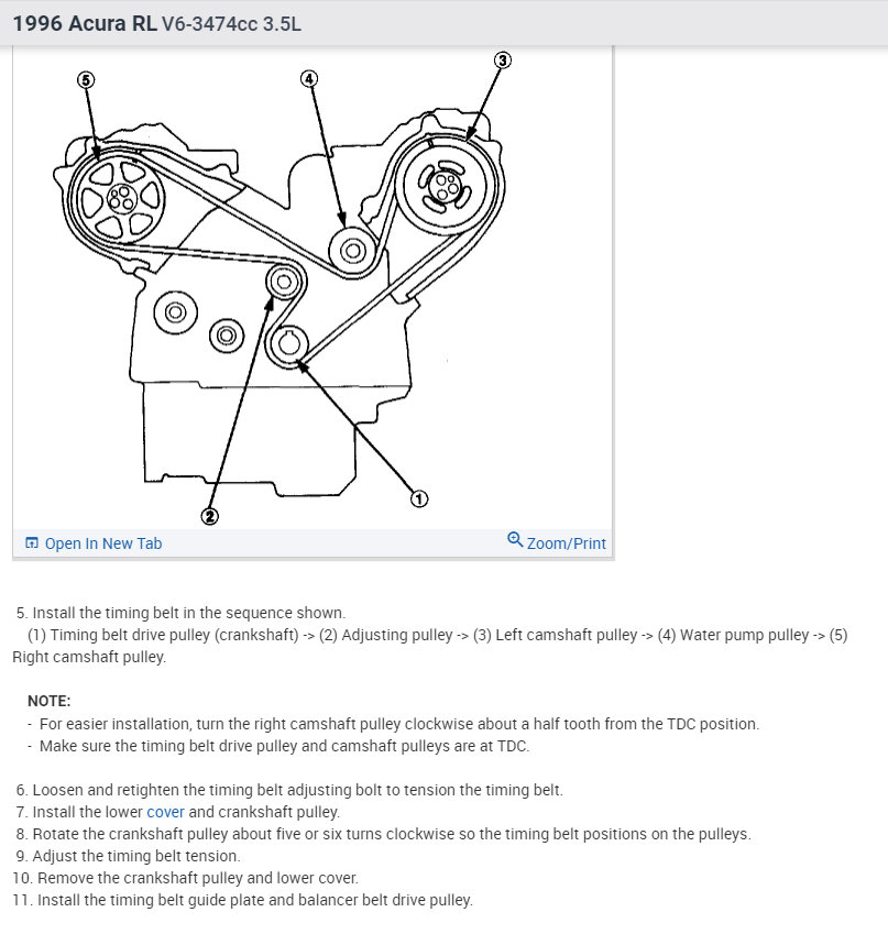

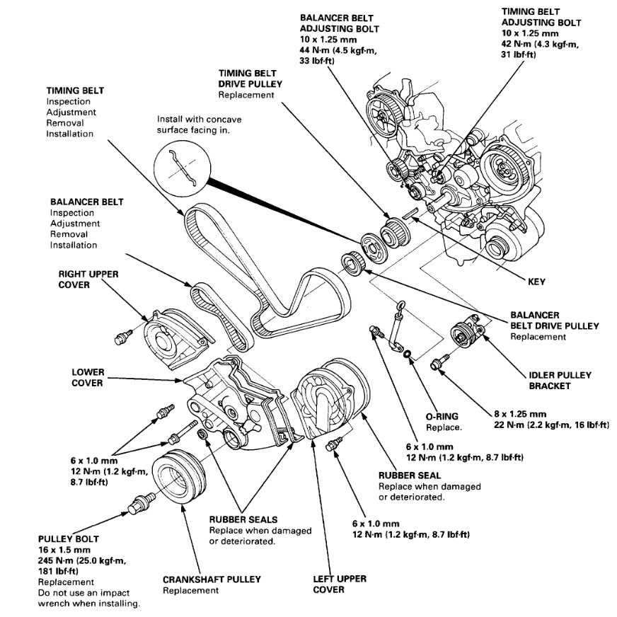

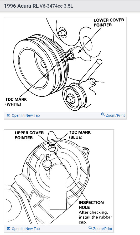

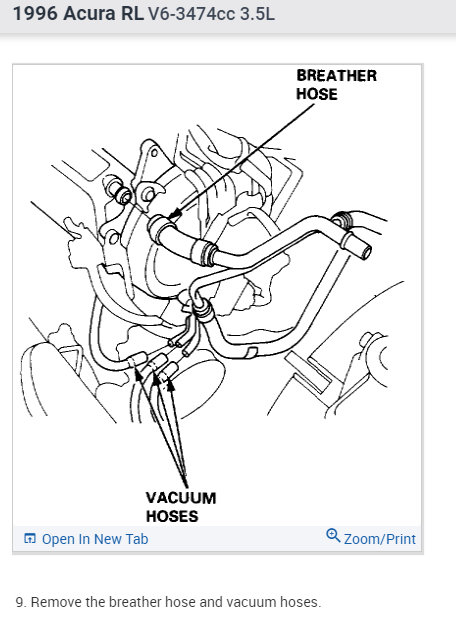

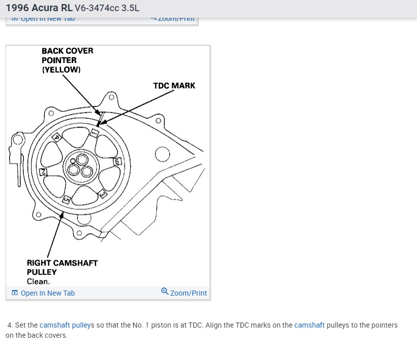

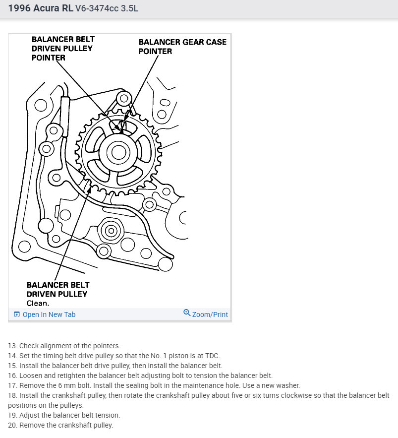

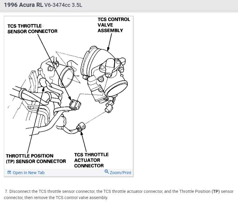

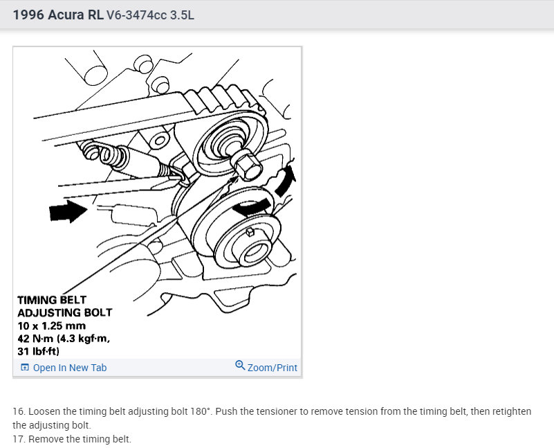

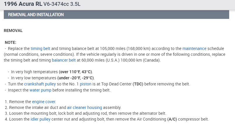

The best option would be to remove the timing belt and re-install to ensure everything is properly aligned and timed.
This way you will be able to first install the tensioner then put on the belt.
https://www.2carpros.com/articles/how-a-timing-belt-works
I have attached the timing belt procedure below including all the markings and torque specifications.
Let me know of any questions.
