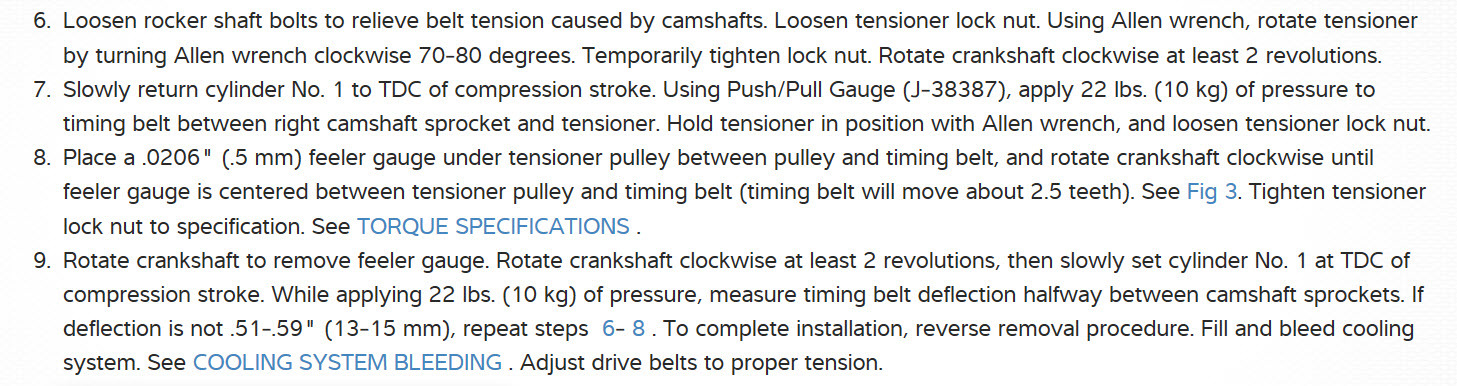

There are three different timing chain tensioners so you need to know which one or all of them. this is best left to pros if you don't have a manual to use to do it. It will also take you longer than the time given if never having done this or not familiar with it.
This guide can help you fix it
https://www.2carpros.com/diagrams/nissan/xterra/2004

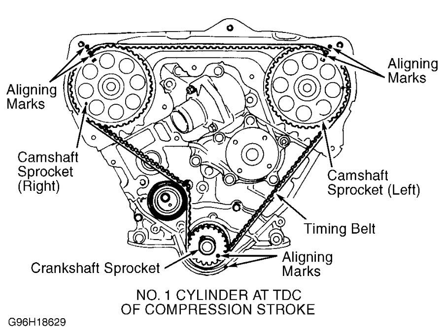

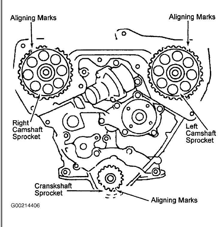

Timing belt broke and wanted to know if the right timing is the marker on the block match themarker on the gears also if you could give me from start to finish instructions on how to time it

Make sure to read all instructions along with pics. If car starts and it misfires it may be bent valves as this is an interference engine. Check out the diagrams (Below). Please let us know if you need anything else to get the problem fixed.

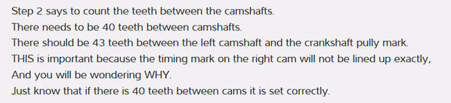

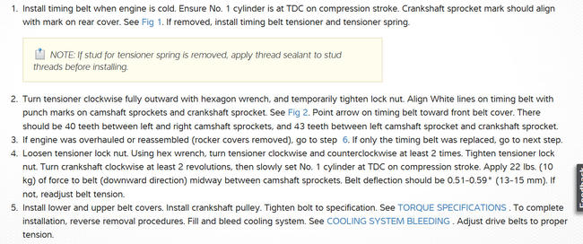

I have been struggling with P0030 code (multiple cylinder misfire) and have replaced literally everything.
Finally removed front of engine, put crankshaft at Top Dead Center, one camshaft pulley the timing marks lined up perfectly, the other would line up if I moved the crankshaft to 15 degrees before Top Dead Center was exactly one tooth, so I fixed that and it runs way worse.
Took it apart again, rotated the crankshaft and all marks line up perfectly.
The camshaft that was off was not for cylinder number one.
Do I need to re-time the engine anyways?
