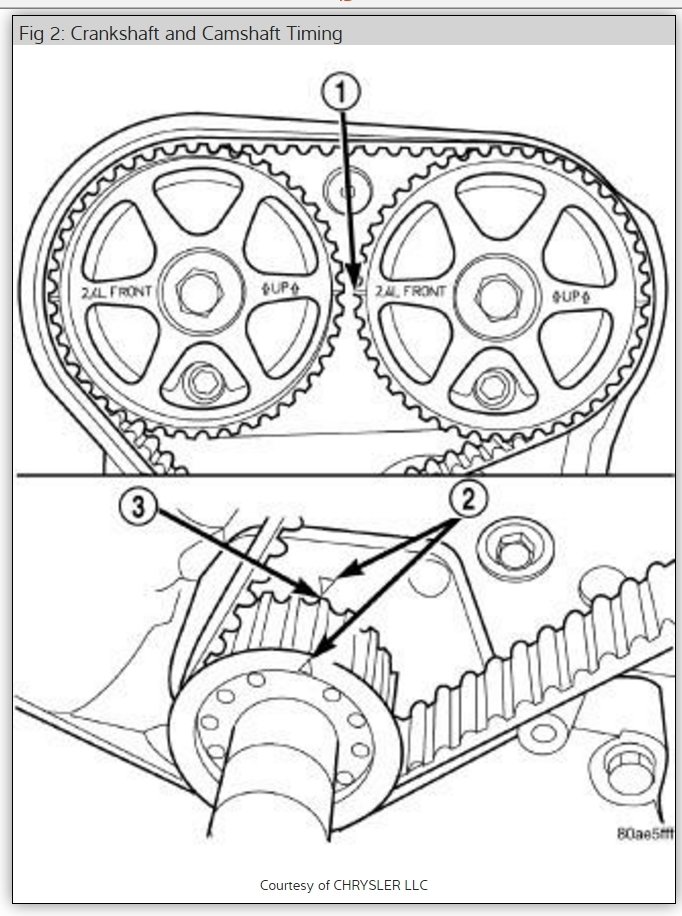

would timing belt slipping cause the engine to start sounding like its sucking gas, shut radio off for a second then conninue on but still not sound right
Oct 9, 2016 at 11:31 AM
  • 54,832 POSTS
Yes it would, it would also make the engine have low power, here is a diagram of the timing belt marks.
Please let us know what you find so it will help others.
