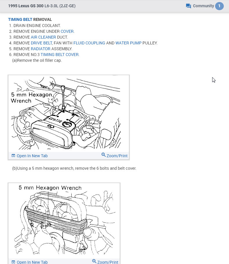

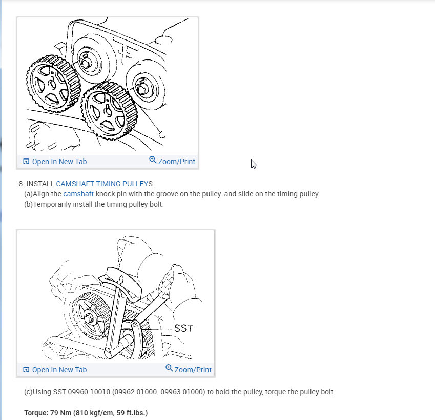

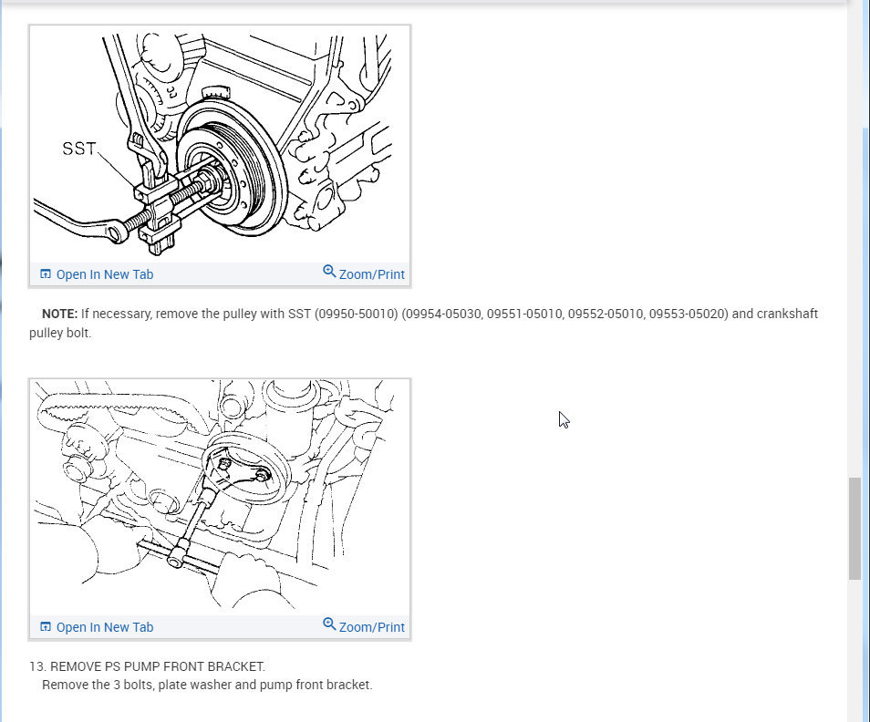

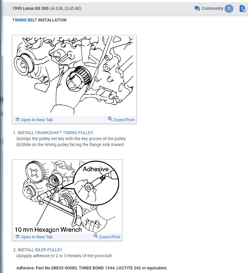

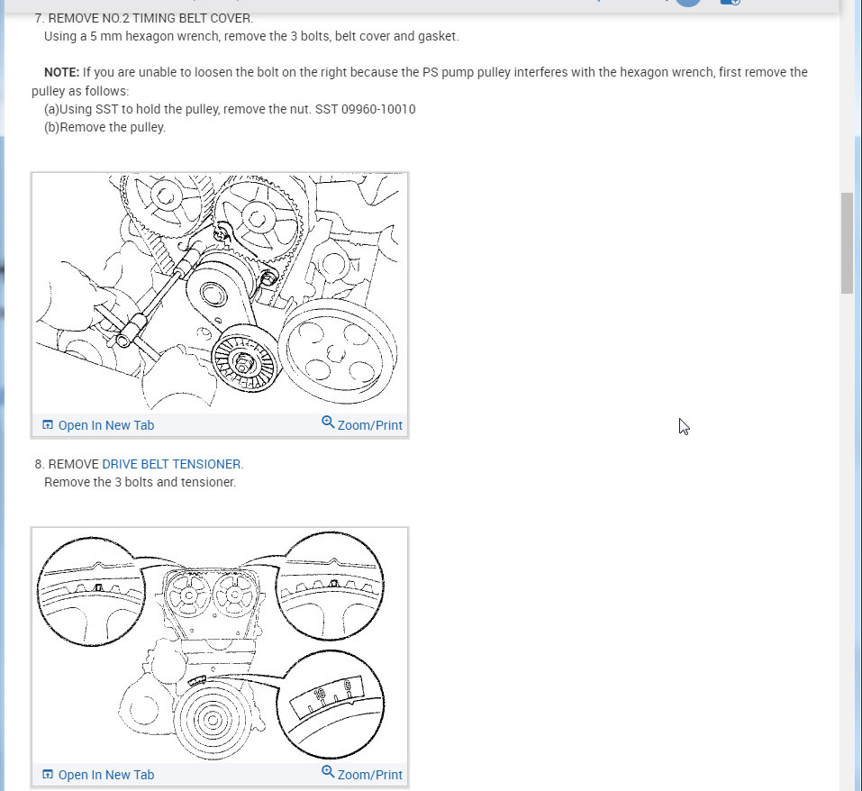

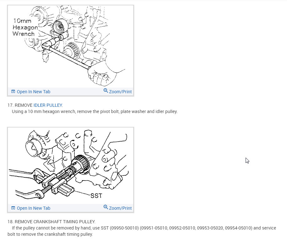

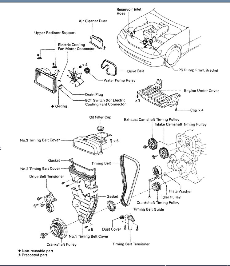

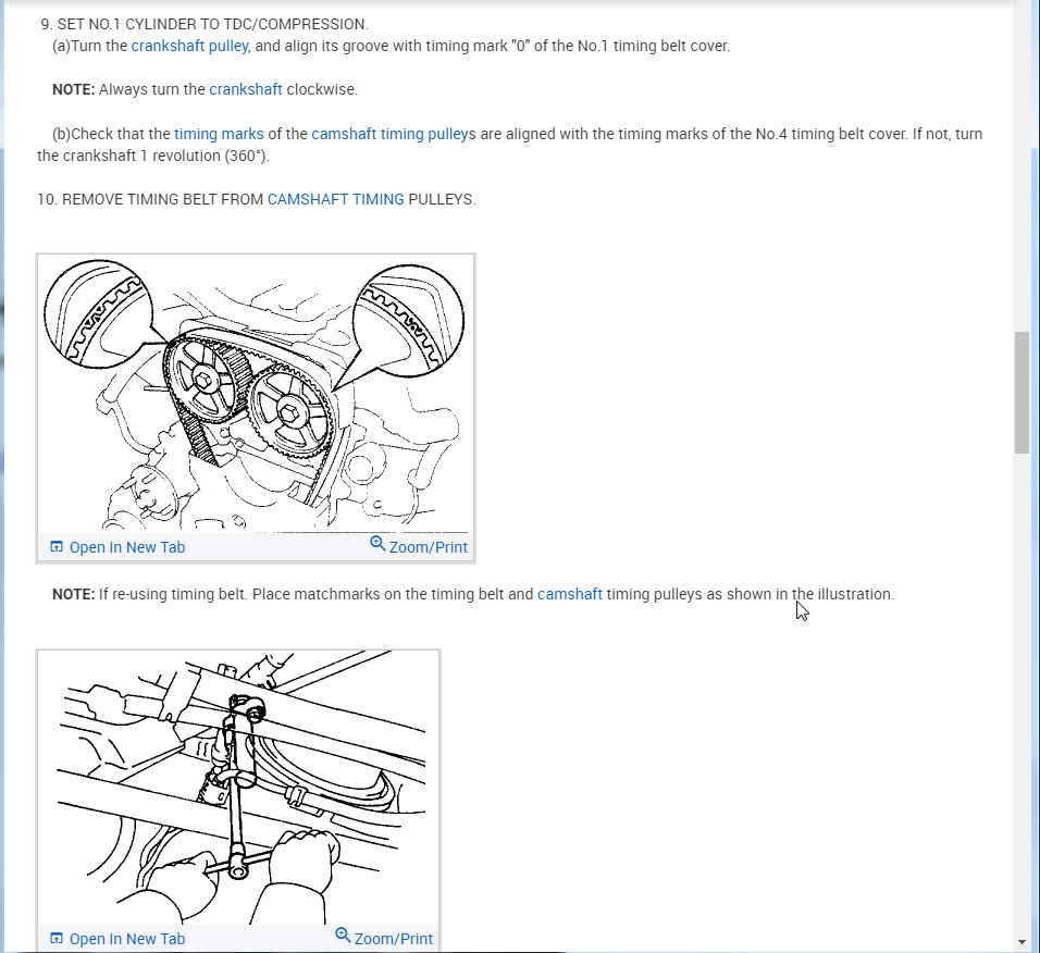

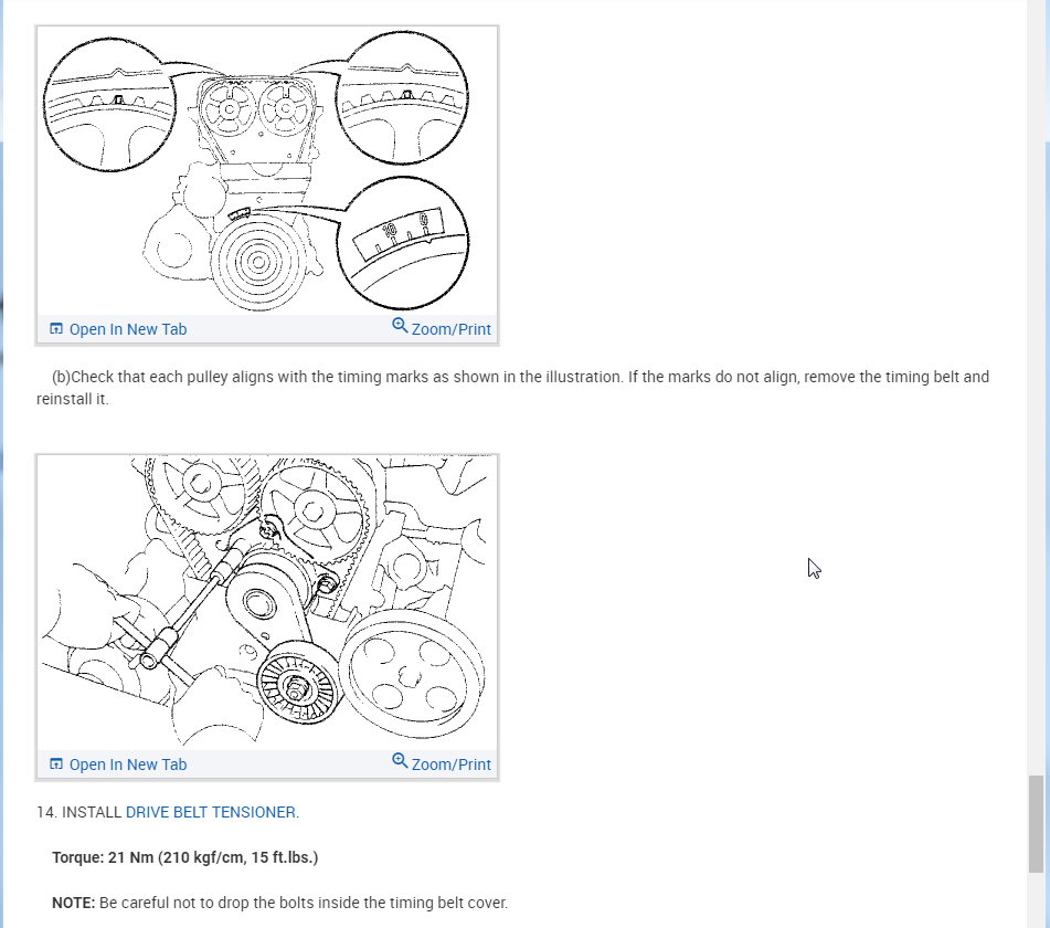

Hello. I need to change the timing belt to this vehicle listed above 2jz-ge (non vvti) and i want to know if you can send me the procedure to perform this job correctly?
I will appreciate your help.
Thanks,
Juan Marin
Aug 17, 2020 at 1:23 AM

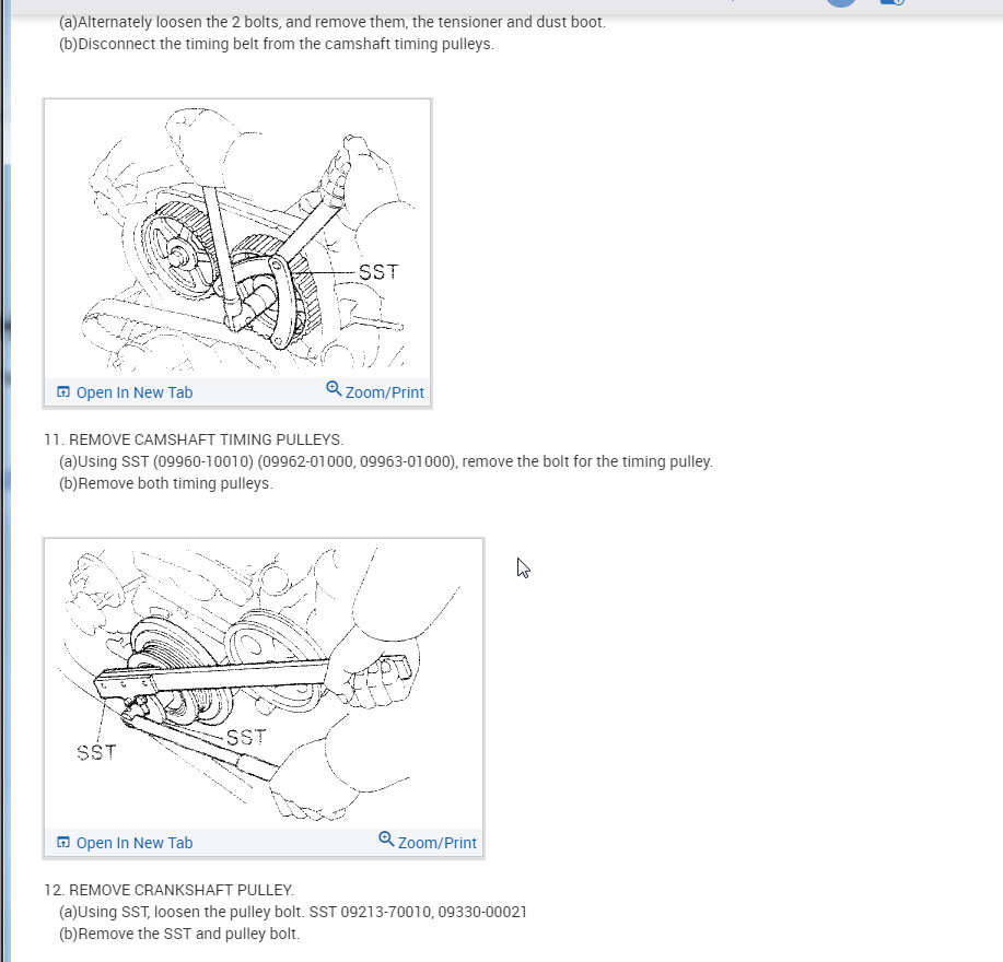

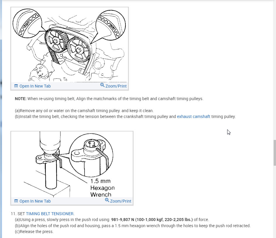

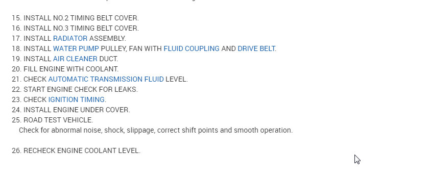

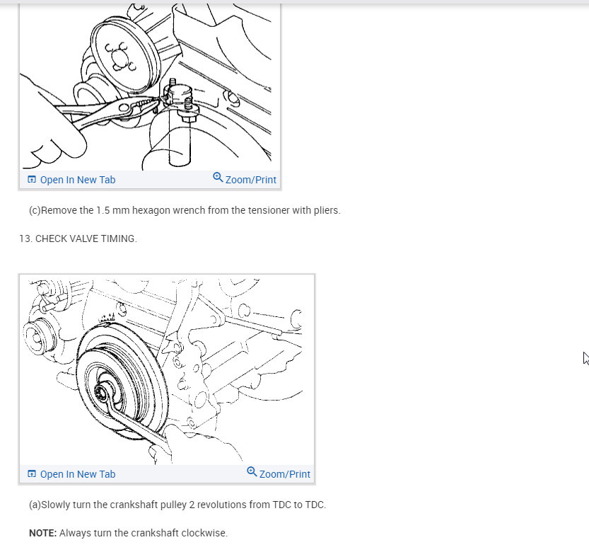

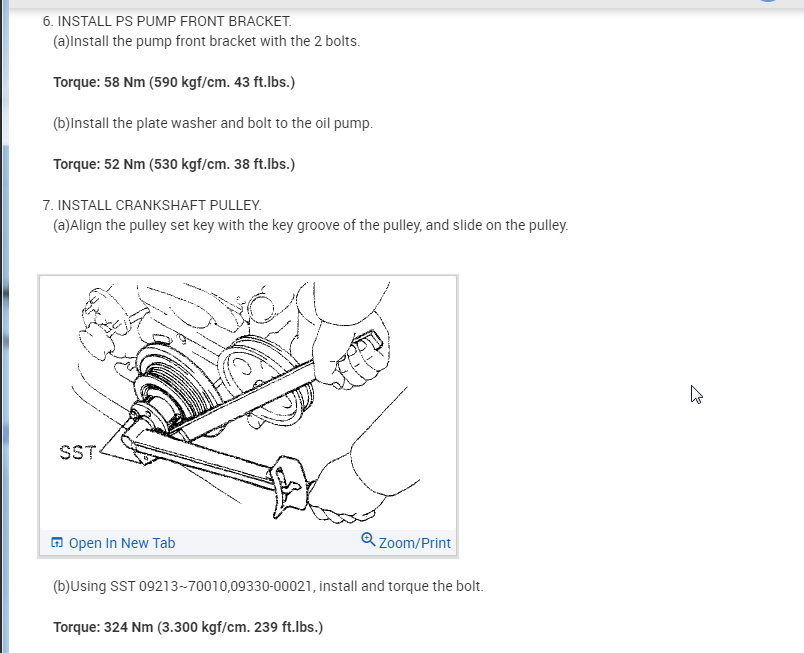

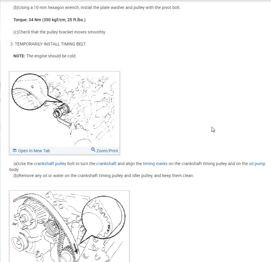

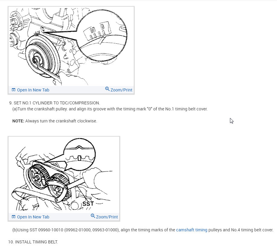

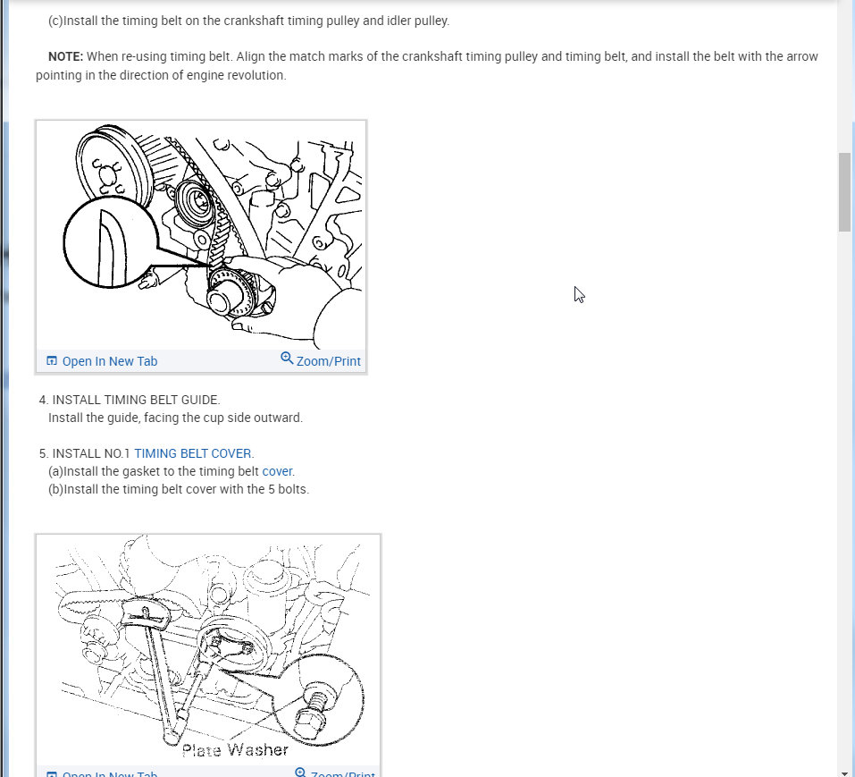

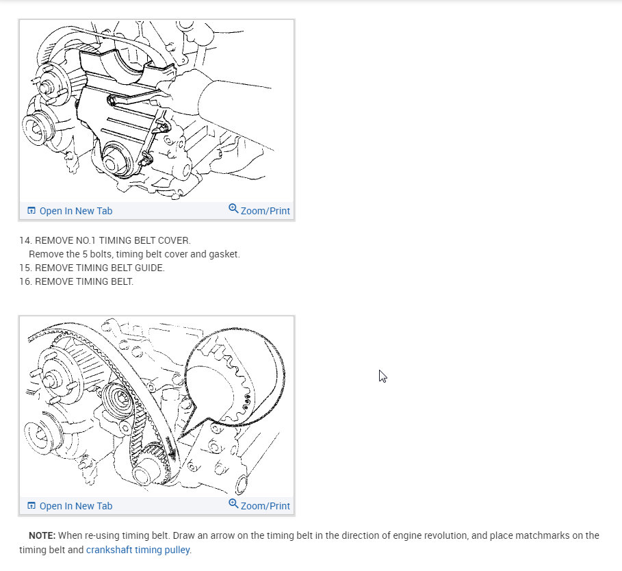

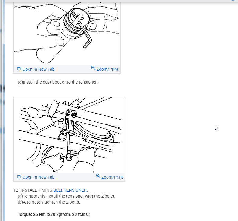

Attached is the entire process from the manual. Let us know if you have other questions on this. Thanks

Thank you so much. The job was done excellent! With your help.
