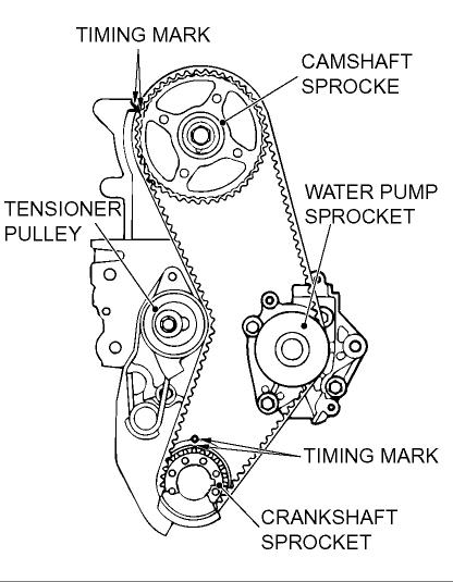

how to align timing marks on my lancer the belt is already installed but i think my cam gear has turned a little bit because i don,t have the power i had before.That is all i need for now and i thank you for your support.
Bob
May 23, 2013 at 9:23 AM
Here is a page that sows you everything you need to know about changing the timing belt
https://www.2carpros.com/diagrams/mitsubishi/lancer/2005

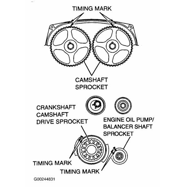

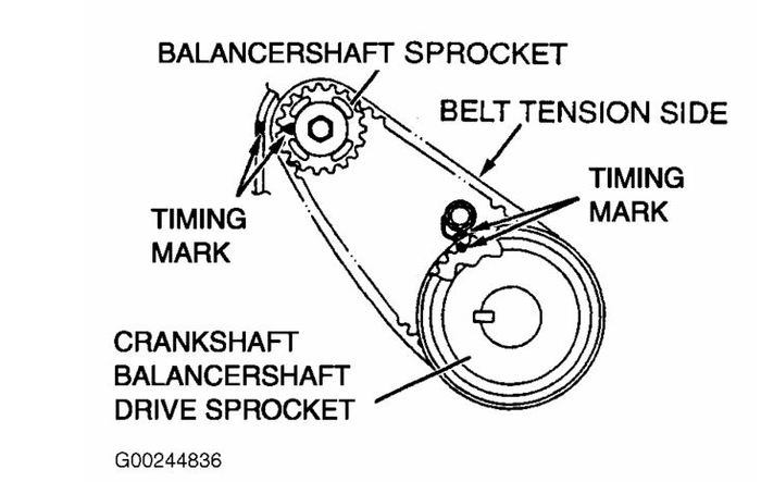

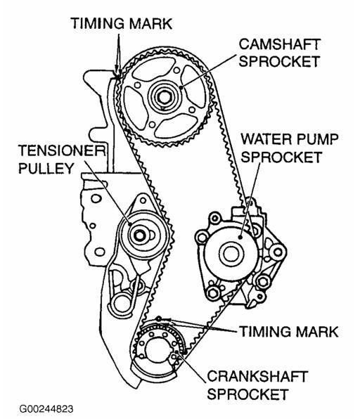

Timing belt "teeth" are stripped, it did this when I tried to crank it. I am trying to find a diagram of some sort to show where the timing marks are and how it should be aligned when repairing. Thanks
Dec 3, 2020 at 1:45 AM (Merged)
DRCRANKNWRENCH
  • 3,380 POSTS
I am giving you the single and dual cam setups and the balancer shaft diagrams.

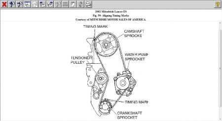

ANTHONYT1967
What are the timing marks for this model?
Dec 3, 2020 at 1:47 AM (Merged)
  • 75,992 POSTS
https://images.2carpros.com/forum/automotive_pictures/12900_timing_marks_9.jpg

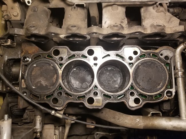

So, my timing belt snapped awhile ago and I've since disassembled much of the engine compartment in order to open up the engine. I've very recently removed the cylinder head in order to test whether or not the valves are sealing (interference engine) and saw coolant on top of the pistons. I'm curious as to what could have caused this and whether it happened as I was removing the cylinder head or if it was the most likely cause of timing belt failure in the first place.
Thanks!
CARADIODOC
  • 34,380 POSTS
Don't panic. This is typical when removing a cylinder head. The head is full of coolant, and there's a number of passages that pass through the head gasket. Even though you likely drained the coolant first, there's a lot hung up in those passages that doesn't drain out, that is, until you unbolt the head and shake it around.
https://www.2carpros.com/diagrams/mitsubishi/lancer/2002
Use rags to soak up the coolant on top of the pistons. If it seeps past the piston rings and gets into the oil, antifreeze will melt the soft outer layer of engine bearings. Change the oil before starting the reassembled engine to get the coolant out.
STILLY5
Thanks! I've already drained the oil previous to this and plan on refilling it as soon as I get it all put back together. I plan on taking the cylinder head to someone else to get the valves replaced but should I go to a mechanic or machine shop? I know that almost all of the valves hit the pistons heads but I don't see any cracks in the pistons from the top.
DOCFIXIT
  • 18,828 POSTS
Post pic of gasket can tell if problem but go with Caradioc probably poured in from head. This engine does bend valves so likely that occurred and go with machine shop to have head done. If u plan on keeping have a complete valve job ie. seats cut and valve seals replaced.
