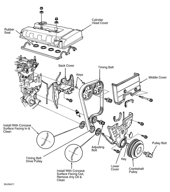

Timing belt broke and while I was taking it apart. I noticed rub marks on the cover from the belt, so I replaced the belt only with a new one. When tbd motor started the new timing belt walked forward about a quarter of an inch, so I replaced the tension-er and that did not help. Now I do not know what to check.

If you have everything together and the pulleys all line up, there should not be an issue. The only thing I can recommend you confirm are the two belt guides located behind and in front of the crankshaft pulley. Make sure they are facing the correct directions. I have attached a picture for you to see how they go on.
