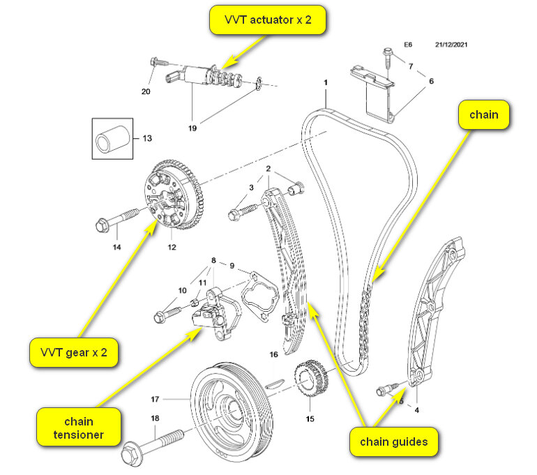

Your vehicle is equipped with the GM 1.0L Ecotec L5Q engine.
This engine is fitted with a timing chain and not a belt.
See image 1
Common issues are a stretched timing chain, usually around the 40k mile mark.
At 7k miles this should not have happened.

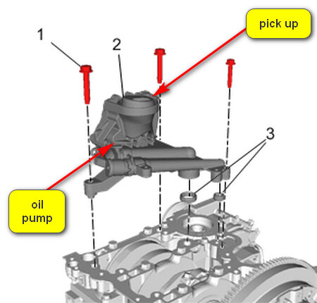

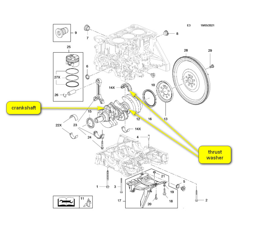

Also, they should check that the crankshaft does not have any excessive axial float.
0.3mm is the maximum permissible play.
See image 2 regarding possible collapsed thrust washer.
This is a frequent occurrence on the 1L and 1.4L engine.

The common issue with this engine is the crankshaft axial float. Vauxhall is well aware of this issue.
The most economical way forward would be engine replacement if you are planning on keeping the vehicle.

I would suggest getting your mechanic to check the engine for possible crankshaft axial float, the main issue which would require engine replacement.
If the axial float is within factory tolerances (0.3mm max) then it would be worthwhile to investigate the oil supply issue.

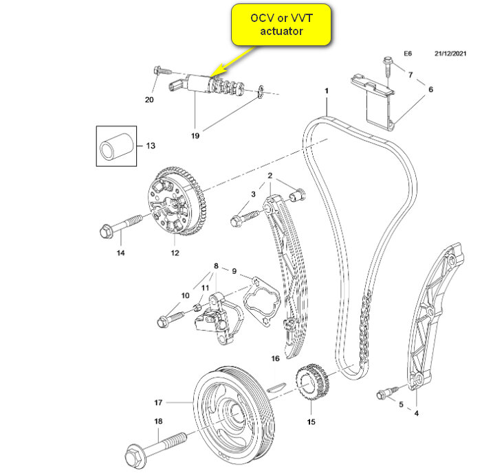

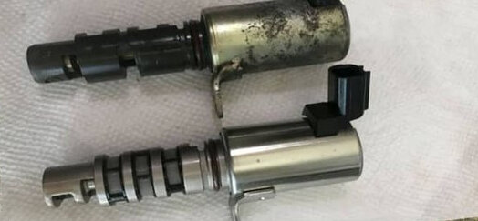

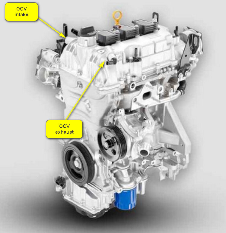

Most common issue with oil supply to the camshaft gears are the OCV (oil control valves) also called the VVT actuator solenoids. Get the mechanic to remove these 2 solenoids, identical parts (12636524), and inspect the mesh screens for any metallic debris. If present this would mean possible engine bearing failure and no further repair is advised.
A short video:
https://www.youtube.com/shorts/Yt9nik-Zn8Y?feature=share
If no metallic debris is found then next it would be advisable to clean these solenoids, check internal resistance (7-12ohm) and swap sides, intake to exhaust. As P0014 is set this would indicate a possible issue with the exhaust OCV, so swapping it to the intake would prove if the solenoid were faulty if after swap fault code P0011 sets.

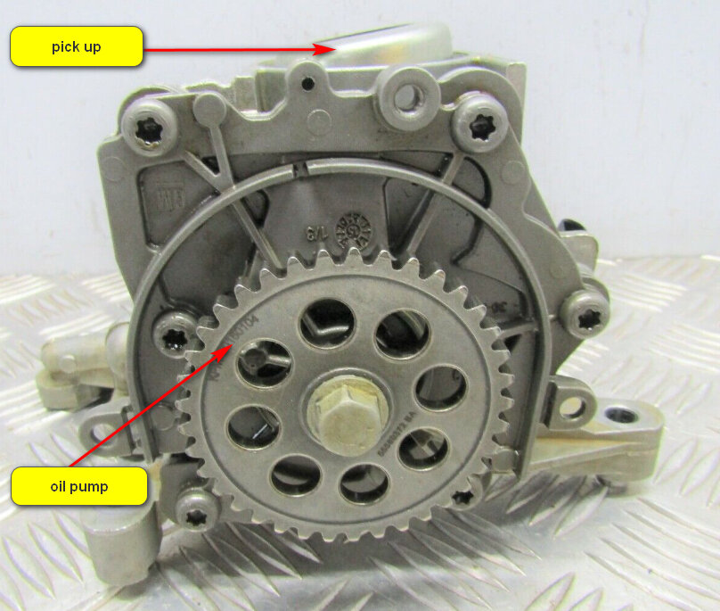

Oil pump failures are not common at such low mileages on these engines.

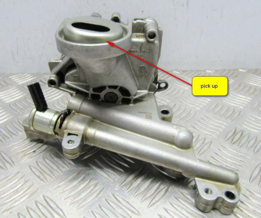

BORIS K
  • 836 POSTS

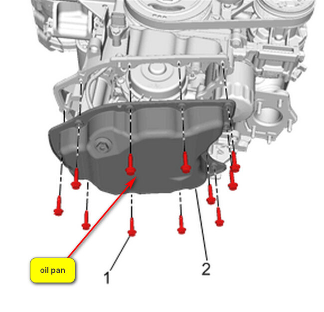

I find it strange that your mechanic would charge you for a separate oil pump suction tube/pipe as the oil pump pick up is part of the oil pump housing. Unless the oil pump pick up was cleaned as it could have been contaminated.
While the lower oil pan was removed (to access oil pump) were any metallic debris found?

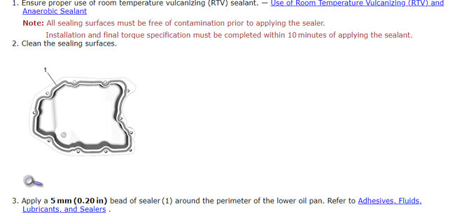

I do not see the need for any gaskets btw, the lower oil pan only uses sealant.
The valve/rocker cover requires a new gasket and so does the new timing chain tensioner.
Labour time charged for this job should have been around 6.5 hours.
