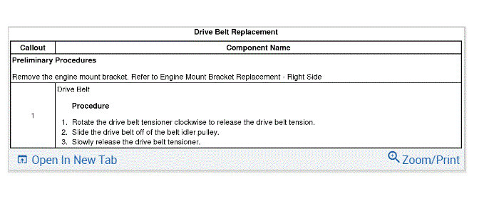

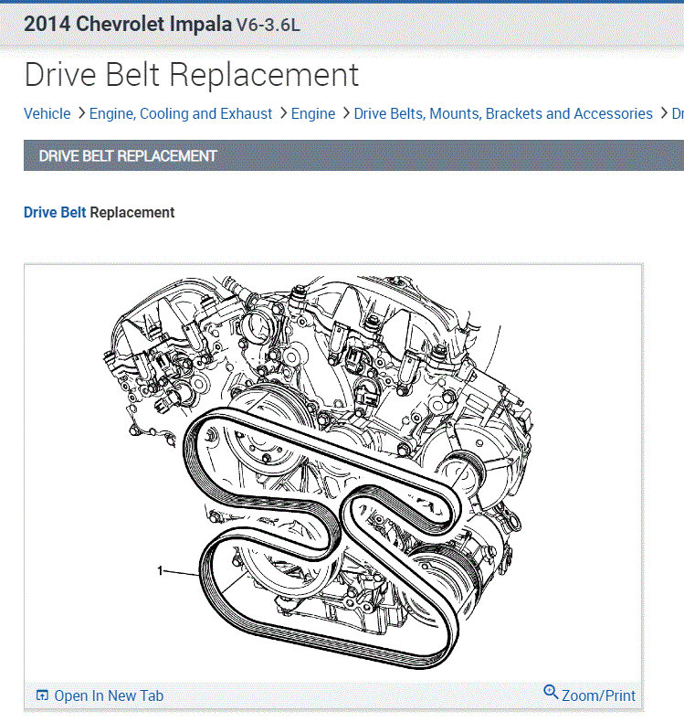

I had my water pump replaced and now they don’t know how to put the serpentine belt back on.
Jun 2, 2022 at 1:35 PM
  • 110,244 POSTS
The vehicle doesn't have a timing belt. Did they tell you they replaced the timing belt? If so, that is a concern.
As far as the accessory drive belt is concerned, I attached the directions and a picture showing belt routing. Is this what you needed or was it something different? There is a big difference between a timing belt and a serpentine belt. I just want to confirm. Especially in this case when there is no timing belt. LOL
Let me know. Also, let me know if you have other questions.
