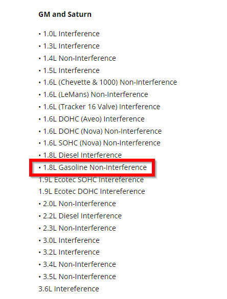

Third, is this an interference engine or not?

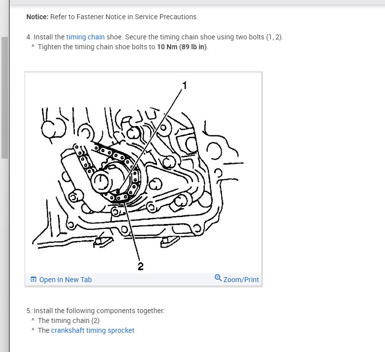

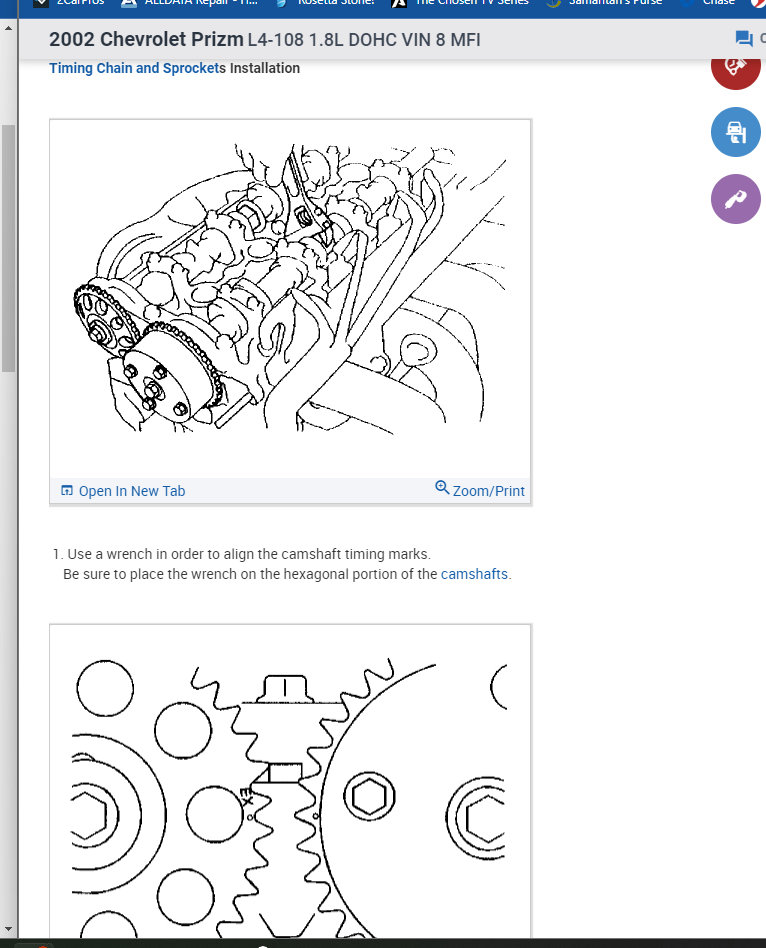

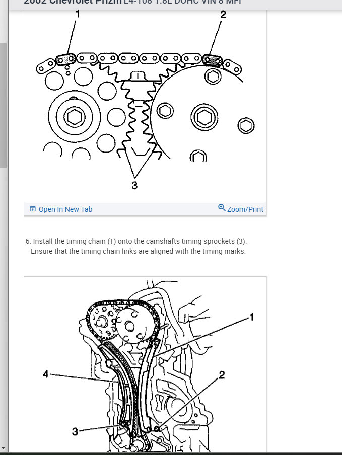

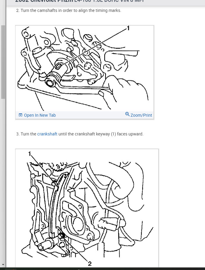

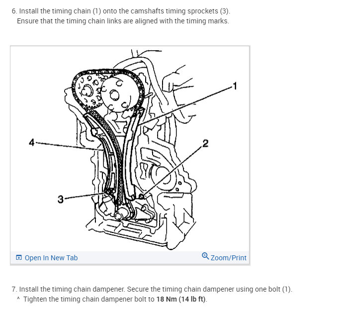

This will be an easy one for you. This is a timing chain for this engine, so it only needs to be replaced if there is a reason to replace it. There are no maintenance intervals on chains.
https://www.2carpros.com/articles/serpentine-belt-timing-belt-timing-chain-diagrams
However, if you need to replace this, I attached the process below on how to do this.
Please let us know what other questions you have.
Thanks

So, with it being a chain driven engine, is it not interference? That's what I'm worried about. I'm looking at putting it on the street some days for 9 to 12 hours. I don't mind if the chain breaks or slips, so long as I don't have to replace the engine due to smashed valves and pistons.

Understood. Looks like this engine is non-interference.
