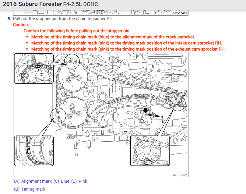

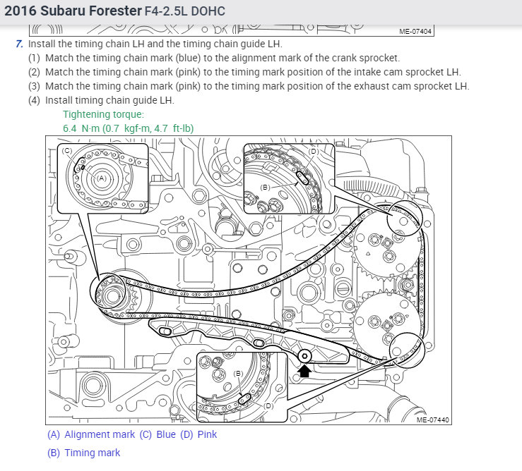

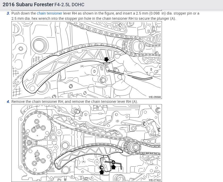

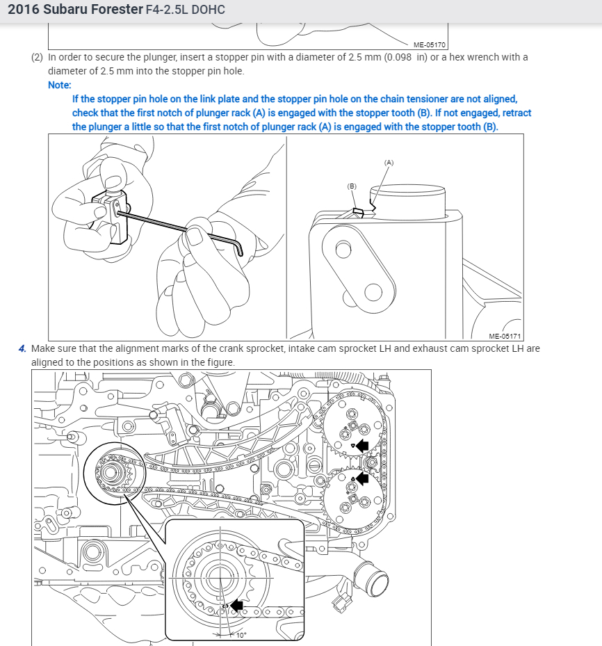

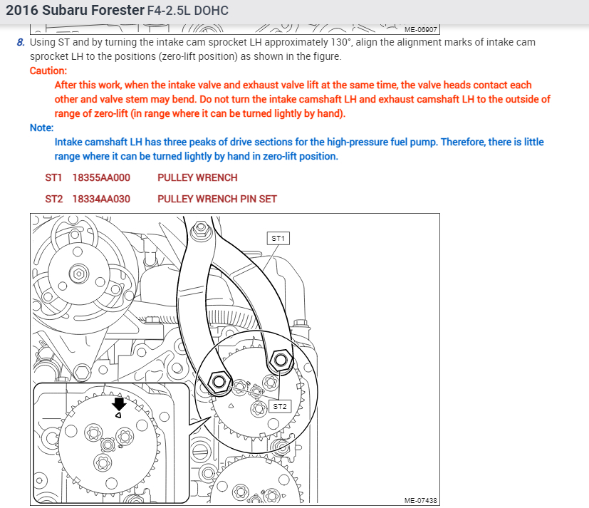

Hi, does anyone have a good video or instructions they wish to share?
Thanks

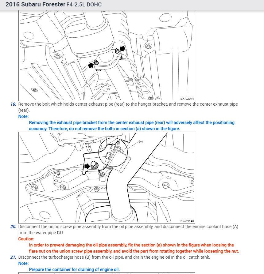

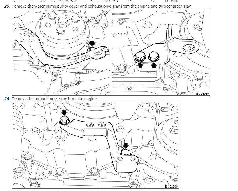

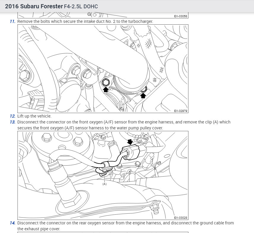

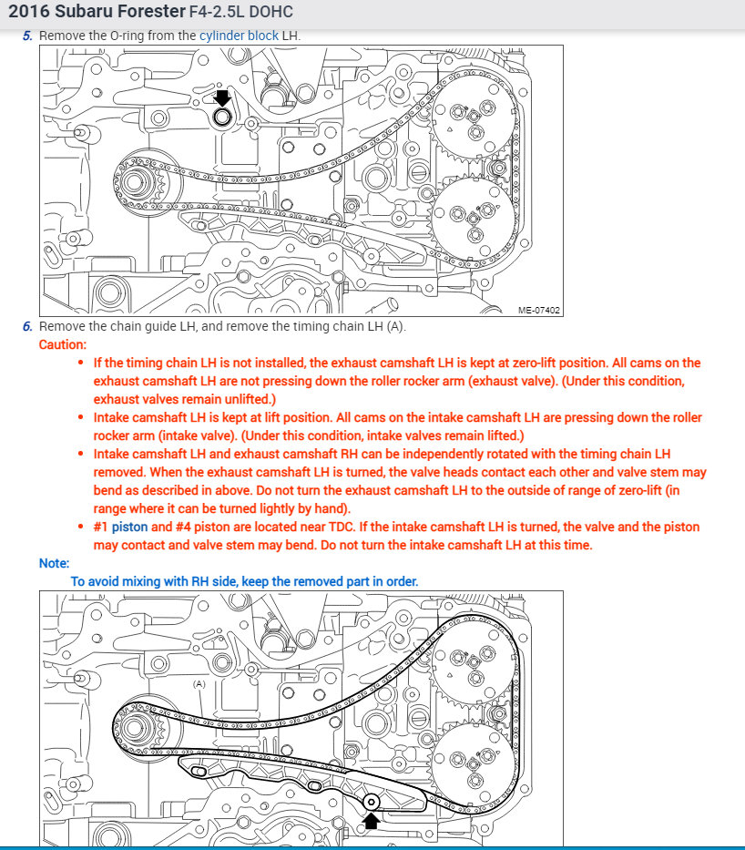

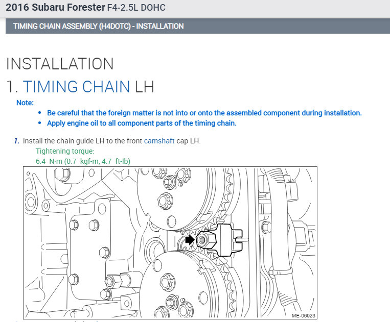

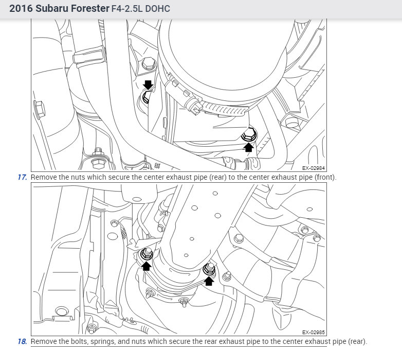

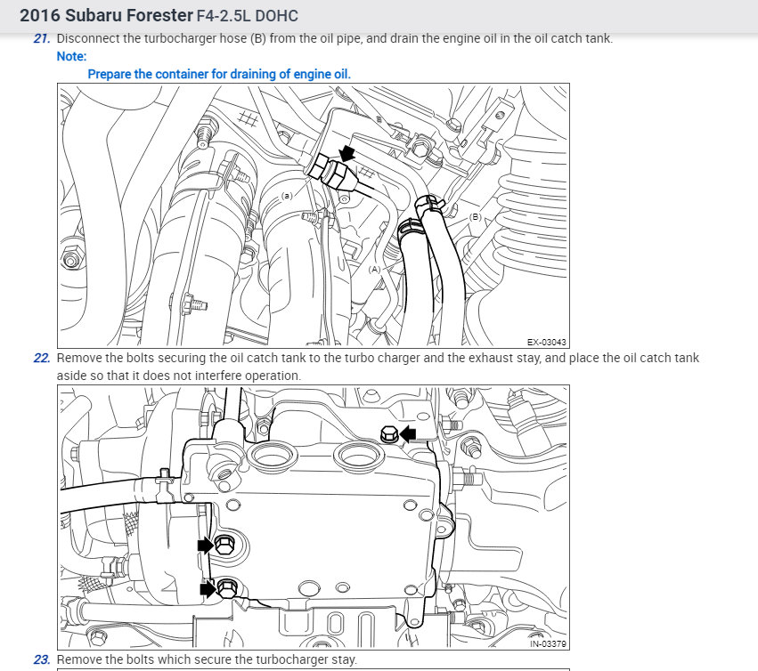

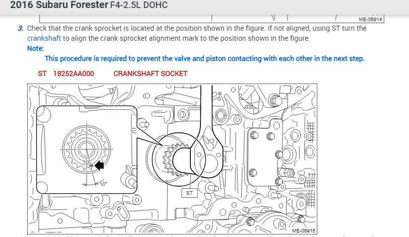

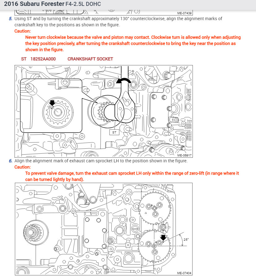

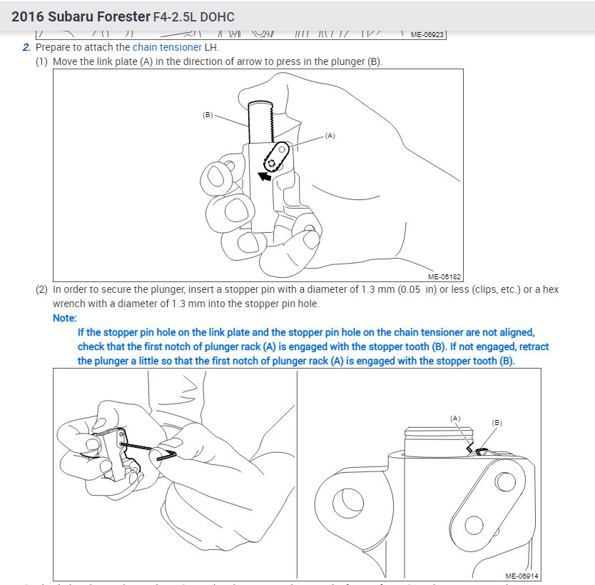

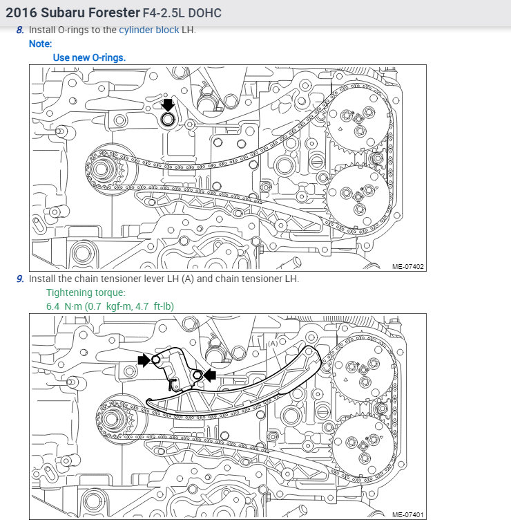

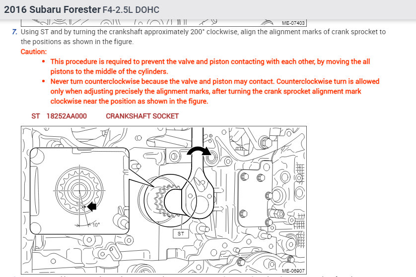

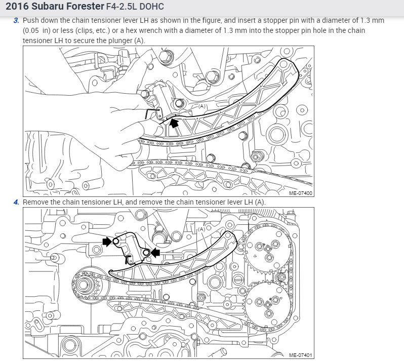

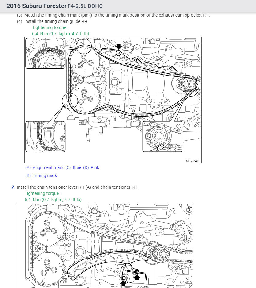

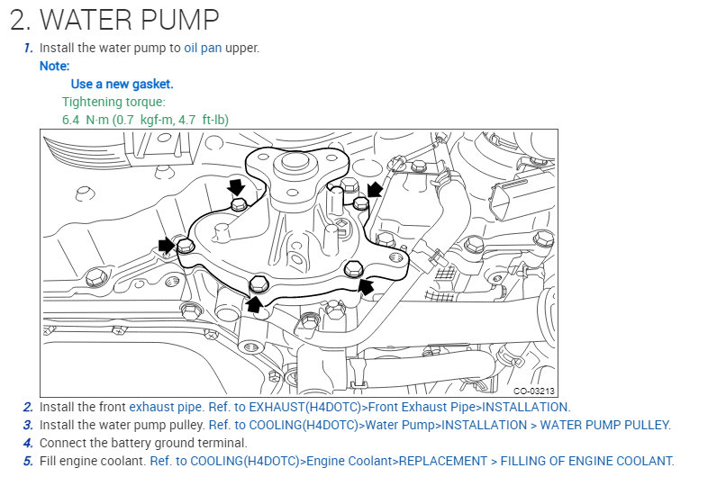

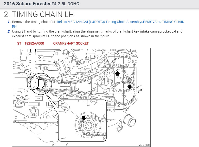

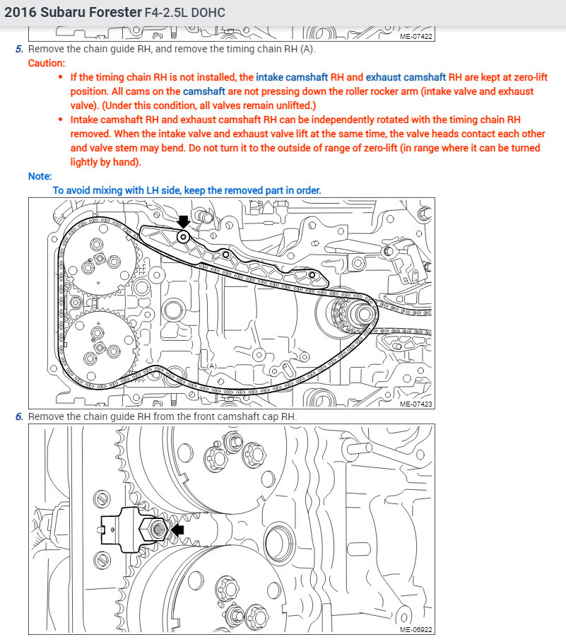

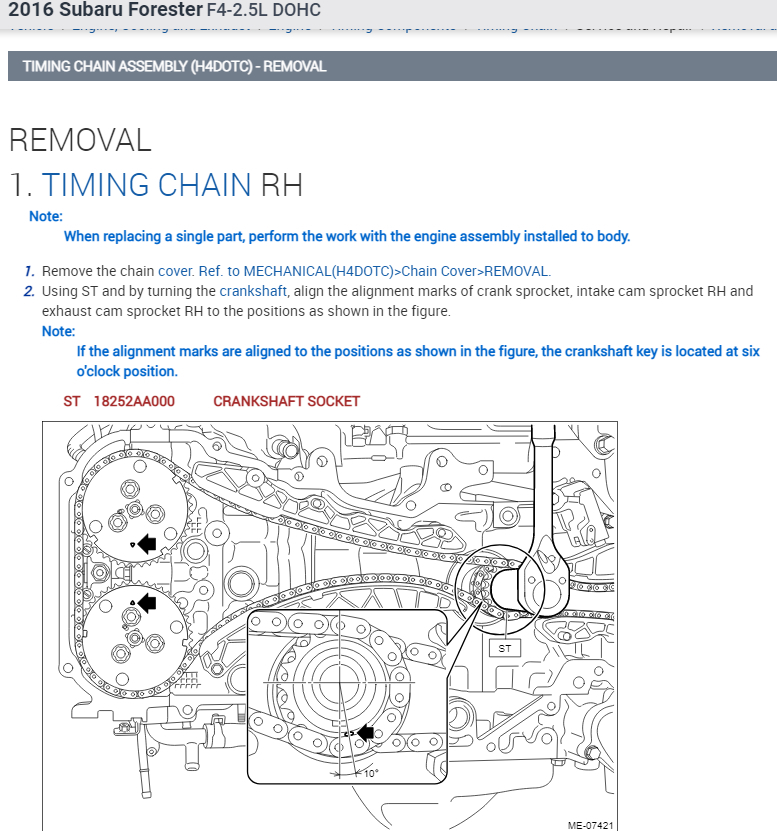

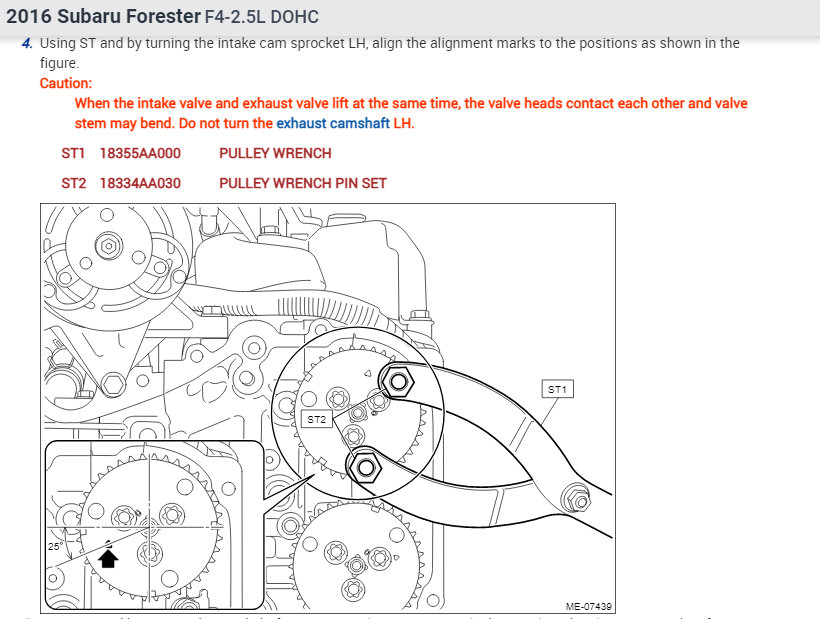

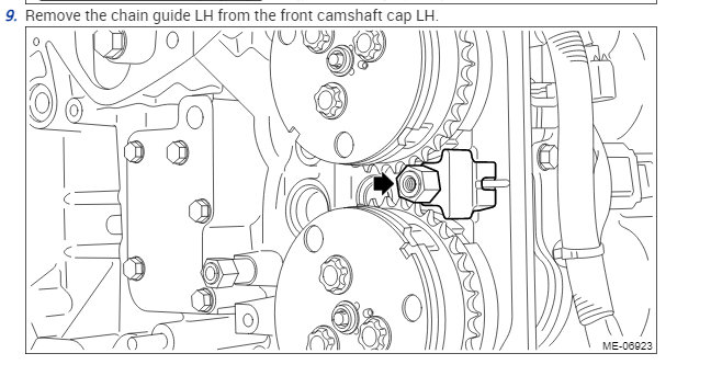

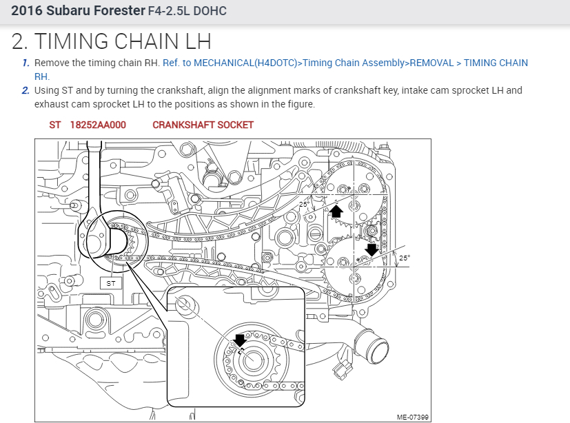

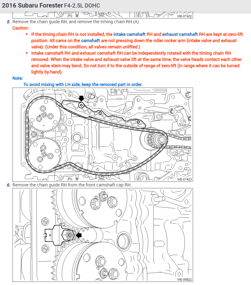

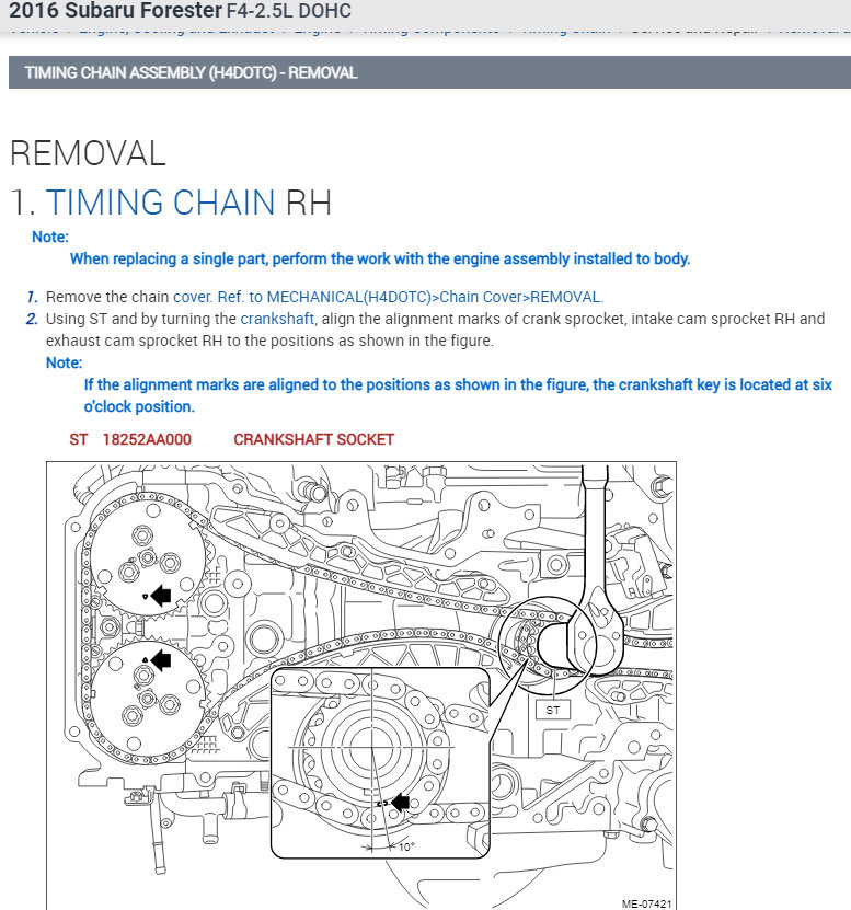

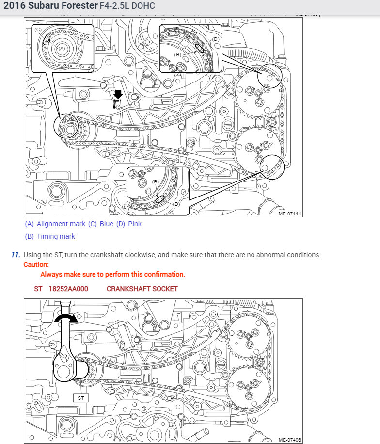

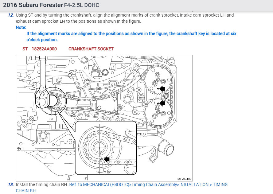

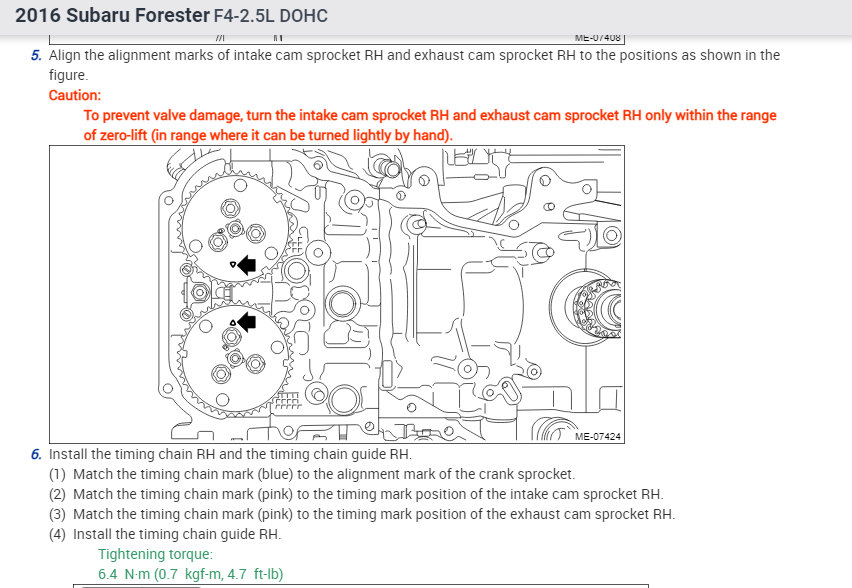

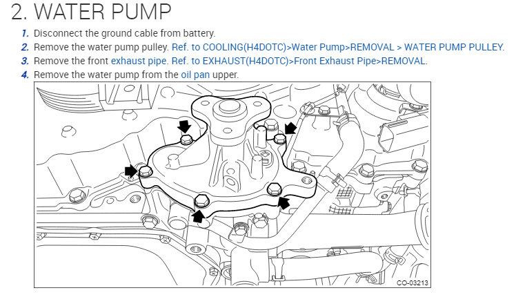

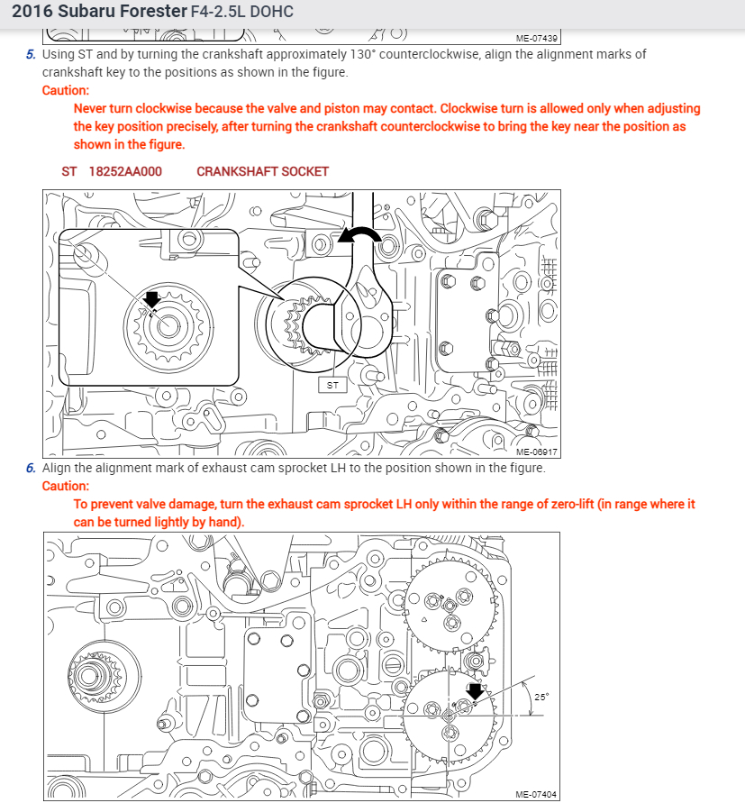

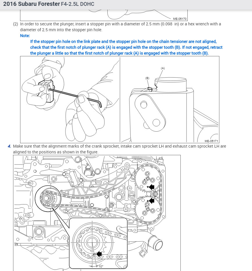

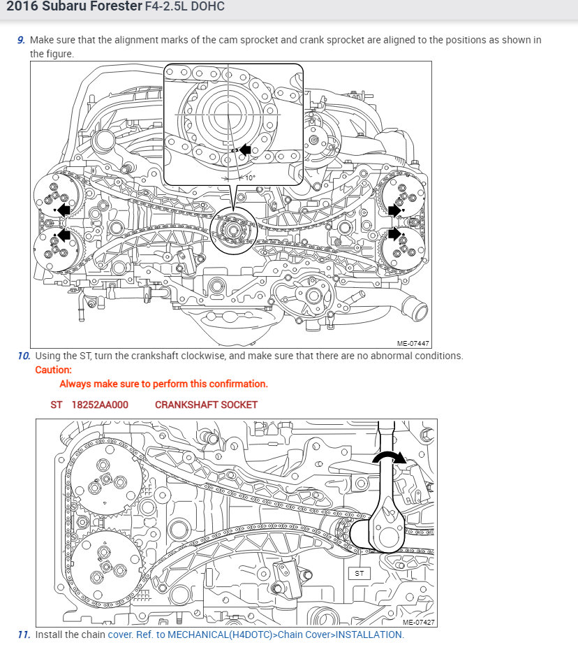

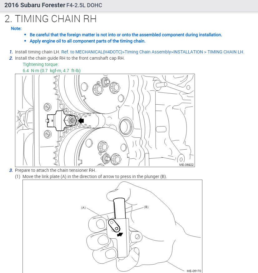

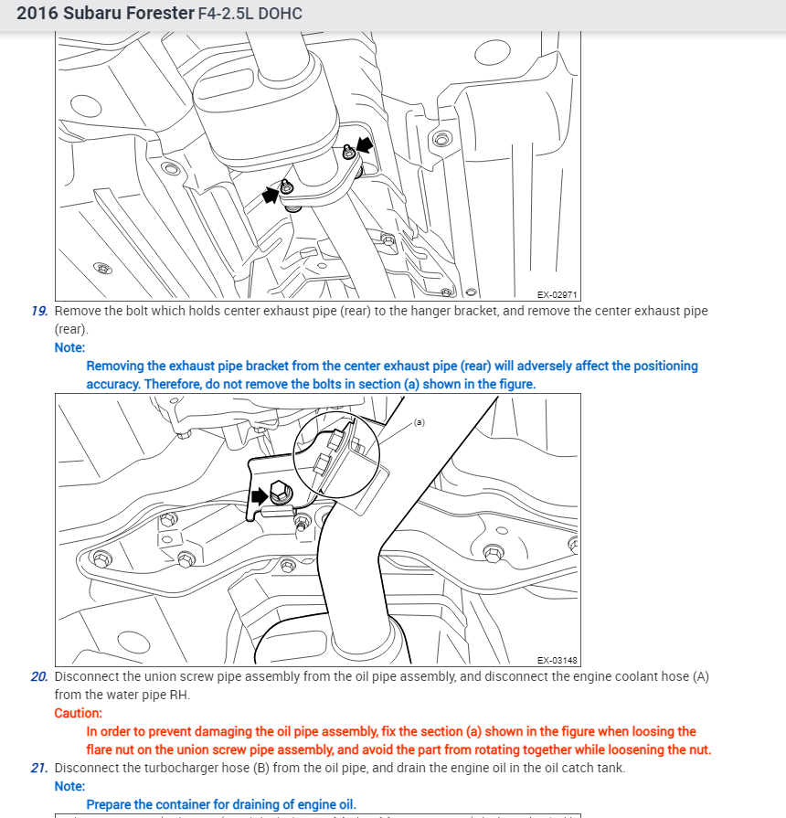

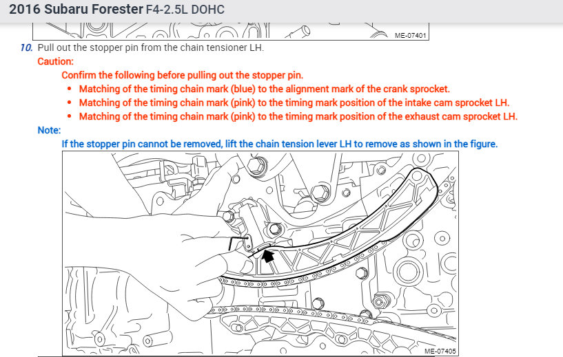

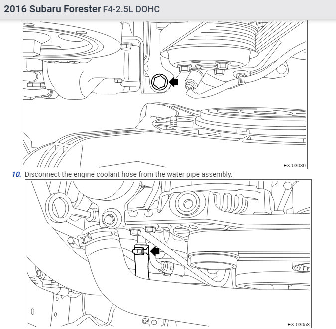

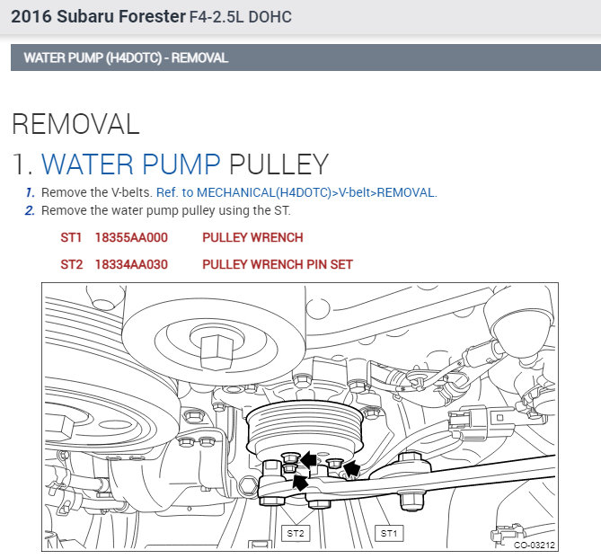

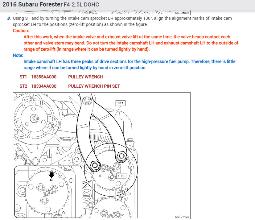

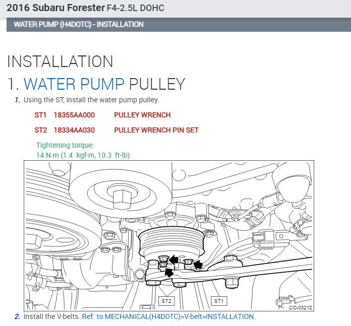

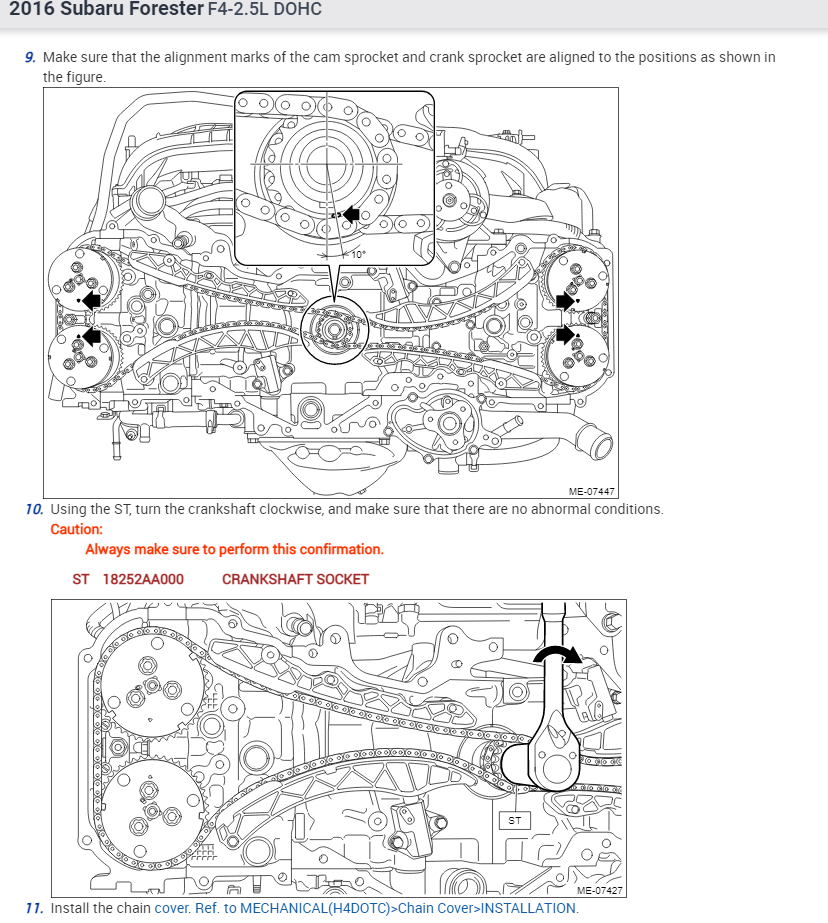

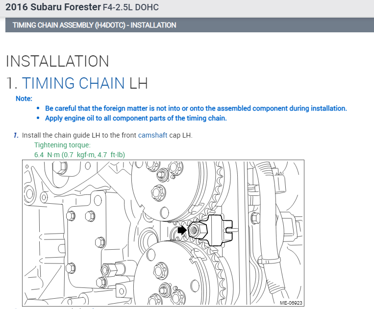

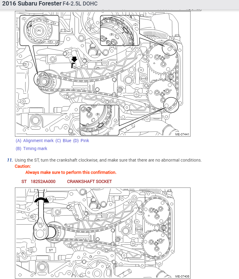

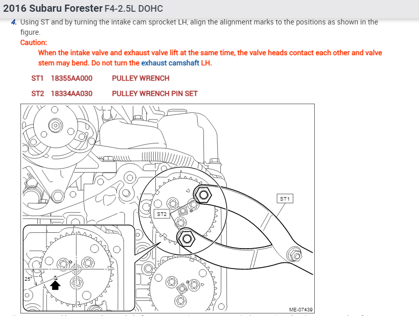

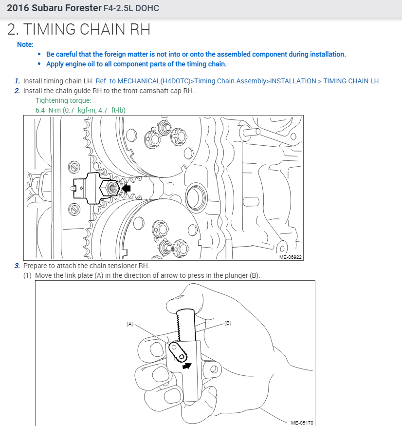

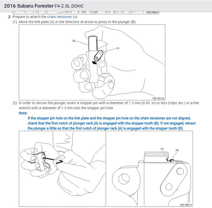

This vehicle with the 2.5L engine is equipped with a timing chain, not a timing belt.

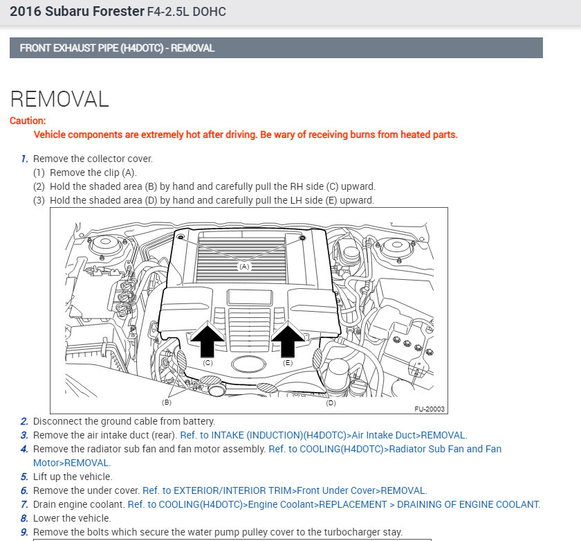

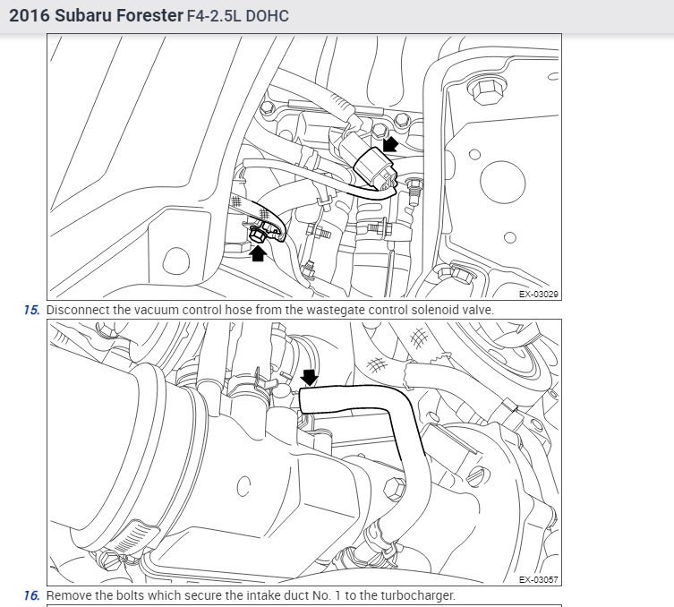

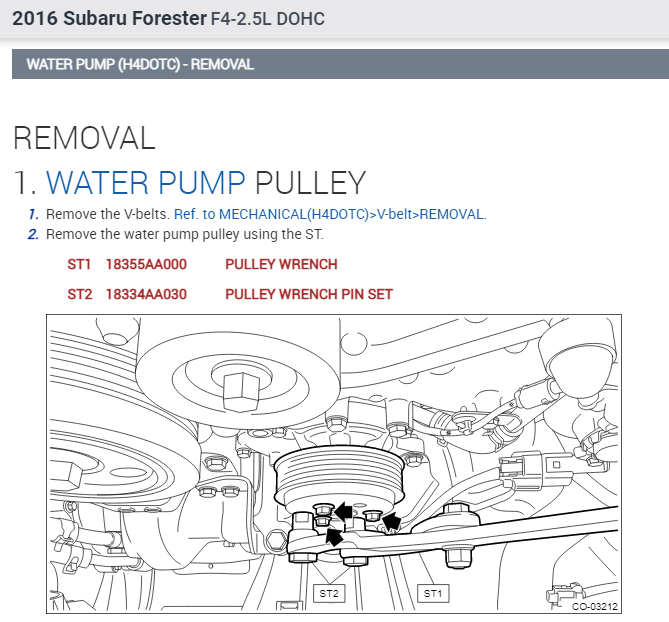

I have attached the water pump as well as the timing chain replacement procedures below.

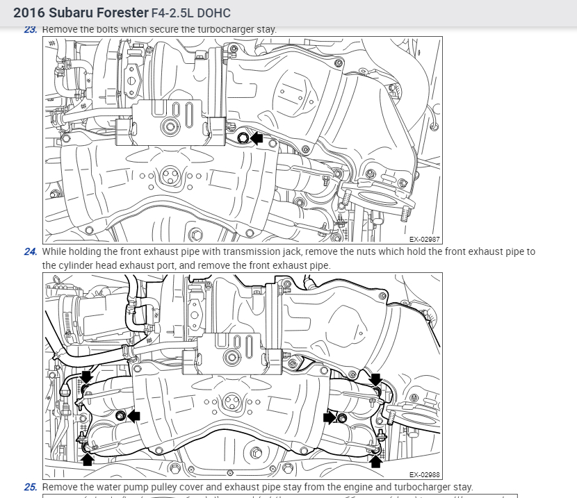

In order to replace the water pump, you will have to remove the exhaust manifold to have proper access.
Here is a helpful guide on the best practices of any water pump removal:
https://www.2carpros.com/articles/water-pump-replacement

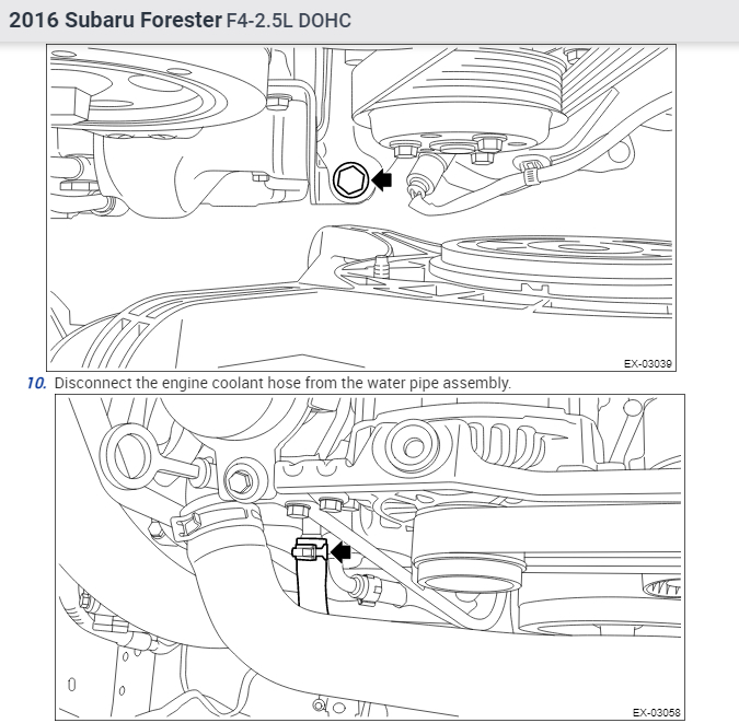

I appreciate the quick reply and details. I'm curious the pictures you sent has a turbo, mine is not - would I still need to take off the exhaust to access pump?
Thanks
Feb 19, 2022 at 2:18 AM
SQM
  • 6,383 POSTS
The diagrams/instructions that I have uploaded are for the 2.5L non turbo engine.
You can see the engine size on just about every image.
And yes, it does call for the removal of the exhaust to be able to replace the water pump.

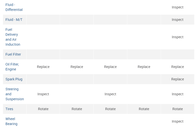

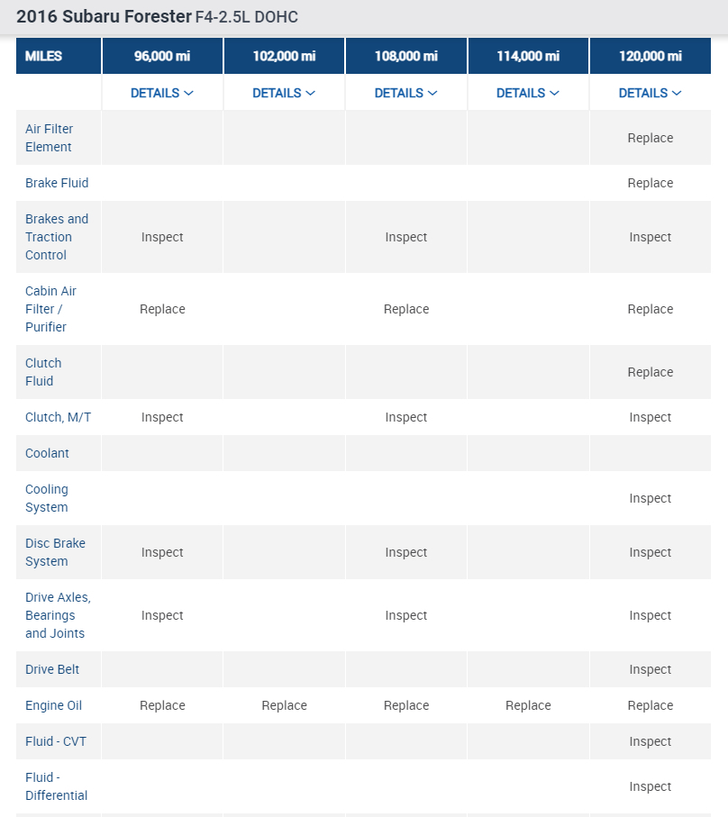

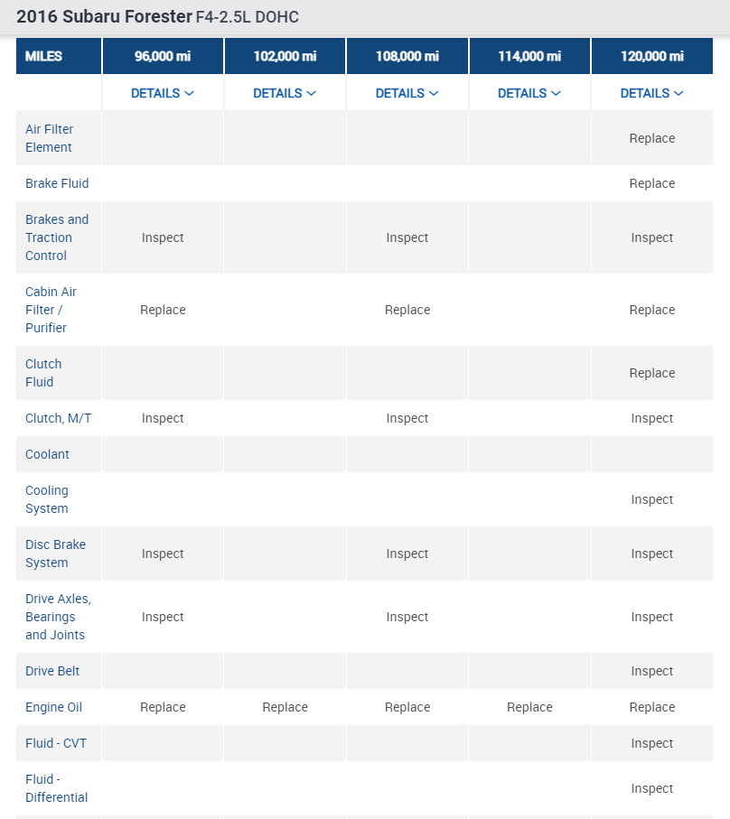

Thank you, since there is a chain and no belt it's not required to replace the chain for life of the car I'm told, Belt is 100,000 but chain is not required? I am planning on just replacing the serpentine belt and tensioners along with the water pump and thermostat.
Any other replacements required at the 110,000 mark?
Thanks
Feb 19, 2022 at 11:33 AM
SQM
  • 6,383 POSTS
That is correct, the timing chain is not a maintenance item like the timing belt.
Take a look at the chart below, it shows the recommended maintenance around that mileage.
Most of the recommended items are at 120K miles mark.
