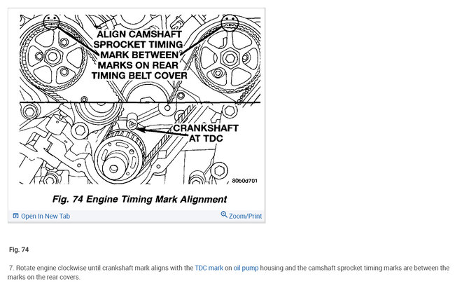

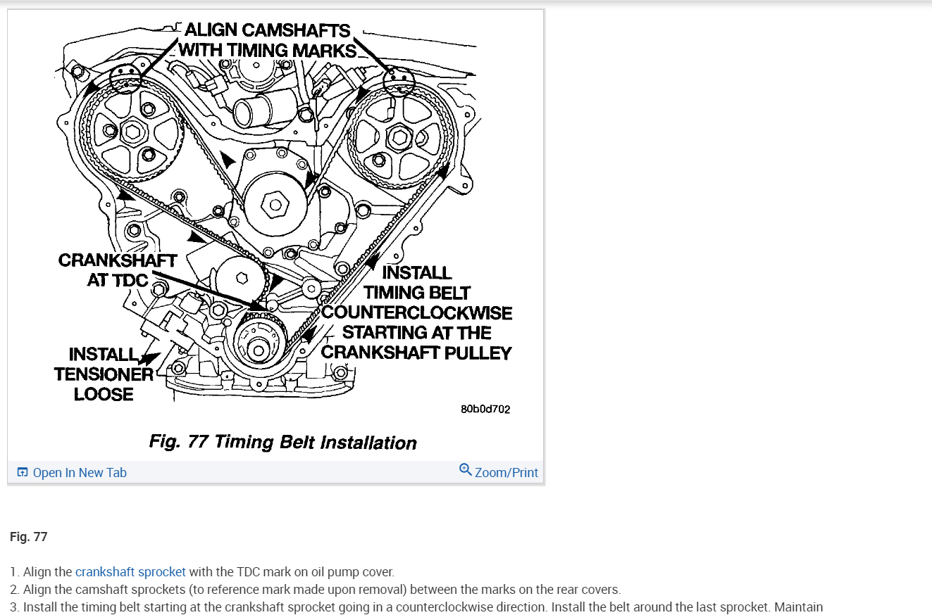

A person that I don't trust is telling me it's the water pump and timing belt. I was wondering what are the first things I should look at. Like steps of the things, I need to look at before I replace things. If you could give me a list to check.
Aug 3, 2023 at 6:48 AM
  • 54,840 POSTS

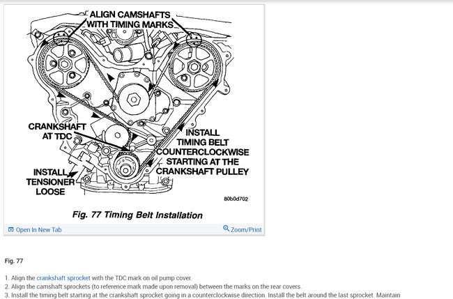

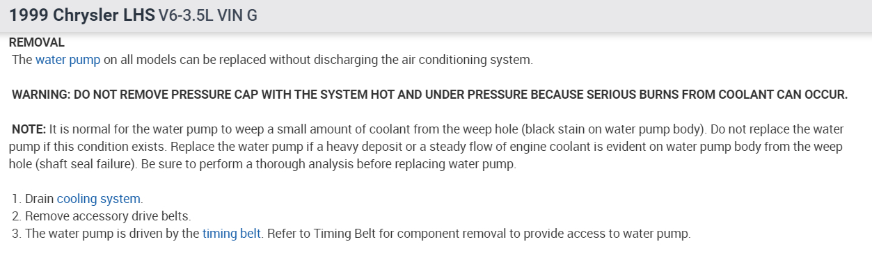

If you don't trust them, take it to another shop for confirmation. here is a guide so you can look at the leak yourself to confirm the water pump:
https://www.2carpros.com/articles/car-is-leaking-coolant
I can tell you the water pump and timing belt failure is common.
Water Pump, R&R 3.0 HRS @ shop rate. Look on amazon for the parts prices.

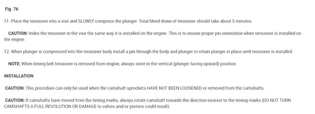

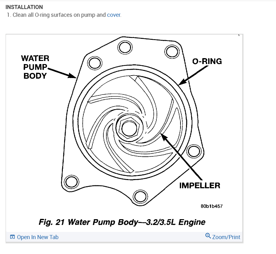

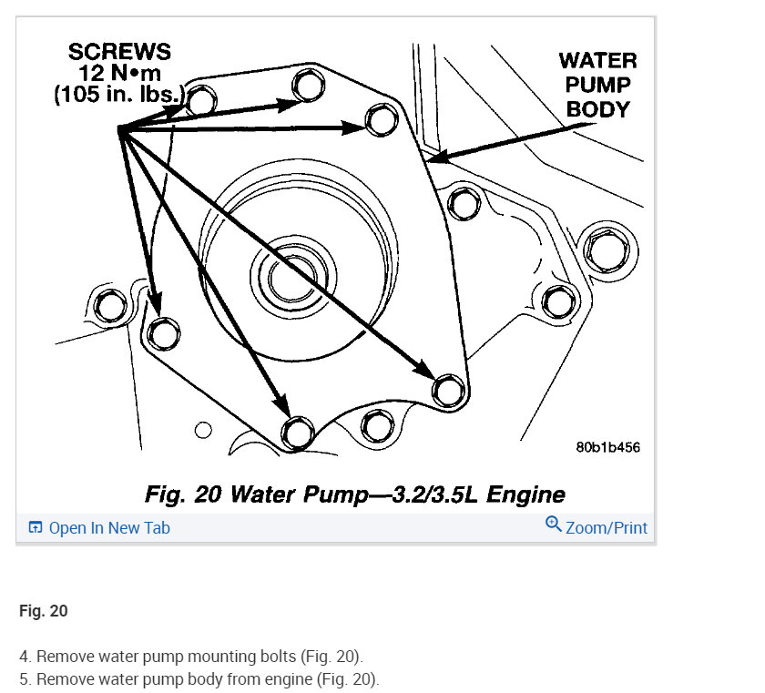

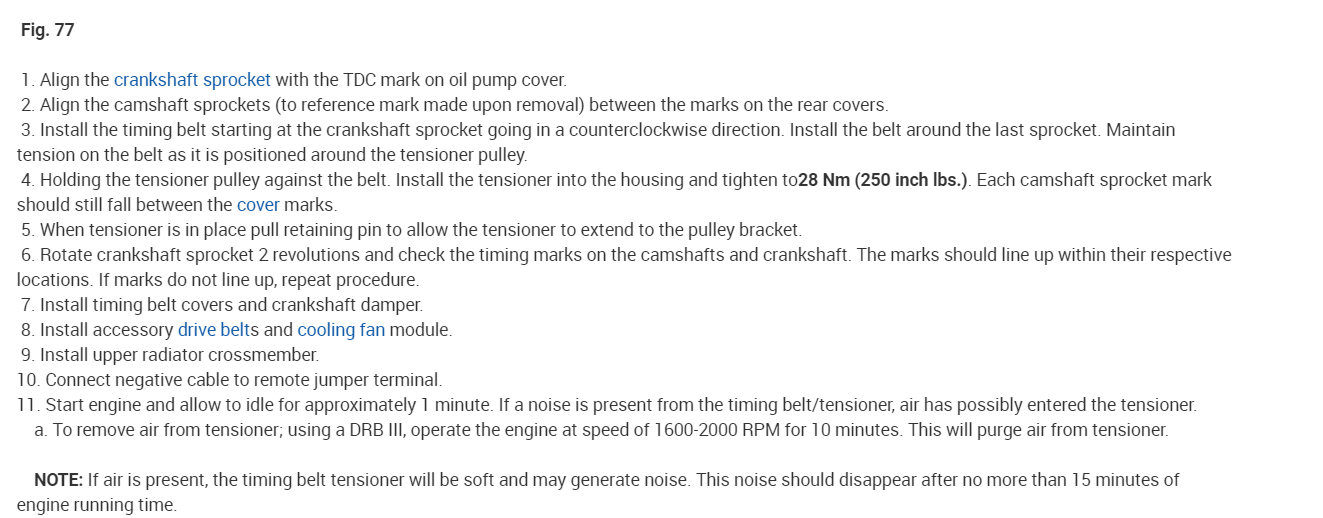

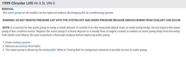

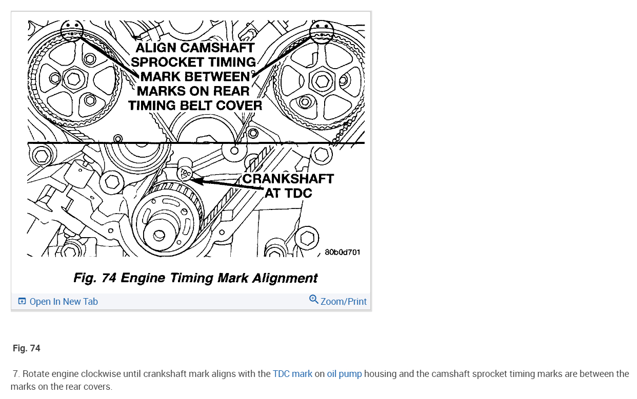

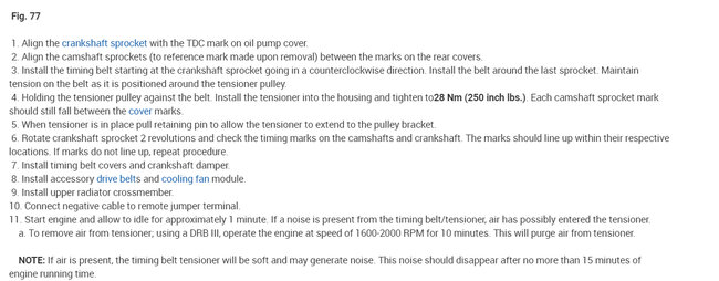

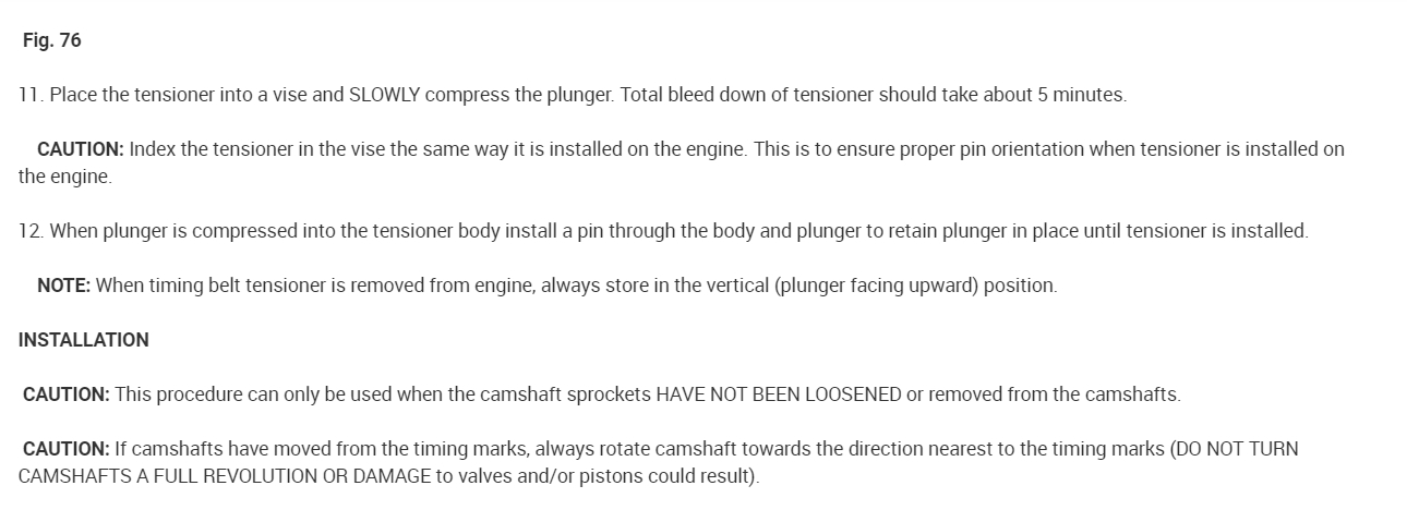

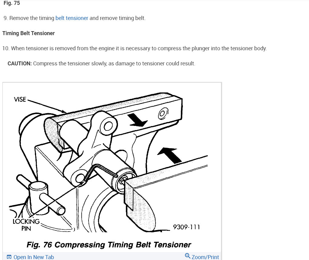

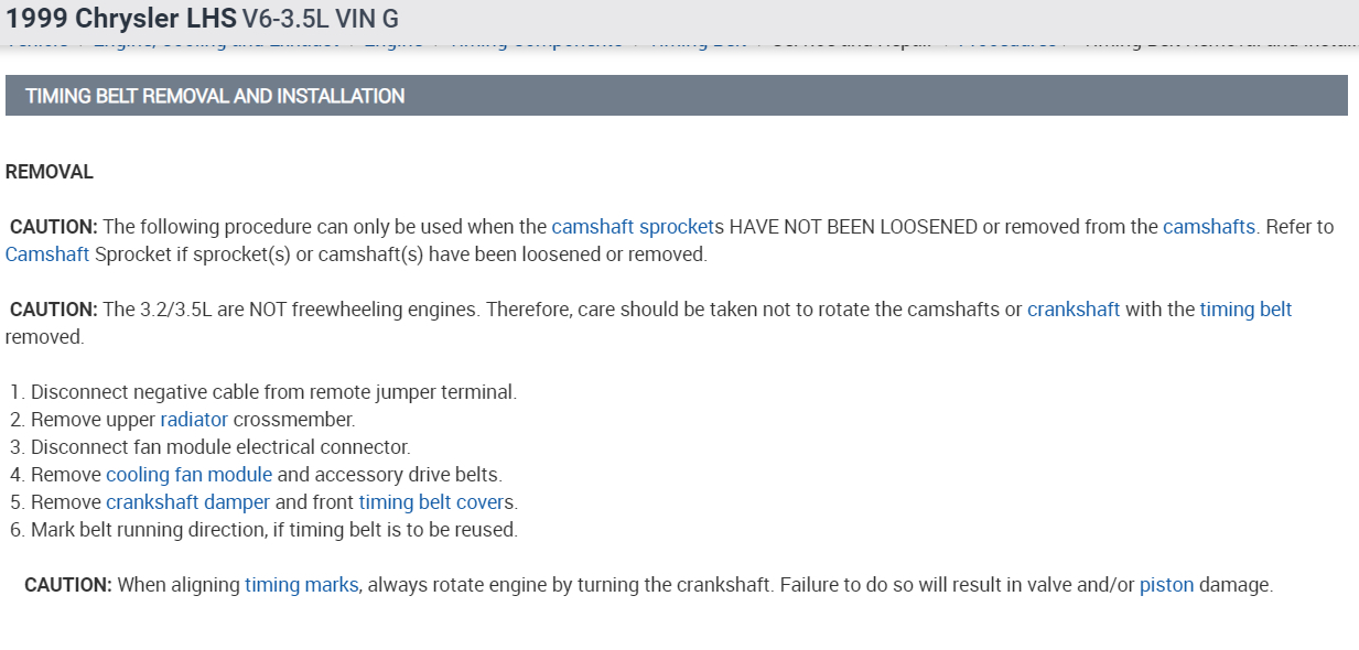

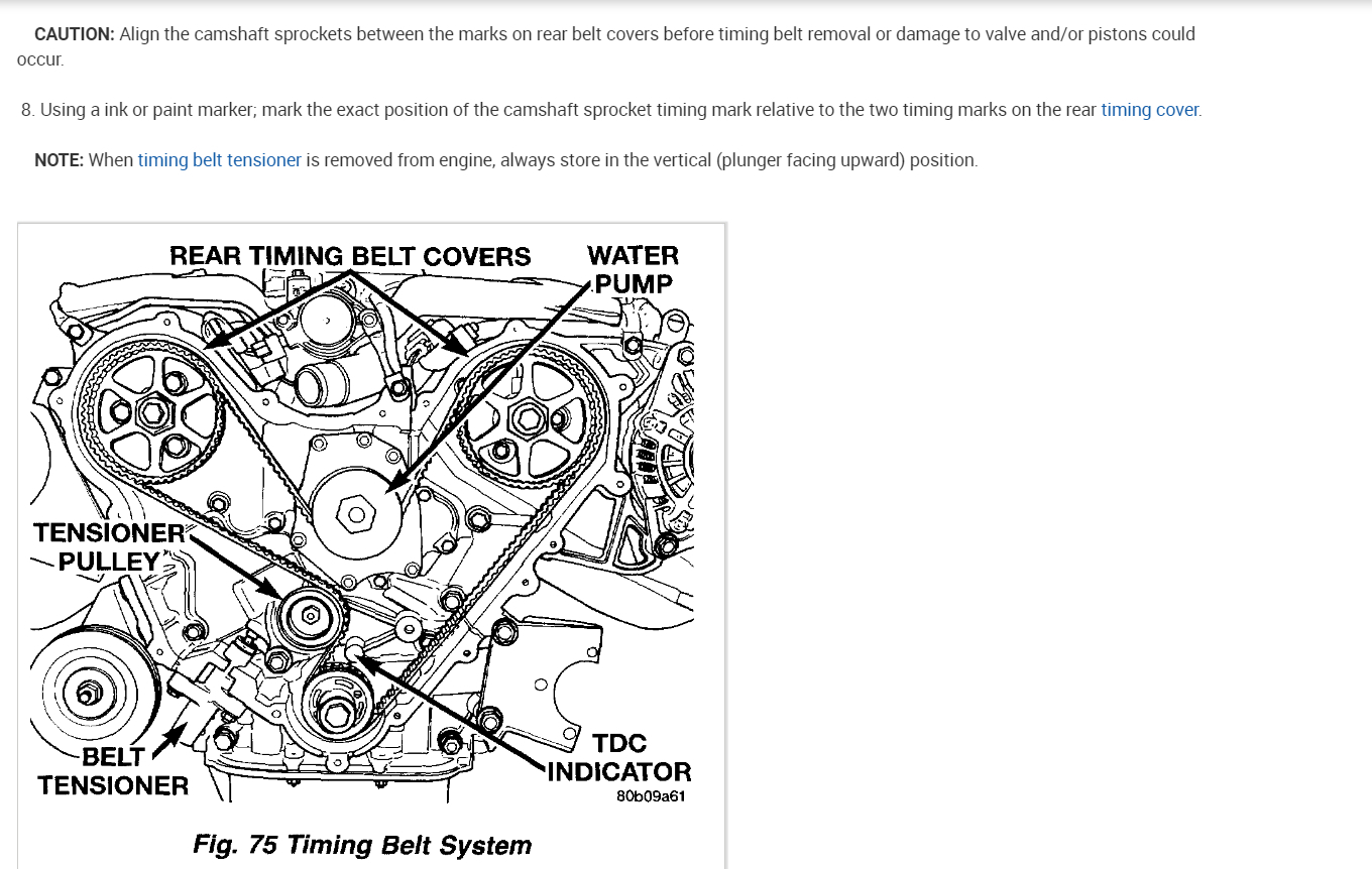

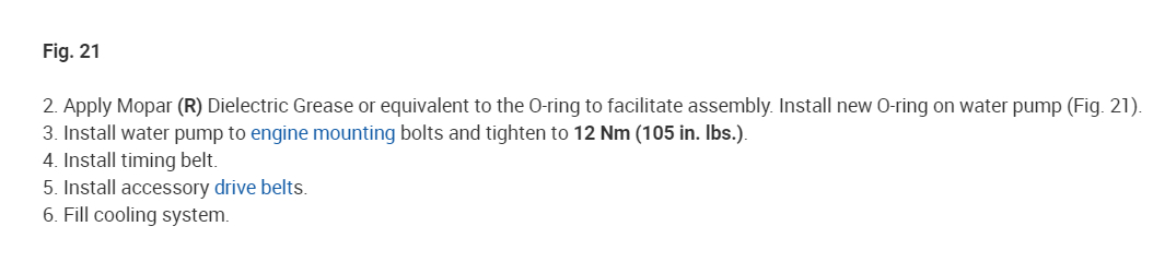

Here is how the job is done. in the images below. Check out the images (below). Please let us know what happens.
