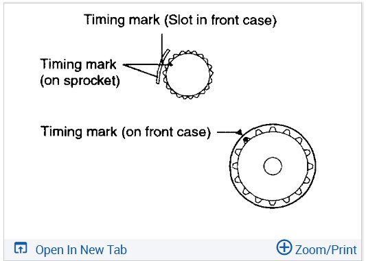

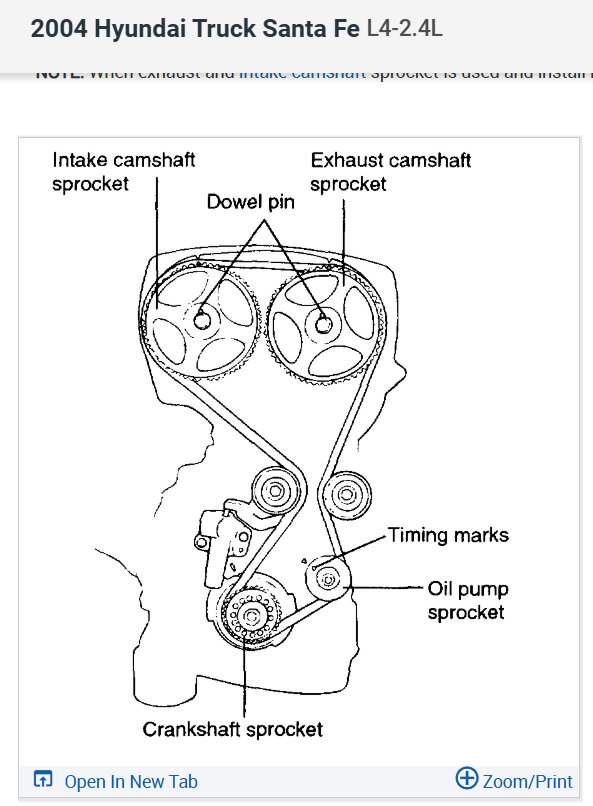

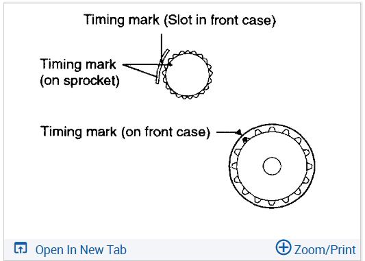

I am attempting to replace my balance shaft belt, but I need a diagram of where the timing marks are for the belt.
Apr 24, 2025 at 7:00 AM
  • 55,443 POSTS
Sure, here are the timing marks for the main timing belt and the balance shaft belt. Check out the images (below). Let us know if you need anything else.
