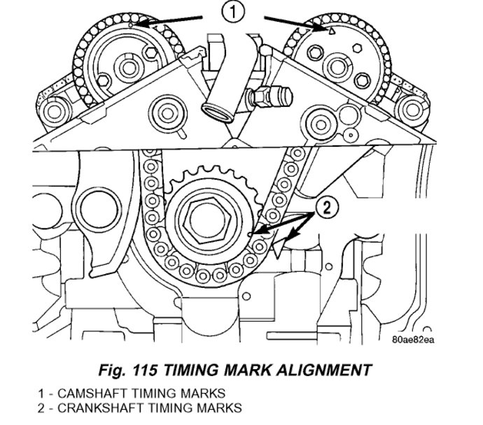

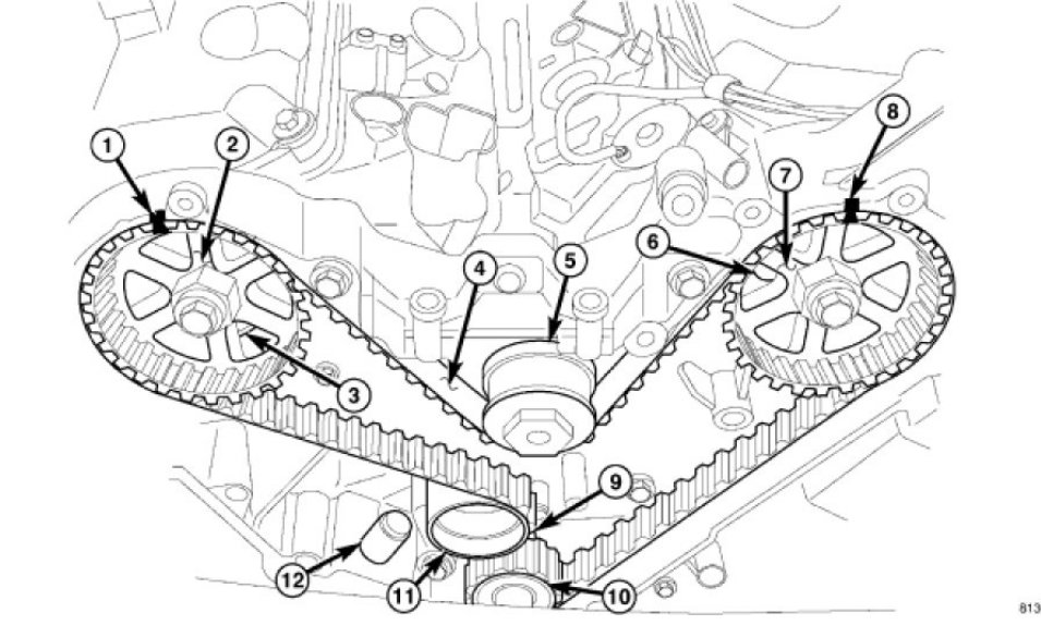

Books say cam marks up aligned with cover marks crankshaft mark aligned with TDC mark on cover. I rotated motor to check marks crank is aligned on compression number one TDC but cam marks are 180° off.

You are on valve overlap. rotate the crank one more turn and the cam marks will be lined up along with the crank. that will be the compression stroke.

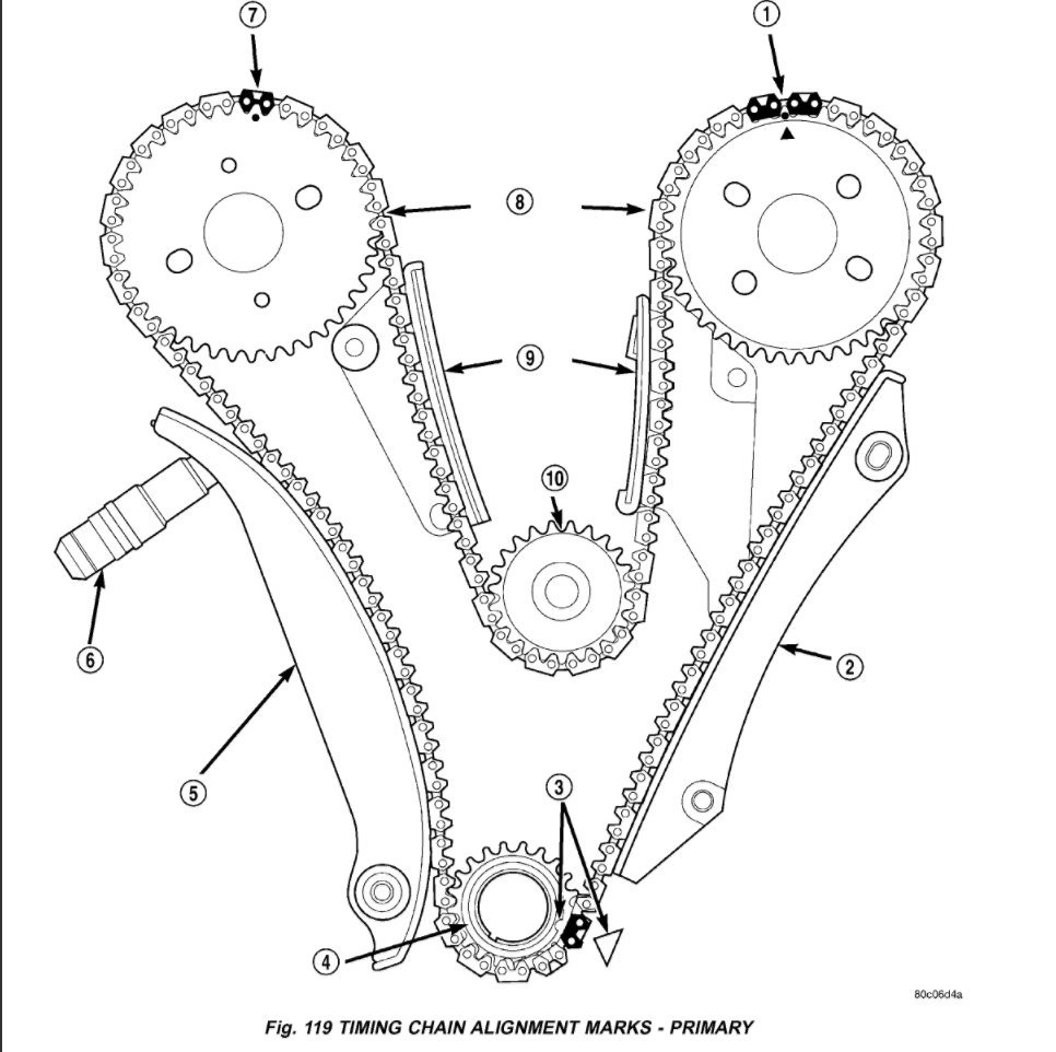

I have a 06 dodge charger with a 2.7l engine, I have changed bearings, water pump and a few intake valves. Changed intake valves twice due to not having right timing and timing chain bad. As of now everything is correct but cant seem to get timing right, that is do to camshaft problem Im having. Ok, so the problem Iam having is with the left camshaft, book says camshafts marks are to be facing up 90 degree angle from cylinder head. Rightside is good, but left side when placing cam at 90 degree's facing up aligned with mark the front exhaust valves are open. Question I have, is the camshaft bad or is it ok that exhaust valves are open. Really stuck here,

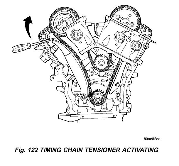

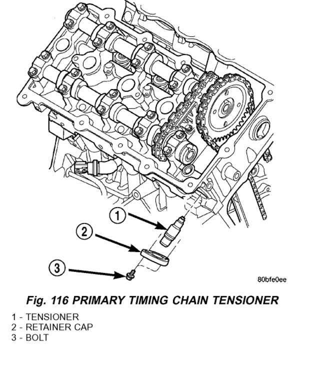

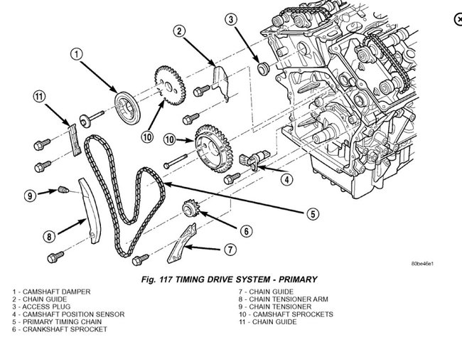

You have the right camshaft 180 off. In other words you need to rotate the crankshaft one full turn and then line everything up. Here are guides to help you get the job done.
Check out the diagrams (Below) Please let us know if you need anything else to get the problem fixed.
