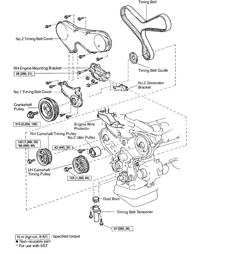

Compression caused the rear cam to move from dead center on its own when the timing belt was off?
200,000 MILES • 3.0L • 6 CYL • 2WD • AUTOMATIC
BRUX
  • 6 POSTS

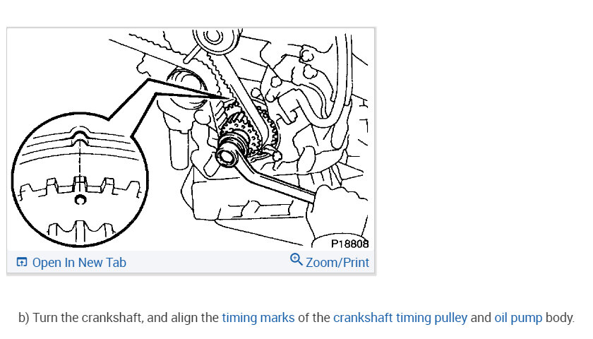

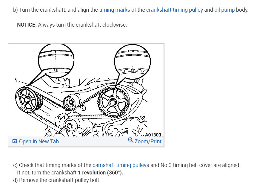

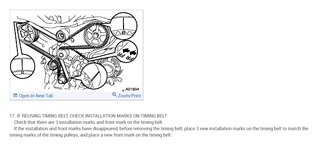

Is it okay to turn the pulley clockwise to line up with the mark again?
Mar 4, 2023 at 10:56 AM
  • 55,721 POSTS
You should be okay just turn the camshaft slowly and don't force it. Here are the timing marks in case you need them in the images below. Please let us know if you need anything else to get the problem fixed.
