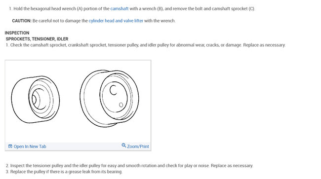

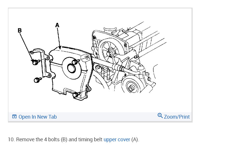

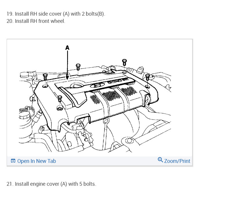

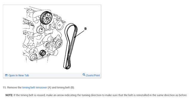

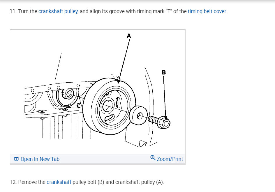

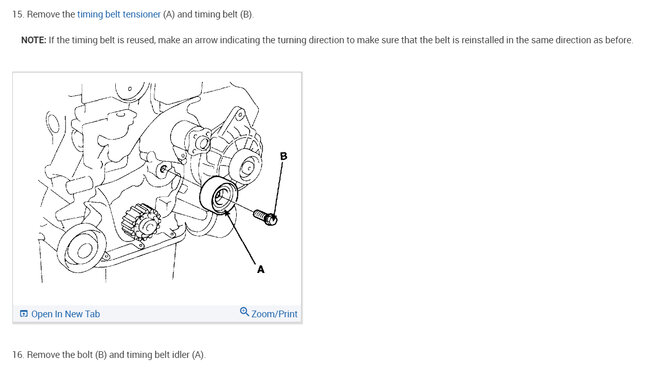

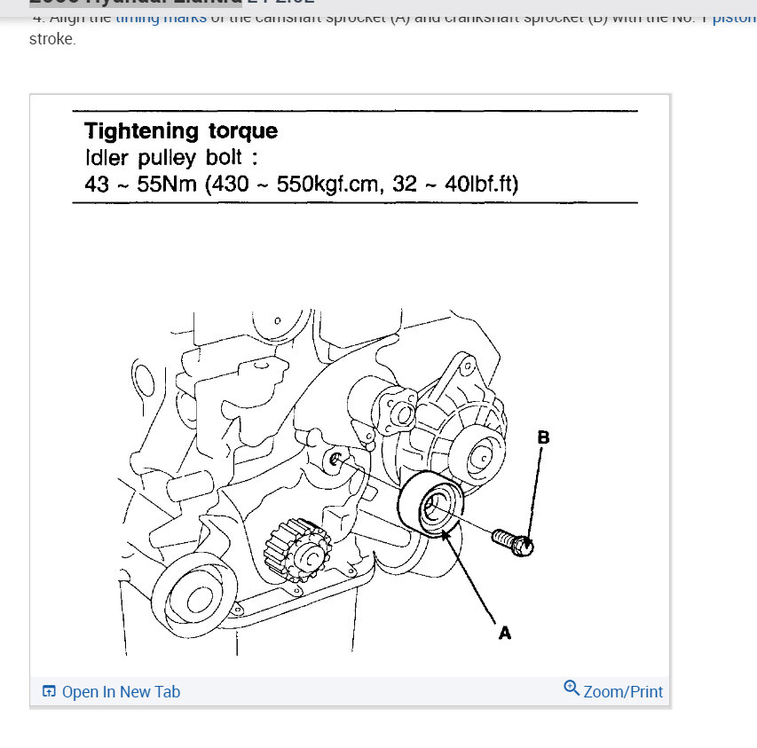

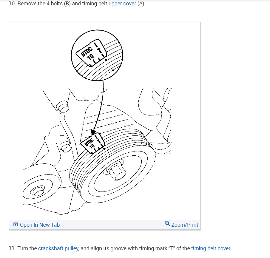

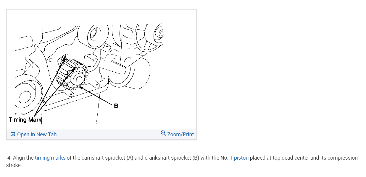

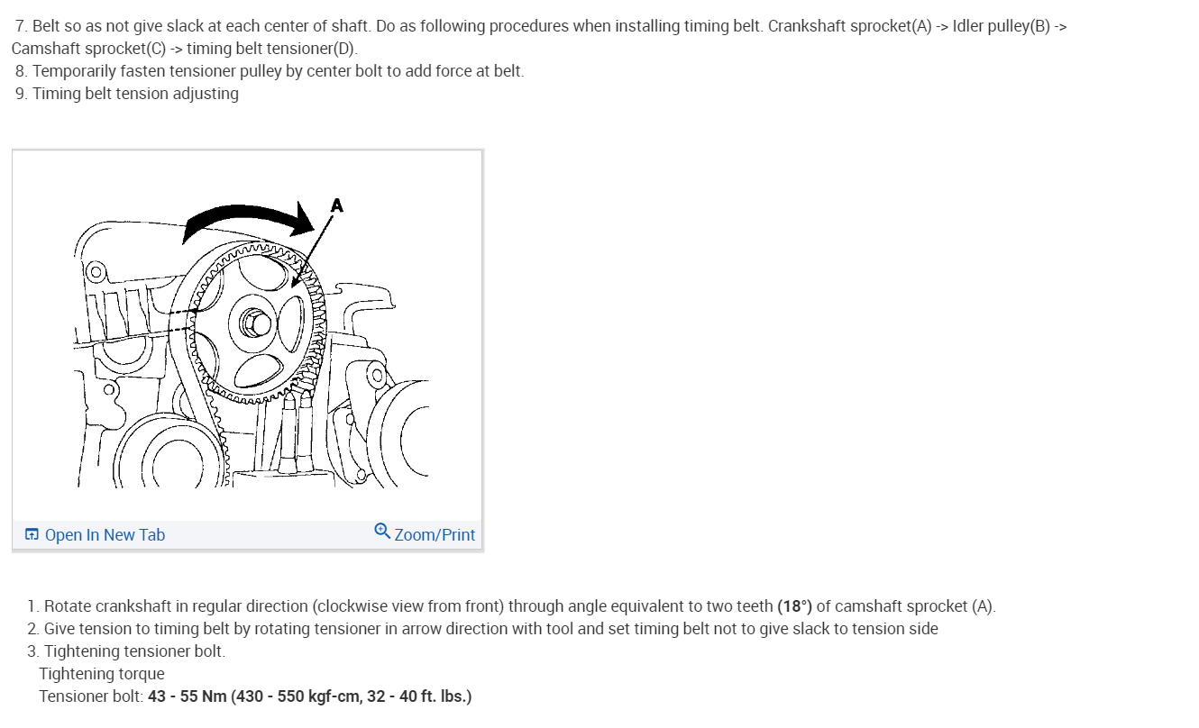

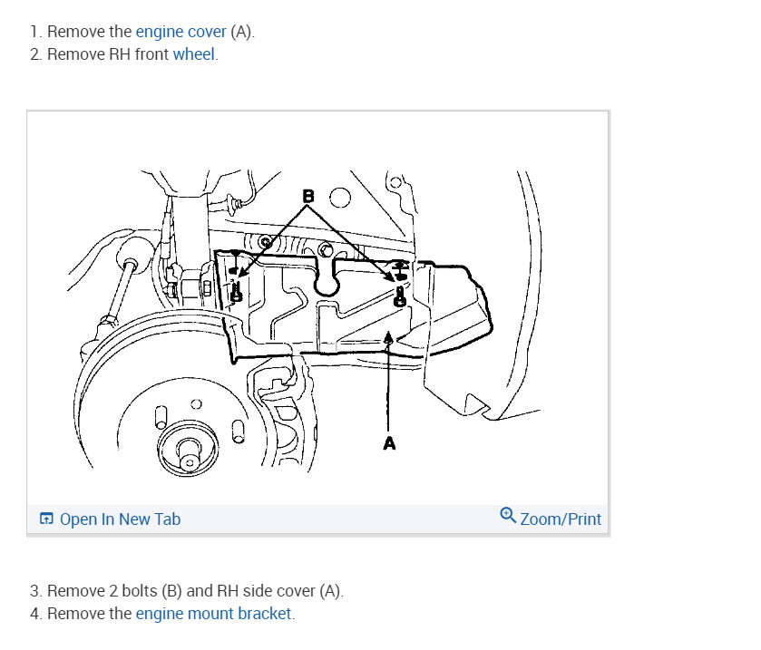

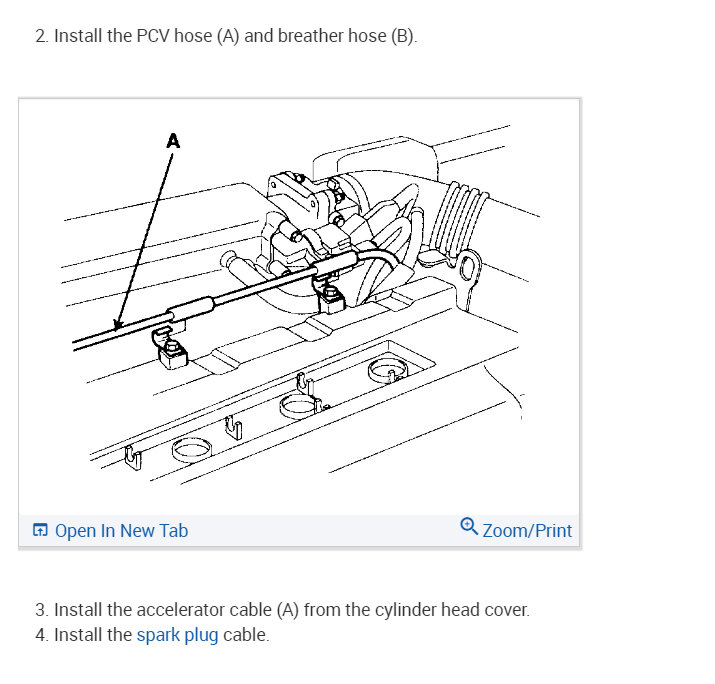

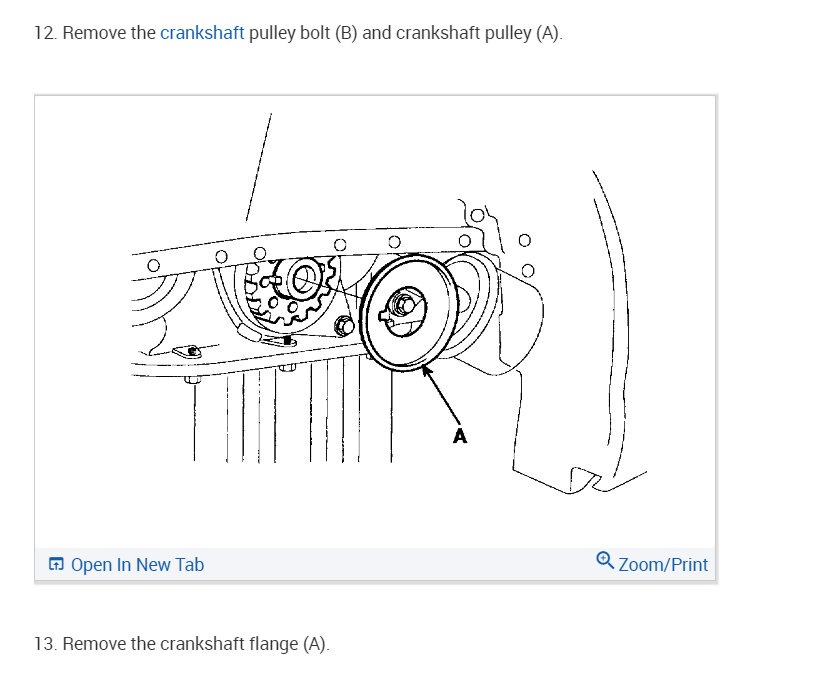

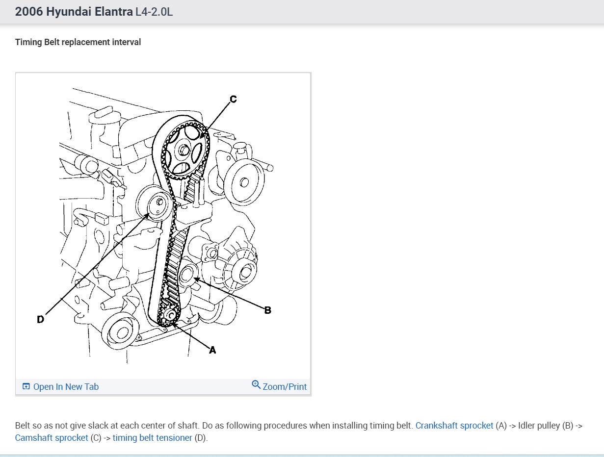

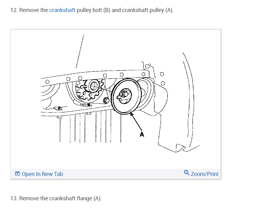

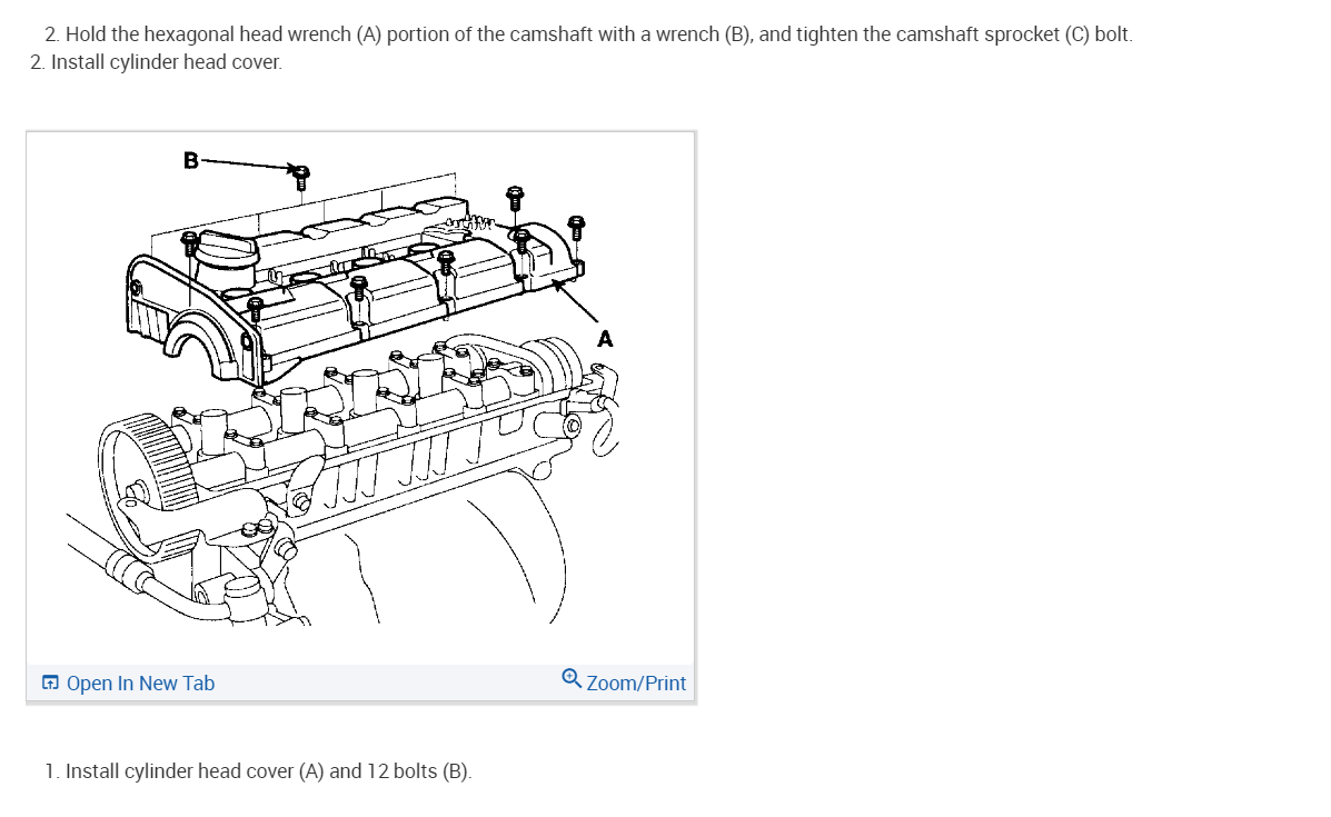

True or not true? If you have a broken timing belt every time you turn the engine over, you could damage the valves. Thanks, Glenn
Jan 3, 2023 at 6:29 AM
  • 55,721 POSTS

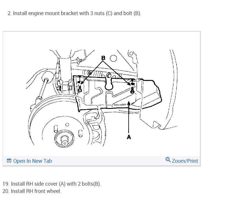

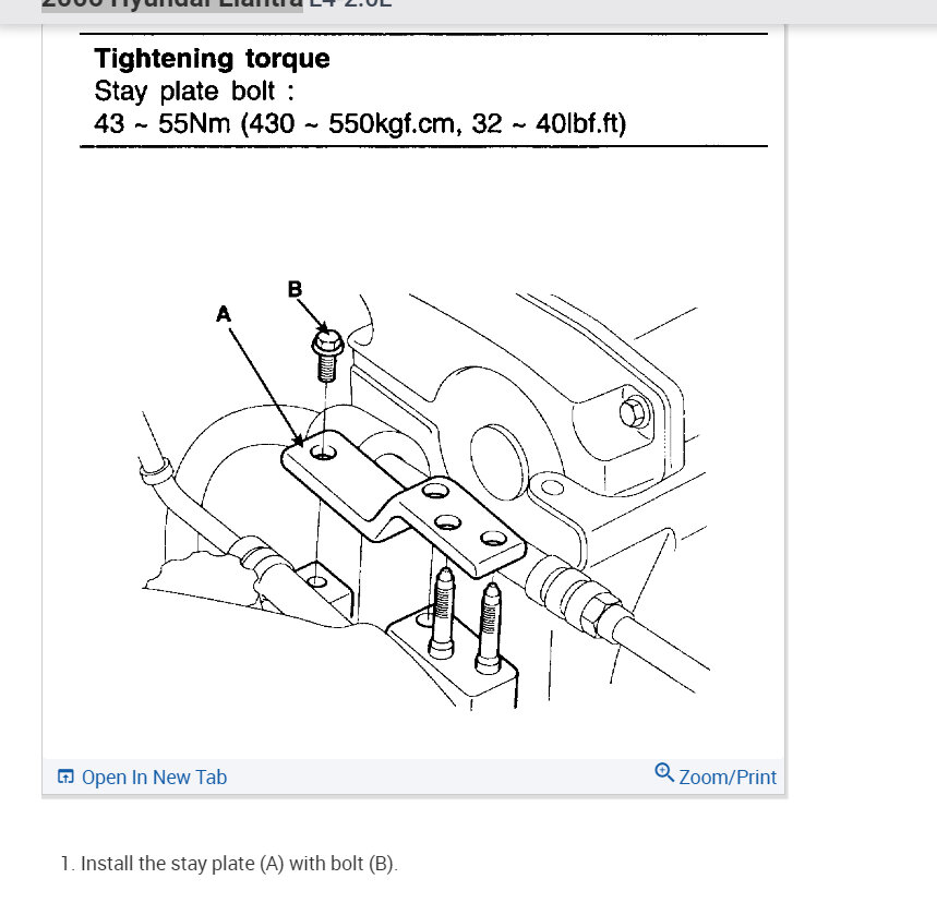

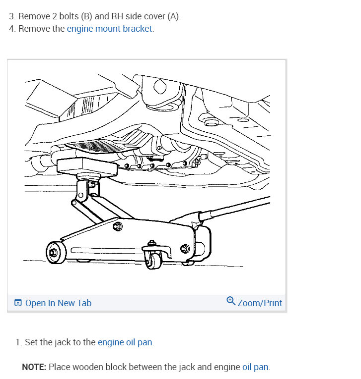

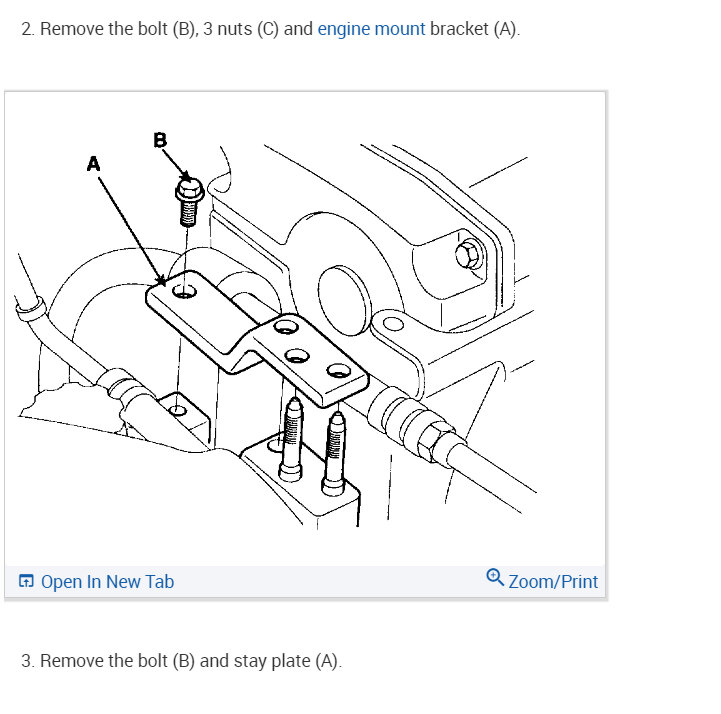

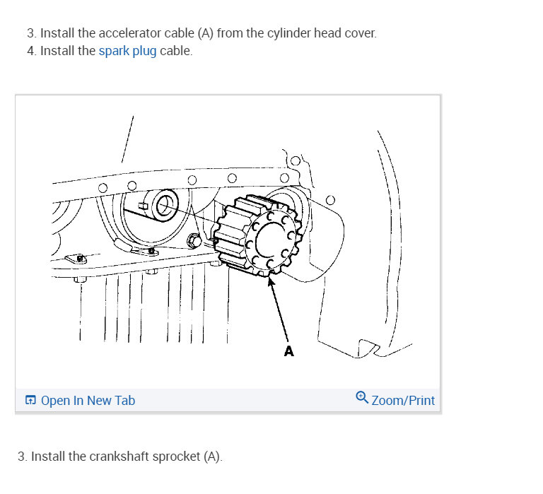

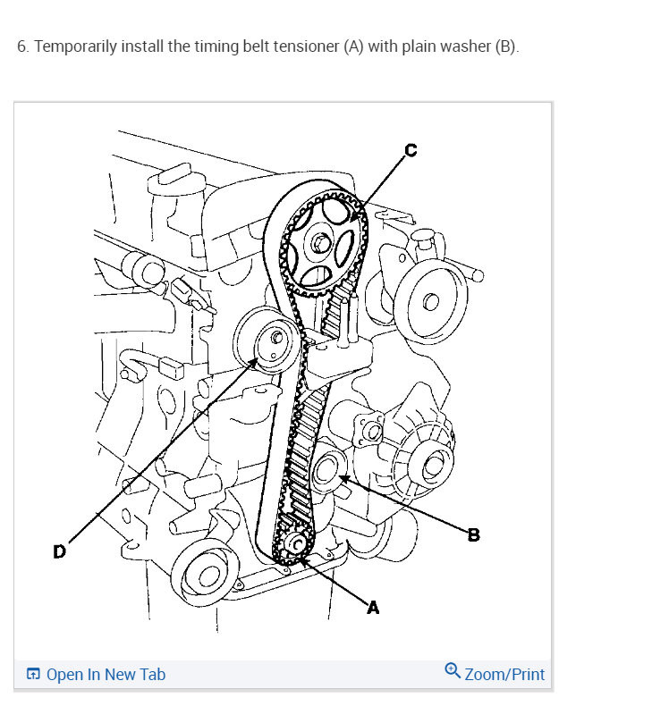

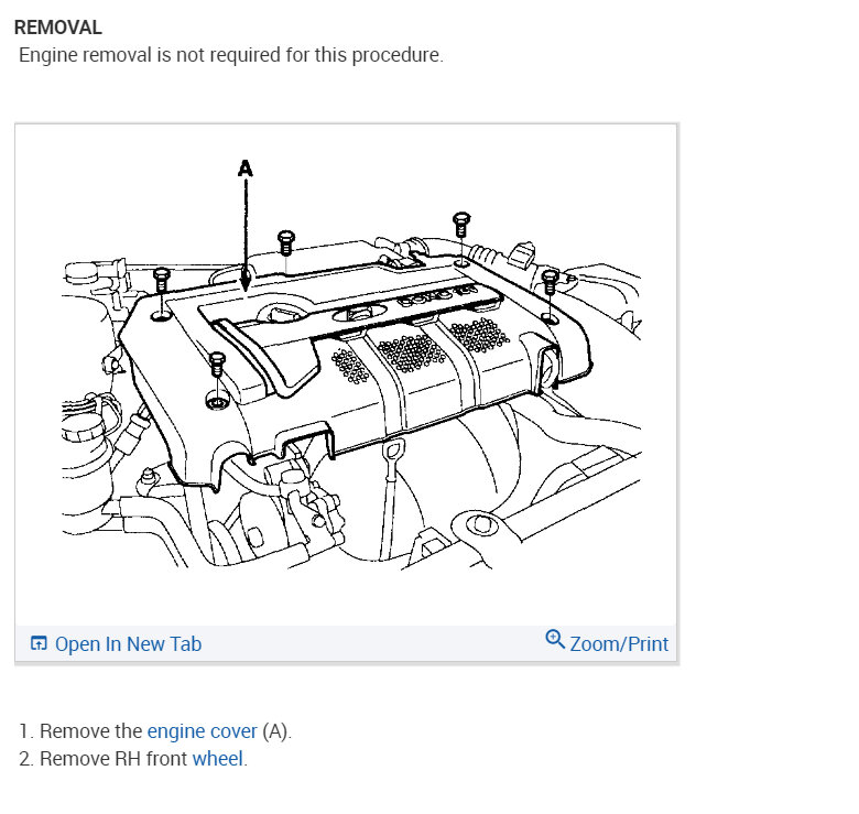

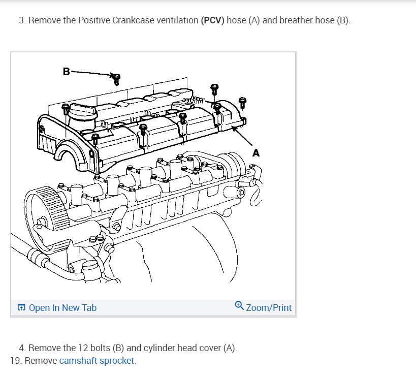

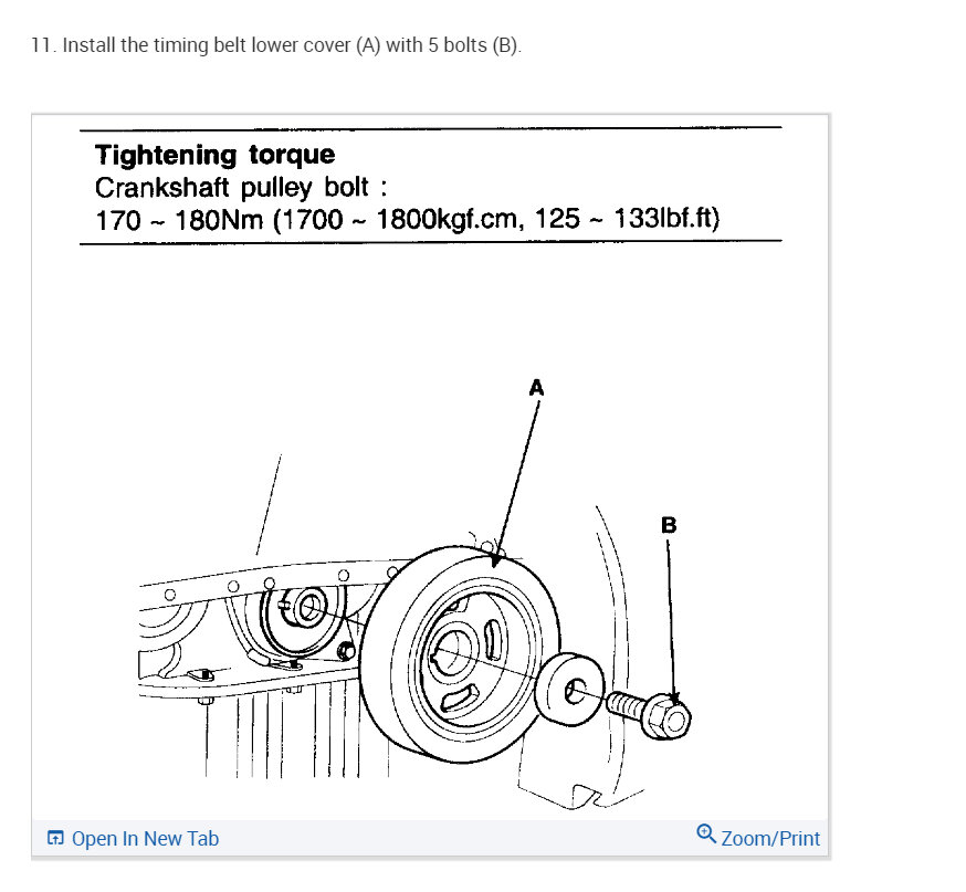

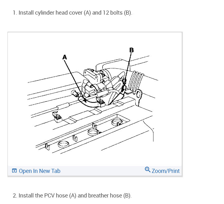

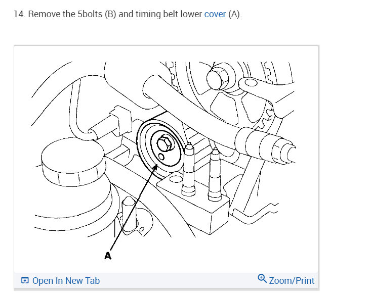

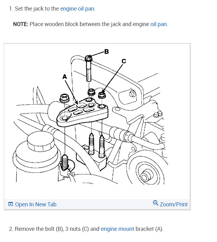

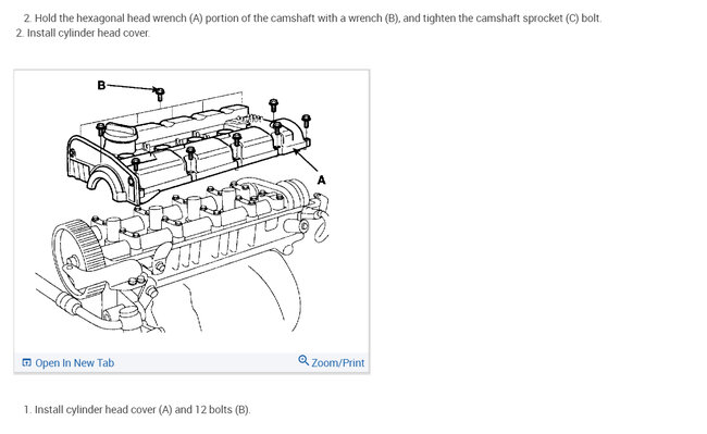

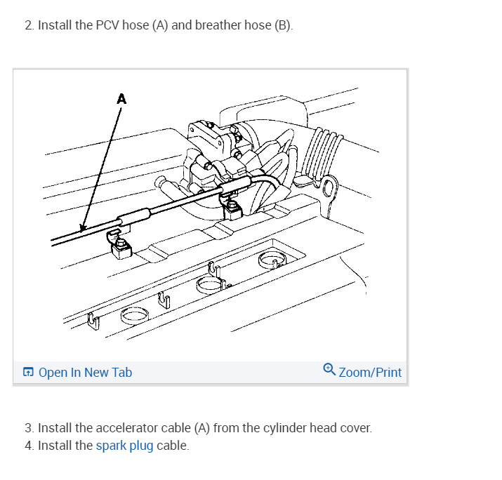

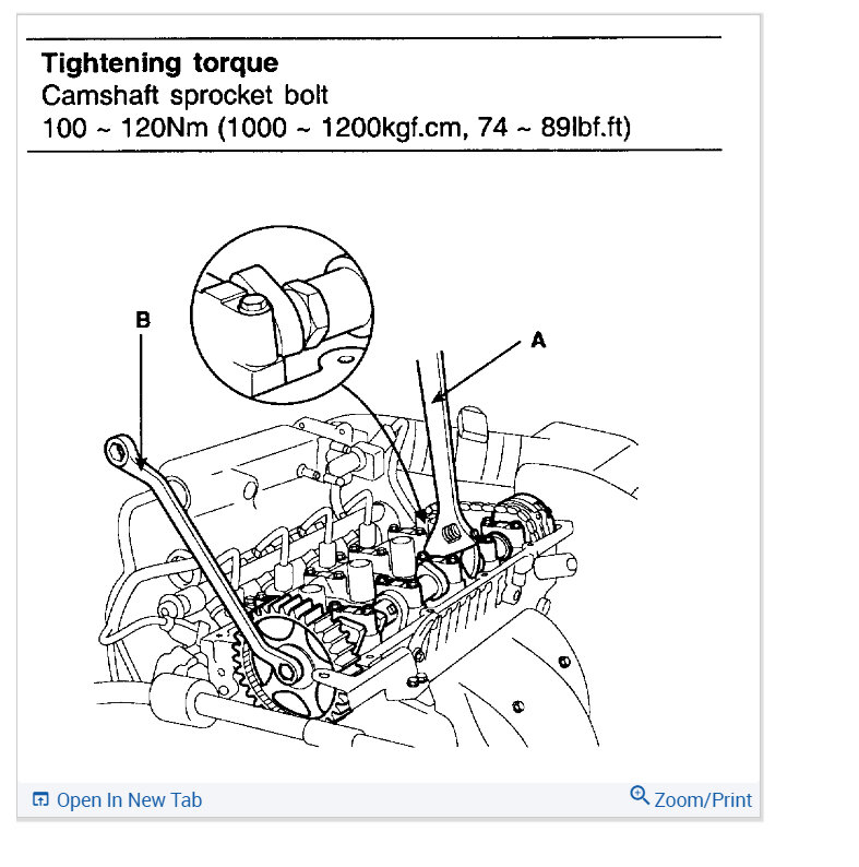

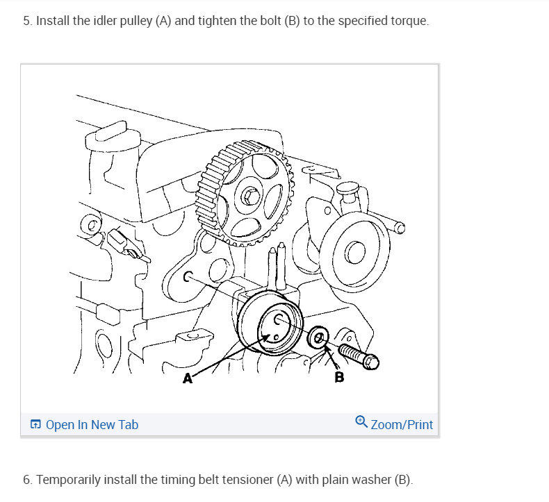

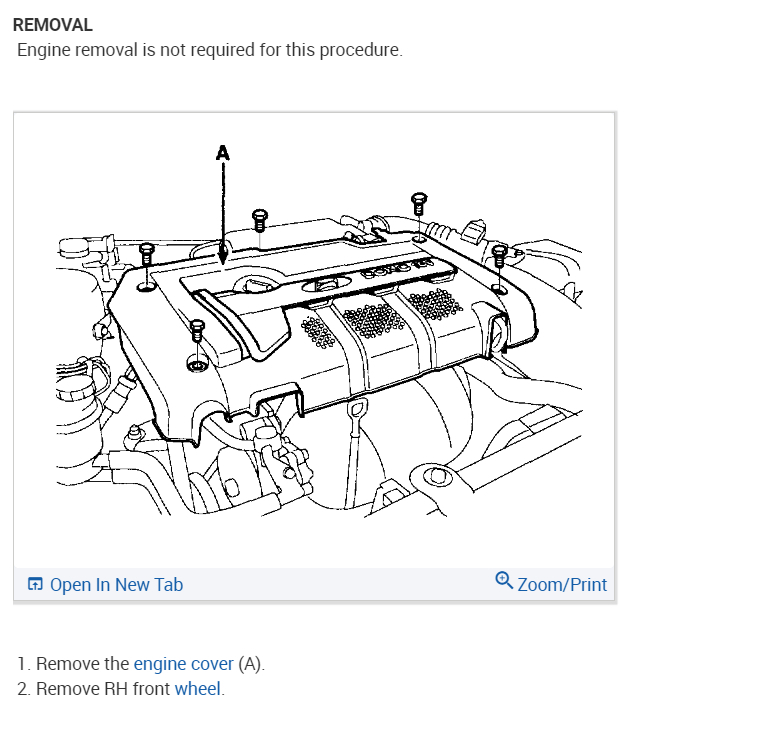

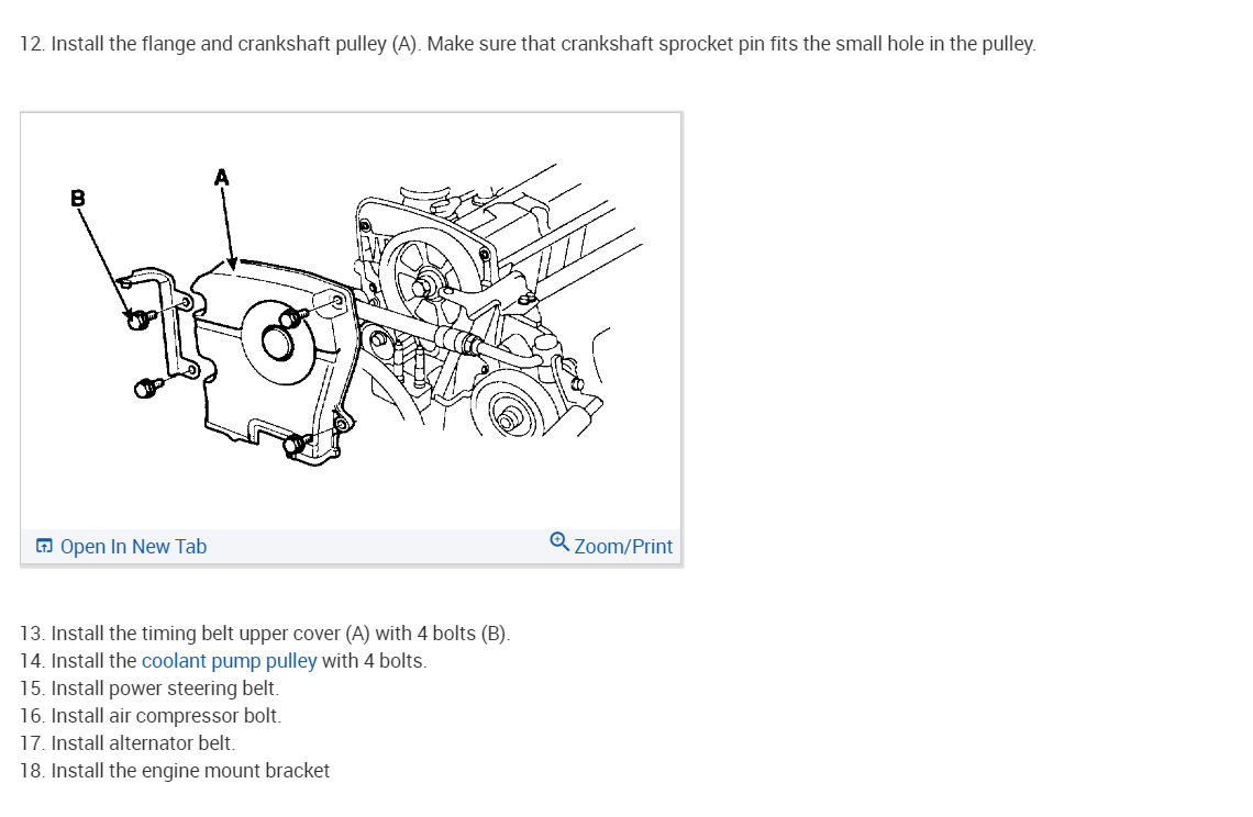

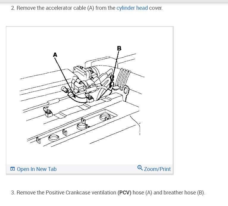

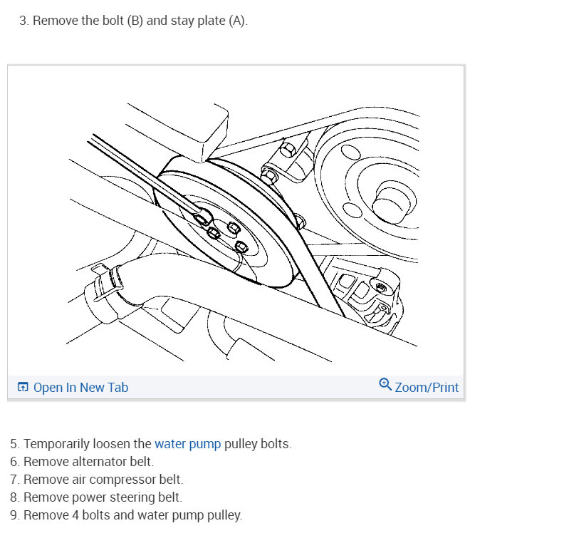

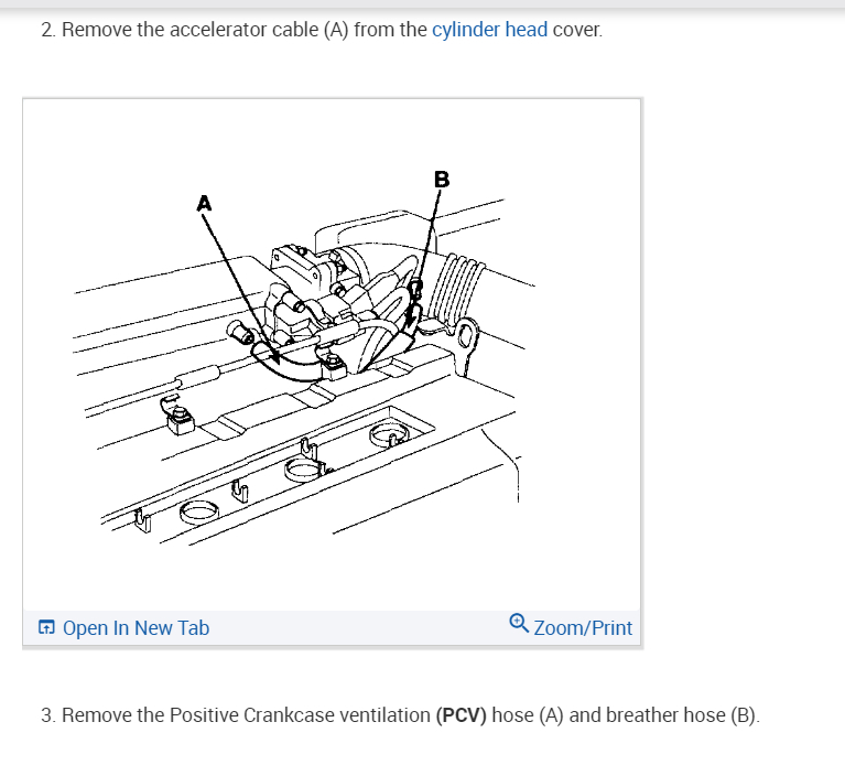

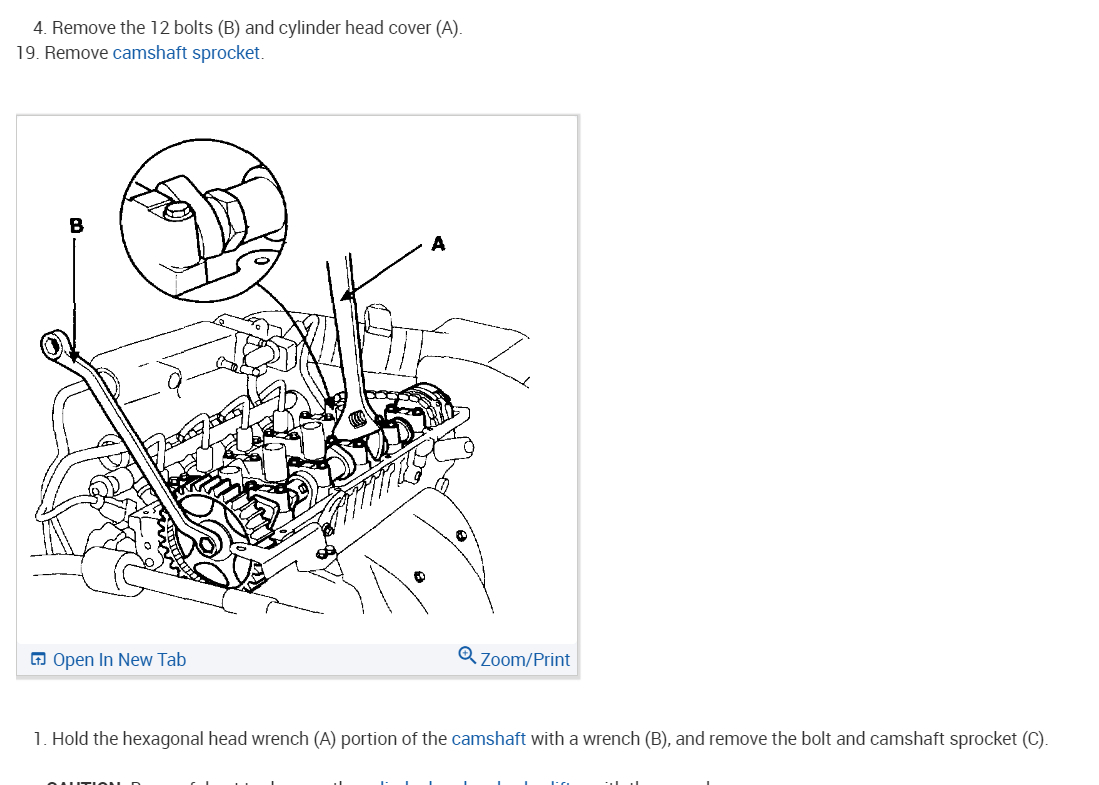

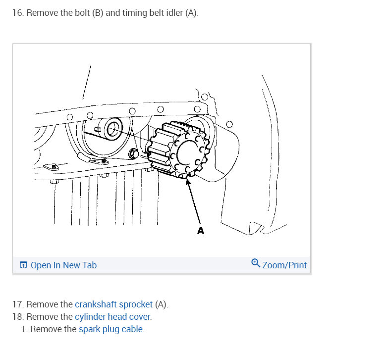

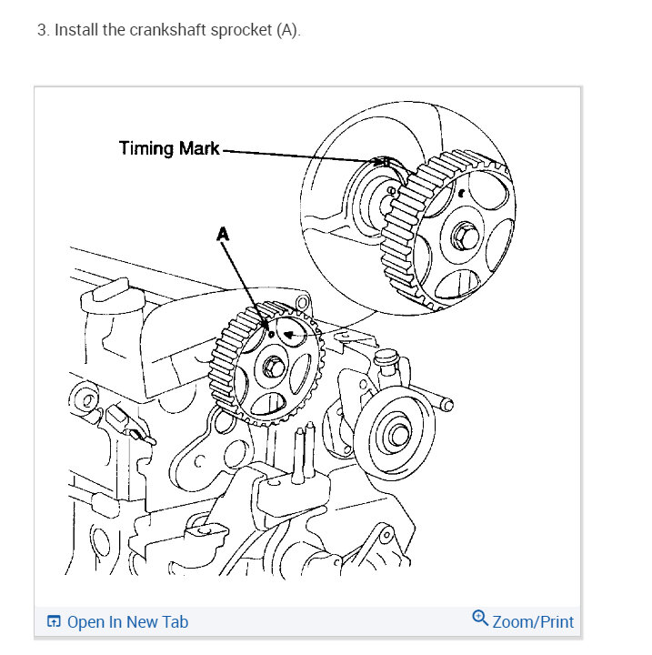

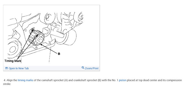

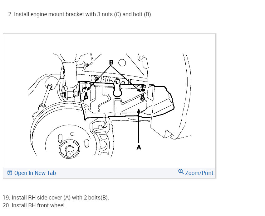

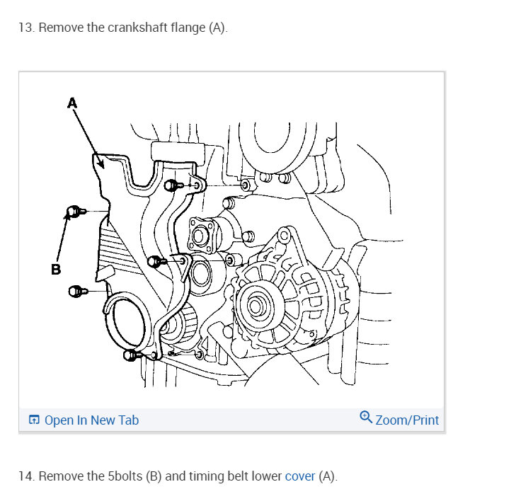

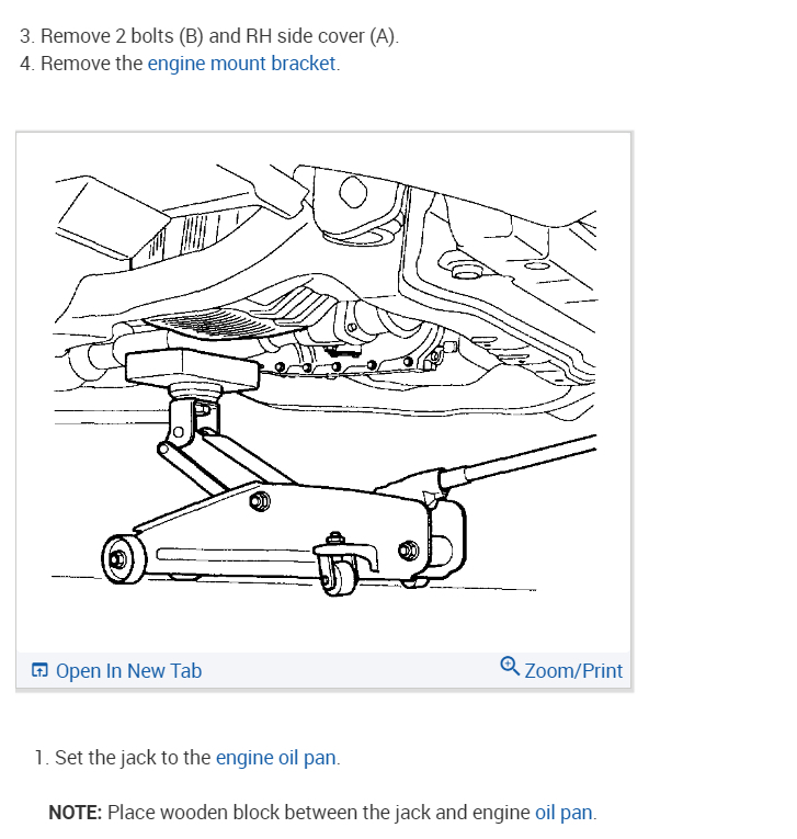

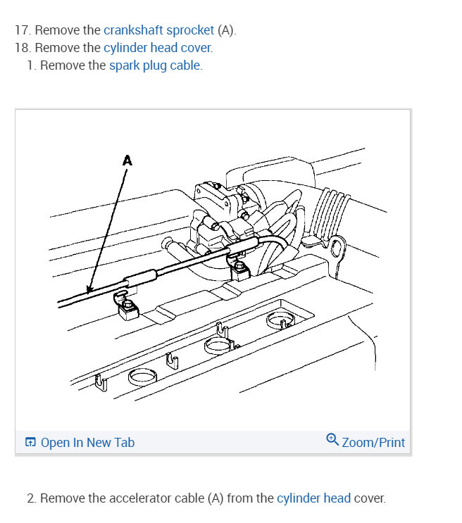

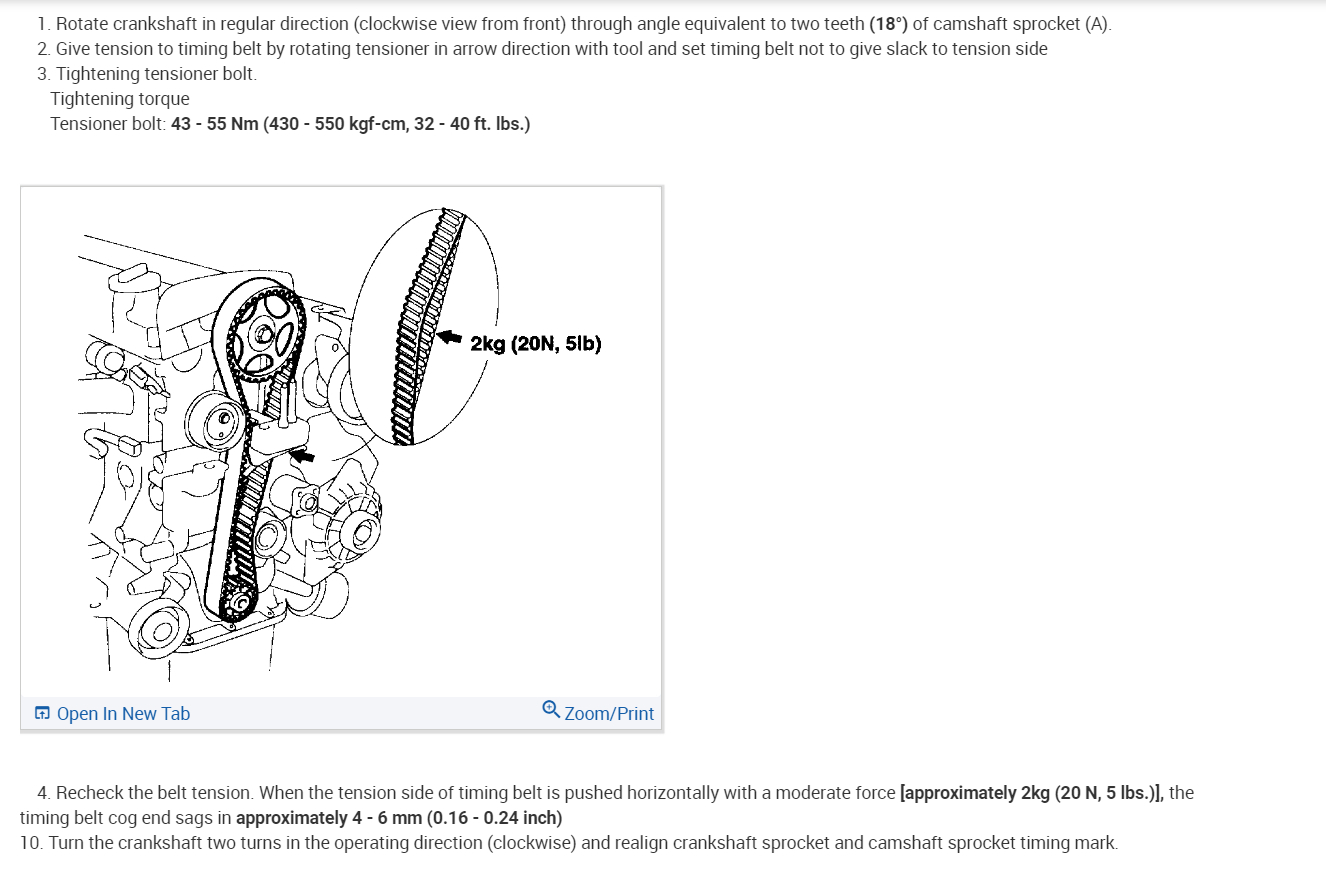

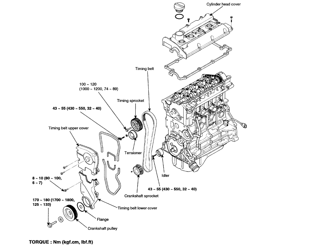

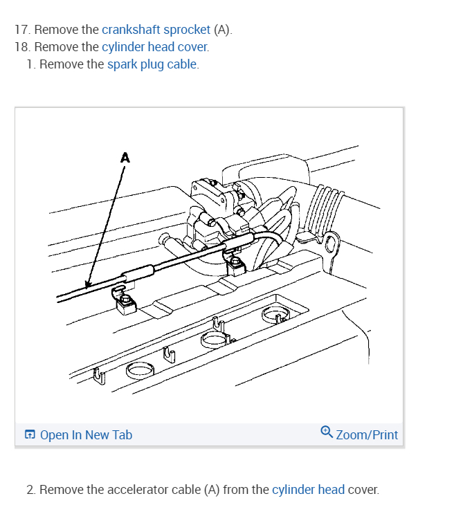

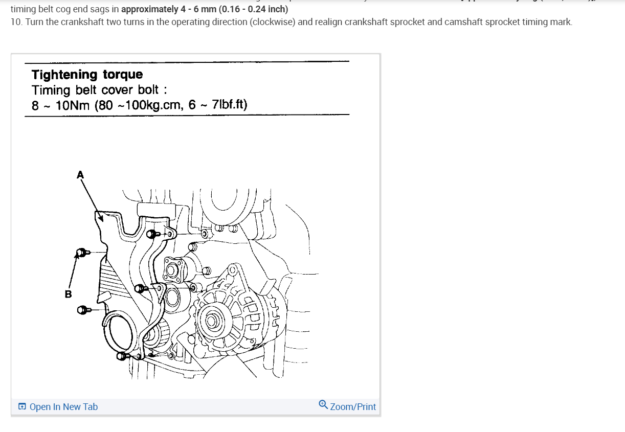

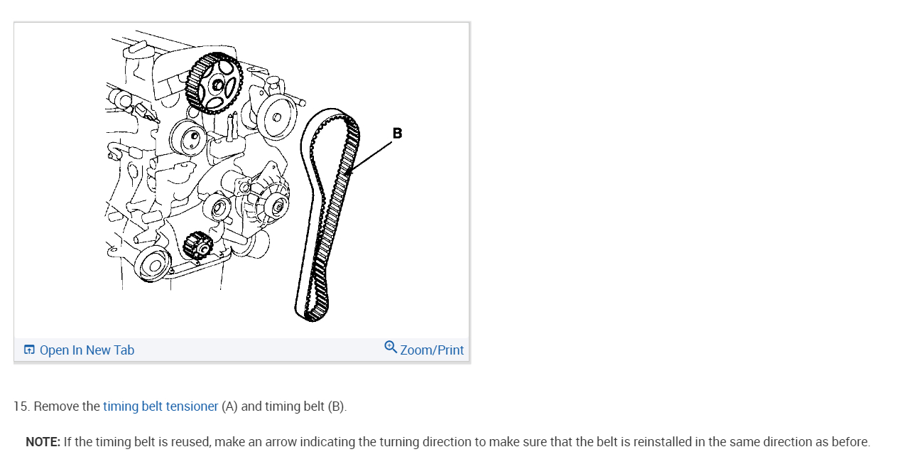

This is an interference engine. Here are the instructions on how to replace the timing belt with torque specs and timing belt marks so you can replace it yourself or see how the job is done to see what you are paying for. Check out the images (below). Please let us know if you need anything else to get the problem fixed.

Yep, it sounds like the timing belt is broken, thanks for the video. Let me know what you find.

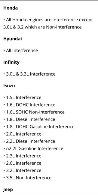

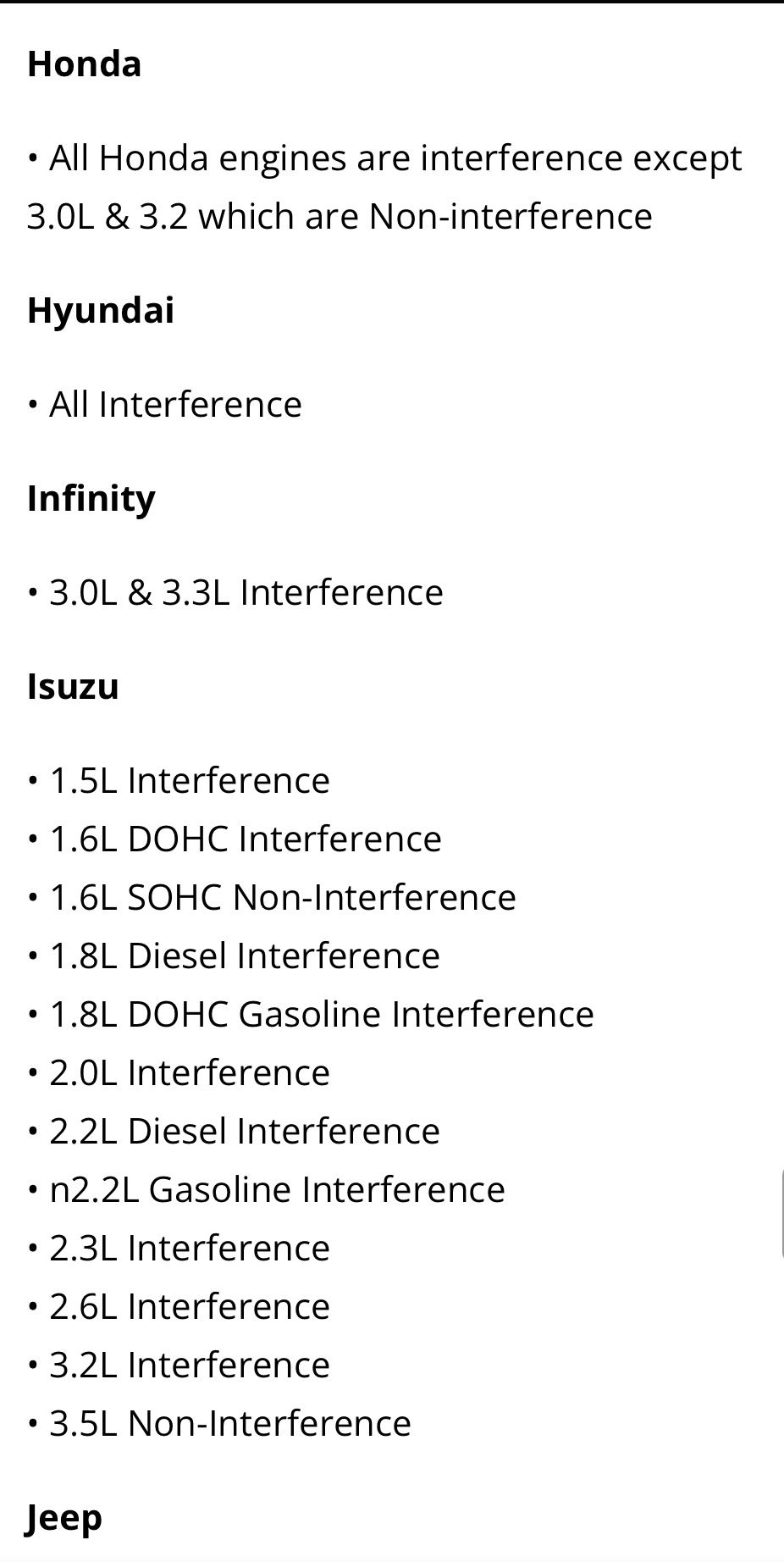

Ken, I saw this today it’s a list of car makers and which ones had engines that were Interference engine or non. This screenshot is just a little section of it. I just thought I’d send this to you. thanks for everything. this car is not mine just helping someone out, we haven’t went in it yet but I’ll let you know how it turns out. thanks for your help.
Jan 16, 2023 at 1:18 PM
  • 55,721 POSTS
Wow, I didn't even know they made interference engines past 2000 thanks for the info. I will correct my post above. Thank you.
