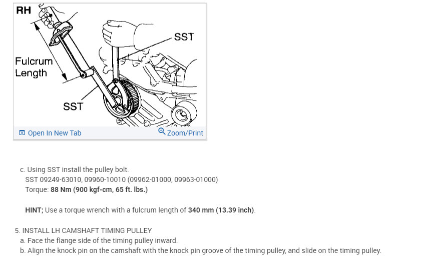

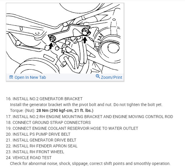

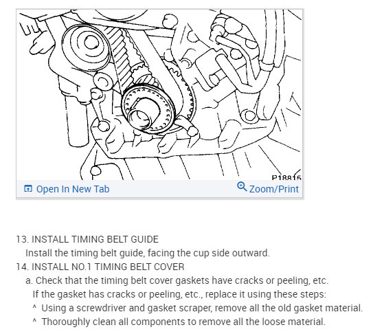

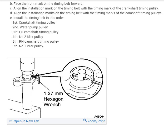

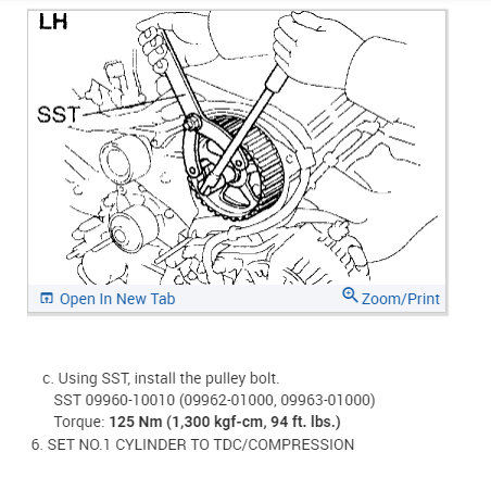

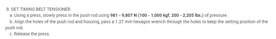

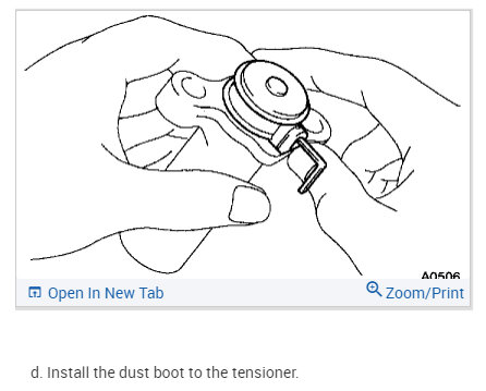

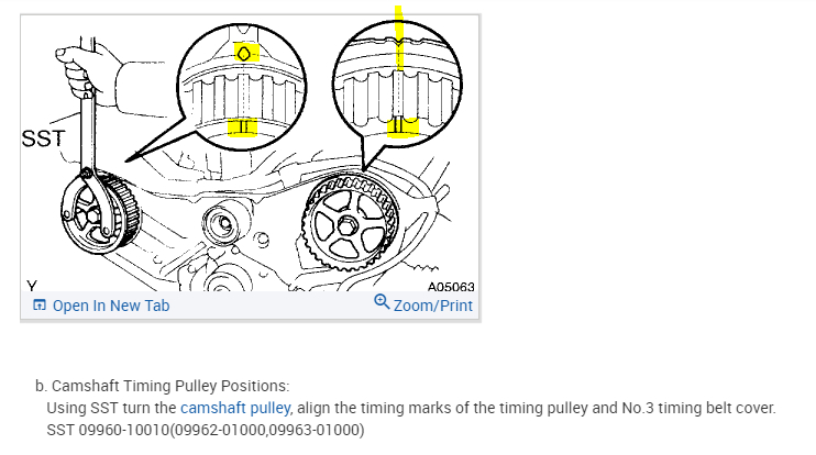

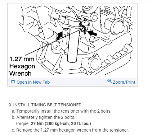

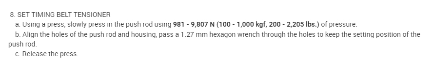

Had a guy replace the water pump and he jacked it all up. Cat timing belt covers which belt was hitting so bought new belt and put on. He didn't have in time. So, my car isn't running now which was driven to him and hauled back. Having problems putting in time. What do you suggest, maybe a video on the timing?
Jun 20, 2023 at 8:36 AM
  • 110,248 POSTS

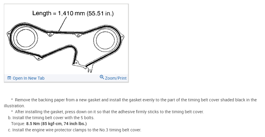

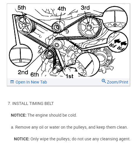

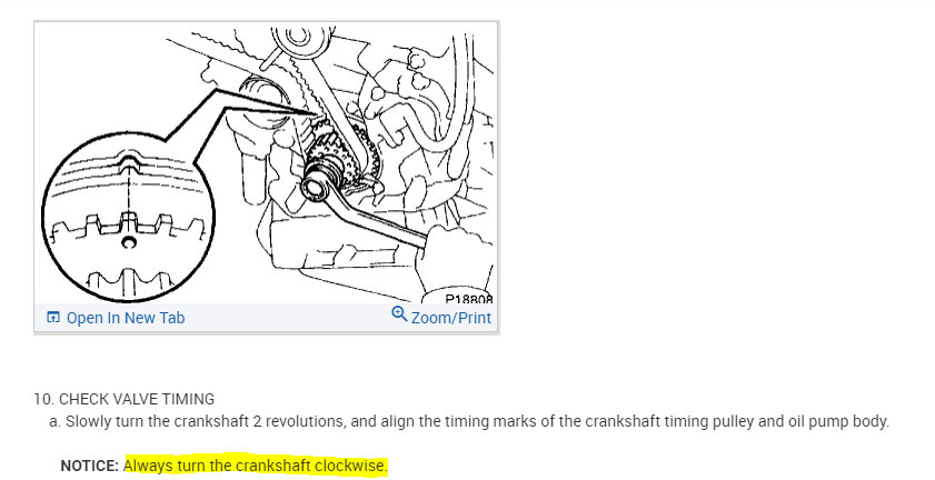

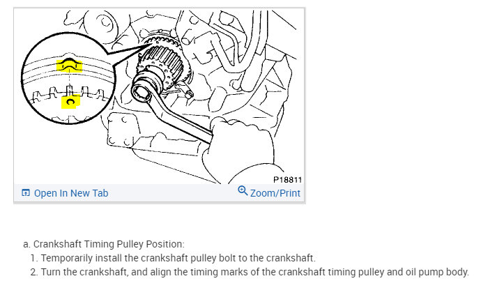

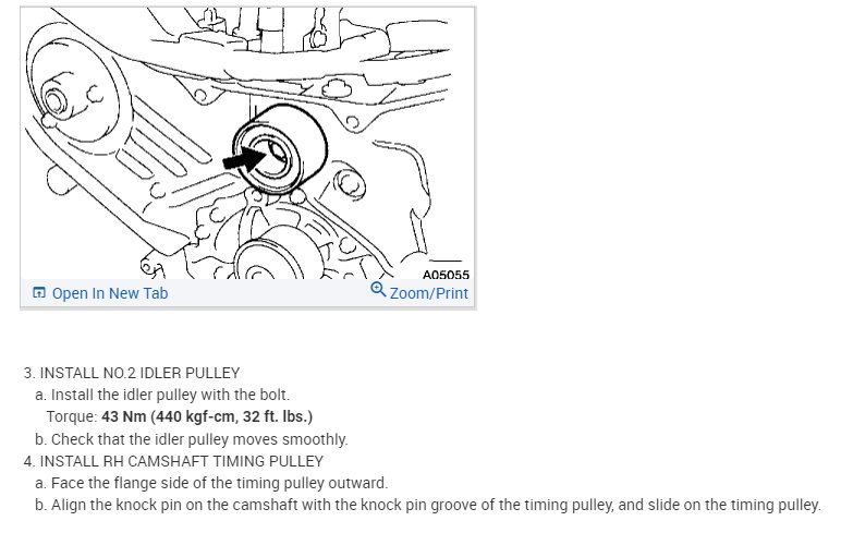

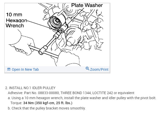

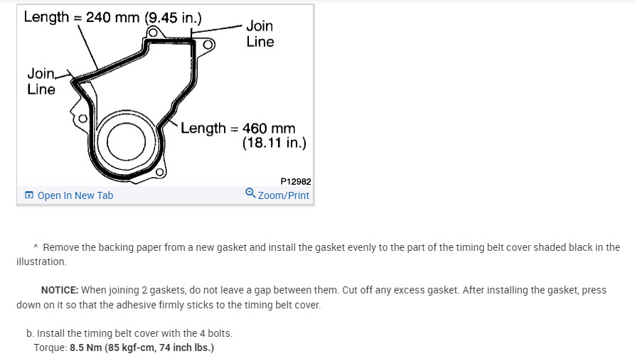

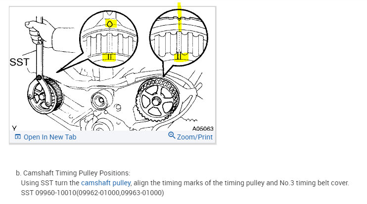

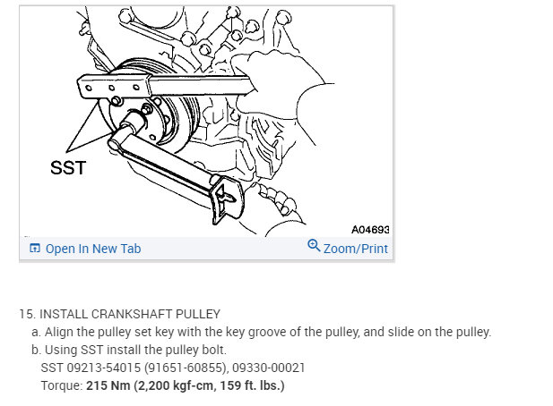

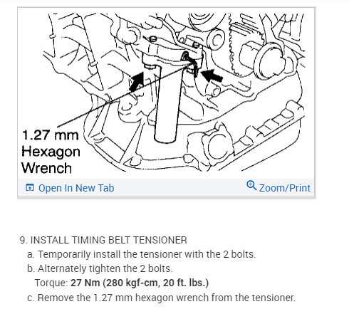

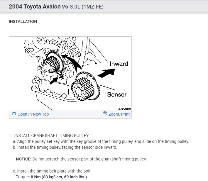

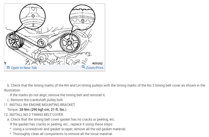

I assume the belt is off, so I attached the directions starting with "installation." Note that the directions include things like installing the camshaft pulleys which is likely already done.
Take a look through them and let me know if you have questions and if they help.
