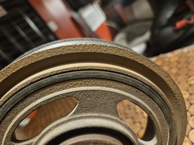

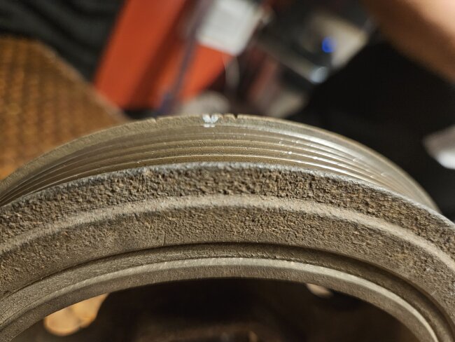

They all line up but I'm confused where the camshaft one should be lined up at. Your pics show two marks and mine has 4.

There should be two small plastic tabs you can take out to see the camshaft timing marks, you shouldnt need to remove any covers, notice in the diagram of that camshaft being lined up with the number 1 mark, service info states to look for the white mark on the crankshaft harmonic balancer. You will probably end up with cylinder misfire codes on every cylinder eventually.

Yes the marks line up and even after trying to start it they were lined up. You could manually turn the engine with no problem. So I was shocked to find this out. So this means I need a new motor (that'd be cheapest way right)?
