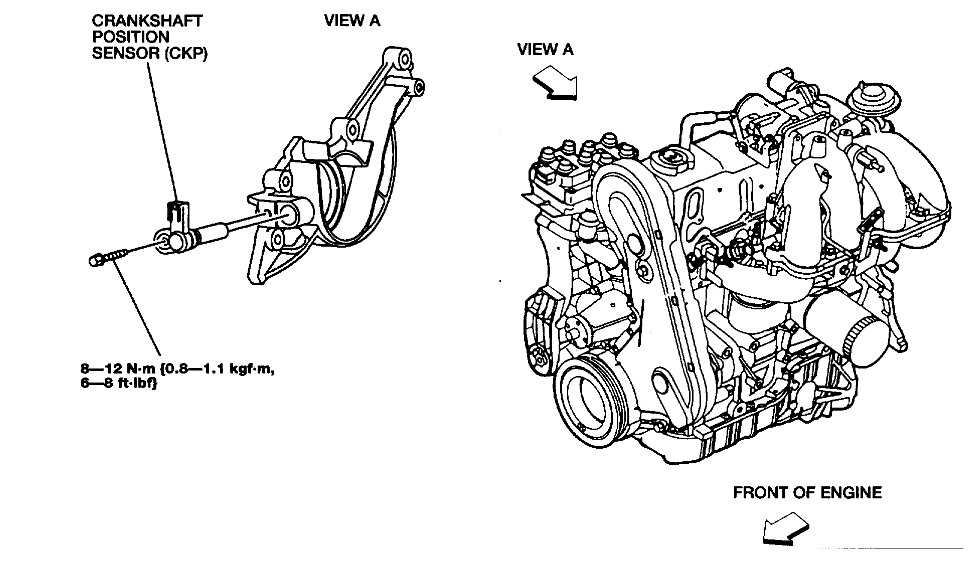

Belt broke, set the timing, and replaced the belt. I tried to start it, it has no fire, it does have compression. The engine will turn over. I have not put everything back together. I just have the timing belt on. Also, it has eight spark plugs.
Oct 11, 2022 at 1:38 PM
  • 110,194 POSTS
Is the crankshaft position sensor installed yet? Take a look at the pic below. If that isn't reinstalled, you won't have an ignition spark to the plugs.
