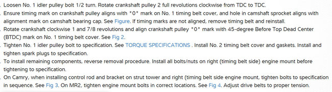

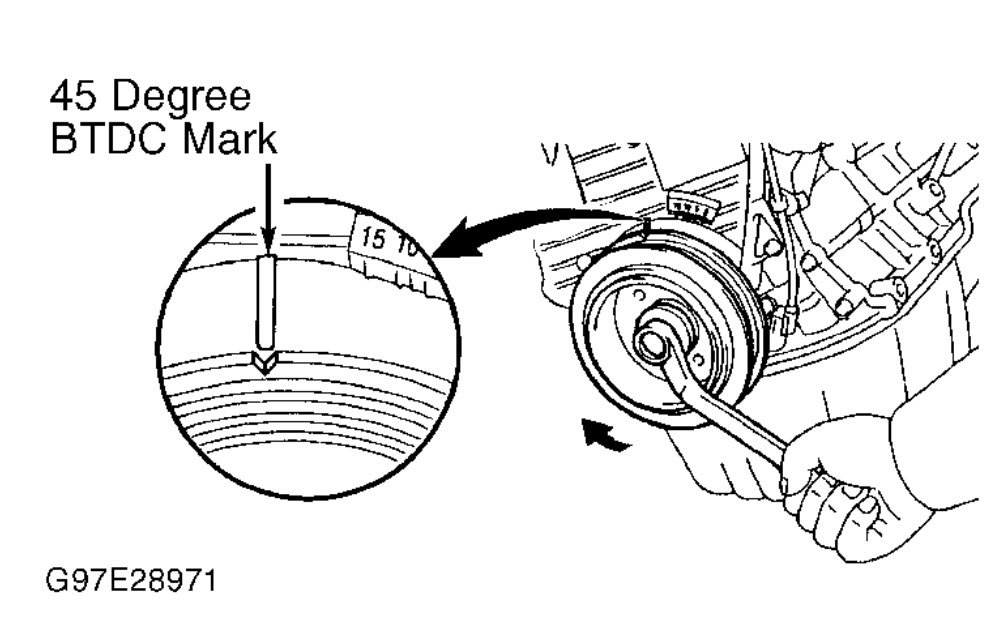

Have installed my new timing belt and alligned with timing marks.. It says to rotate two revolutions. Marks are still good.Then it says to rotate 1 7/8 revolutions and align on BTDC? I do not understand. Help

re read the instructions i am sending and look at picture. it has to line up with BTDC mark in picture it is probably hard to see.
