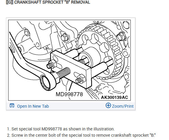

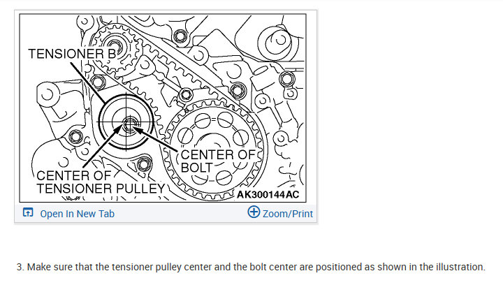

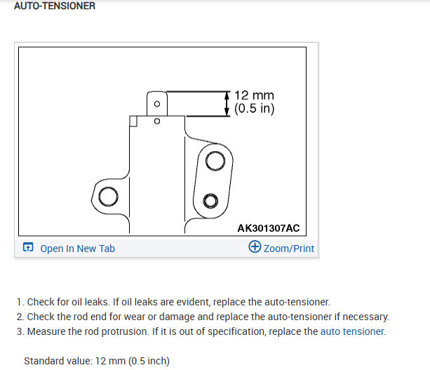

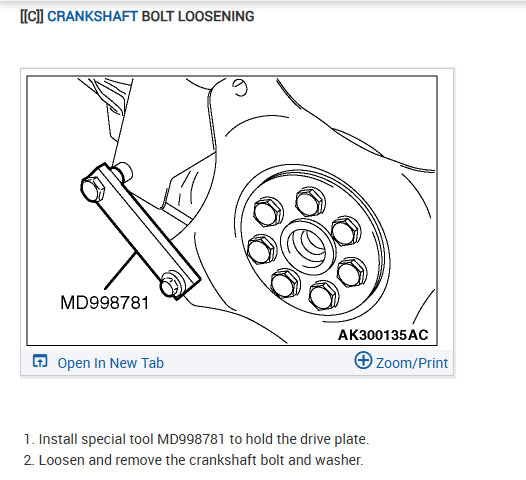

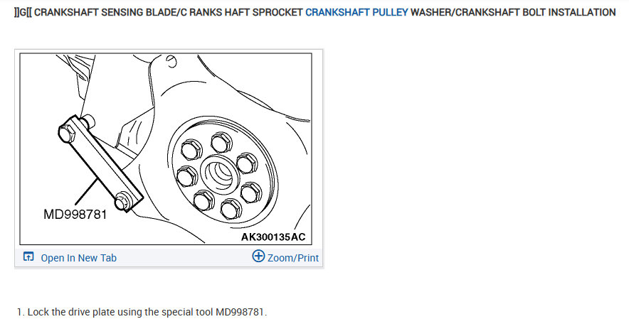

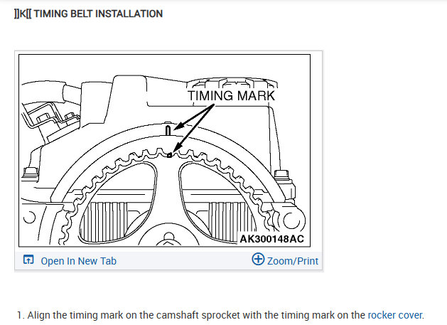

Timing belt installation instructions needed?
2009 MITSUBISHI GALANT
146,000 MILES • 2.4L • 4 CYL • 2WD • MANUAL
TAINA
  • 12 POSTS

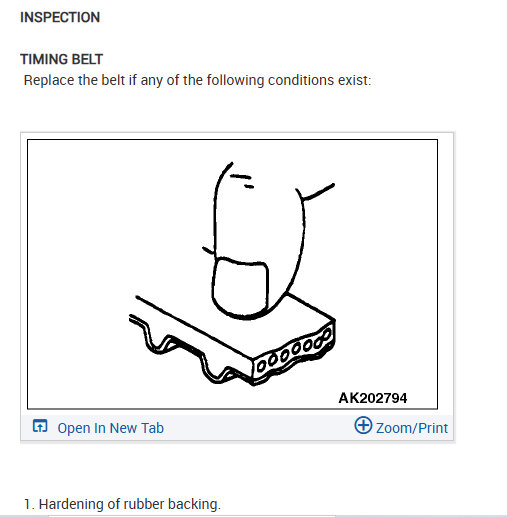

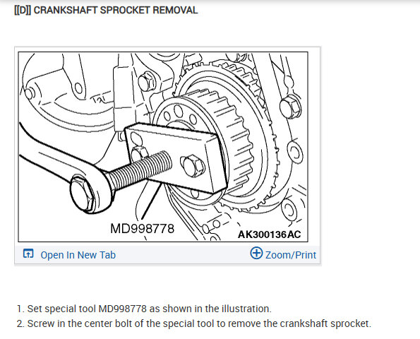

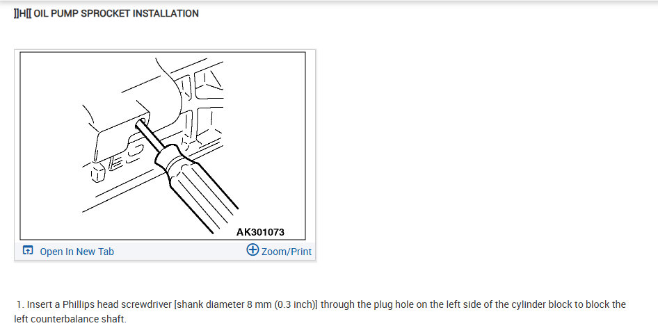

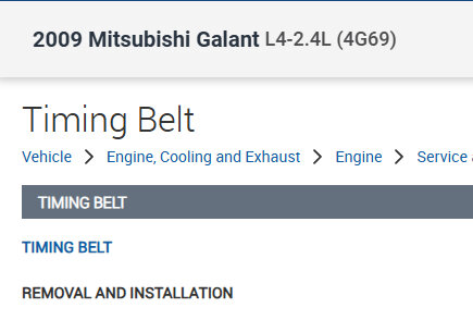

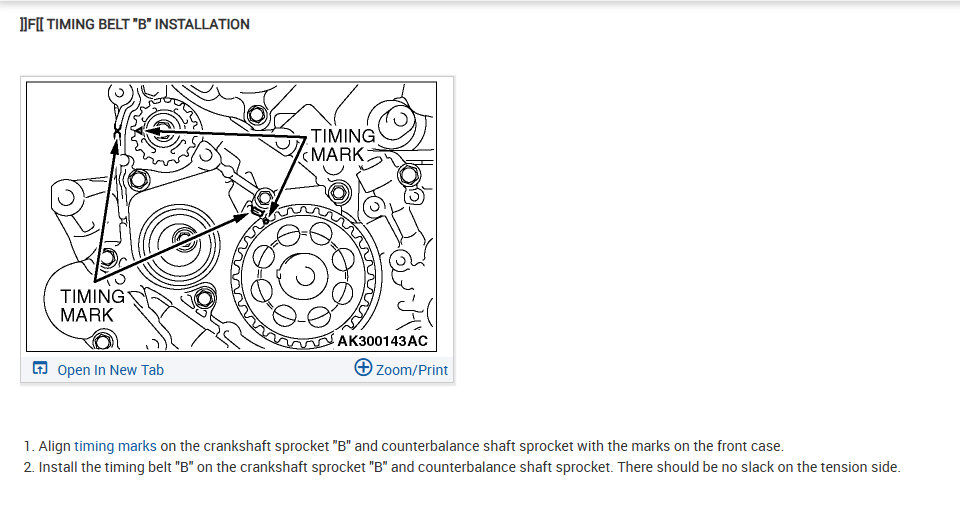

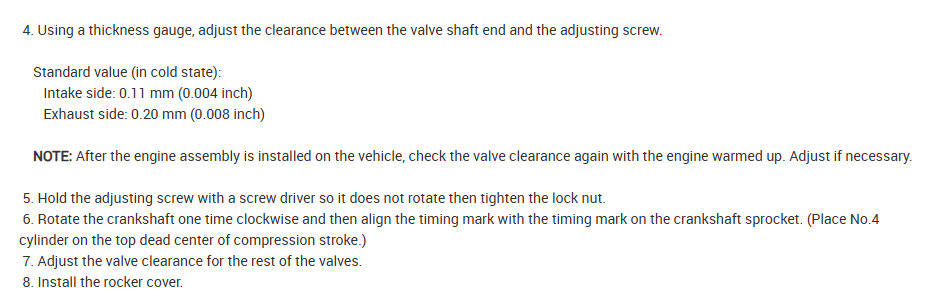

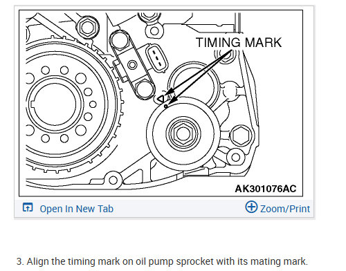

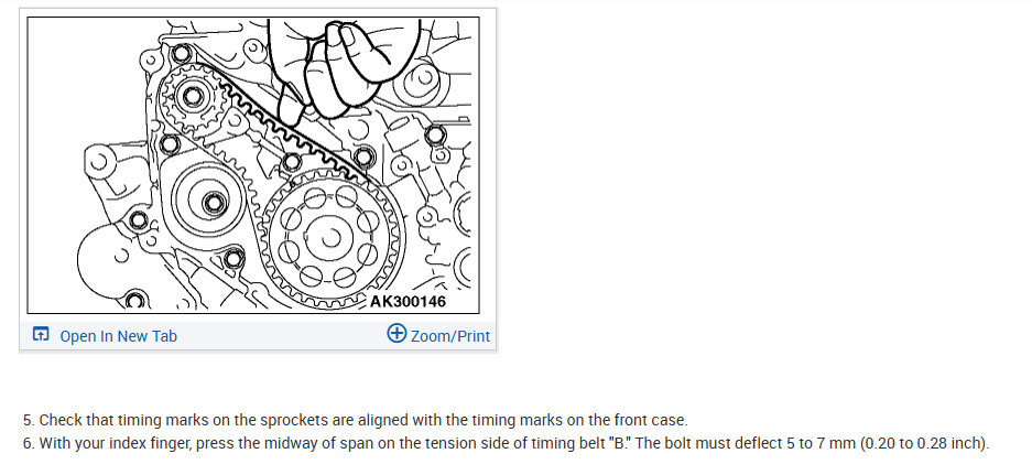

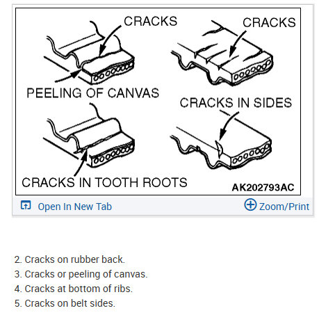

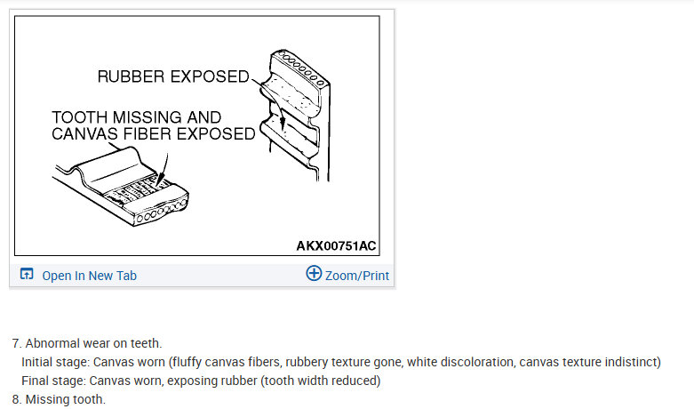

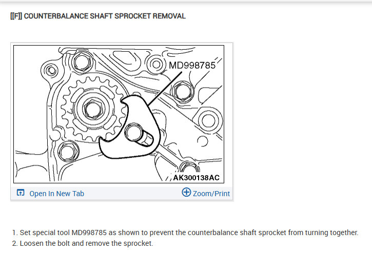

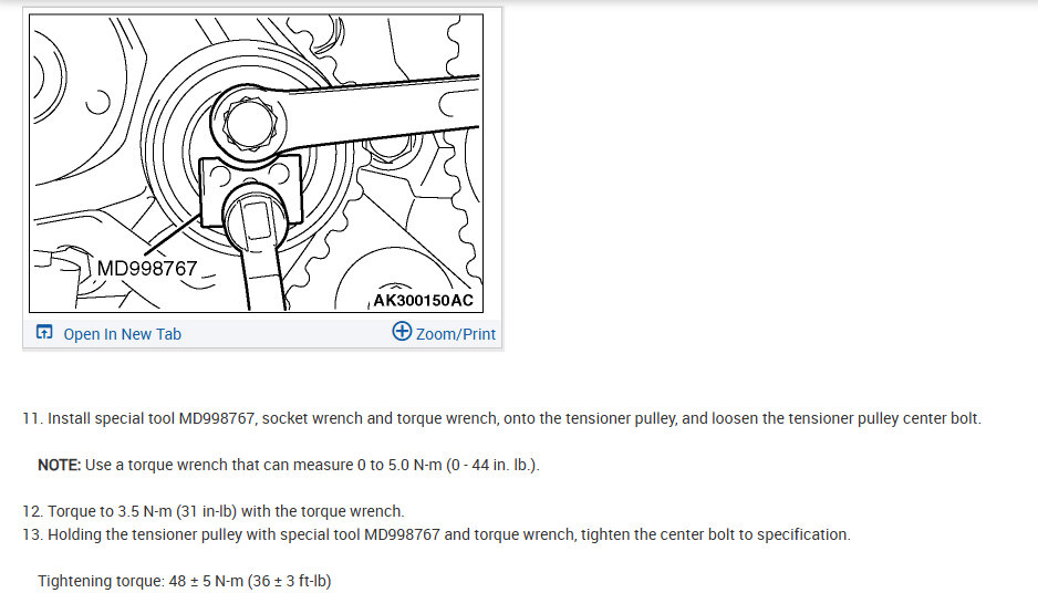

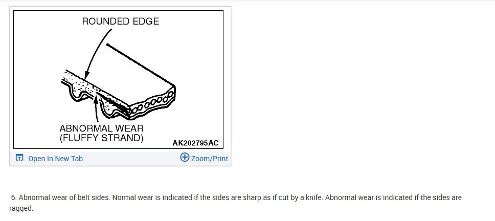

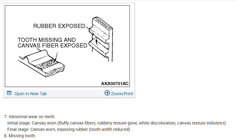

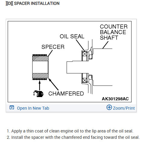

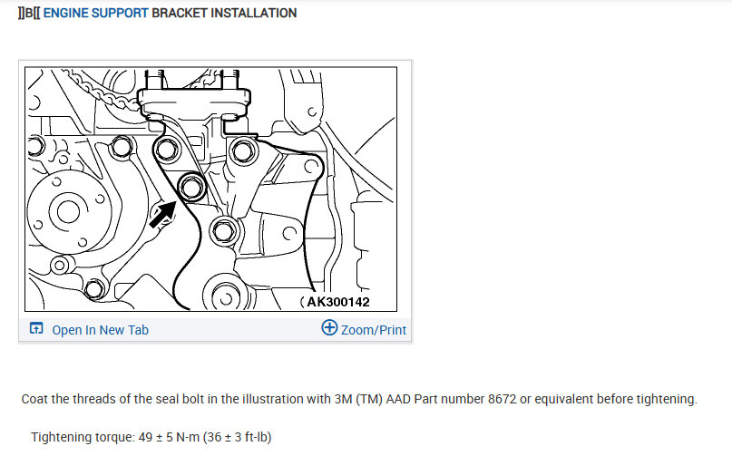

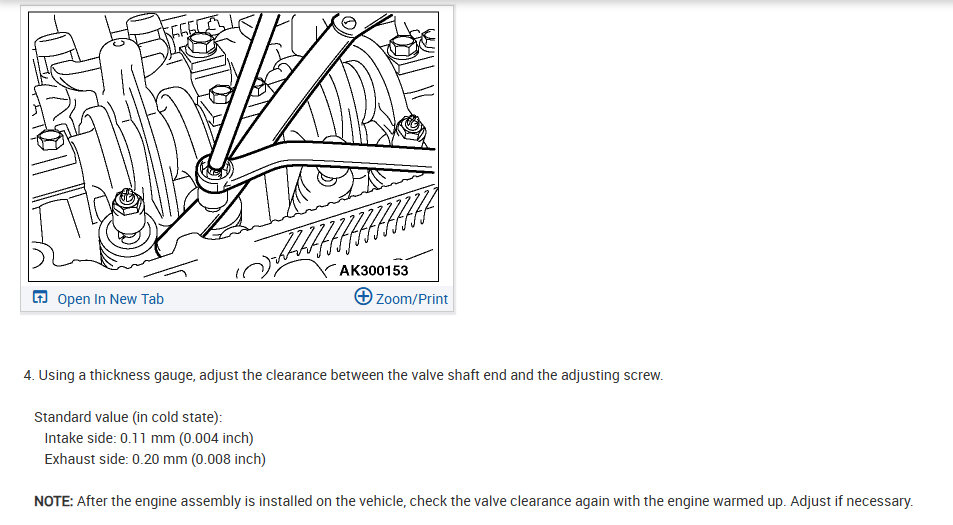

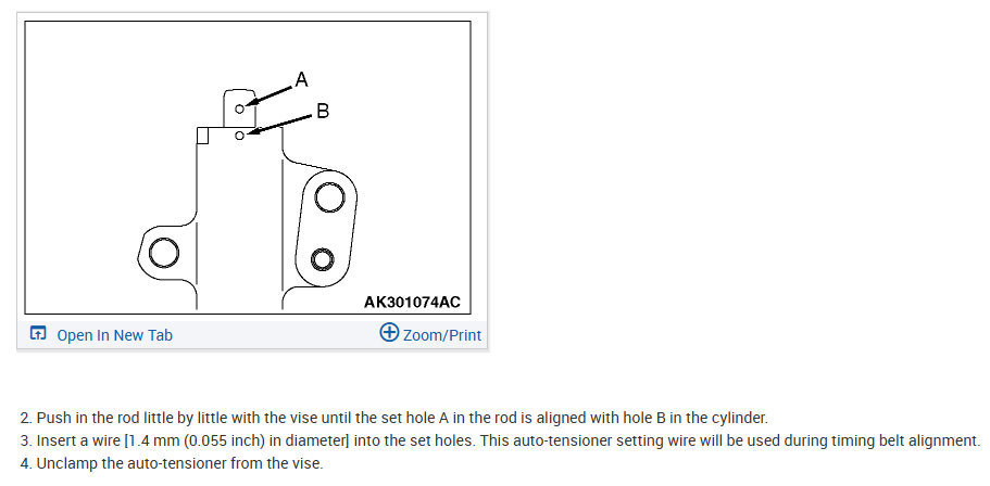

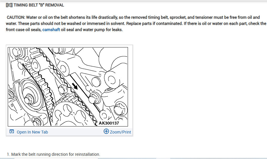

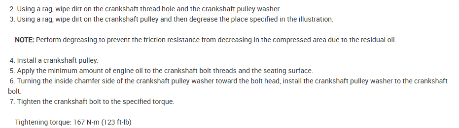

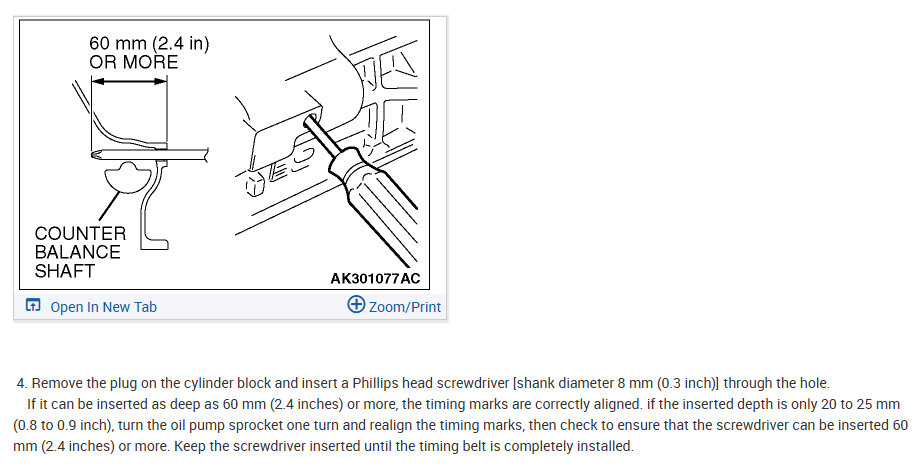

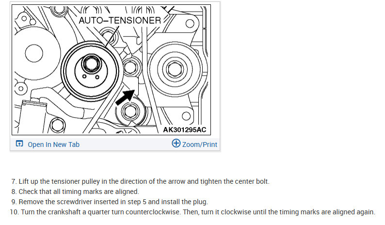

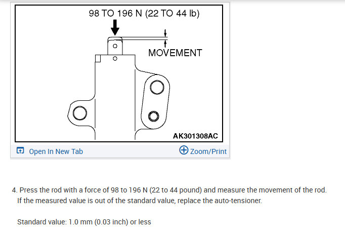

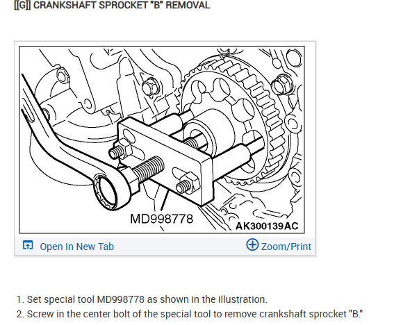

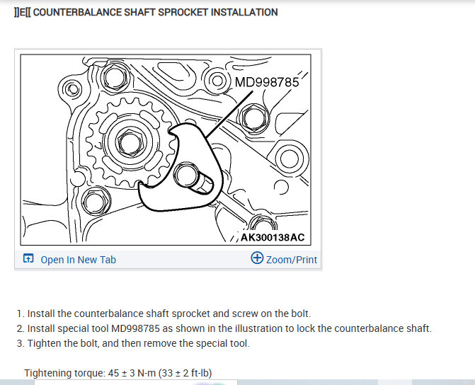

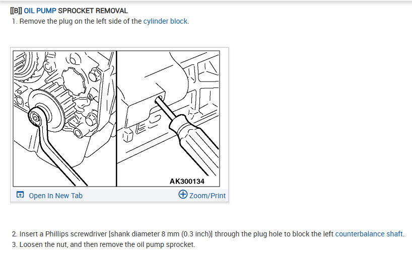

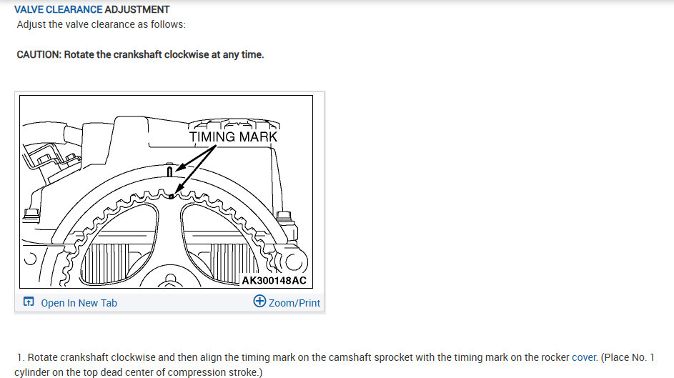

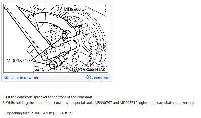

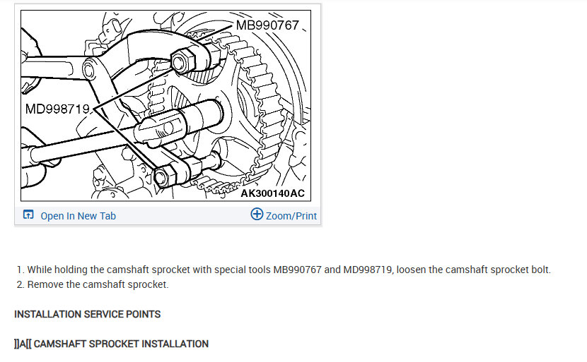

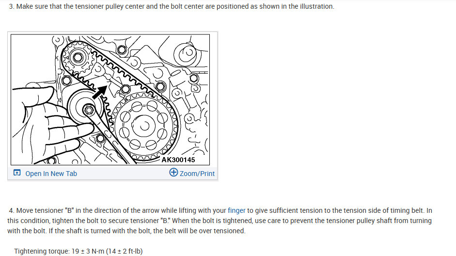

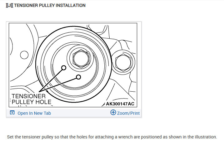

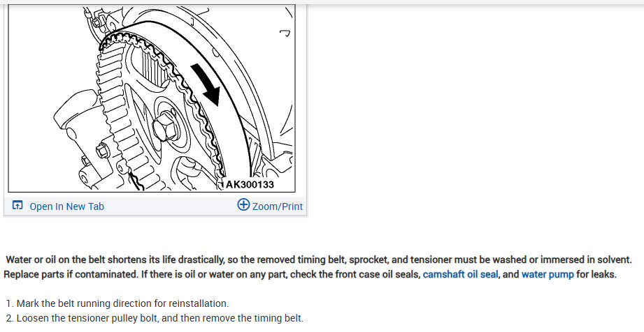

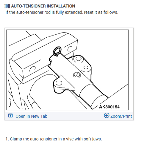

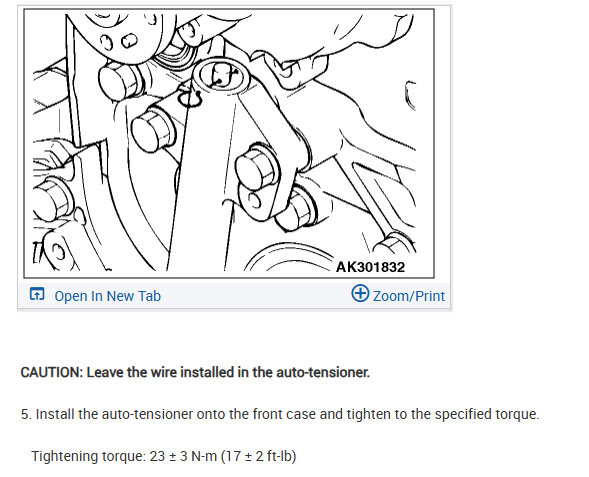

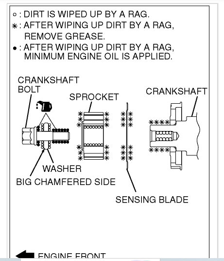

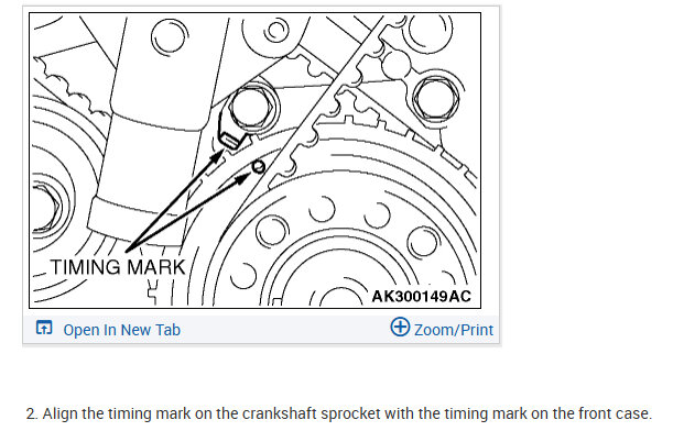

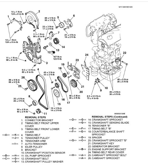

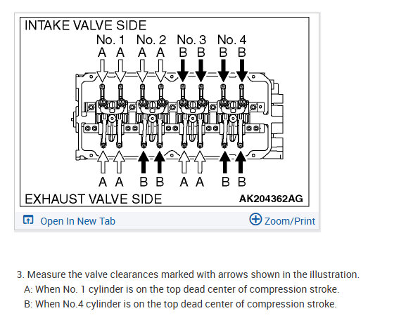

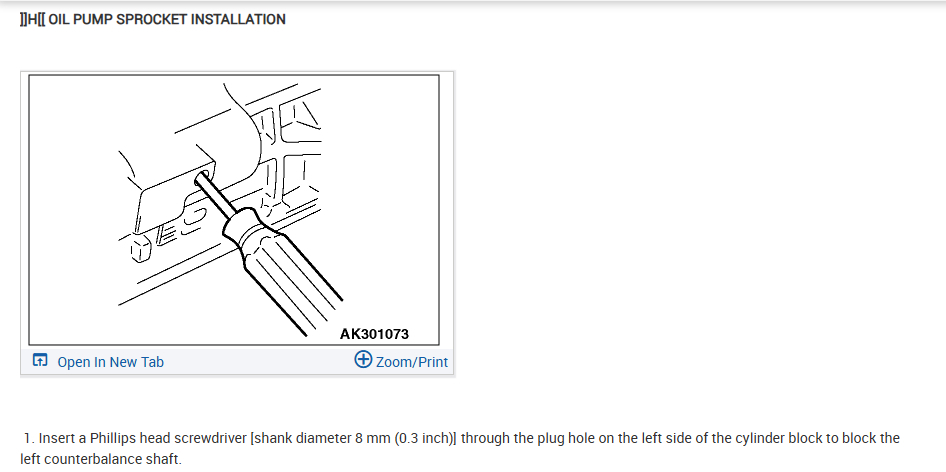

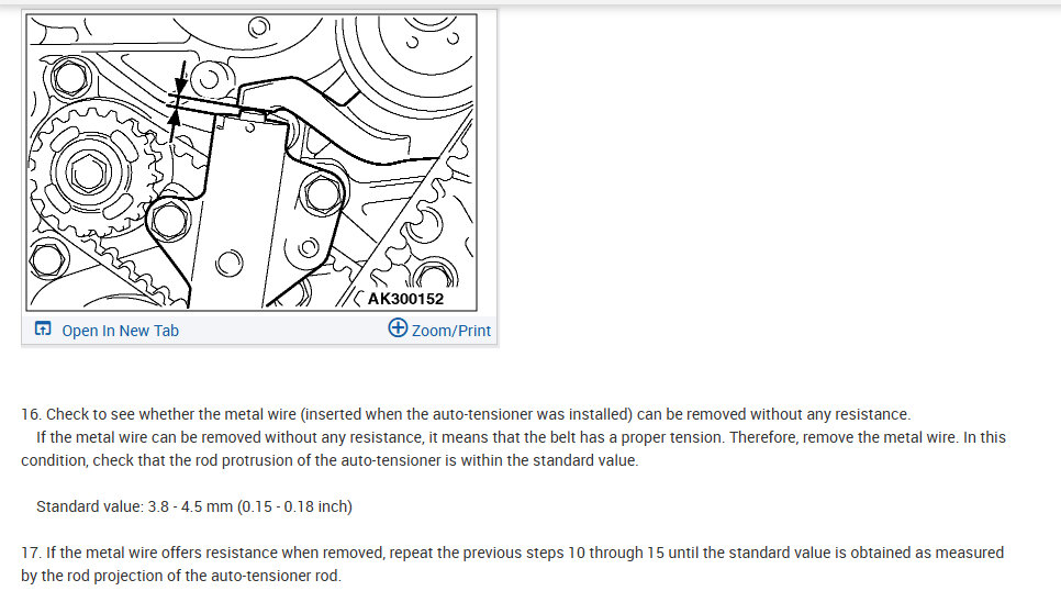

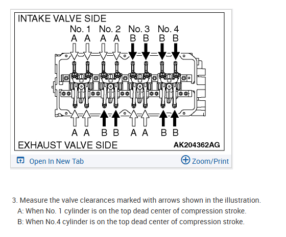

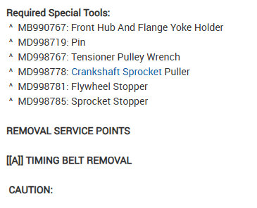

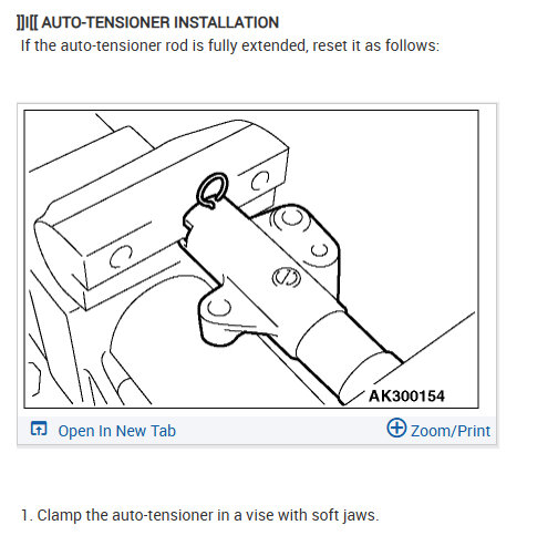

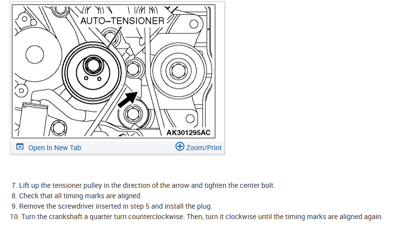

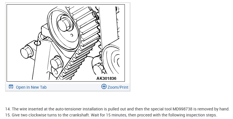

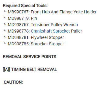

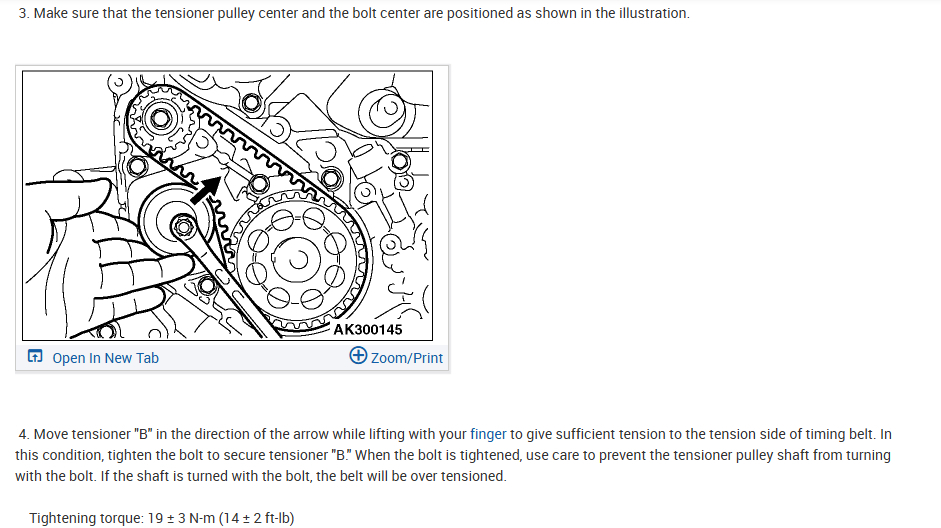

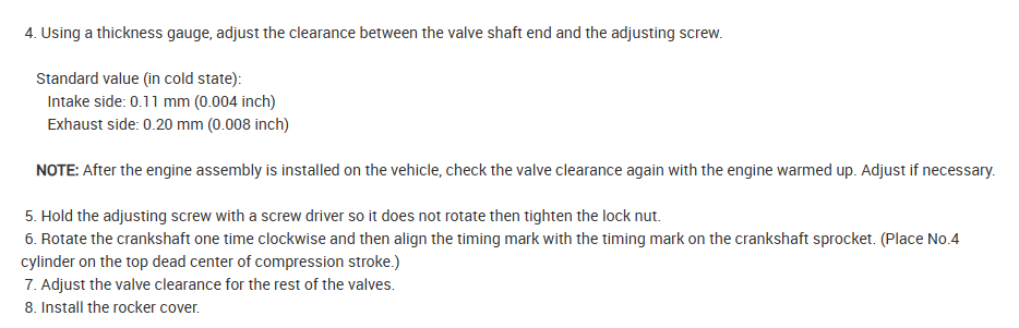

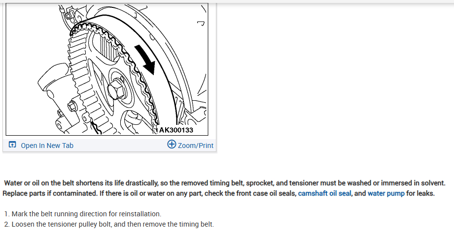

Remove the old timing belt tensioner pulley, idler pulley, water pump and install all new parts and belts timing belt with pictures diagrams.
Nov 16, 2024 at 3:05 PM
  • 110,240 POSTS

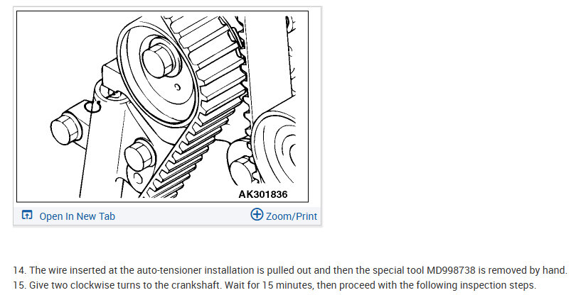

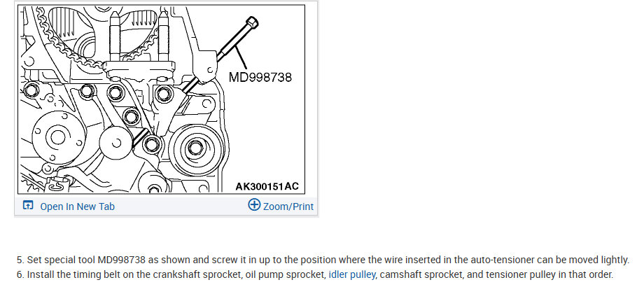

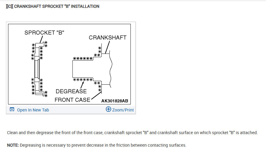

I attached the directions below for the entire job. I suspect there are things you won't need to do such as replace belt pulleys, but it's all there. LOL
Take a look through the directions (extensive) and let me know if you have questions.
