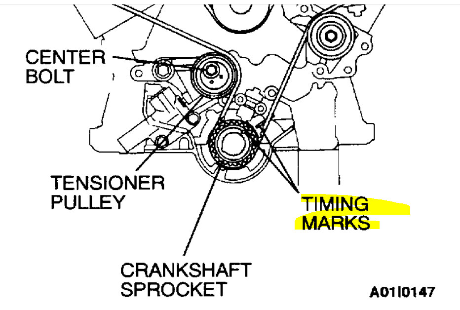

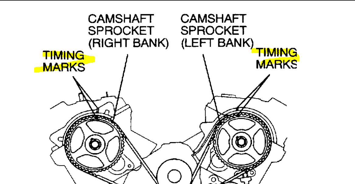

I assume you are referring to timing marks, correct? Your question isn't very descriptive. LOL Just kidding.
If that is the case, I attached two pics below showing them. The first picture is for the camshafts and the second is for the crankshaft.
Let me know if this is what you needed.
