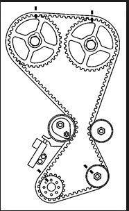

at what interval must timing belt be changed?
Please send a diagram or and a picture to assist in changing.
Nov 12, 2017 at 11:39 PM
  • 55,423 POSTS
The timing belt should be changed between 90,000 and 110,000 miles. To change the timing belt will require you removing the front balancer and timing cover.
Here is a guide to show you how to remove the balancer:
https://www.2carpros.com/articles/how-a-harmonic-balancer-works
See the diagrams (below).
