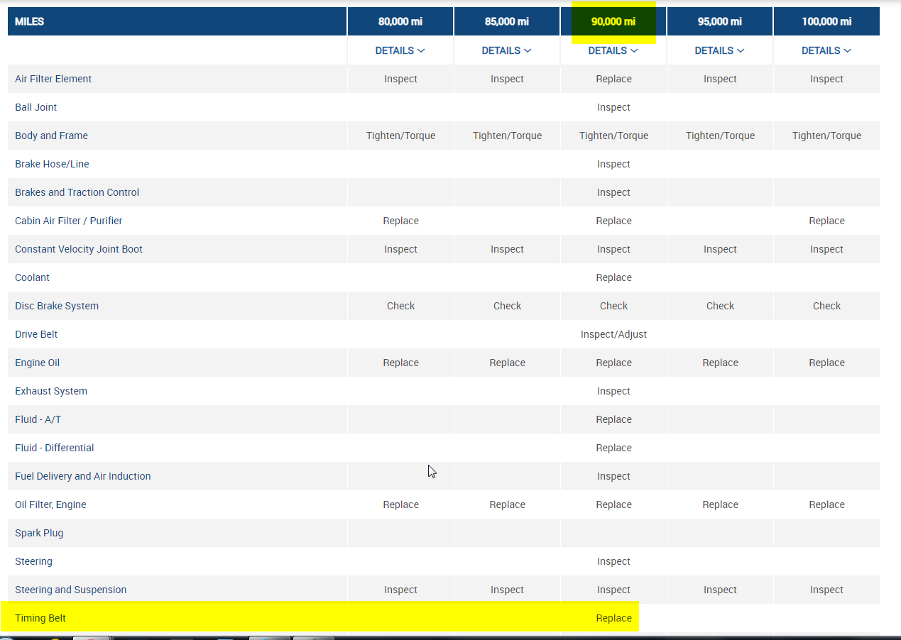

How do I know when the timing belt needs replacing?
Nov 11, 2020 at 7:00 AM
You don't want to find out that it is time that you have to change it because that is by it breaking. So it is important to have it changed at its proper interval which is 90,000 miles. If you are at 133,000 miles and have not changed it then we need to get that done ASAP.
Let me know if you are going to do this yourself and I can send the instructions. Thanks

Hey Davis.
I'm looking at a 2003 edition of a timing belt replacement manual... The OEM (Toyota) has 'not' recommended a timing belt replacement interval for this engine. Typical trade practice indicates that, as a precaution, the timing belt should be replaced at 60,000 mile intervals. "Caution": This engine has been identified as an 'Interference' engine in which the possibility of valve-to-piston damage in the event of a timing belt failure is 'most likely' to occur. (direct from the manual)
Replacement book time is about 3 hours and as a standard practice, replace the water pump at the same time, which will raise repair time some. And a wise practice, replace belt tensioner and guide pully too.
I recommend that you do not put off belt replacement.
