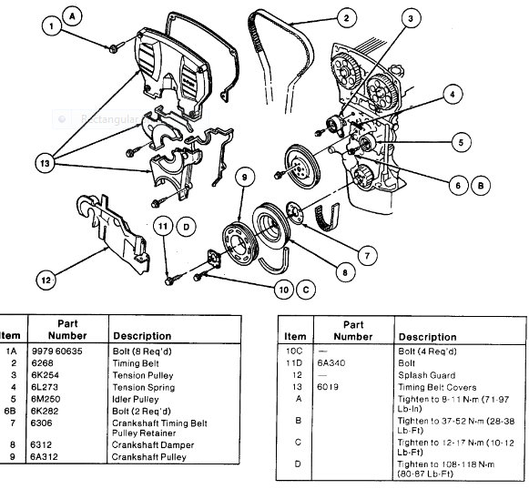

Need to know how to replace timing belt and water pump on 91 mercury capri
Jan 24, 2019 at 1:28 AM
SEVAG P
  • 405 POSTS
Hello RIFFIE thanks for using 2 car pros.
here are the direction for timing belt replacement specific to your vehicle.
PROCEDURE.
REMOVAL (SEE PIC 1)
1-Raise vehicle on hoist.
2-Remove right front tire and wheel assembly. Remove RH splash guard.
3- Lower vehicle.
4-Remove spark plugs. Set engine timing to TDC on No.1 cylinder.
5- Remove generator and power steering belts.
6- Remove oil dipstick.
7- Remove water pump pulley.
8-Remove crankshaft pulley, damper and support plate.
9-Remove crankshaft timing belt pulley retainer bolt and retainer.
10- Remove upper timing belt cover.
11- Remove center and lower timing belt covers.
12- Remove timing belt tension spring.
13- Loosen timing belt tension pulley.
14- Support engine with floor jack and remove RH engine mount.
NOTE: Mark timing belt rotation direction before removal.

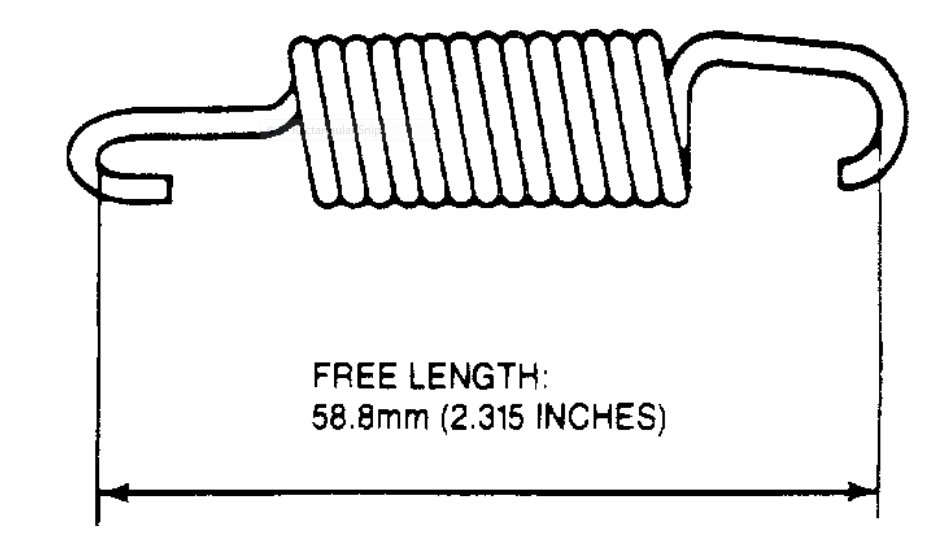

Timing Belt Tension Spring(SEE PIC 2)
When servicing the timing belt, check the free length of the timing belt tension spring. Replace if out of specification.

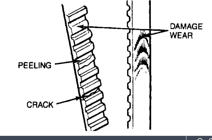

Timing Belt
CAUTION:
Never twist, turn inside out, or bend timing belt. Keep belt away from grease and oil. Replace the timing belt if affected by grease or oil. Check the timing belt for wear, tears, peeling, cracks or hardening. Replace the belt, if required(SEE PIC 3).

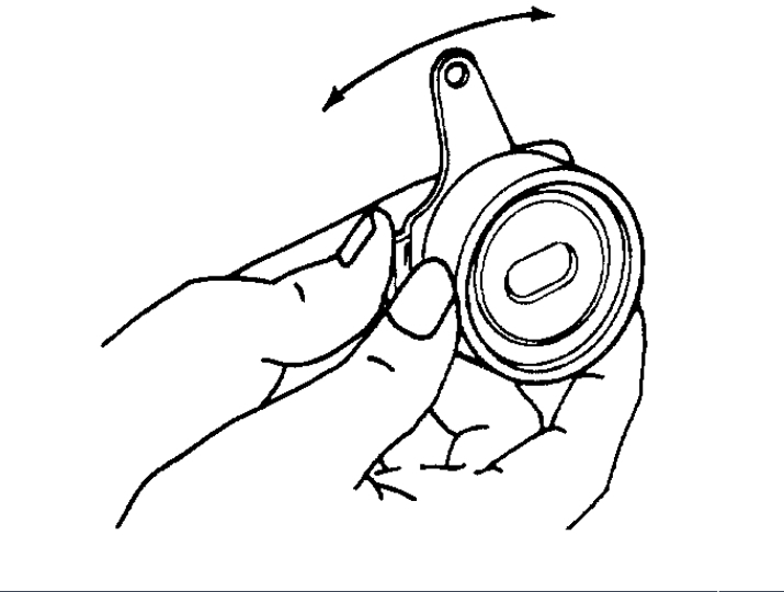

Tensioner and Idler Pulleys
CAUTION:
Do not clean tensioner or idler pulleys with solvents. Wipe them clean only. Spin pulleys by hand and check for smooth rotation or abnormal noise. Replace, if required.(SEE PIC 4).

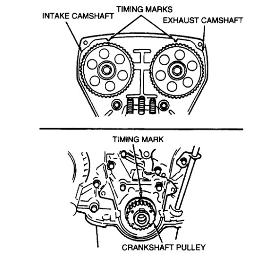

1. Ensure timing marks are properly positioned on camshafts and crankshaft as shown. The intake camshaft should have the letter "I" aligned with the arrow on the belt cover. The exhaust camshaft should have the letter "E" aligned with the arrow on the belt cover.
2. The crankshaft woodruff key should align with the arrow as shown.

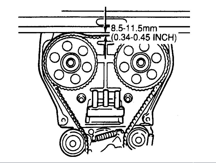

9. Measure timing belt tension between camshaft pulleys. Belt deflection should be 8.5- 11.5 mm (0.34-0.45 inch). If incorrect, loosen tension pulley and repeat procedure. If proper tension cannot be achieved, replace tension spring.
