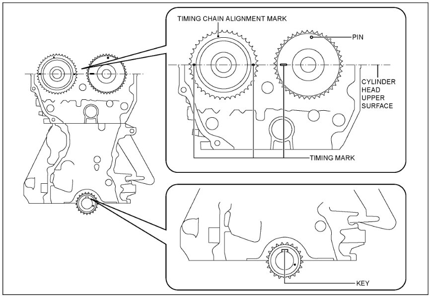

Installing the timing chain and I need to find TDC, Top dead center, secondly I’ve don’t this three time because after I install the chain I rotate the crankshaft pulley and after two full rotations the links are off by one link. I I’m thinking it’s the tensioner and the instructions are very complex as to where the tensioner lie supported by a m6 bolt. I’ve attached the instructions which I make sense of it. All the help I’ve gotten has style everyone. My chain comes with painted links so it’s easy to see where they go, but it’s just a few steps I’m not clear on. How the exhaust cam the other how they need to sit when I place the charge and then from there one it should be very simple. Installing the chain cover the rest is pretty simple. I just need a second pair of eyes to confirm what I’m doing is right.

When you turn the crank, it may take multiple turns for the marks to align again.

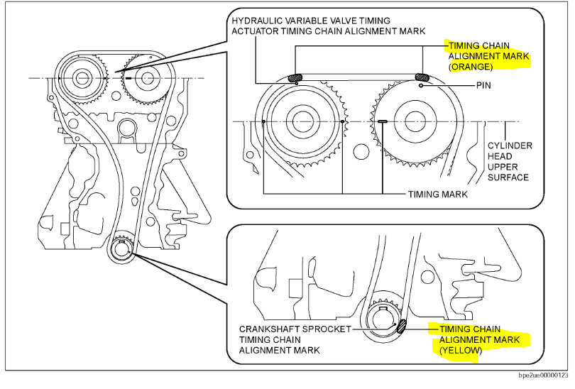

I attached a couple of pics below showing timing marks. Note the color marks on the links. Let me know if that is what you did.

Yes, I sure did. From here I even rotated the pulley to where the marked went twice all the way through to get “realigned “only to be off every single time by one link. The last time I did this I turned the car on, and it ran for a few minutes, but very hard and a lot of tapping noises and was even with someone else that stated the timing was so close but off by a link.

If you had the colored links aligned, it can't be off. There are a specific number of links between them that help prevent it from being off.
By chance, did the timing jump or the chain fail before you did this work?
